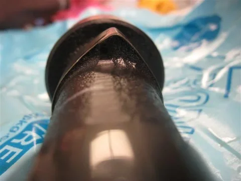

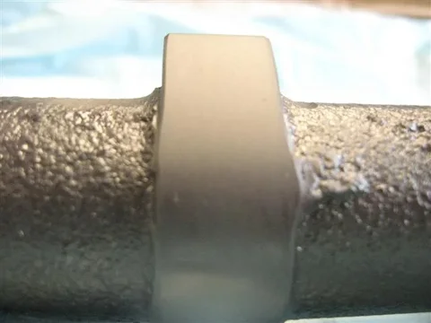

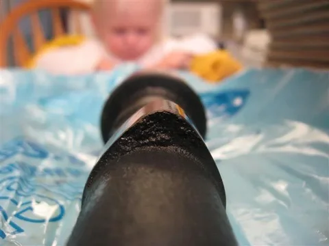

Here are some pics of my cam I just got back from the cam grinder machinist guy.
The new cams intake lobe. It has more lift, but is relatively unchanged.
Here is the exhaust lobe... much more duration and lift. I as specified to increase the breathing on the exhaust side. OK so the exhaust lobe pics is out of order and is further down below, but you get the idea.
He also beveled the edges to prevent catching on the lifter. He said that poor quality grinds, such as the one I provided him ugg, can catch on the lifter edge and break a big chunk off causing major damage.
One thing that is weird is he said that the Cruiser gas cams and the diesel cams share the exact same profiles on their lobes... wtf?
Actually he said WTF #$% ##$%% Toyota!!
And then was happy cus his grind will be much better... hehe
He also parkerizes his stuff.

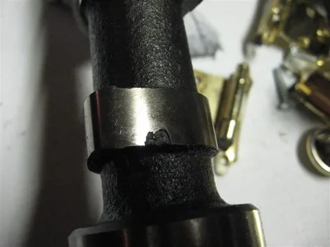

These pics are from the same cam before he worked on it.
Here is one lobe that he said is a good candidate for catching the edge of the lifter.
This damage he said could have been origionaly from a relatively small amount of metal broken from the edge but caused massive wear as it got ground in between the lifter. Its hard to see but all of the hardness is worn off on the pokey end of the lobe.
He also recommends running a zink additive as most modern oils have decreased the amount of zink due to roller lifters not needing it in newer cars. He said over the last few years flat lifter cams of all makes and types have been comming to him with terrible wear. He attributes this in part to low zink.
