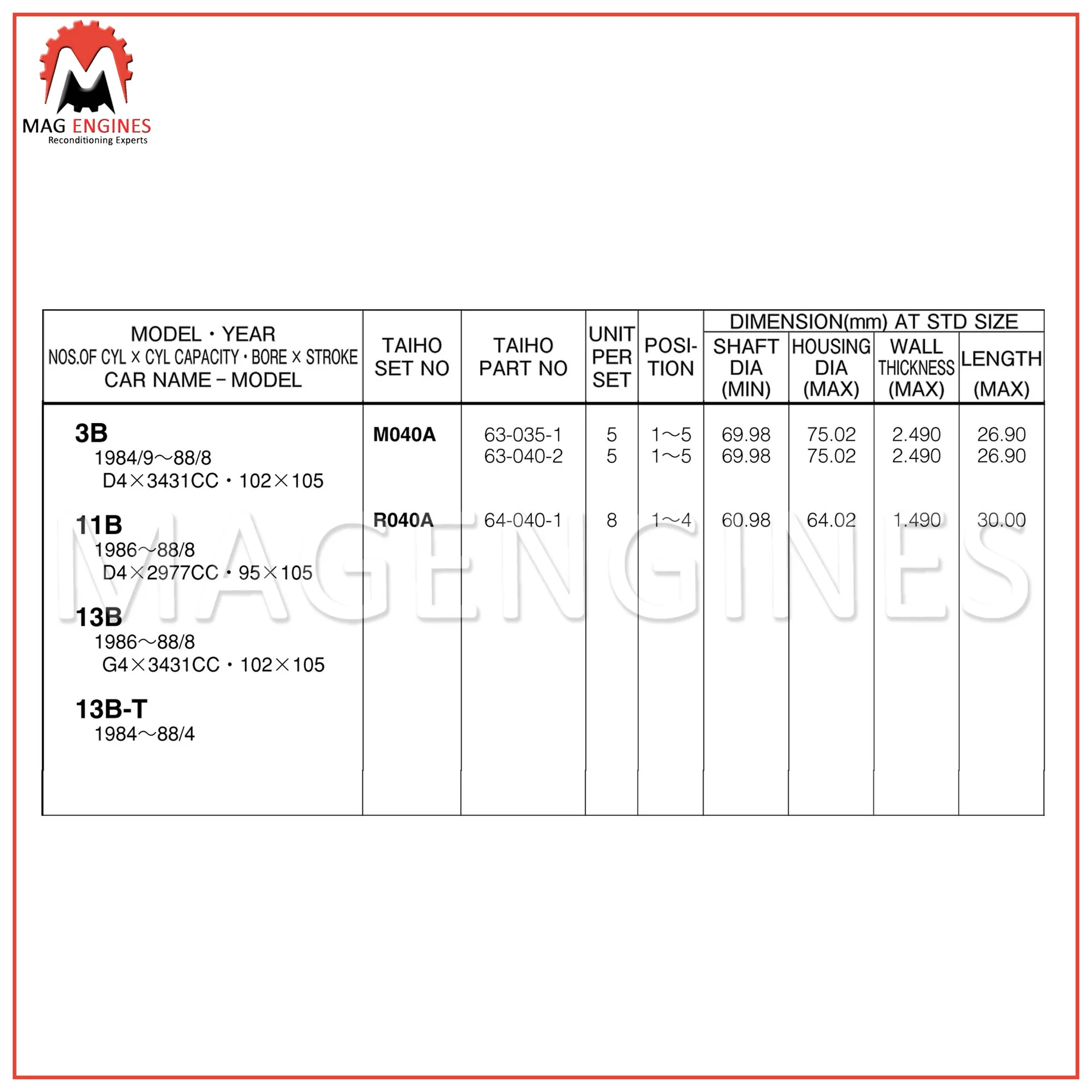

So I ordered these a few months ago from Mag Engines in Dubai. Very attractive price, maybe now I know why. The tabs for half the shells are on the wrong side... And the set doesn't include the #3 thrust bearing. 😐

M040Astd seem not to the right part for your engine.

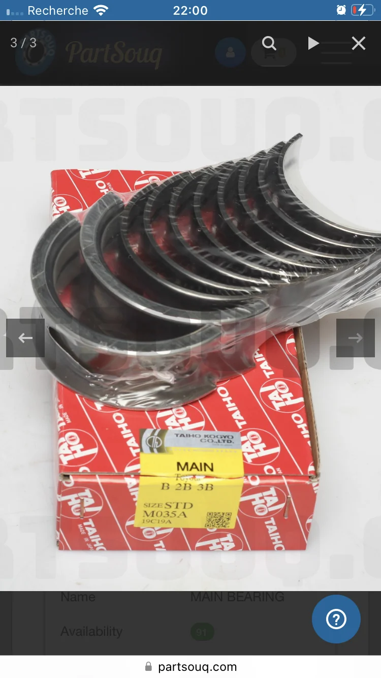

If you search Partsouq with 1982 3B, you get several part number for crankshaft bearing, the first could be what you need, M035A
Looks like you're right. I ordered from Mag Engines, and they only have a stock photo that doesn't show the integrated thrust bearing. Somehow I missed it on the chart that the M035a kit is for 1980-1984 and the M040a is 84-up. Doh! I may ask them to exchange...I paid $30.63 + $20 for shipping, if anybody else is looking for 3B stuff.
Nothing to do wih the price, you ordered the wrong set. Any 3B bearings common to the 14B will only fit the 1988+ 3B, which was never supplied in North America.

I appreciate your help getting me on the right track. Just ordered the M035A set, on sale for $25! The rod bearings are the same, so I should be all set.
