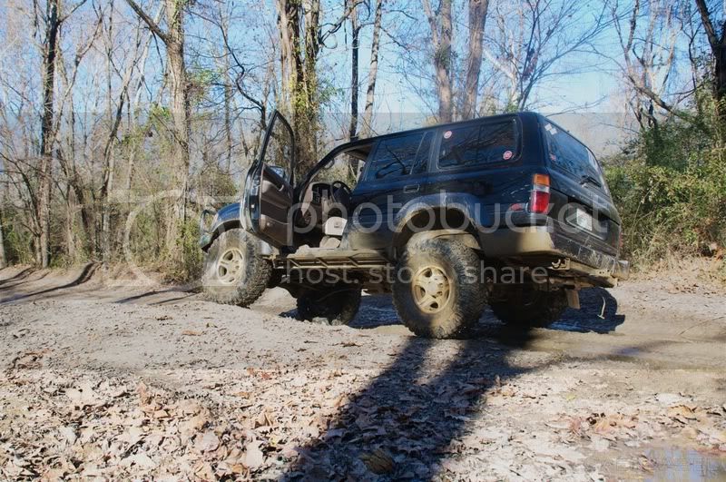

37's w/ OME 2.5" lift
rubbed slightly above the frame on the inside of the rear wells

im wondering if a wheel spacer will clear my rubbing issue 100% or if just stepping up to the FOR springs and shocks will solve it :D id like to avoid just settling with J springs and L shocks
youll need spacers to clear the inside rub. the 8" with 4.5" bs wheels sit too closely to the frame. either new wheels with a 3.5-4" backspace, or spacers on the stock wheels. i had 1" spacers, no rub on full stuff. now im running without, and have rub on the inner wells...not that i care or it bothers me really...
Yep, 1" spacers whatever your spring choice if you are running stock rims.
1" spacers will clear up the rubbing issues for sure. It was interesting going for the short trail ride yesterday with MemphisACC, things that the transfer case needed to be locked for, were a walk in the park. The truck laughed at a LOT of things...
The lack of flex in the front was the only thing that we noticed, something I was thinking that the FOR suspension would fix. *Nudge Nudge*
Over all I am VERY impressed with the truck and the tire choice.

325/80/16....man I like that size. No need for new wheels.
So, if you go with this tire on stock wheels and 2.5" OME, you need bumpstop extensions and 1" spacers all around?
Wilson, what rims did you go with?
I would say forgo the bumpstops at first... We did NOT alter the bump stops on MemphisACC's '80... The 325/80/16s do rub some but very, and I repeat VERY minimally. I have a feeling with a 1" spacer we may or may not have to trim the inner part of the flare. There is a LOT of room in the wells with the tire fully stuffed.
