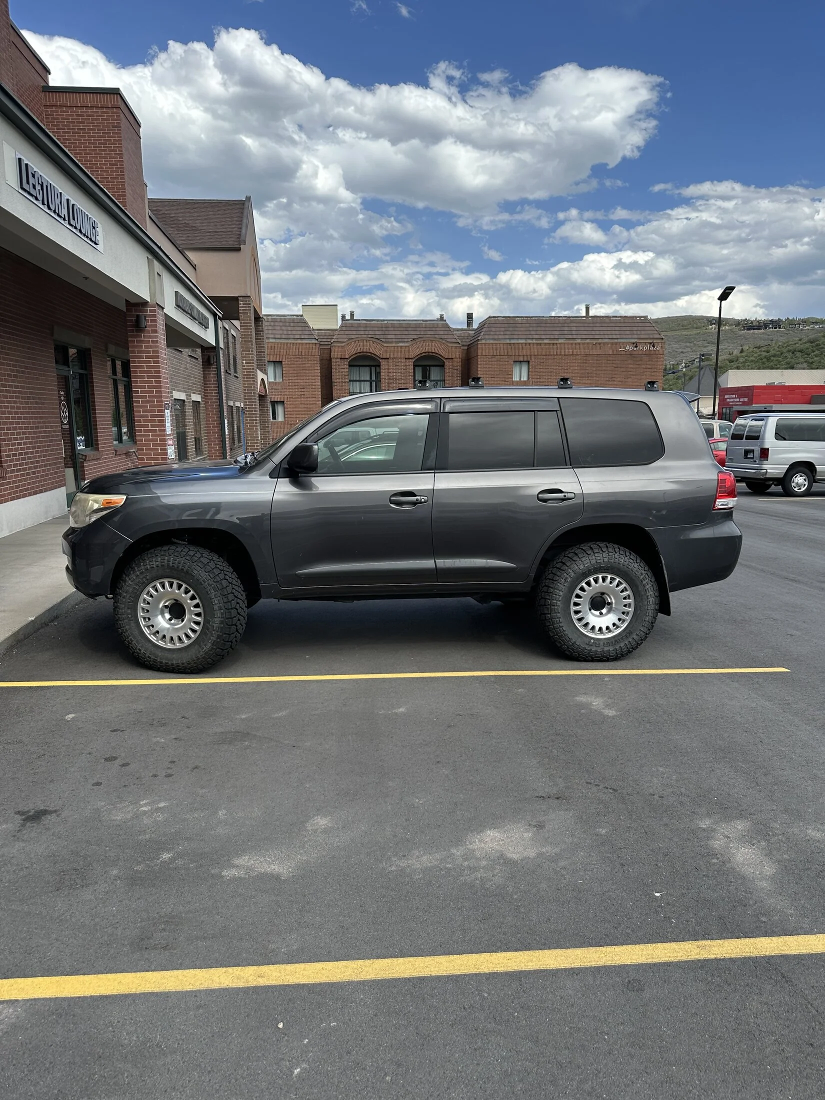

I installed these on my heritage the other day.

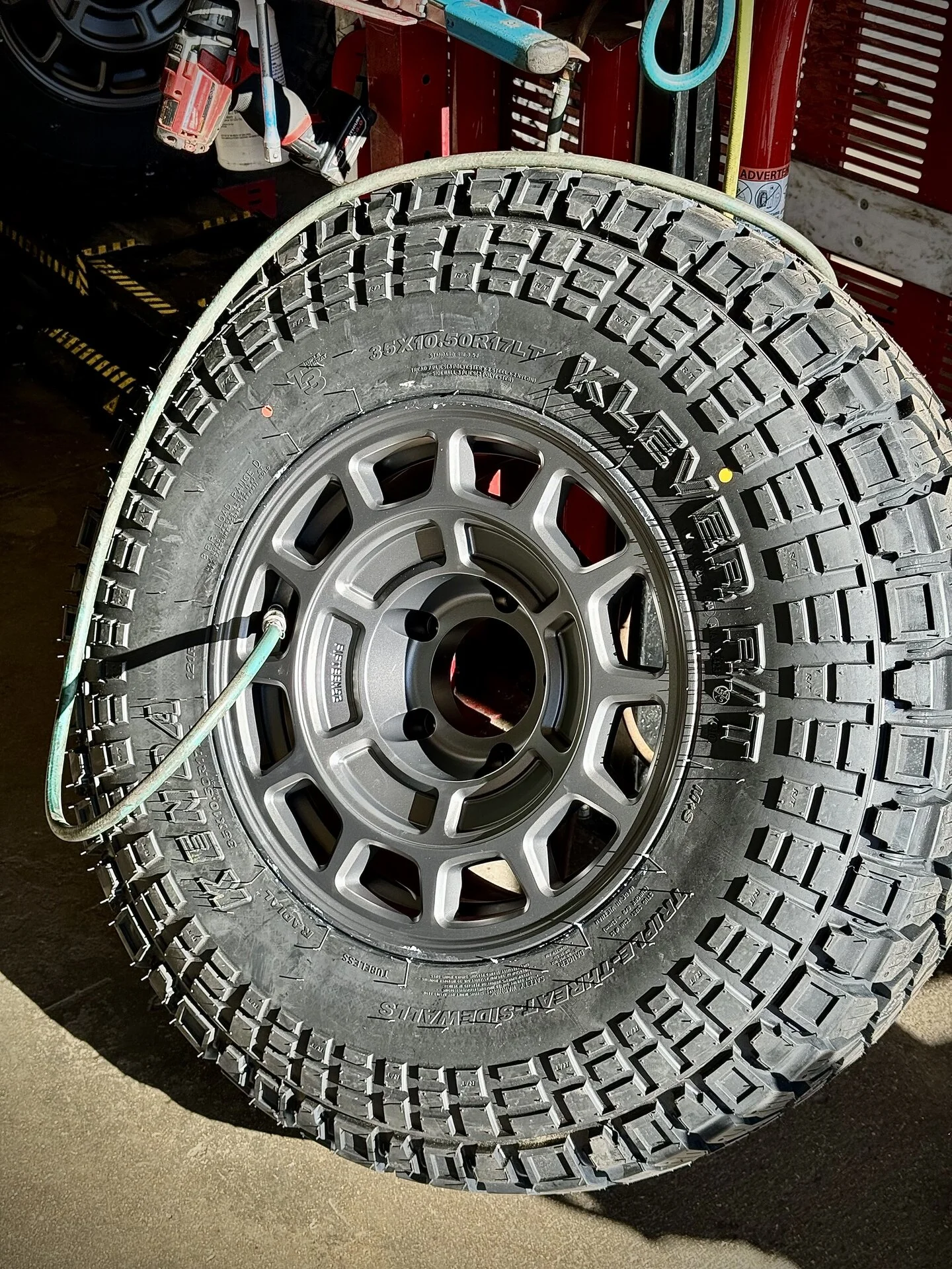

Not on mine but I’m doing the body mount chop to get rid of the rub in reverse and clocked

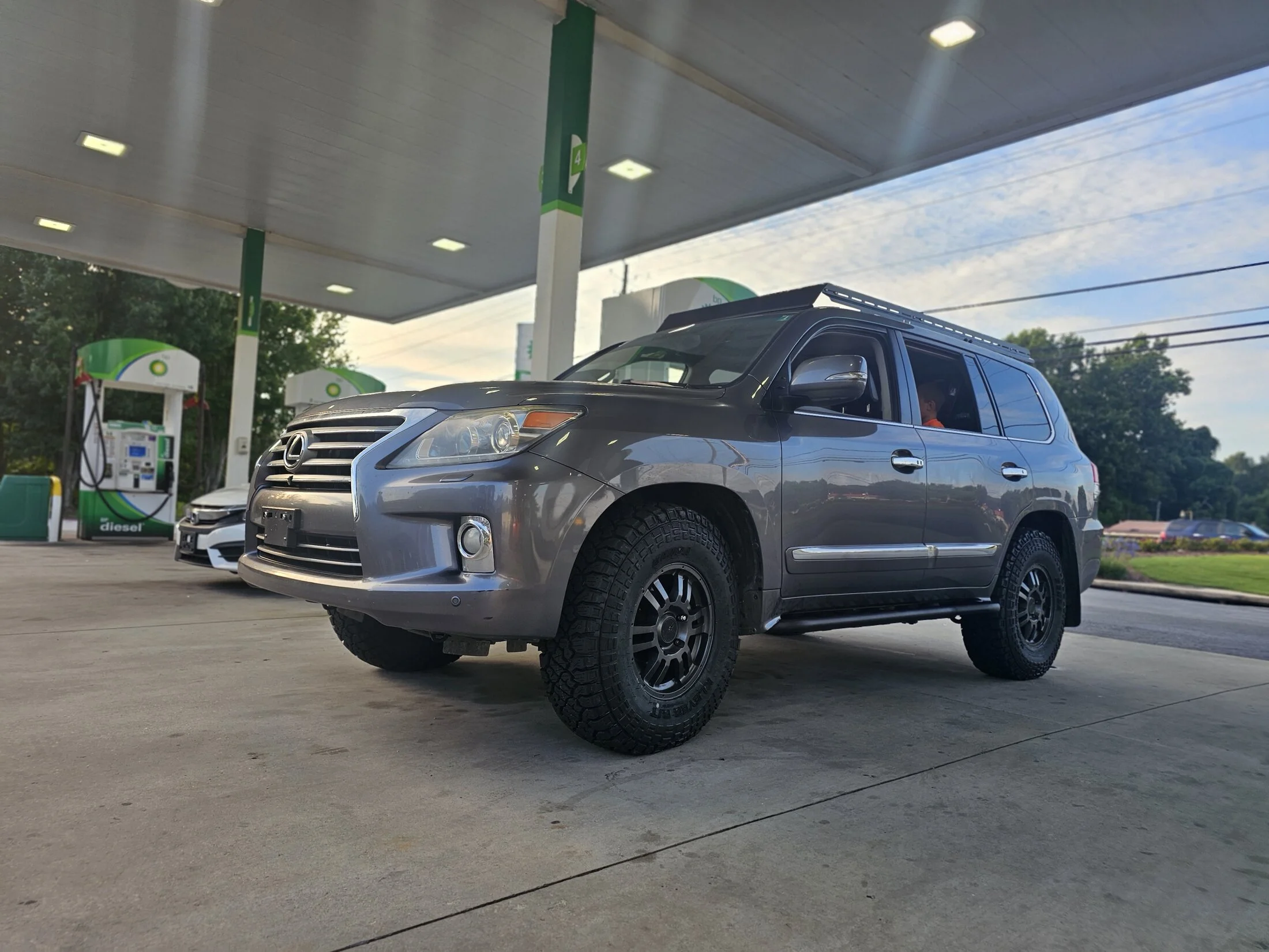

Just installed these (Kenda Klever 35x10.50's) on my 2013 LX with Rock Warrior wheels (No Spacers)
I did a slight sensor lift prior to install.
So far I have somehow managed to avoid any real scrubbing (After Removing the Front Mud Flaps).
I think I hear a little rub in reverse while turning. But minimal.
I still need to put in high mode and flex the suspension.
Just wanted to provide my experience for the next guy reading this thread.

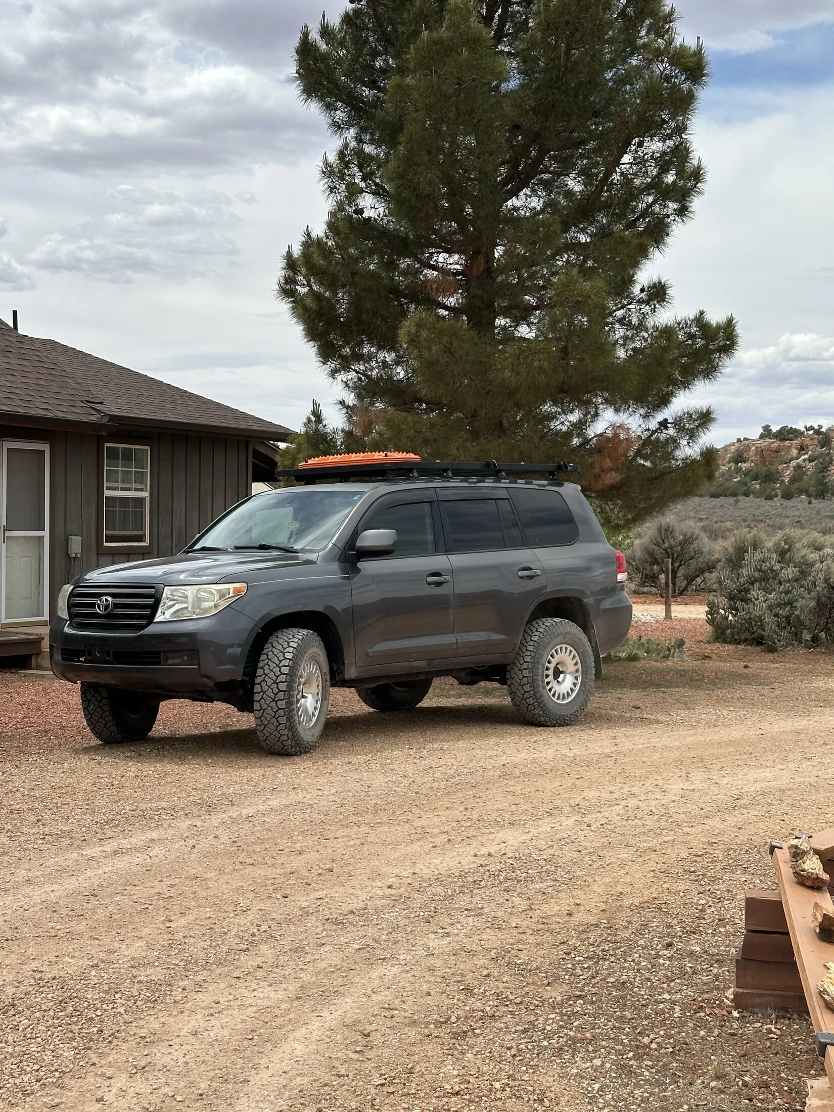

I’ve had these tires for a bit. Nomad Sahara. 0 offset. I do not rub on my body mount or kdss. I did have to trim quite a bit of plastic. I also have a full size spare underneath. So far I’ve enjoyed them and I’m considering buying another set to stud for winter.
Do they flex out without hitting the fenders? Mine on 15 offset look really close…
Haven’t had an issue. Been to Moab and a few flexy areas.
