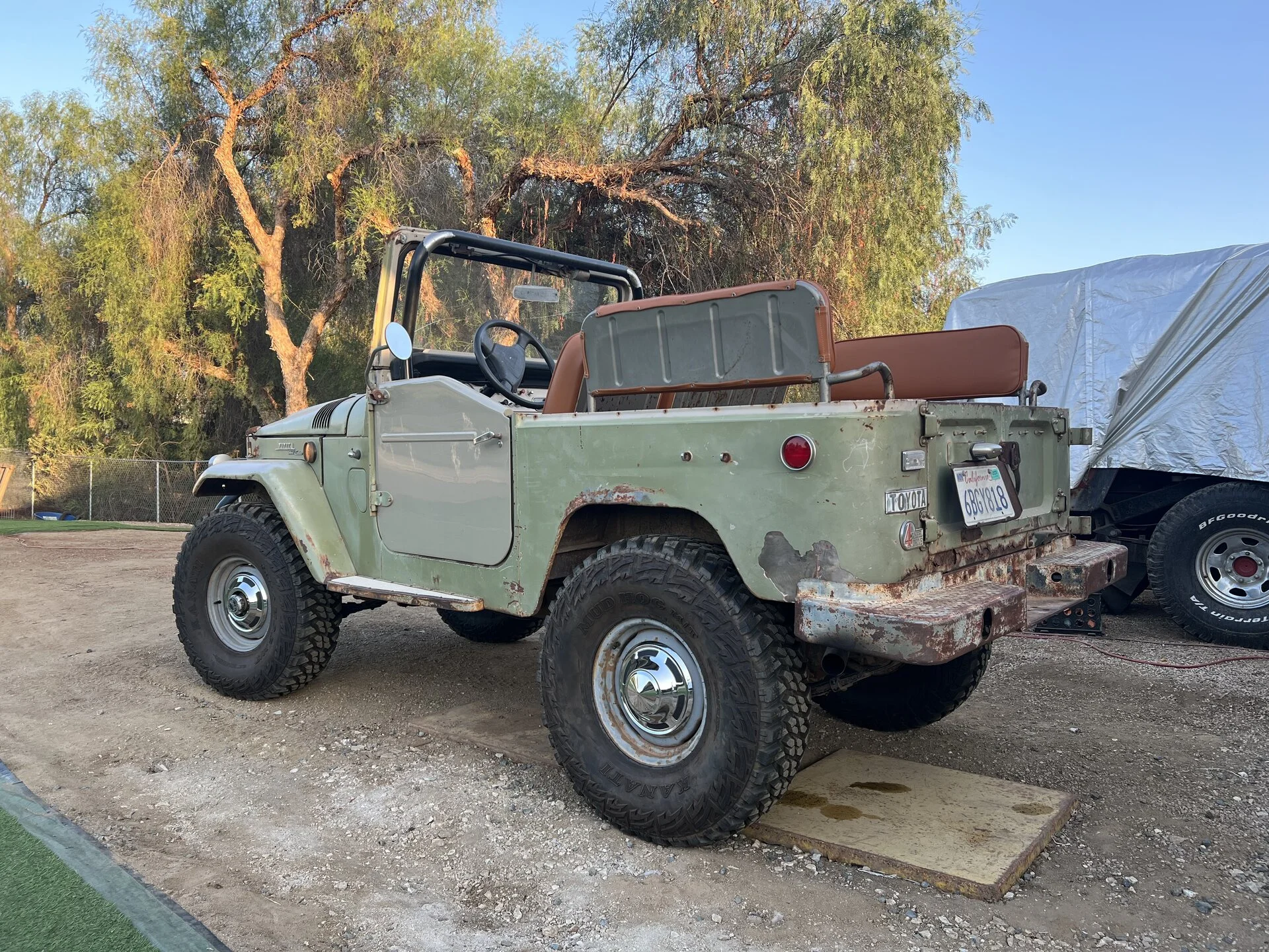

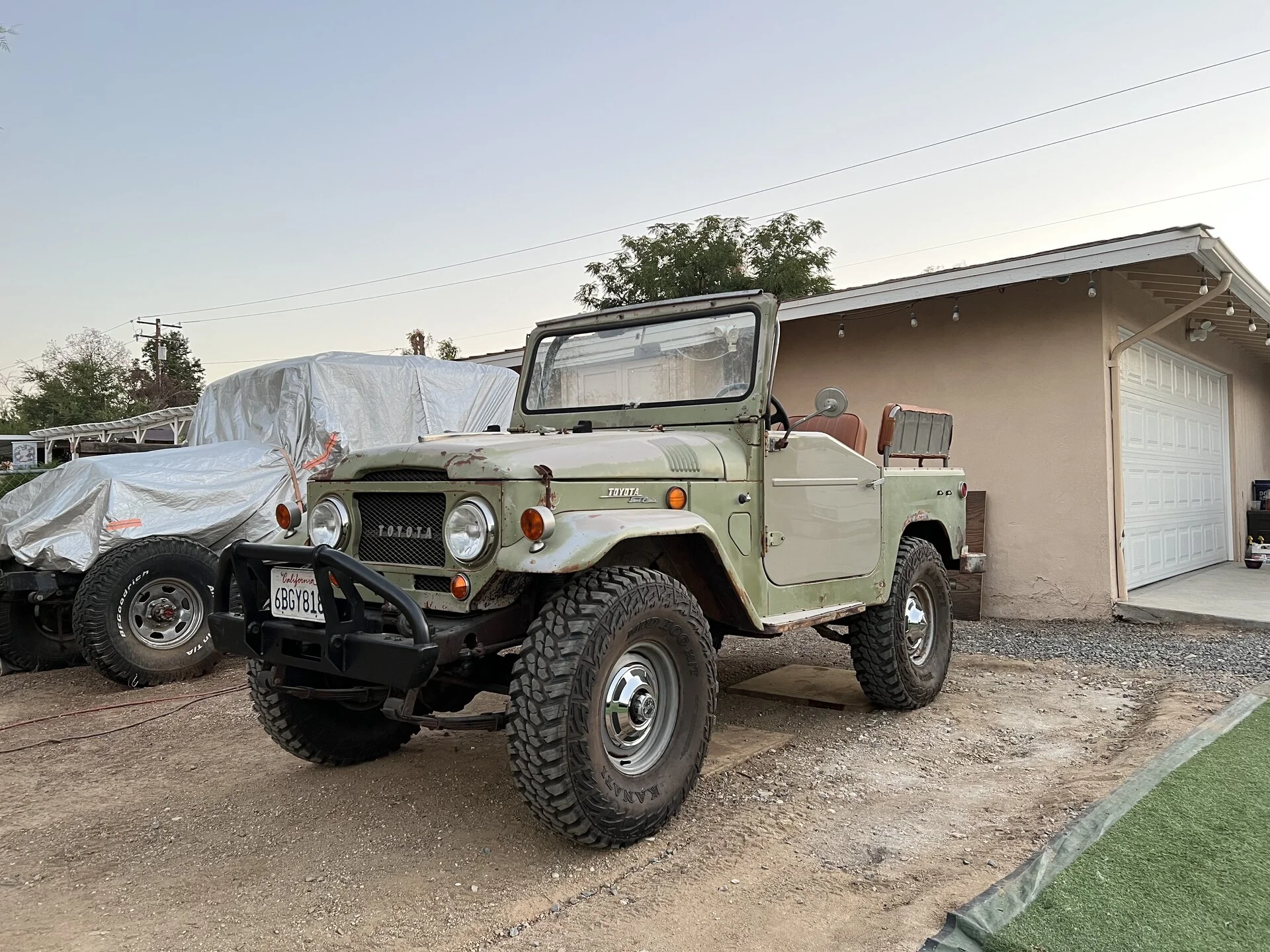

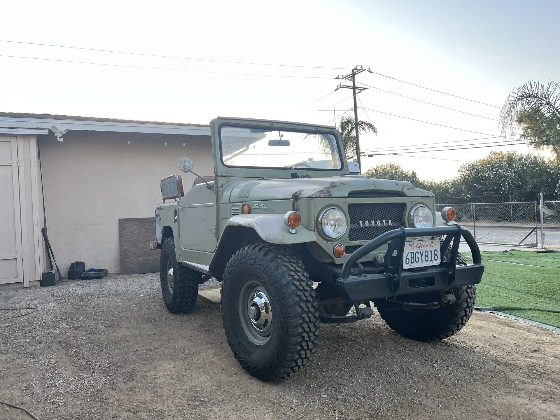

If you stay with the factory wheel width and offset and also skinny tires (35x10.5), I believe you can get away without cutting the rear wheel opening as the tire should tuck up inside the lip. If rubbing the inner wheel well bothers you, bumpstops will be needed. In the front, you will likely run into tire/leaf spring interference without wheel spacers or the mini-truck hub swap. I think it's a fine line up front trying to stay low with bigger tires between fender clearance and leaf spring clearance.

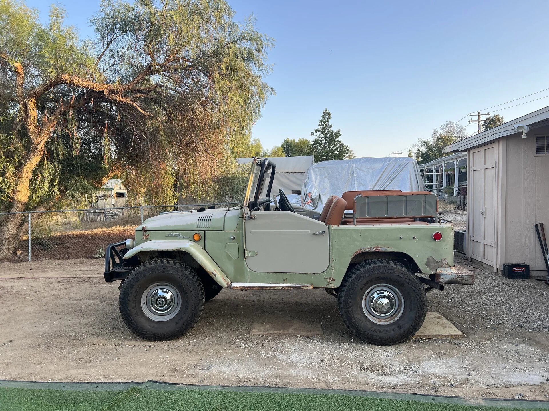

2" lift on 35's tall skinny's, and I've done some playing around behind the house in the hills but not really done any hardcore wheeling with it. I have tire to leaf spring & tire to steering pivot arm clearance issues at full turn and articulation, and the tires rub the inner wheel well in the rear. I haven't played with spacers up front, this truck isn't intended to wheel.

You will rub on your drag link and pitman arm at full lock. Likely rub the inner rear wheel wells when flexing. I have a 2.5” OME and true 33” tires and that’s where mine rub.
