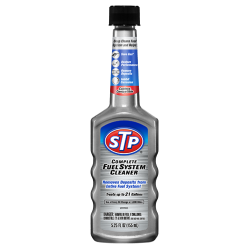

Thanks guys! That's quite a list, 2001LC. I will work my way down it. Couple questions. What is 44K? What is tech stream, ACH/tech stream?
44k is a fuel system cleaner. You don't have to use 44k any cleaner will work (I prefer STP b/c it's easier for me to find locally), it's used to clean your fuel injectors and let your engine run smoother & more efficiently.

Aha. Thanks. Techstream looks to be quite expensive! Almost $1500 for a scanner system?! Damn. As far as 44K, thanks for the info. I actually have some Liqui Moly 2007 Jectron Fuel Injection Cleaner, which I use on my other cars (BMWs) with some success, so I will probably go that route. Anyone in my area have a Techstream? I would like to rent it, if possible. :)
