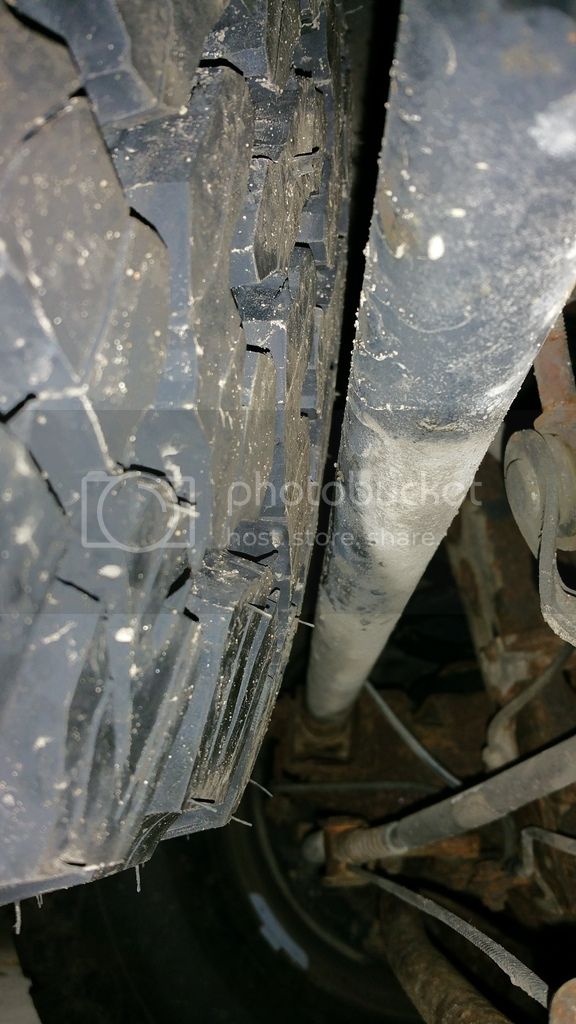

Here's some pics of a 315/75/16 BFG, which measures small. It's pretty worn, but I've fit a new one back there. This is with the DIY tire lift thing using 3" tubing IIRC. No hitch tho, so i'm not sure how that plays into it.
It fits fine without a tow hitch, but hangs very low and looks a little bit silly. Mine's there now.
I tried the same with a 315/75R16 Toyo MT. You will most likely need to remove the receiver hitch so not to rub on the rear diff arms. Hitch came easy enough though with 4 or 6 bolts. I also have the 3" pipes that raise the spare higher into the pocket, but this may have limited returns with a full 315 as it may touch on the bumper flange. Depending on your use, this may be a good opportunity to use a worn down spare. The lugs on a good 315 are 15-21/32nds tall x 2. Thus a more bald spare with say 1/3 to 1/2 tread could save you 1/2 to 1" of room. I believe I posted pics of this setup on the forum before.

Ko2 can be squeezed in without the hitch. Brand new 315 with the tire lift from Wit's end btw ;)
Pan hard clearance- I need to revisit this soon and make sure it's still gtg.
Did you mount the spare to the stock mount, or move it up to fill the void left from where Mr T so wisely decided to NOT give us a ROW sub tank?
Neither my General Red Labels or my Duratracs fit in the OEM location when I tried. (it was not even close) Now with the 4x4 Labs bumper not a chance. My 296/75r16 Nitto TG barely fit way back when. For the record I do have the LandTank extended LCA. Those are moving the axle back a little I don't recall when I installed those in relation to when I tried fitting a 315 down there. But if your running 315's there is a good chance your also correcting for rear pinion as well.

Like i mentioned this is a 315/75/16 and not a true 35" but its what tire I run. (geolanders) The tire I got from ACC is pretty worn down, maybe 15% life left in it, perfect for my spare application. This gets me to about 34" total give or take. I have the factory tow hitch and everything on the tire leveling kit maxed out to the back and as high as it will go.
But as you can see in the photos its totally doable.
