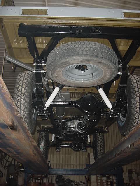

About 8 hours today on the lpb if you included about 3 hours in transit time.

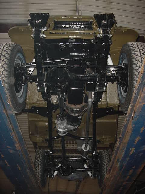

Started on the day at 6:30 am by heading to the muffler/exhaust shop. After a couple hours there...he was done. Took a couple pics, extremely happy with the job he did. Nice and clean from front to back and tucked up nice and tight.
Headed back home and talked my mechanic buddy into giving me a hand with 3 brake lines that need to be made up. After a couple hours at his place (no pics, sorry) we had all the new lines fitted up and the brakes bled out......so now I have brakes again.

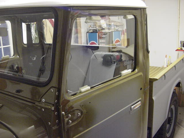

Trailered the lpb home after that and un-bolted a couple parts off the lpb that need to still be painted. Took a photo of some stuff that needs to be either blast and painted. Probably tackle that job tomorrow. I need to get the kick vents primed and jambed on the inside so I can get those installed and then the entire rig is ready for wet sanding and paint.

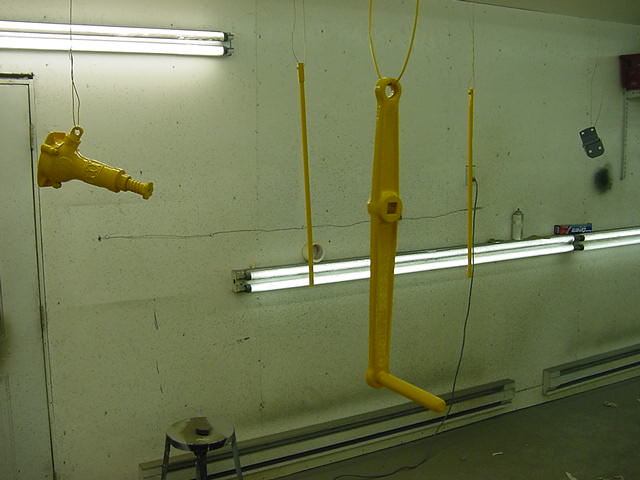

Started off by blasting all those parts that I took a pic of in the bed last night. After that, hung all of them up in booth and shot a couple coats of DP50LF on them. Kinda screwed around a bit on the truck for an hour or so with misc. little stuff while primer was drying. This evening I just shot a couple coats of single stage ureathane that I had mixed up at the auto parts store about 2 months ago. It was a yellow for the jack and handle crank(s) in the truck. It was the closest thing I could get..I think it lookes pretty factory after I shot it.
Hoping to shoot base/clear tomorrow night and all the other parts. Then hopefully can get those kick vents installed on Wed. or so.

Hoping to get the kick vents installed tomorrow. Depending on the weather I would like to try to wet sand on Friday. I like wet sanding outside since there is so much water flying and it's kinda mess. See how it goes I guess.

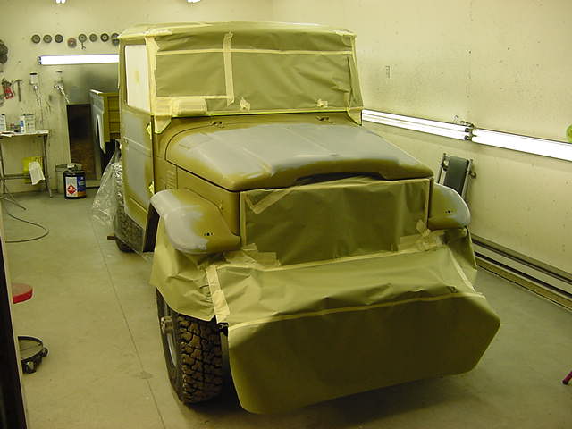

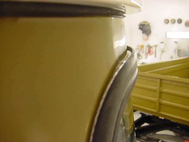

It was a really nice day so I had the truck outside while I wet sanded. Went good, just took all day to do it. I had my neighbor come over and help me lift the box off and back onto the stand so I could wet sand behind the cab. After I was done sanding I wheeled the box and backed the truck into the booth. Spent about 3 more hours back taping this evening. Still have a couple more hours of taping to go, but plan on starting again the morning. I remember seeing my body man buddy using some rope one time around weather stripping before he painted. I used some 1/4" nylon rope and pulled out the weatherstripping and stuffed it behind there. Allows the paint to get in behind the weatherstripping vs up against the edge of the weatherstripping.
Anyway...few pics of todays fun.

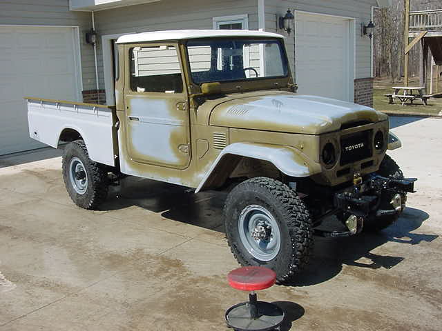

The plan was to get up this morning, finish taping and start shooting base. Well...the finish taping and shooting base happened but...ran into some major problems on shooting the base. As soon as I started shooting the first coat I had some MAJOR fisheye's all over the edges of the front fender's and 1 of the rear quarters. I don't know what the hell got on there, but wet sanding and scrubbing the entire vehicle down with water and a scotchbrite pad the day before obviously wasn't enough to get off what was ever on there.
So..then I had to wait about an hour and wet sand out the fisheye'd areas. I then mixed up some DP50LF and shot 1 light coat after that. Fisheye'd again on the passenger side fender again, this time in a smaller area. This wet sanding and priming went on for 3 more hours and 3 more times in that area before I finally got off whatever was on there???? Then I started shooting base again.....got on 3 solid coats and......ran out of base :rolleyes: Can't win today.....I have good coverage, but it's going to need 1 or 2 more coats for sure. So I was done shooting base for the day around 5 pm, figured I better call it a day before something else goes wrong.
