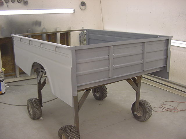

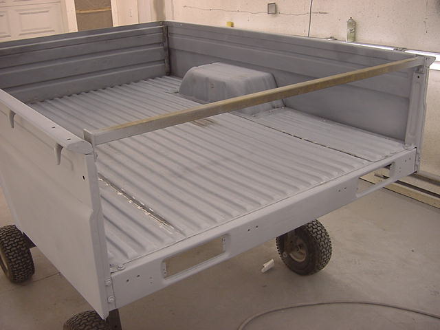

Is the floor wavy or is it the lighting?
Floor is a little whooped in on the rear, about a 1/4". Probably looks worse than it is in the pics. I beat on it a bit, but really wasn't working. I think after it is bed lined it should look fine....also, just to much work to take all that apart to make it straight. Especially when my junk gets driven :D

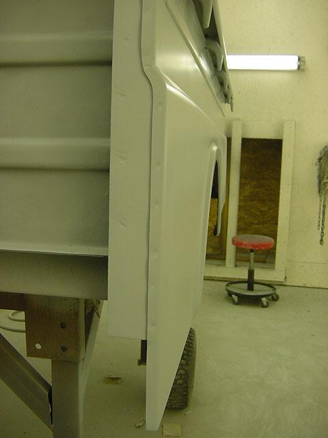

Few pics of the finished product.....still a little juicy in the pics. Turned out exactly as planned. Gotta leave at the crack of dawn and won't be back until late Sunday night. Gives it a could 4 to 5 days to sit...then, get some buddies over and flip it upside down again and do the same. Maybe Monday night?
