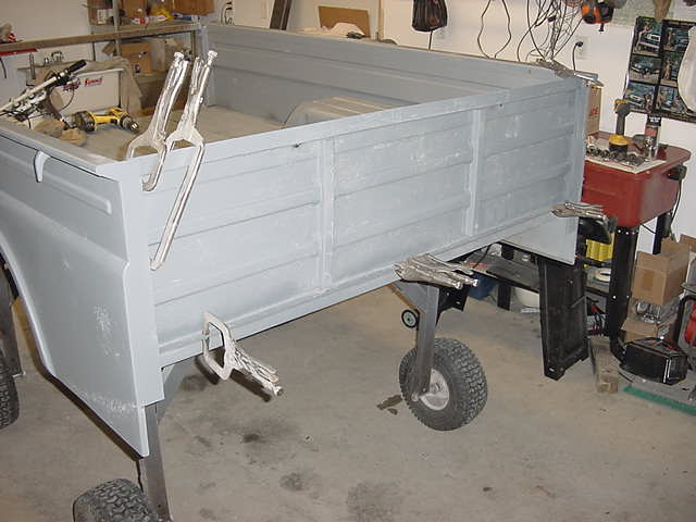

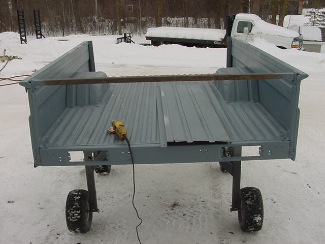

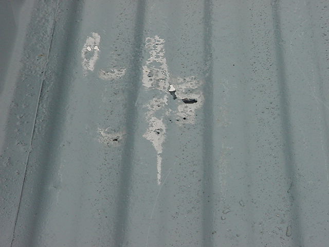

Continued to work on the box. I gas axed the bolts that were around the rear and wheel wells, I think 18 total. Not all of them had cracks around them, but figured I would just replace them all anyway. Also blasted the area where the front panel was, clean the rust off. Welded up the cracks and ground down. I had also planned on getting the front panel welded in, but didn't find the ambition.
Get a couple opinions on this, thining of SEM saucing the front side of the front panel. I am going to be bedlining the inside of the bed, and the bottom...just kinda thinking of a going up and all the way around the front. You don't see it anyway since it's up against the bed? Just an idea, got it straight, but there a going to be a lot of little things....might be an easy way to make it look nice vs priming and sanding for something you never see?

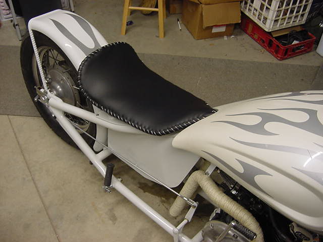

Wife also picked up some foam and black leather, brought it home tonight. Drilled holes about evey 1/2" or so. Glued some foam to it tonight, hoping to get the leather wrapped on it tomorrow...plus work on the lpb some more.

Never had an lpb until now, so I have never had any problems to deal with. If that is the case, maybe it would make sense to SEM sauce the front of the front box panel as I mentioned in my prevous post? What do you think about that?
Bedline the inside, underneath and carry the stuff all the way from the inside of the bed to the bottom over the front panel? Most of it is up against the cab so you don't see it anyway, and it would be protected from any gravel? It would still match the paint and look nice?
Matt
I assume the SEM sauce is a undercoating-like spray. I think you did something else with that stuff in a previous portion of this thread, right? Sounds like the right approach: barely noticeable but prevents chips and dings which eventually lead to more rust.

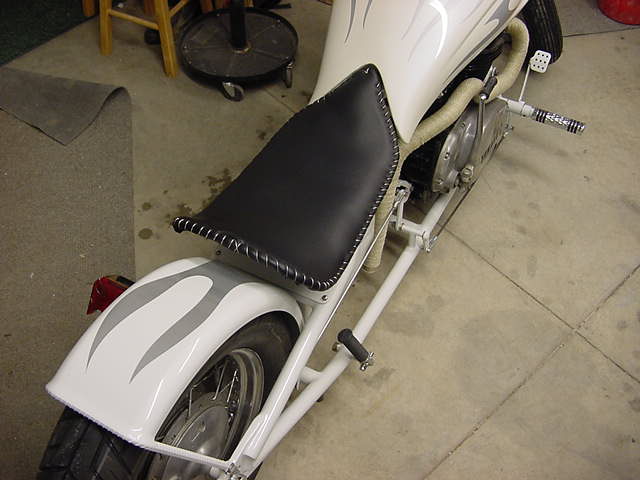

I know, you want lpb....but, the wife picked up that 1/2" foam and leather yesterday so that was tonights project. Wife gave me a hand on this one. I glued the 1/2" foam to the seat with weldwood contact cement. Then for pretty much the next 2 hours the wife and I hand laced the seat with steel wire. Turned out pretty good, but what a pain in the ass to do that.
Anyway, pics of the seat done and on the bike. Should be back after the lpb tomorrow.

The SEM sauce is tintable bedliner, really good stuff. Yes, I sprayed it on the bottom of the cab and fenders of the lpb. Also the bottom of the body and fenders on the lv, and on the bottom of the tub and fenders of my 40....crap doesn't come off.

Got the front panel welded back on, fairly straight forward. Just clamped by each hole and welded, then re-clamped and moved onto the next one. Ground most of them down, even though they will all be covered up by the SEM sauce.
Got some buddies coming over tomorrow night and are going to give me a hand flipping it over. I have a couple small rust spots I have to fix, fill some holes, pound some dents on the wheel wells while it's upside down and replace that left rear quarter.
