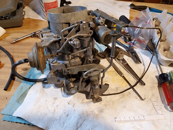

Here`s a pics of the rebuilt late 69 carb:

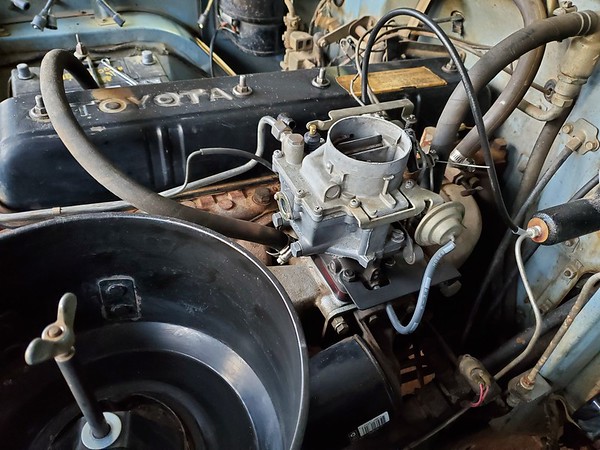

and installed
Started right up with choke and idles great. 👍
