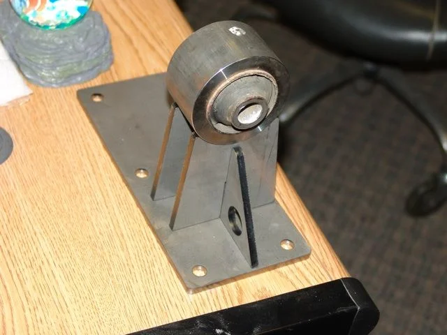

I was reading about a 2UZ swap a guy did with a FJ45 on a FZJ80 frame. Slee helped with the conversion and did an awsome job on mounts. They used a laser cutter and made some really cool looking mounts. I wonder if Slee would offer up a mount package. Mine were made from pieces I just cut out using an angle grinder.
Slee 2UZ mounts

thats gary's rig he goes by waggoner on the boards. i saw the end result in person and wheeled with him in Katmecy, TX.
Slee 2UZ mounts

Christo and I designed these mounts for my 45 with the intention of being able to use them in 80's as well. He is doing a V8 swap on one of his 80s, but is doing another set of custom mounts to put the engine in the correct position in the 80 bay. The mounts are not for sale as of yet and its my understanding that he is not going to build a kit. There are way to many variables, especially in the wiring.
