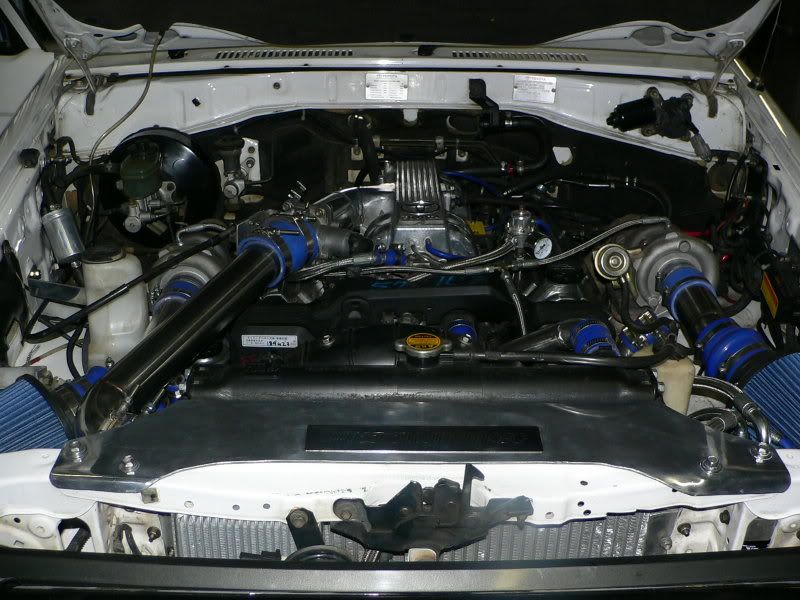

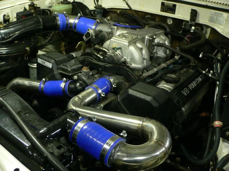

This was a 1UZ and fitted to a 79 Cruiser - If that can be done then I am sure it can be fitted in a 60
Write up Here : http://www.landcruiserclub.co.za/cm...opic&t=38700&postdays=0&postorder=asc&start=0
