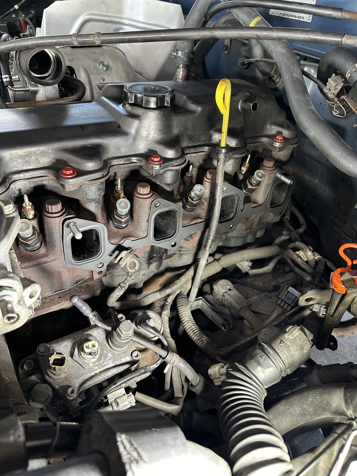

The glow plugs were replaced since it was $80 and we removed them to do the compression test. This didn't make a difference though, although I thought it would since I had to do 2 glow cycles origionally to get the engine to turn over on first attempt. All cylinders averaged 450 psi which was good news. We checked this while the engine was cold.

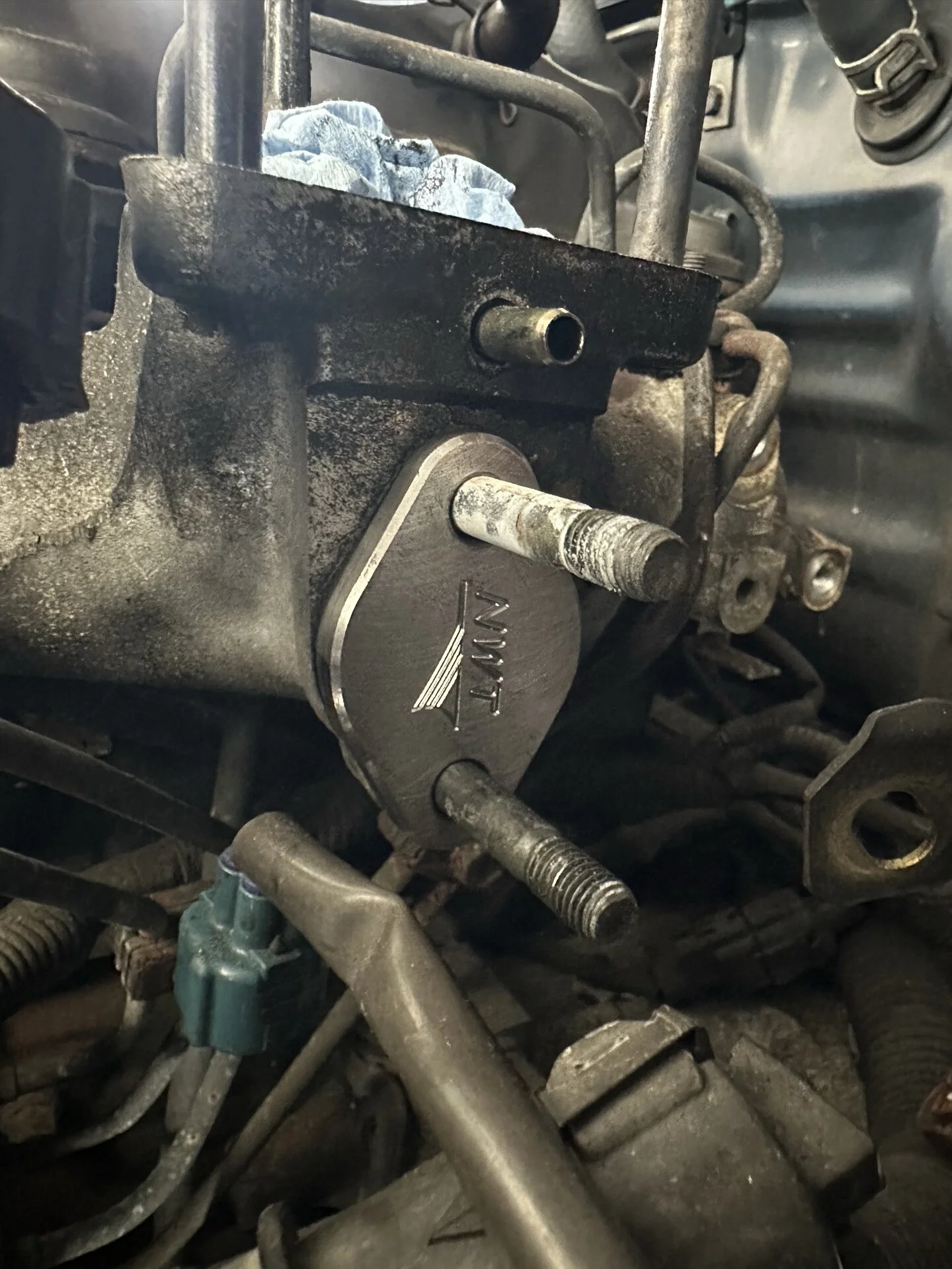

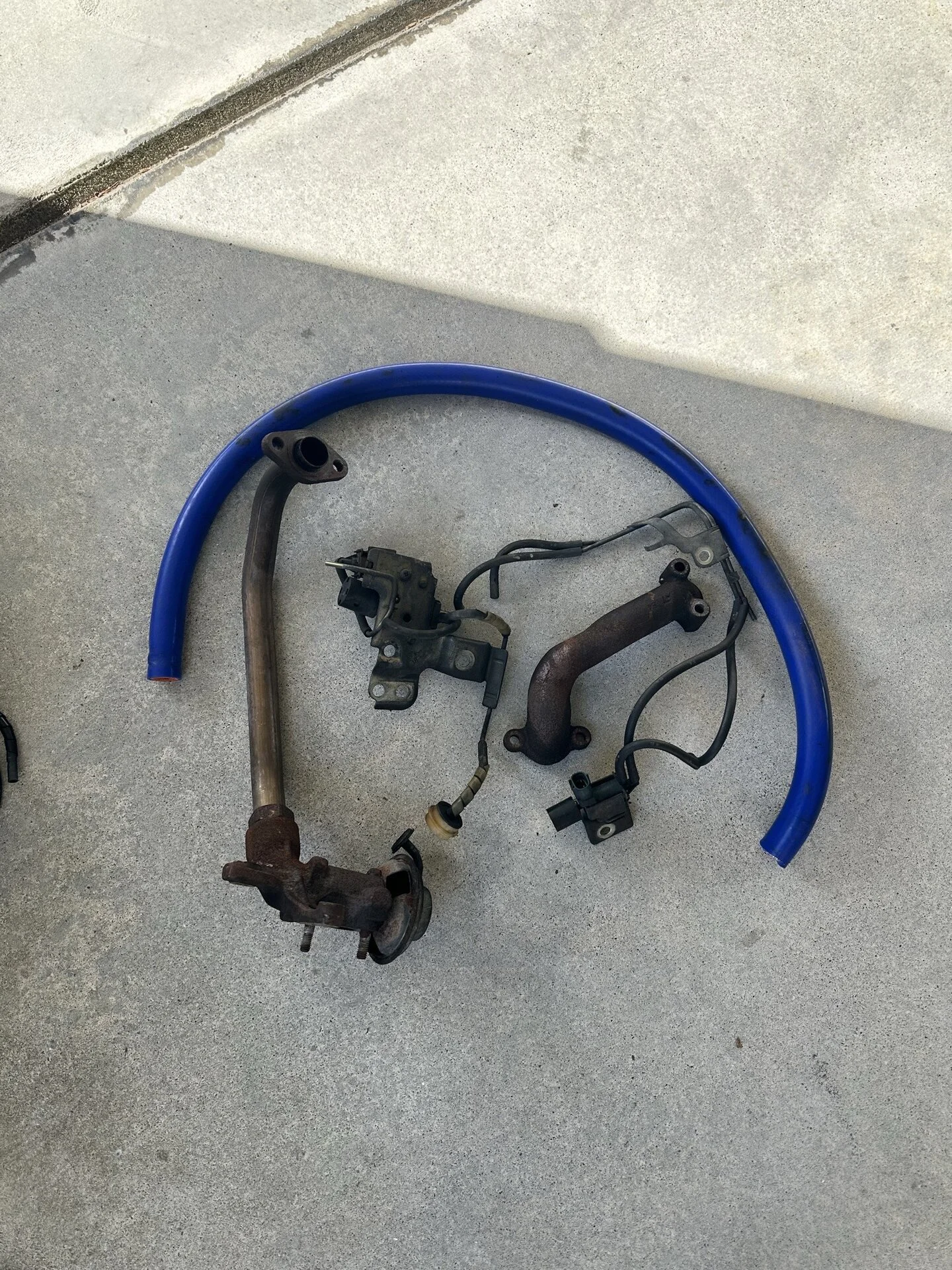

Also, the butterfly plate removal when I did the EGR delete did help a little I think with start up. Definetly noticeable difference on acceleration. Engine shut off was more rough, but no more than the other landcruiser guys I hang out with. Worth the trade off for sure. Below is the link of the kit I bought.

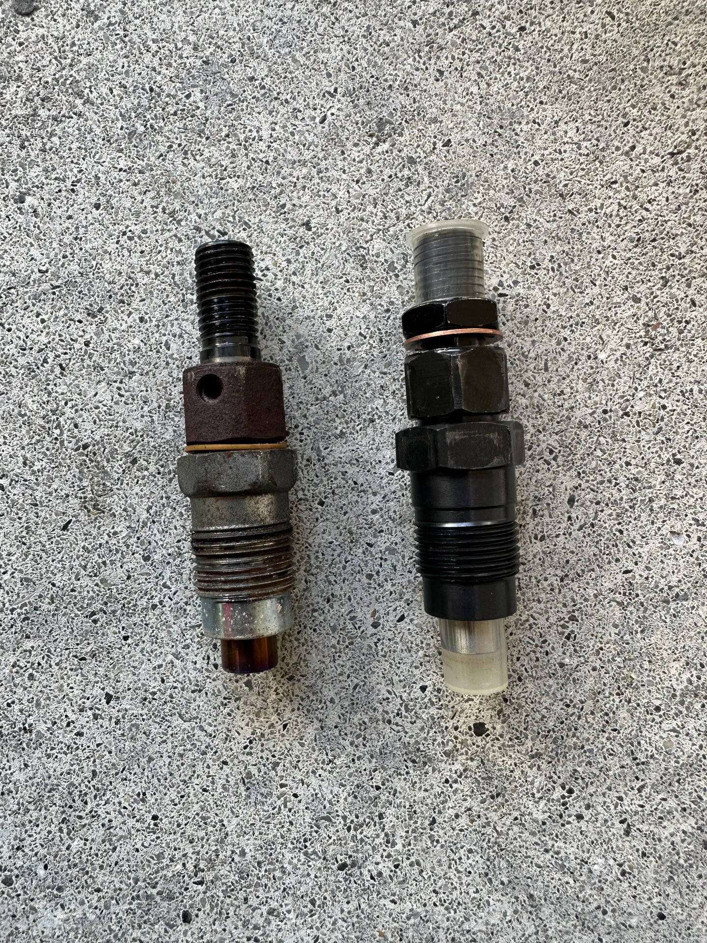

The last thing that really made my start ups in the morning flawless were the fuel injectors. Getting some grey smoke at higher speeds while accelerating and a rough idle (a strong steady vibration) that would smooth out once reved led me to believe the injectors might be the culprit. Also, the truck was just slowww. Idle was around 850.
Also, the turbo was replaced with a rebuilt CT20 from Japan. Has a one year warranty. The truck had a slow coolant leak. After process of ilimination, we determined it was that. Didn't have a boost guage on at the time so I don't know what the boost levels were then but it improved the acceleration. We also got 2 new gaskets for the venturi assy since they were degraded. I now have a boost guage and am getting 12 psi of boost. Coolant hasn't gone down for months! The old turbo was corroded on the inside leaking coolant slowly and instantly burning it off.
The injectors were discontinued so I bought some one ebay from here 4 x Diesel Fuel Injectors for Toyota Hilux 2LTE 95-97 23600-59235 | eBay - https://www.ebay.com/itm/134840197925
Ordered the little crush washer and copper washer that the injectors get seated on. Also new copper washers with the two little holes in them for the fuel return rail if that's what its called. Really helpful btw to have a torque wrench to ensure you don't leak diesel fuel or over tighten them. Made sure each line was bled of any air and regularly checked for any leaks. All good.
This Austrailian company let me know that they were pressure tested before sent out and were the release pressure was at 155 psi
Now my truck has completely driving characteristics. I remember prior, the truck would rev up slowly from idle. Now it's reving up fast and way more response which is nice. BUT, now when I rev it, dark grey smoke comes out the tail pipe. It's also running richer based off the smell and I think increased EGT's. Just got the guage installed for that a couple days ago. Took it on a drive and going up any hill over 3k rpm, the temp pushes 1300 degrees pre turbo. Cruising at around 60 mph they're reading around 1000-1100 degrees. I also am getting smoke when I hit over 12 psi of boost.

- Egr delete 3L / 2LTE Egr Block plate kit - https://www.northwesttoysllc.com/3L-2LTE-Egr-Block-plate-kit-p/580030.htm comes with gaskets. Pricey option but easy
