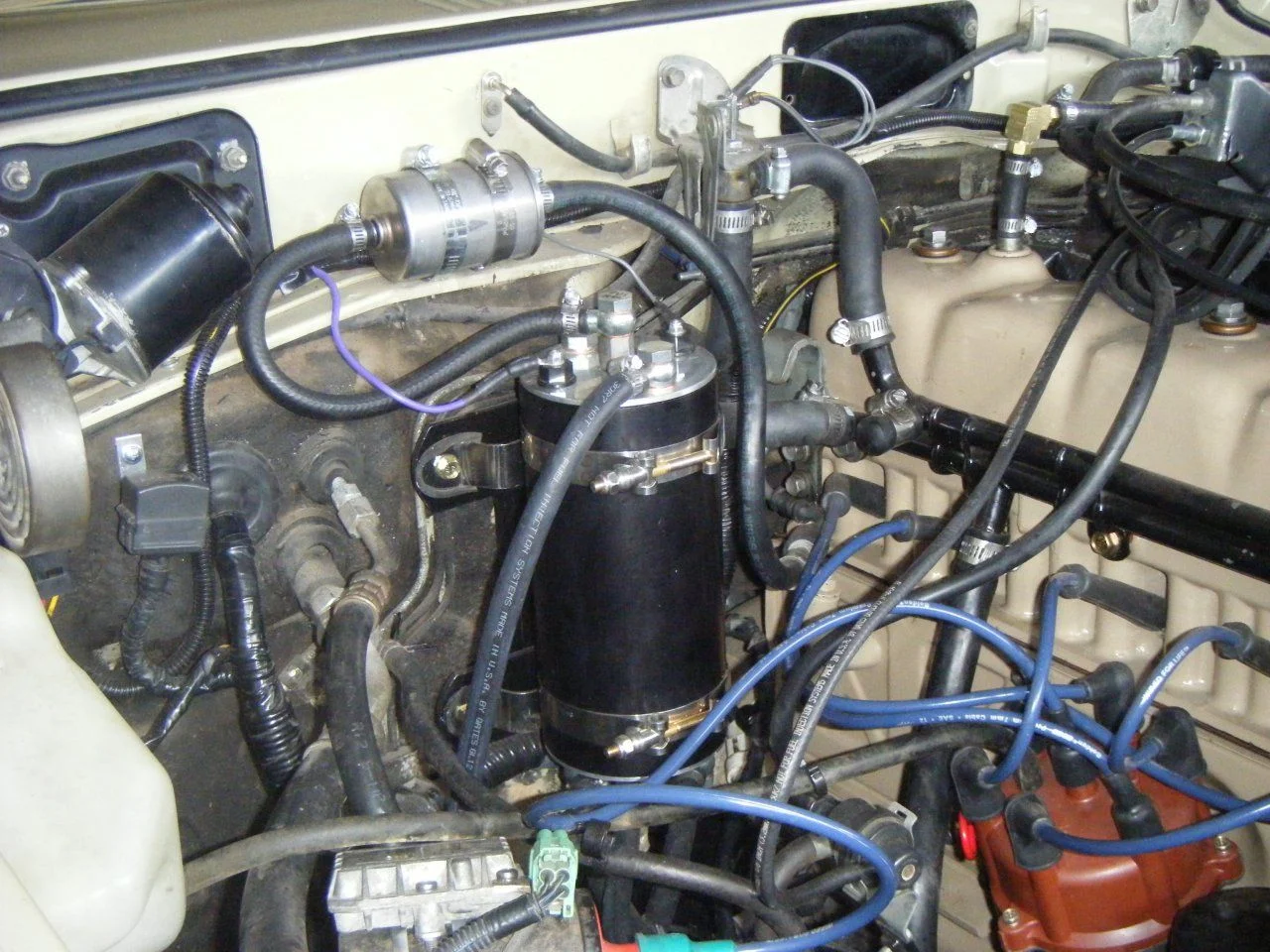

The 60 has an auxiliary fuel tank between the frame rails that the stock tank feeds into, so the fuel pickup point for the fuel is from the auxiliary tank. With the pickup point so low, I was not comfortable mounting the electric fuel injection pump on the frame rail as I didn't think that the electric pump would do a good job of "lifting" the fuel as they are best at "pushing".
So I basically left the stock fuel pump in place, and instead of it feeding the carb (which doesn't exist anymore on this motor) it feeds a small surge tank mounted on the firewall which contains the electric fuel injection pump. The electric pump feeds the fuel rail. Both the mechanical pump return line and fuel rail return line go to this small tank, and the return line to the stock fuel tank comes out of the top of the surge tank.
I will post pictures and a diagram later today.
Here is the diagram and a picture of the install.

It is more complicated, for sure. But the thinking is (I think) that there is less chance of the electric fuel pump starving or failing to "pull" the fuel up from the tank since the fuel has to travel up the in tank pick up before gravity helps it to the pump and is then pushed by the electric pump. This also ensures the fuel doesn't drain out of the line and is always ready for start up.
That's my assumption anyway. I have thought about putting an in tank pump in my spare fuel tank when I do my 2FE, but I haven't gotten that far yet.
Stump, your analysis matches mine.
If you have a stock tank that you are using, then using a frame rail mounted electric pump/filter is very straight forward. Locating the pump close to the tank is best, and noise is minimized.
If you swap in a 62 tank with the stock fuel pump in the tank, then this too is fairly straight forward. Aftermarket parts, or some from a donor 62 make this pretty easy to adapt to a 60.
If you can't use either of these first two scenarios, complicated (sorta) is what you get. For me, locating a submersed fuel pump in a surge tank fed by the system that existed in the 60 was pretty straightforward. Electric pumps push better then they pull, and last longer and are quieter when submerged.
So, after planning on the first option, and not being able to do that or the second option with the auxiliary tank set up that I had, option three was it.
That was my thinking; why not just use an in tank pump?
A good option, but for me the surge tank was easier and more doable with my skills. I wasn't comfortable dropping the the auxiliary tank and cutting on it, and it seemed like more work for little gain.
Anyway, I have an in-tank pump..........it is just in a really small tank:doh:
