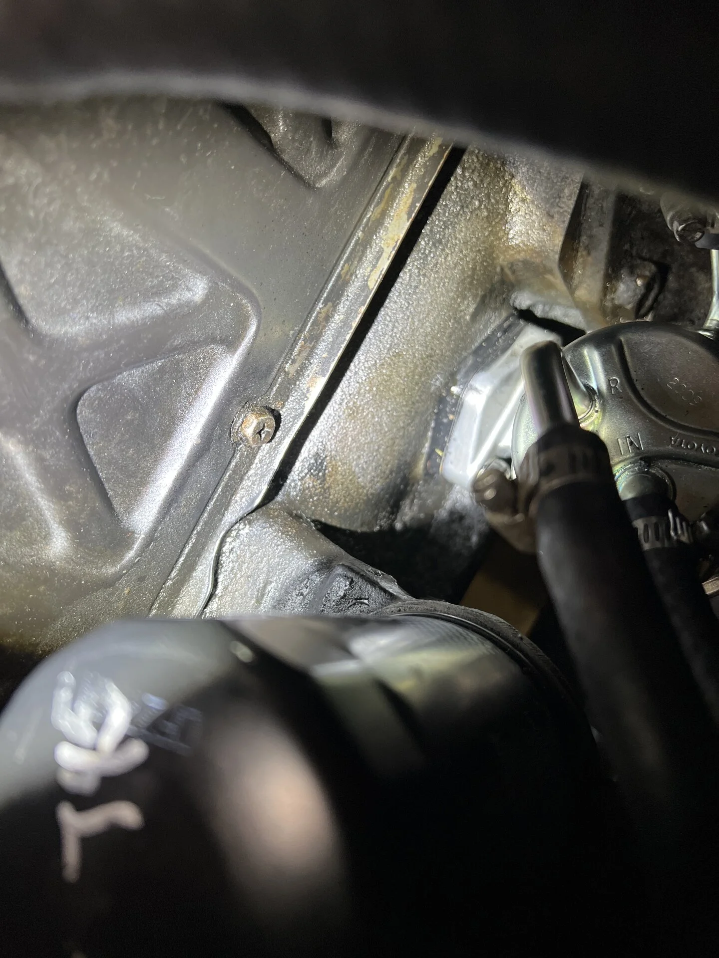

I’ve done some searching for the subject and found some good information, but can anybody verify that you can replace the gasket for the 2F side panel with the engine in place and not disconnect coolant lines (just the brackets), and not the dizzy? I know it may be fiddly to slide up and out and putting back in place with new gasket.
Over the past few weeks I’ve noticed some wetness here just to the right of the oil filter. That seems to come out of nowhere. I’ll wipe it down and let it sit for a few days and then it will still be moist. So I think it’s the gasket is just old and cranky.

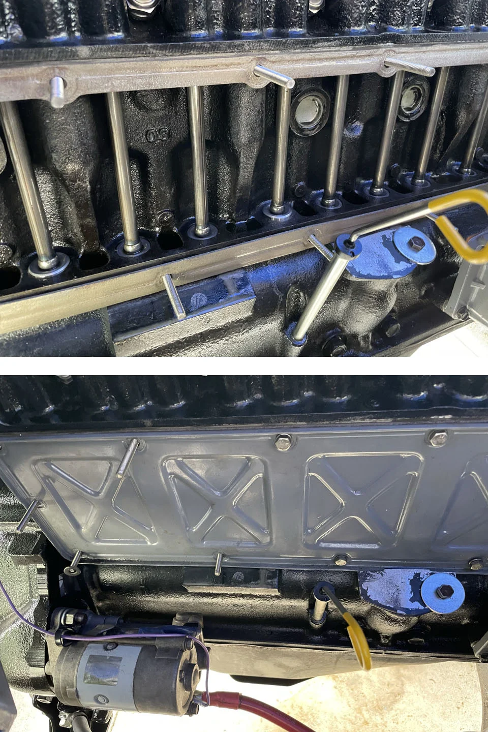

I use anti-seize compound instead of sealant (that’s just me) but either way, my method might be of use. I made some guide pegs by cutting the heads off some 6mm bolts. Then with the gasket and cover in place, swap them out one by one.
EDIT: And for quick dizzy removal and replace, I just take a snap-shot of the dizzy with the cap off.
