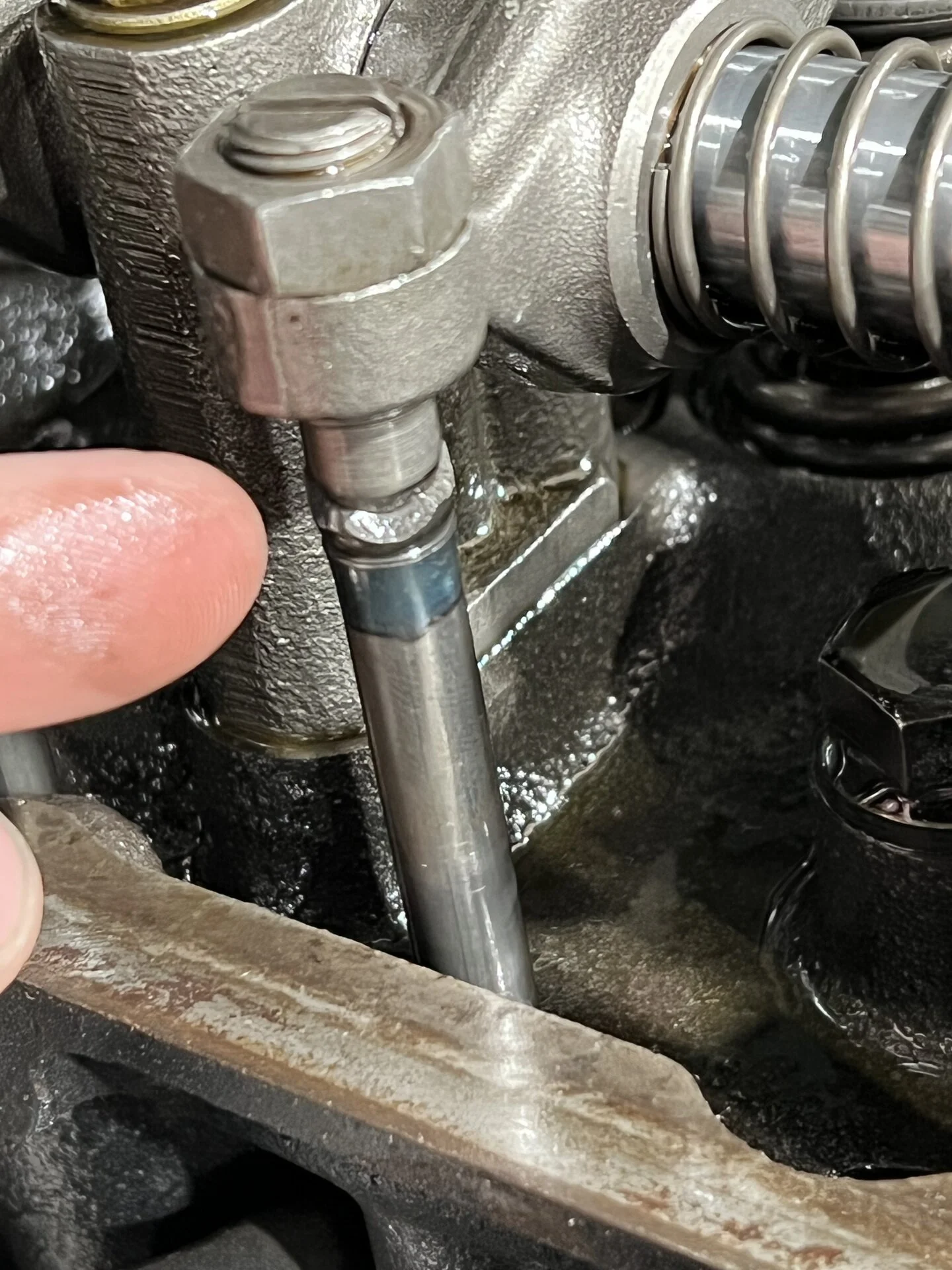

Can’t remember what cylinder but I did crack a push rod a year ago.
