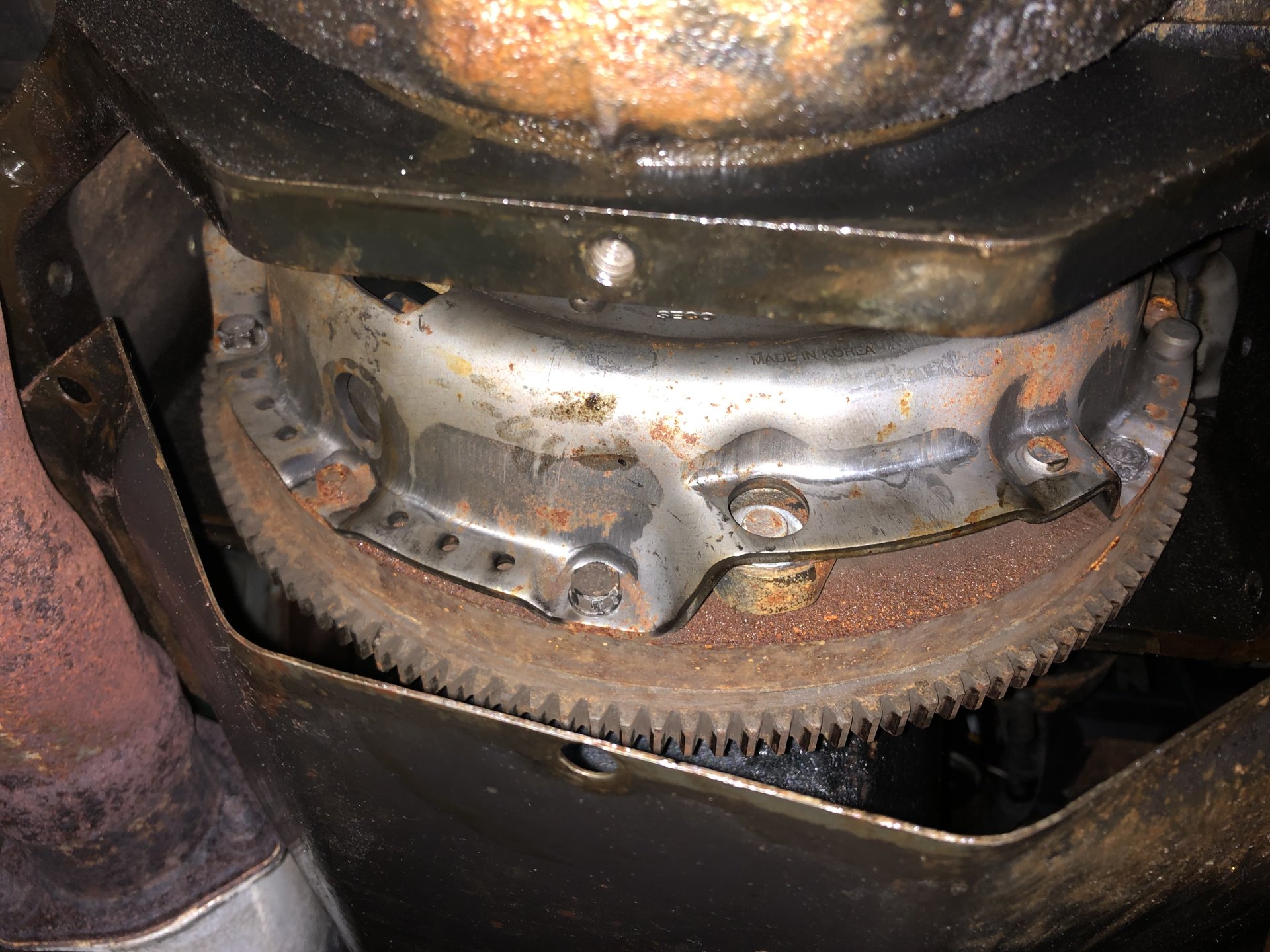

Pull the clutch inspection cover and try tugging front to back on the flywheel as well.
If there is play fore and aft, that tells you it’s a bearing issue? Or if it is loose in any direction?
…or the flywheel bolts are backing out. Seen that twice. :rolleyes:

No play in the fly wheel, no loose bolts.

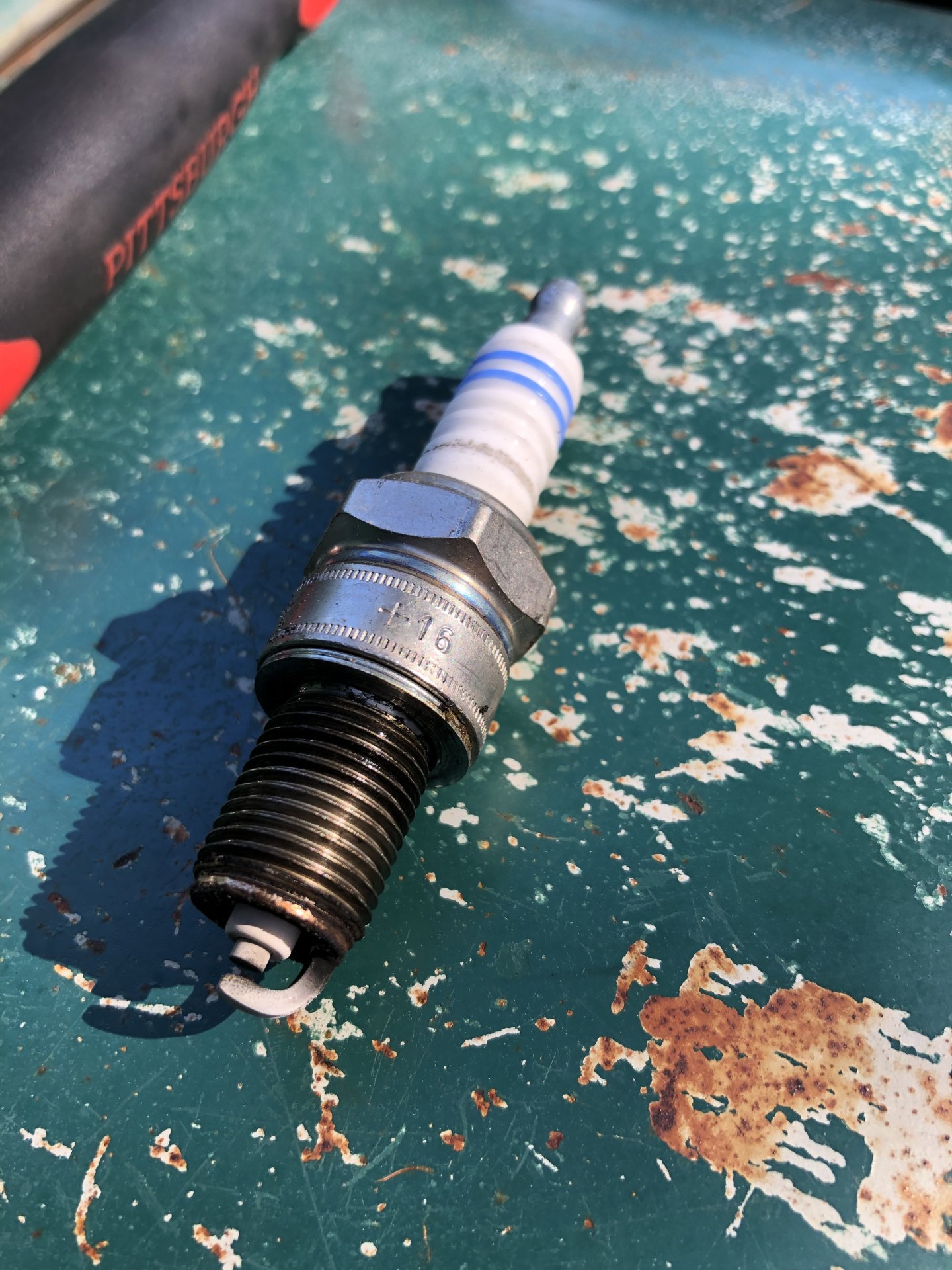

It’s not getting louder with revs, but I can hear it the frequency increase with revs until the transmission and engine get louder than the noise. After removing all the plugs, they need a cleaning or replacement. The noise gets softer when the engine is warmed up. Have not gone as far as finding TDC and doing a timing adjustment.
The bolts Mark is talking about are on the center of the flywheel and used to hold it the crankshaft. Have to pull the transmission and then pressure plate to get at them. Mark was just saying check to see if there was play caused by loose bolts or if the crank might be loose.
