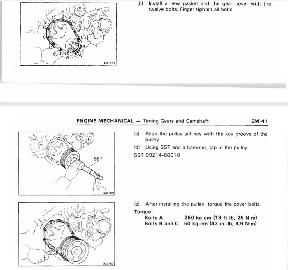

The seal should be greased (on the lip) and you have to leave the timing cover bolts loose until you install the HB, so it centers the seal/TC around the HB, then torque to spec.

Man, seen that movie too many times on this forum. The timing cover centering procedure is the key to this whole repair. I think without the loose bolts you can actually risk tweaking the timing cover some when torqueing the crank pulley nut down.
Thanks guys. Is this the procedure in the FSM?
Yes in the Engine FSM

Its easy to overlook. When I first read it in the FSM, it did not make sense to me as to why you would need to do that. Almost discounted it myself. Luckily for me some kind mudders set me straight before I tackled this job however and, as you most likely see now, it makes perfect sense. It also goes into how important it is to keep the bolts holding the timing cover on in the same place where they came out. Different lengths, different torque values, etc. I printed the graphic in the FSM showing the timing cover orientation, taped it to some carboard, and put each bolt where it goes on the graphic/carboard as I took them out so I would know where to put them back in. Again did not make sense to me reading it the first time through, but made perfect sense once I started taking the bolts off the cover. Taught me the most valuable lesson working on these beasts: The FSM is your best friend. Follow it as written and you will never be wrong.
So even if just replacing the crank seal, I need to loosen the timing cover (new gasket then probably)? Mount HB, tighten and the tighten the timing chain bolts. Thanks.
Download the FSM pages, print them out, then take them to your mechanic and discuss the details. If you are already replacing the seal you might as well put a new timing cover gasket on correctly just in case it's upset with you.
