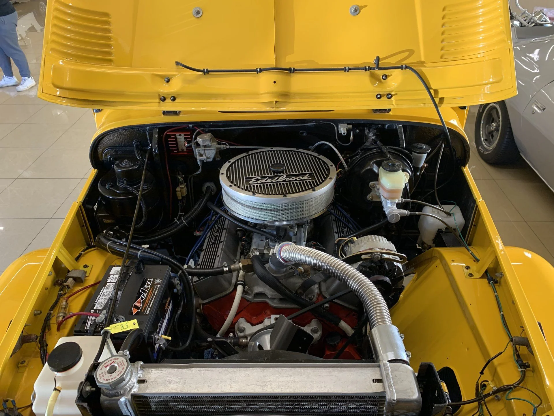

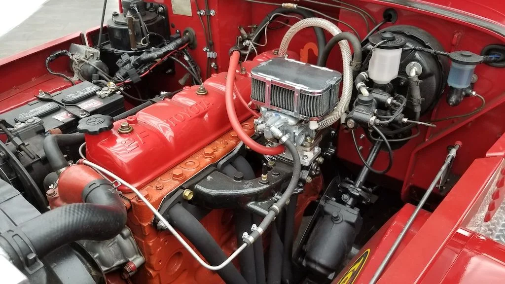

In my search for a TLC FJ 40/45 I keep waffling between a V8 or the 2F. My gut says stick with the horsepower. Especially with AC, which I need to have to keep other family members on board with the truck. I have found several 2F 40s I really like. My question is this: realistically, can the 2F (carb, not fuel injected) with it's limited power really handle the additional rigors of a compressor and keep a cabin cool, especially if it is full soft top and not a hard top? We are in Virginia so the summers can get up there, along with the humidity. Anyone have any experience with this? I am attaching a couple of engine bay shots of some trucks I have recently looked at. Seems the room is still limited no matter what drivetrain is used, at least to some degree. Thanks!

Cool...I really want to keep my options open as to tops, engine, etc. So that helps. And no offense to the older factory AC, but I bet the newer Vintage Air, etc. might even do a better job these days. Thanks
