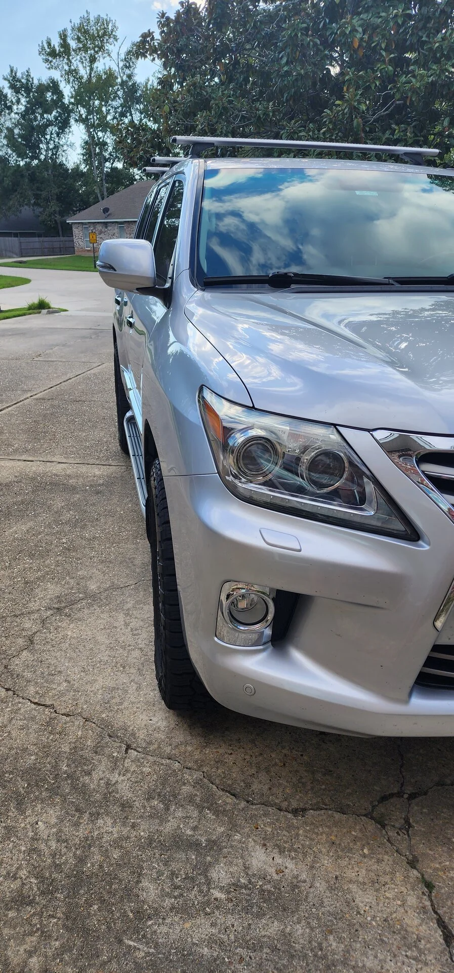

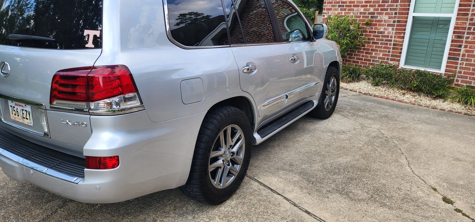

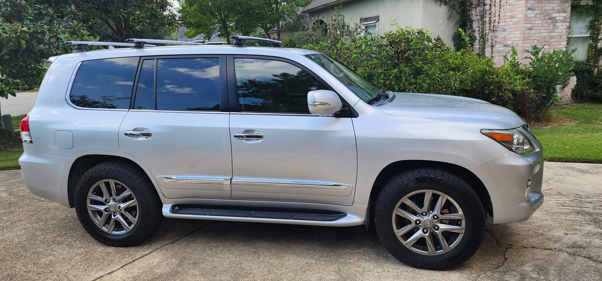

Running them now. Here's pictures. I do run 1in Bora spacers. Also run the equivalent on my wife's 460. Love the tire wouldn't go with anything else.
The LX and GX are strictly over landing and camping rigs. My 80 is my rock crawler.
Do you know if the tires will run without spacers?
They will run fine. They just rub a little more full lock on the driver side. Just have to do a little more trimming on the plastic.
