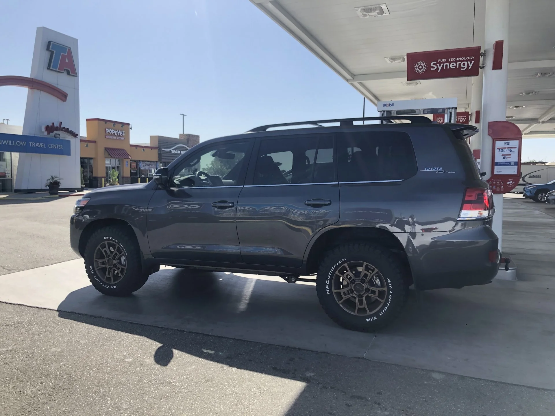

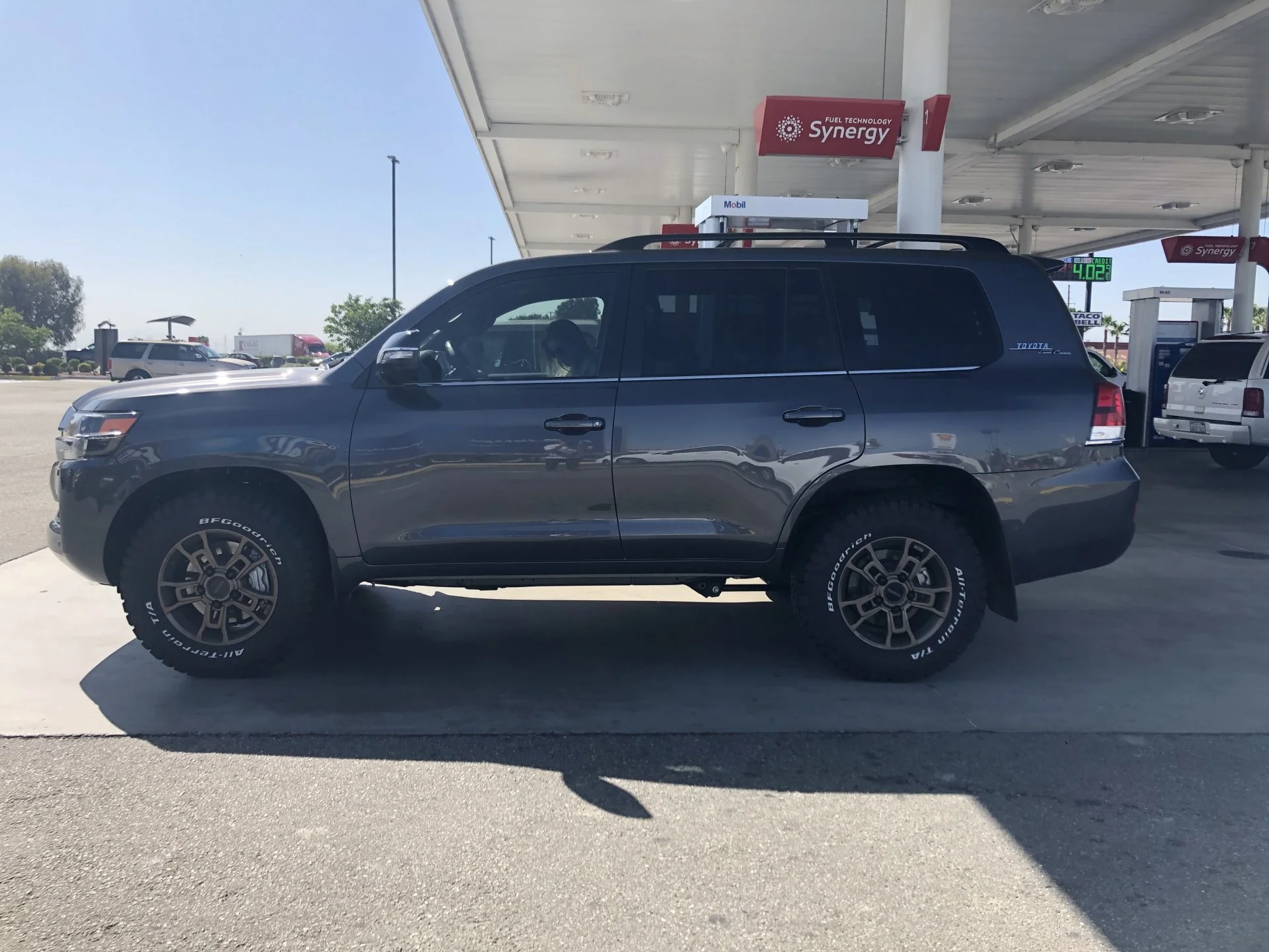

Just drove 1200 miles down to LA, mostly doing highway at 70-75mph and averaged about 16-18mpg depending on incline / grade. Best tank was ~18mpg on flats in central California. 16.8mpg combined including some adventuring in the mountains around Ojai and LA traffic. Not bad for the 285/65/18 ko2s.
Can’t wait until my son can get in and out without running boards so I can pop them back off. Truck looks great. How was the ride quality coming down?

Truck looks good! Is your suspension totally stock, or are you running the OEM front spacers?

@thammer62 I thought ride quality was still very good. I'm running them at 41psi cold and they usually warm up to about 44-45psi on the CA highways. It's firmer than the stock Dunlaps but that was to be expected. Still not bad as the KO2s are some of the best riding highway ATs. No noise difference either.
@goodnightnyc and @greynolds The truck's suspension is 100% stock aside from the KO2s. I will probably do front spacers at some point to level out the ride but the rake doesn't look as bad with the wheel wells filled up by larger tires. No rubbing at all, even at full lock and angles.

Yeah, KO2s on the highway are pretty awesome for such an aggressive tread. After 27k miles, mine are still pretty good in the noise department.
