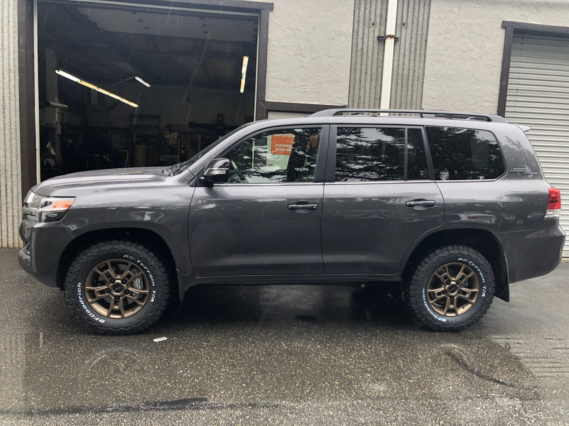

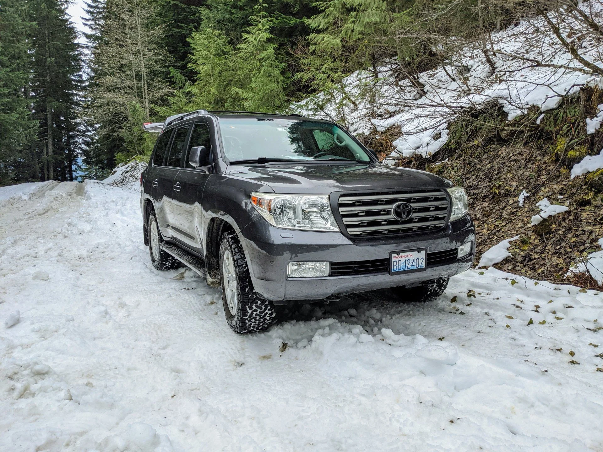

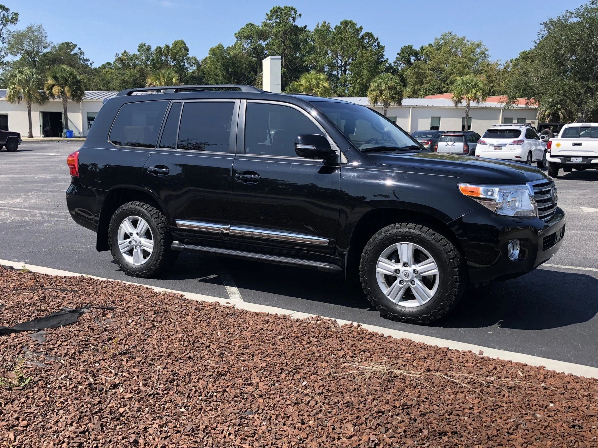

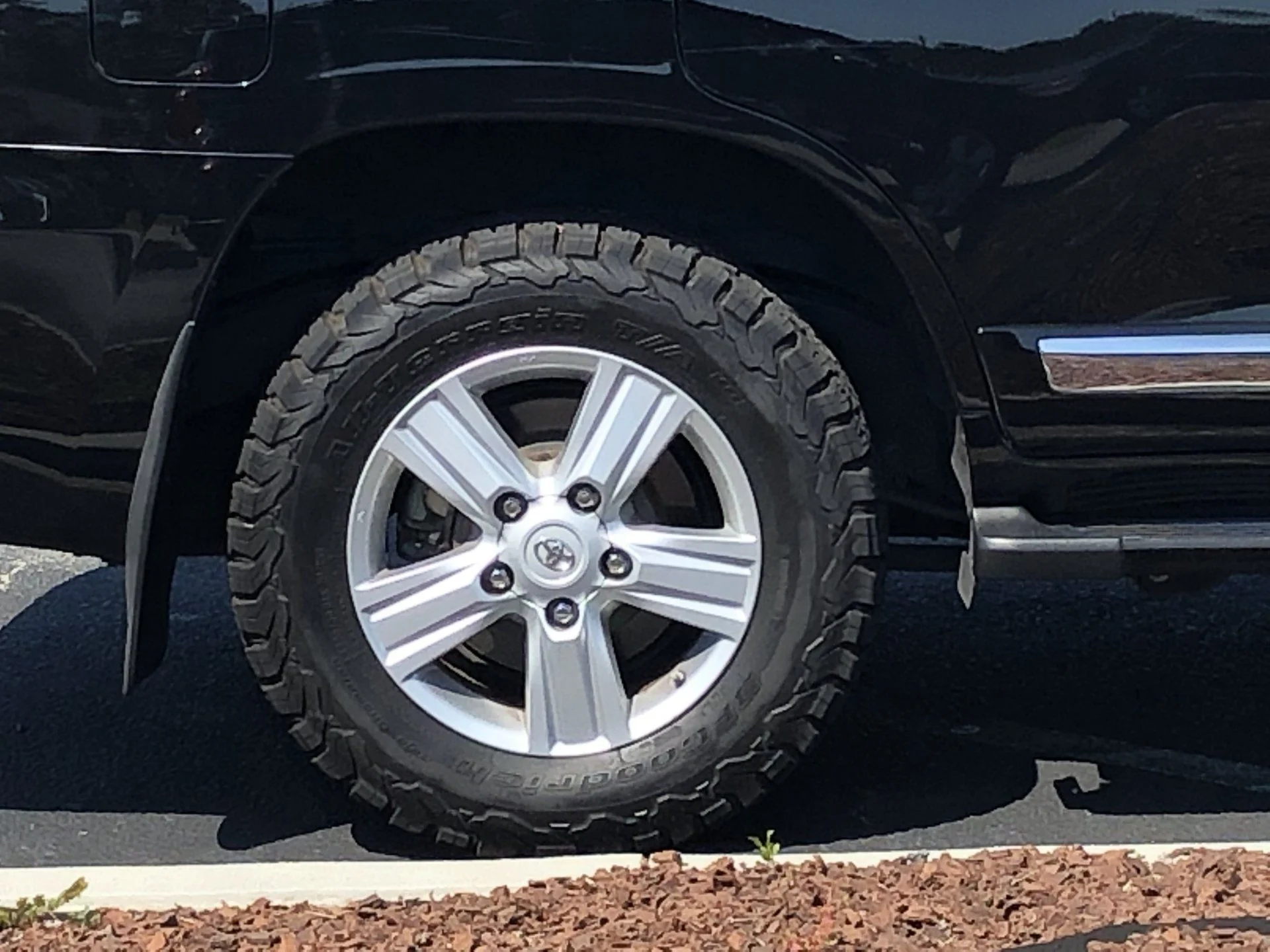

Snapped these stock sized pics a while back as I had the same question - but never saw the owner come out of wherever that was. Hope it helps.

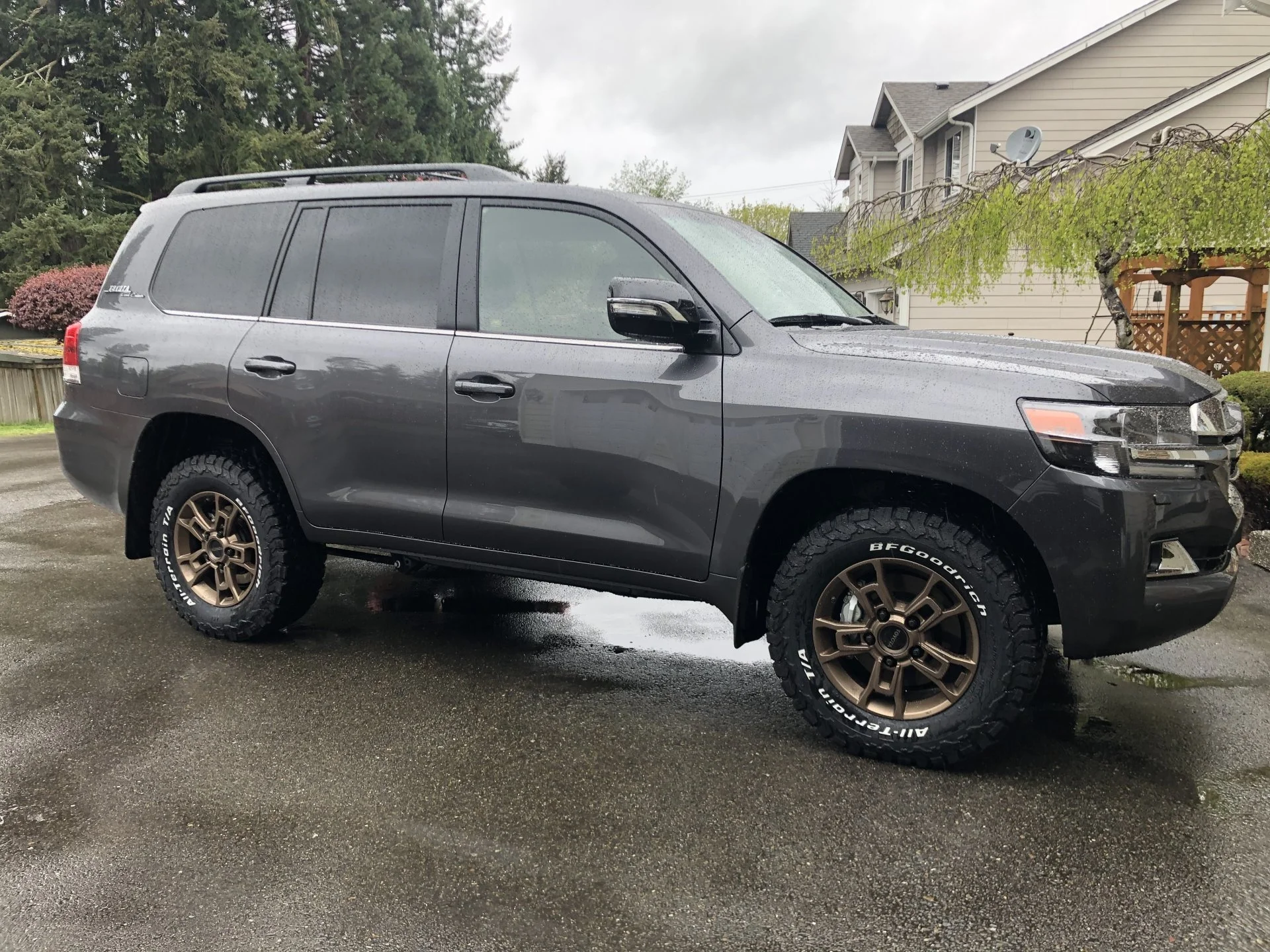

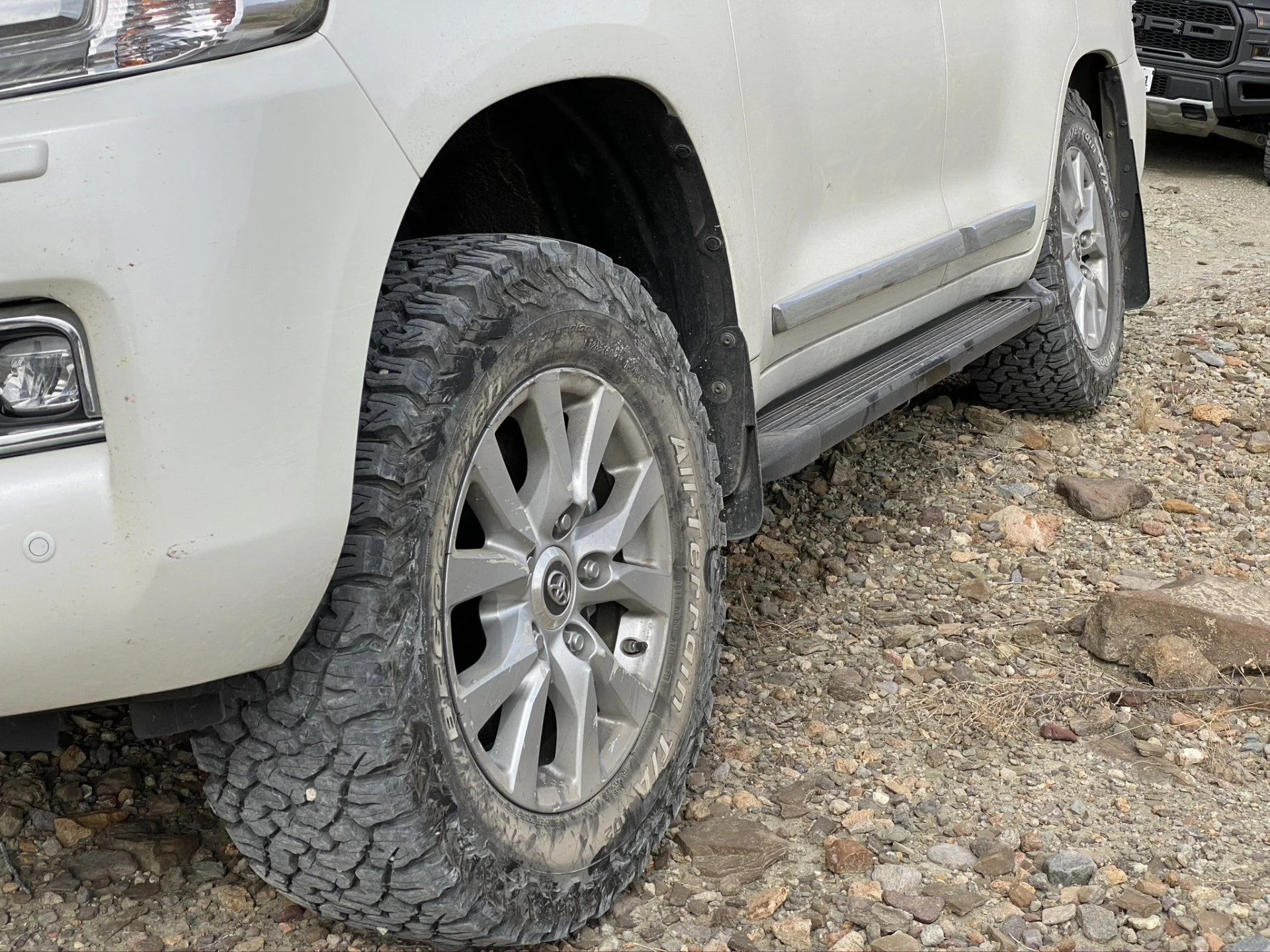

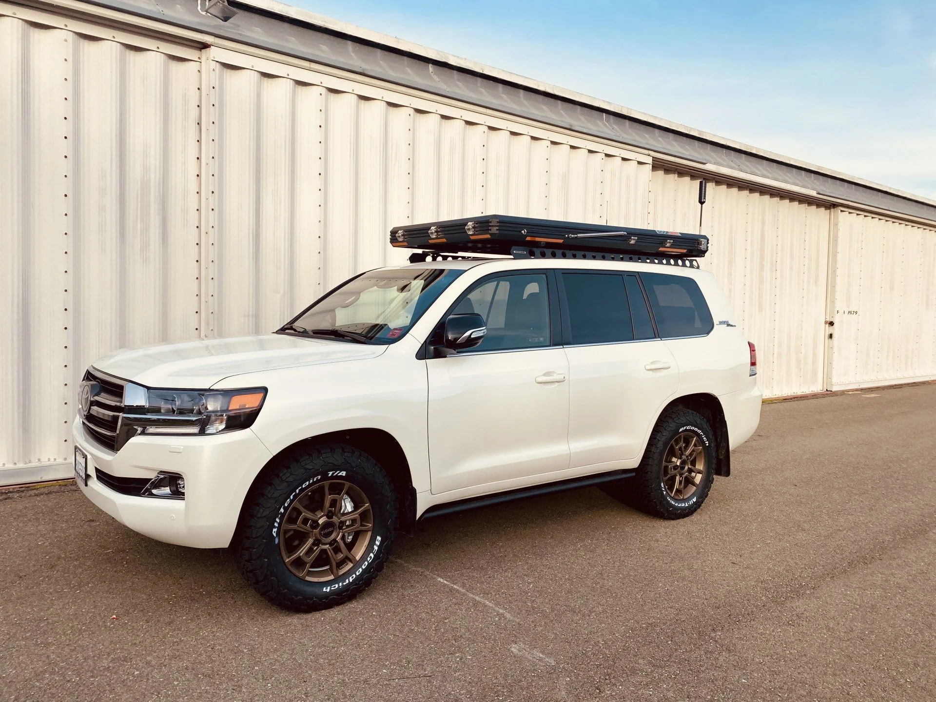

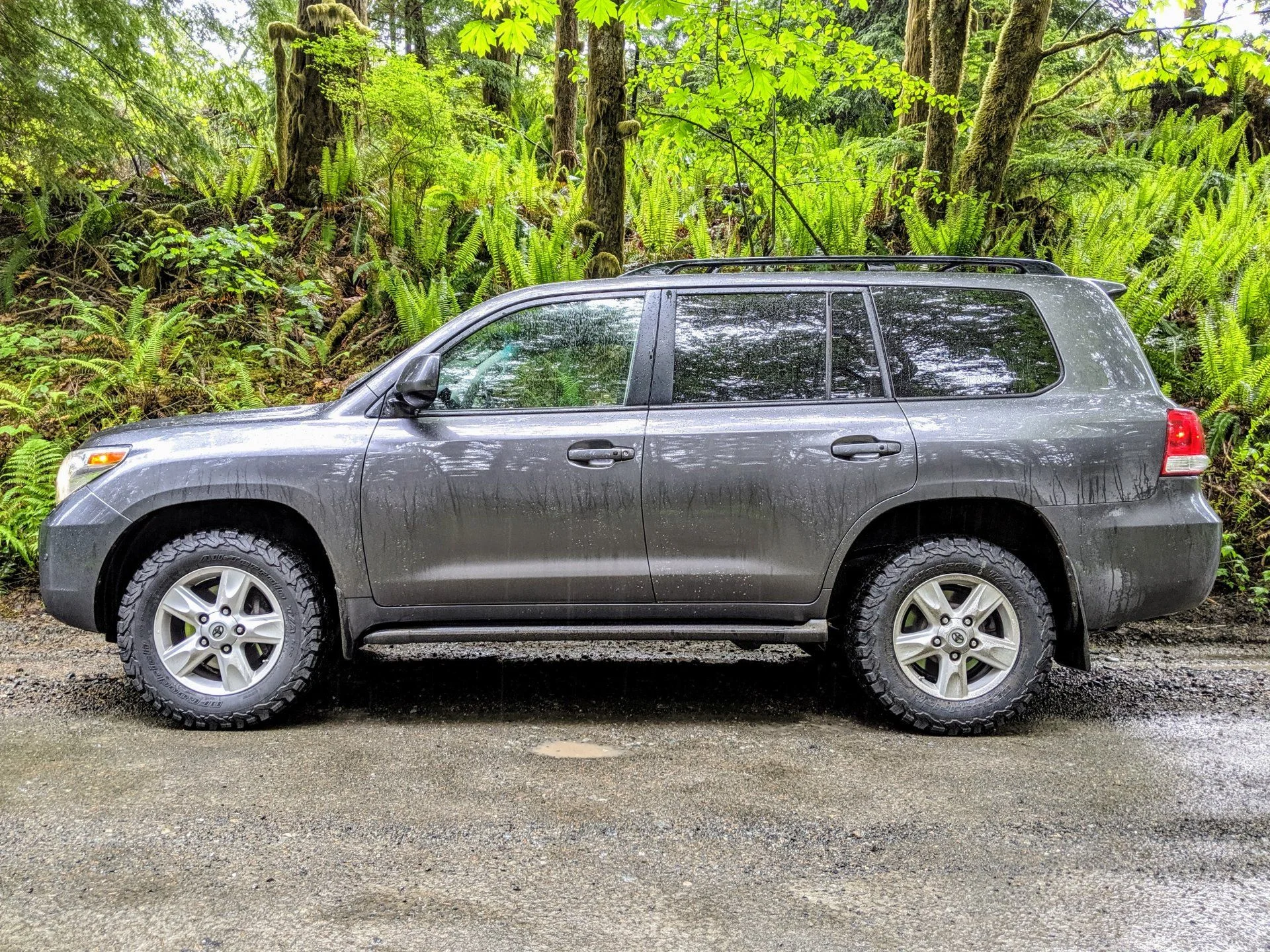

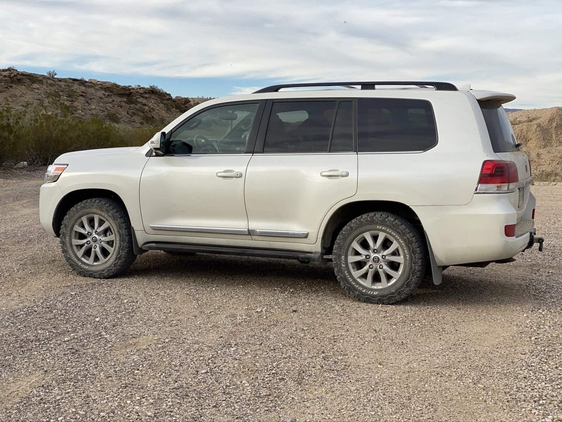

Here are a few of my stock size (285/60/18) KO2s. If I were to do it again, I'd probably go with the 65s but currently on tired original OEM suspension and tow a travel trailer a lot so stayed with the stock size to play it safe.
