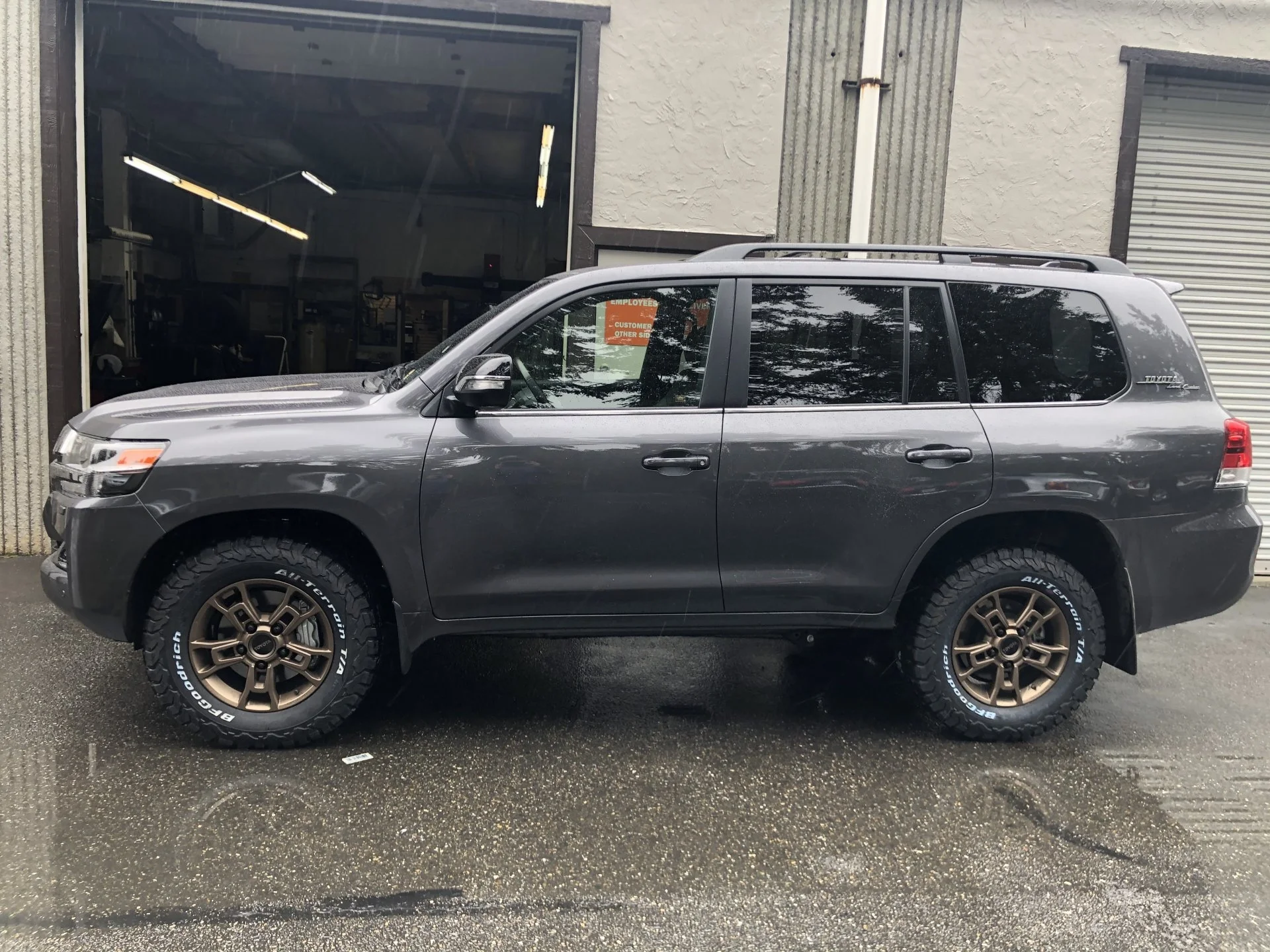

I ultimately ended up deciding on 285/65/18 KO2s because I was able to find them for $250 per tire compared to $305 for the equivalent AT3s. So far so good:

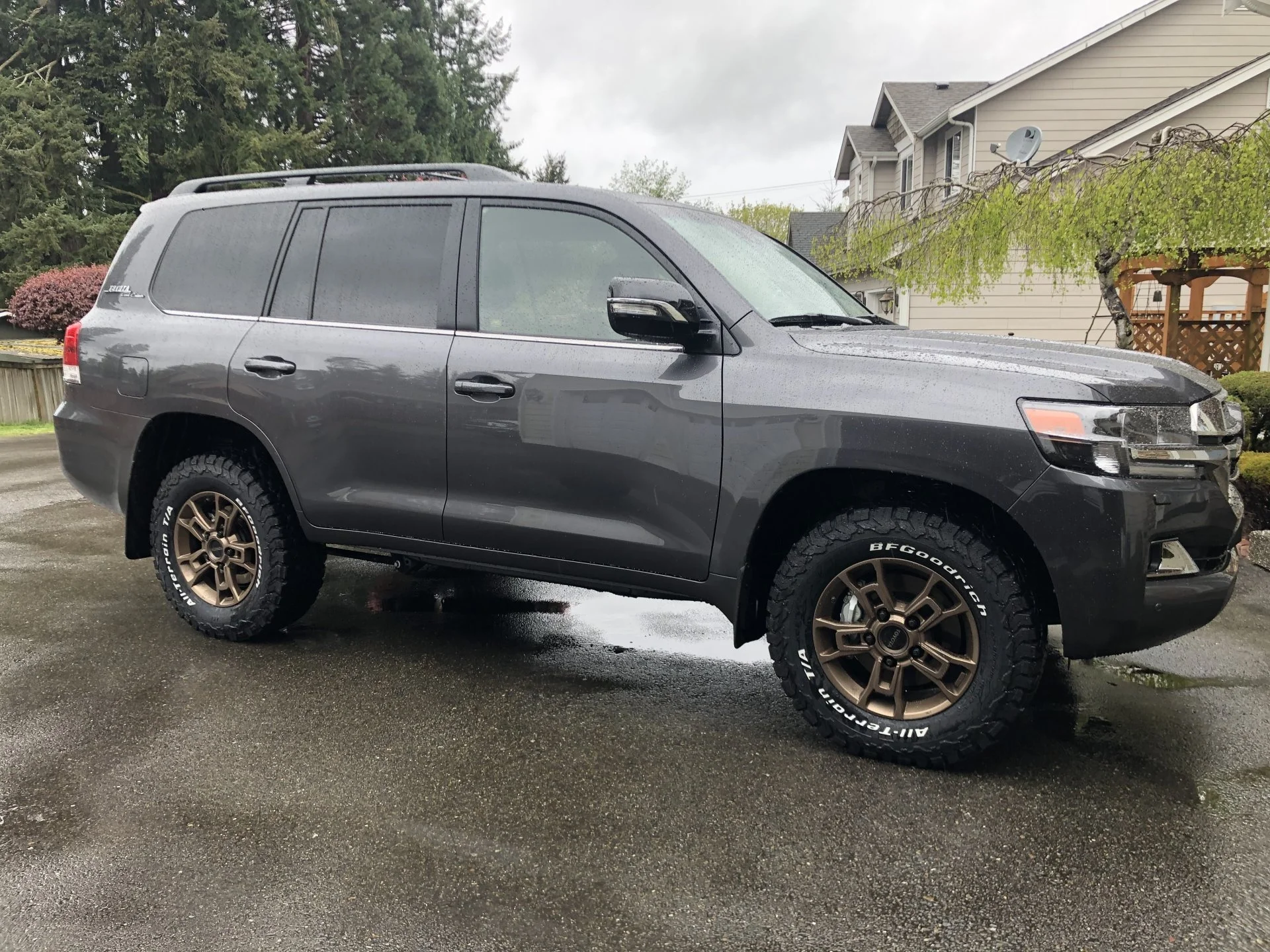

No upgrades needed at all for 285/65/18s on the HE wheels. I did have a minor rub at full lock but the rub went away after I got the car properly aligned. KO2s are great so far (40k+ miles now) and I will be going with KO3s next once more sizes are available.

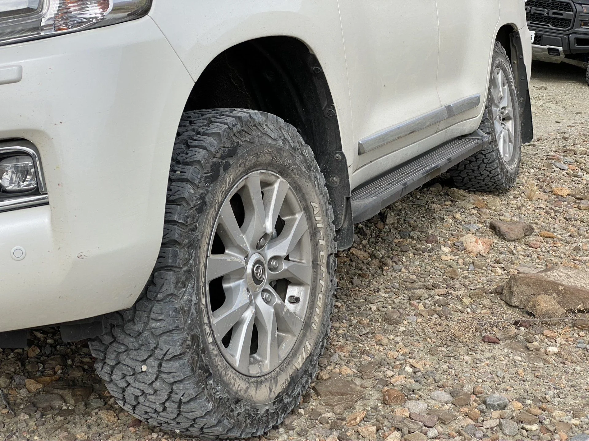

Interesting. When i went to install the 285 65 18s on my stock 200 they rubbed on suspension components at lock. Wasn’t worth a sidewall failure so I immediately went back to stock size.
Hello, just confirming you had rubbing on stock 200 set up, I have a 2016 200 and want to leave it stock, I see lots of 200s with 285/65/18s with no lift, some say no rub and some say they rub. thx!
It definitely rubbed on mine. Wish it didn’t.

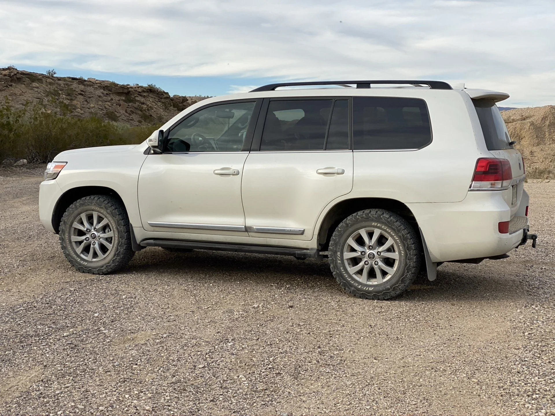

No rubbing from 285/65/18 KO2s on my stock 2018 200
