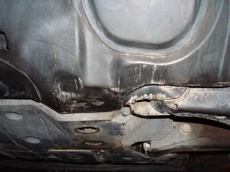

... a half inch of additional clearance. Does that really make a noticeable difference off road? Any input would be appreciated.
A half inch is all this guy would have needed.
attachment.php
So the answer is yes, the additional clearance will make a noticeable difference off road.
