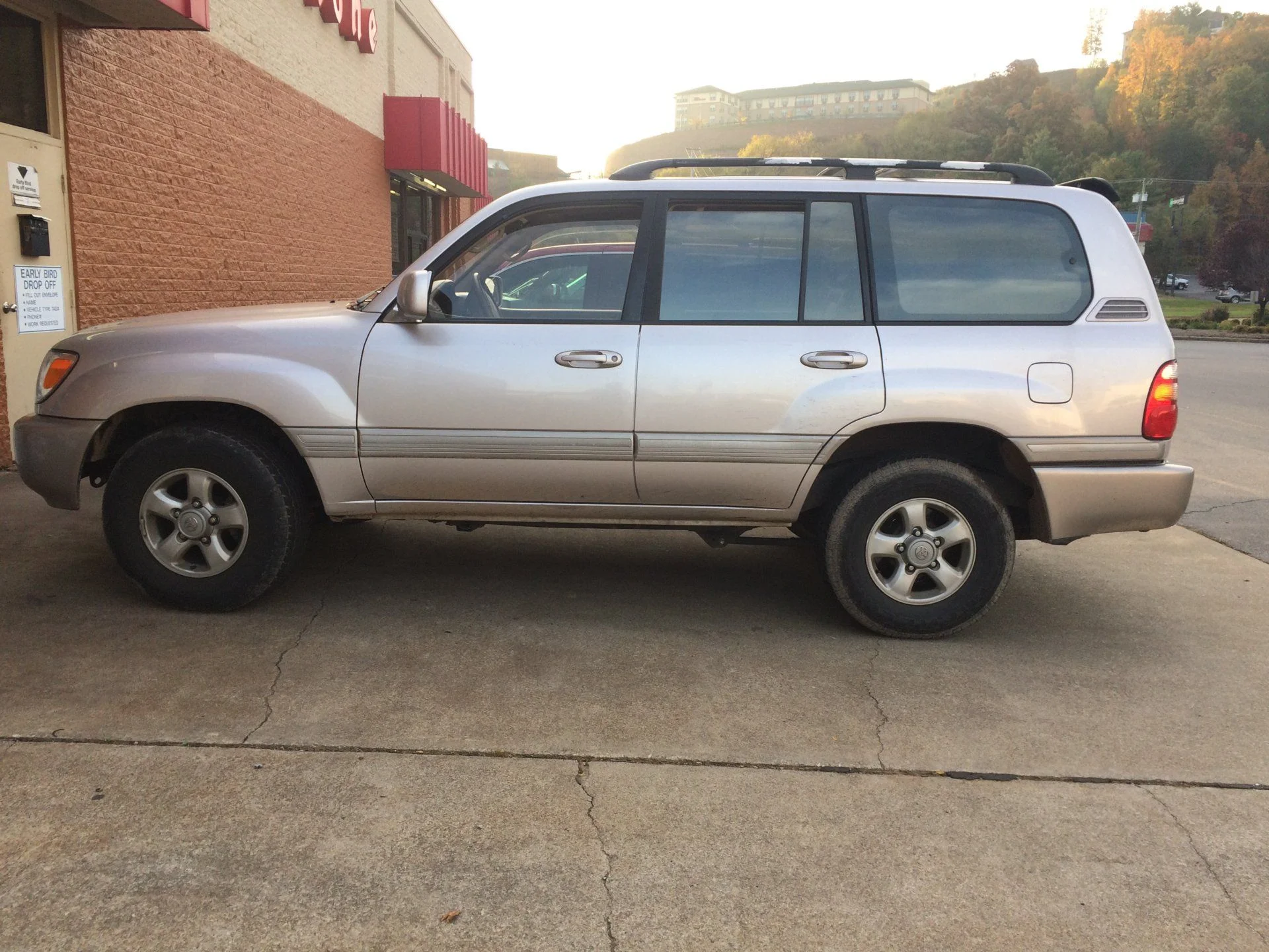

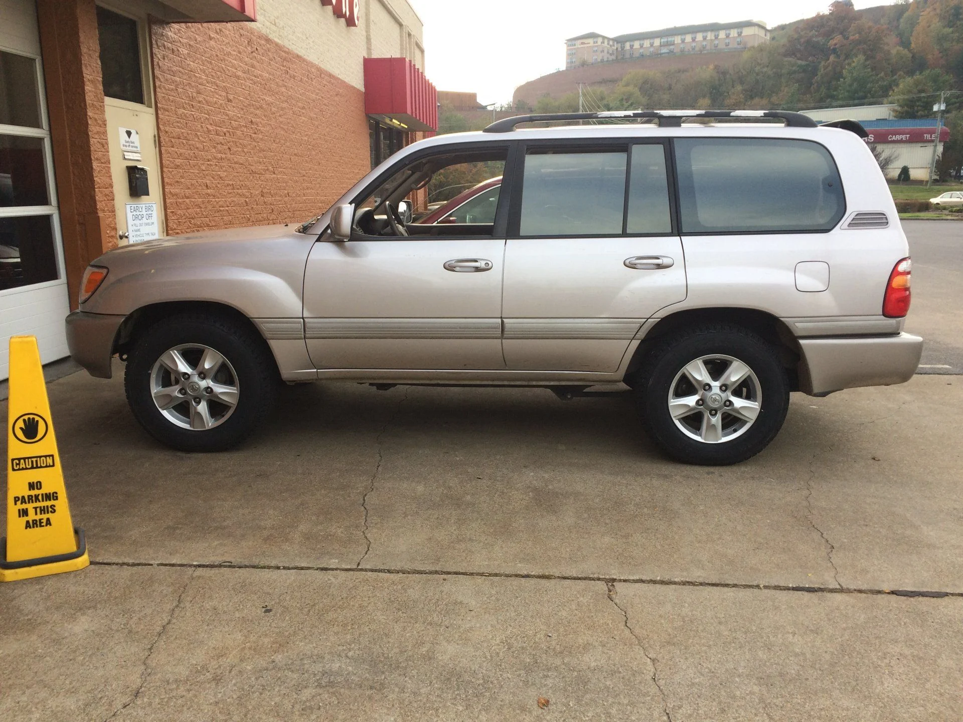

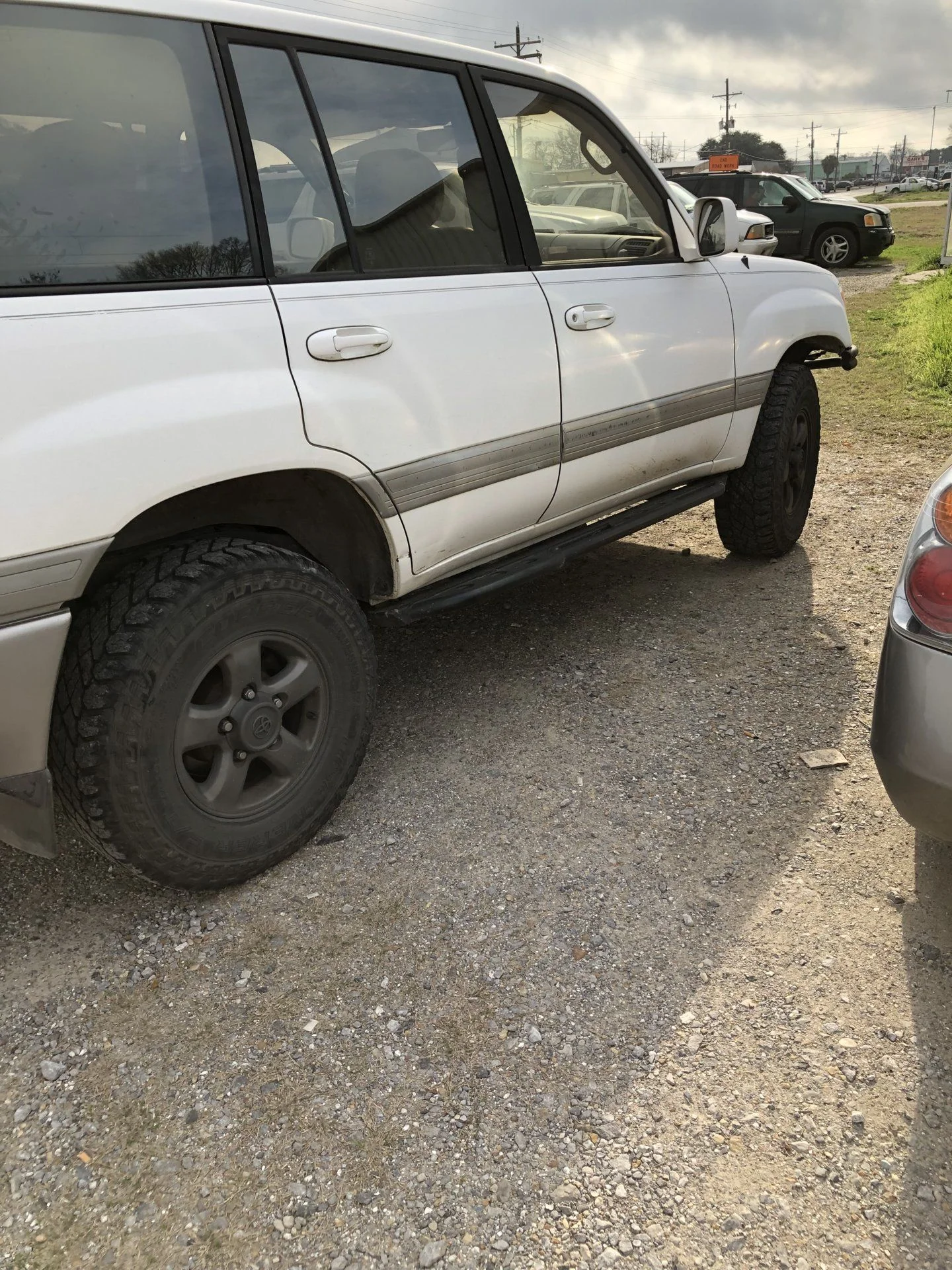

I have a 1999 and the 16 inch rims were nice; however, I located some 18 inch rims from a 2008 Land Cruiser for a good deal. I ended up with five 255/70/18 and the rims for close to what I would have paid for the 16 inch tires alone. I am also running 285/75/16 on my 80 series and when the time comes I am going with tall and skinny instead of the fatty I got now. It really boils down to how you are going to use the truck. I thought I would be an off road God when I first started outfitting my Land Cruiser years ago, now not so much.
On road with max tire pressure it handles well. Offroad I have zero complaints. It handled the easy and medium trails at Uwharrie in Troy, NC very well. I thought I would not like the skinny at first but now I am a convert.

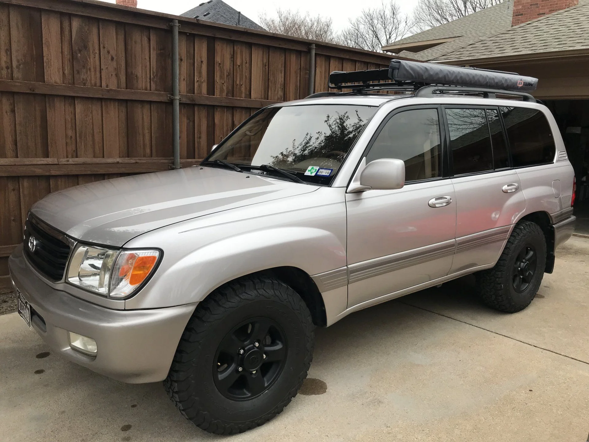

Not 255s, but perhaps relevant if you're looking for feedback on skinny tires vice fat ones--I run 235/85R16s (Cooper Discoverer AT3LT) on 16x6 rims. Handles incredibly well on the highway--I feel like it's even better than with the 275/60R18s it had on it. And these are great off road so far, aired down to 18 psi. I think 255s on the 16x8 rims would work great. Might be a little crowded in the wheel wells if you don't have any lift at all, though. Mine's stock height, and I think it'd look pretty weird with another 1.5" in tire diameter. . .

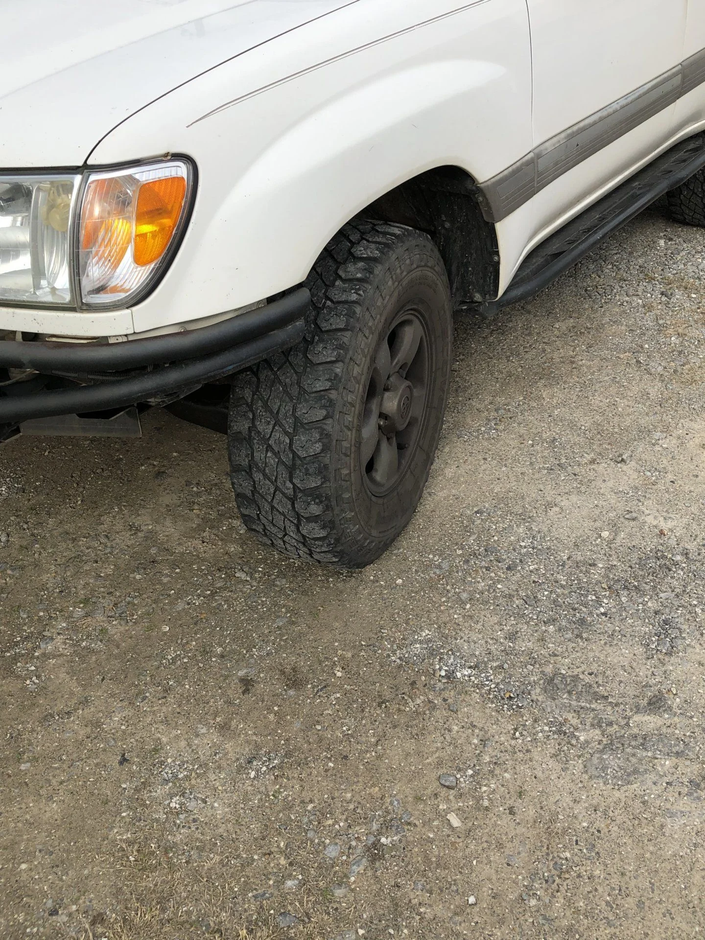

I love my 255/85R16's (Toyo M-55) that I have on one of my 100's. They have been the best tires I have ever purchased. LONG lasting and wear really well. Great traction in rain and snow. I think the size is the best size for most surfaces you would run into (excluding mud and rock crawling). They have a great contact patch when aired down. Like mentioned above, it really boils down to what you use your rig for.

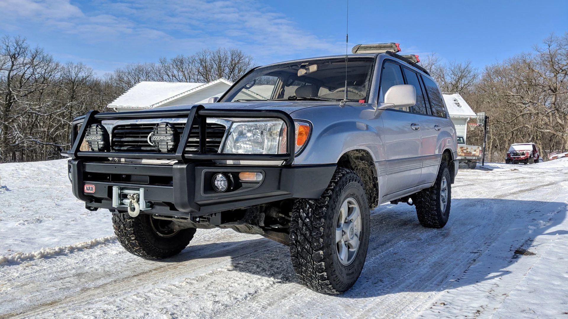

285/75/R16s on original powder coated flat back rims. No lift. No rub and love the ride. Some minor off roading done, nothing crazy, and performed fine.

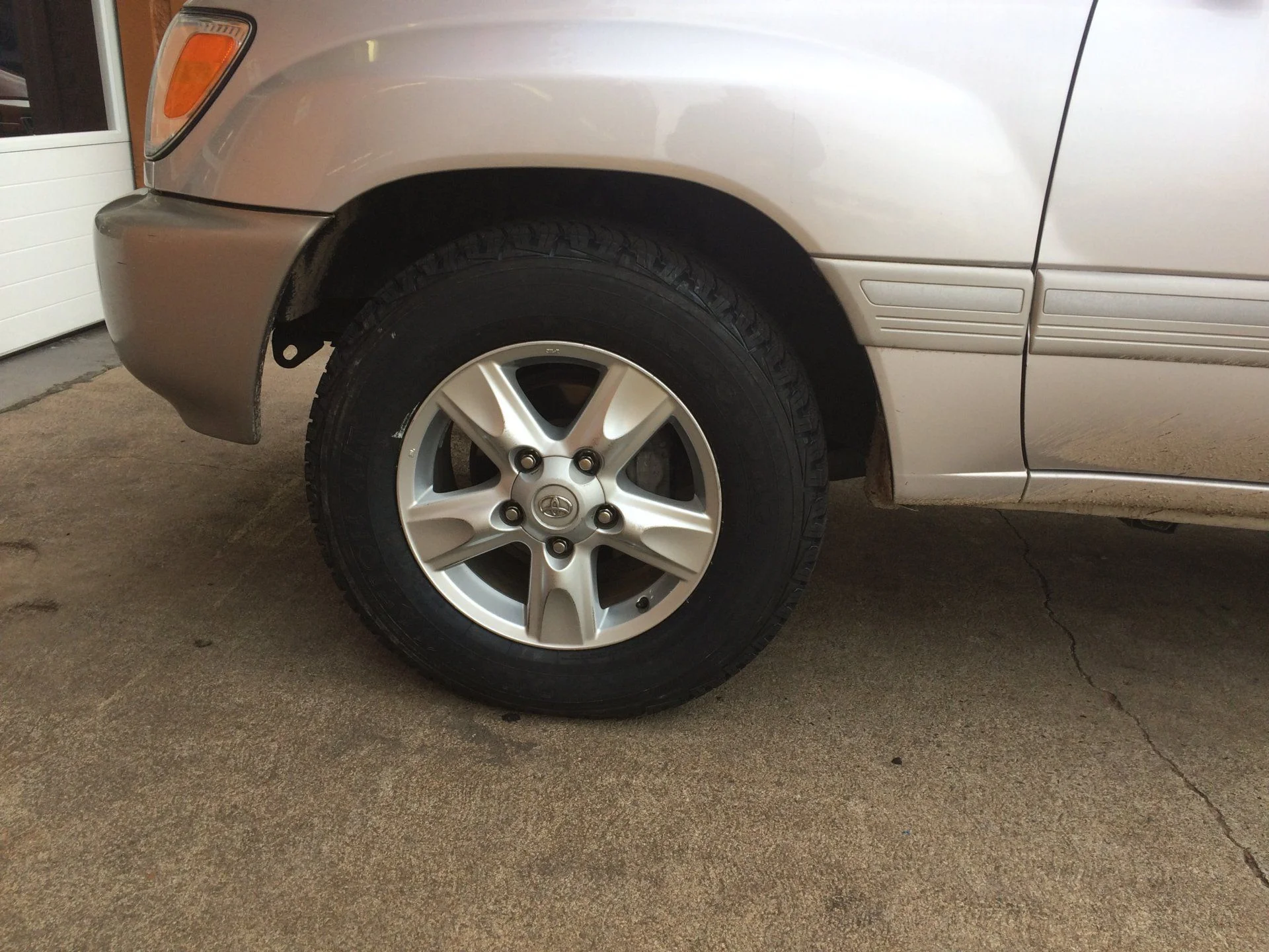

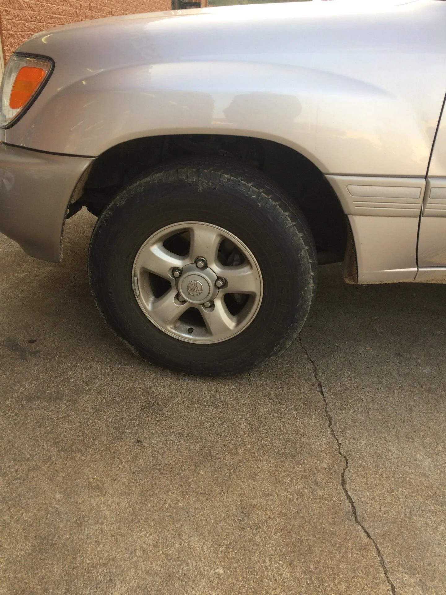

I like the 255/85r16. The size works well on the 100 with stock wheels and no spacers. Switched to the 255's from 265's and only noticed a small drop in mpgs; expected a bigger drop due to the taller profile. I have not noticed the poor handling some claim to have experienced with narrower tires. Fits in the stock spare location and tucks up even further than a stock tire with the spare tire lift. The best part is the tire stays tucked in the fender well. The side of your rig doesn't get blasted with road debris or mud like a wide tire does.
