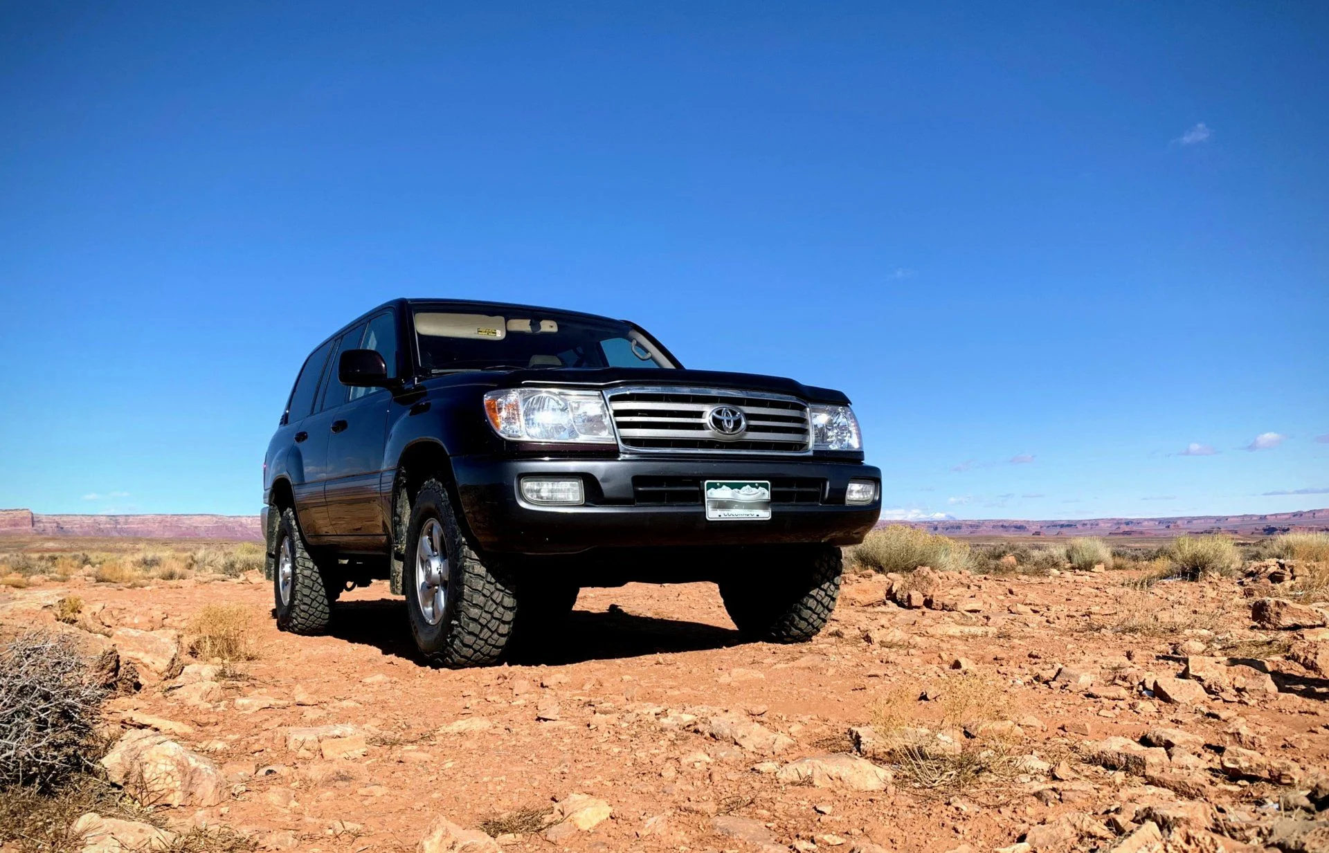

Finally rolling with 255s on the Hundy. Why I took so long to do this is beyond me. I've run every other size. This is the best for the 100, IMNSHO.

Was think of going the 255 86 16 route. Do you have any more pictures from diff angles? I would also probably add a 1.25" spacers.
I'll see what I can find for pics, but IMNSHO there is zero reason to run 1.25" spacers other than a subjectively strange aesthetic. A 33" tire correction over 31" tire original puts us at about 7mm-8mm of additional offset to correct for KPI and OE steering geometry.
