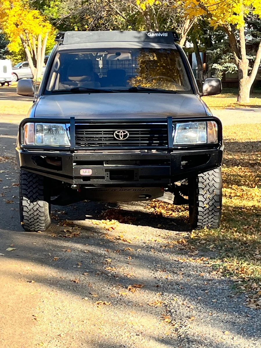

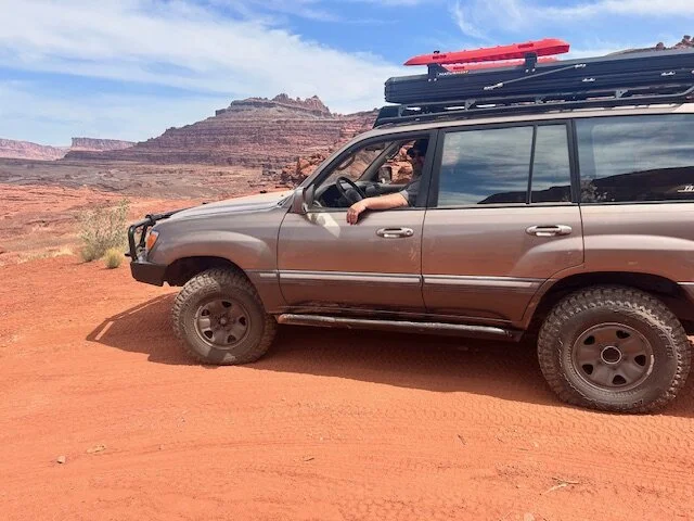

BUMP any 255 80 17 pics?
Bump. Want to see what pizza cutter looks like on the 100

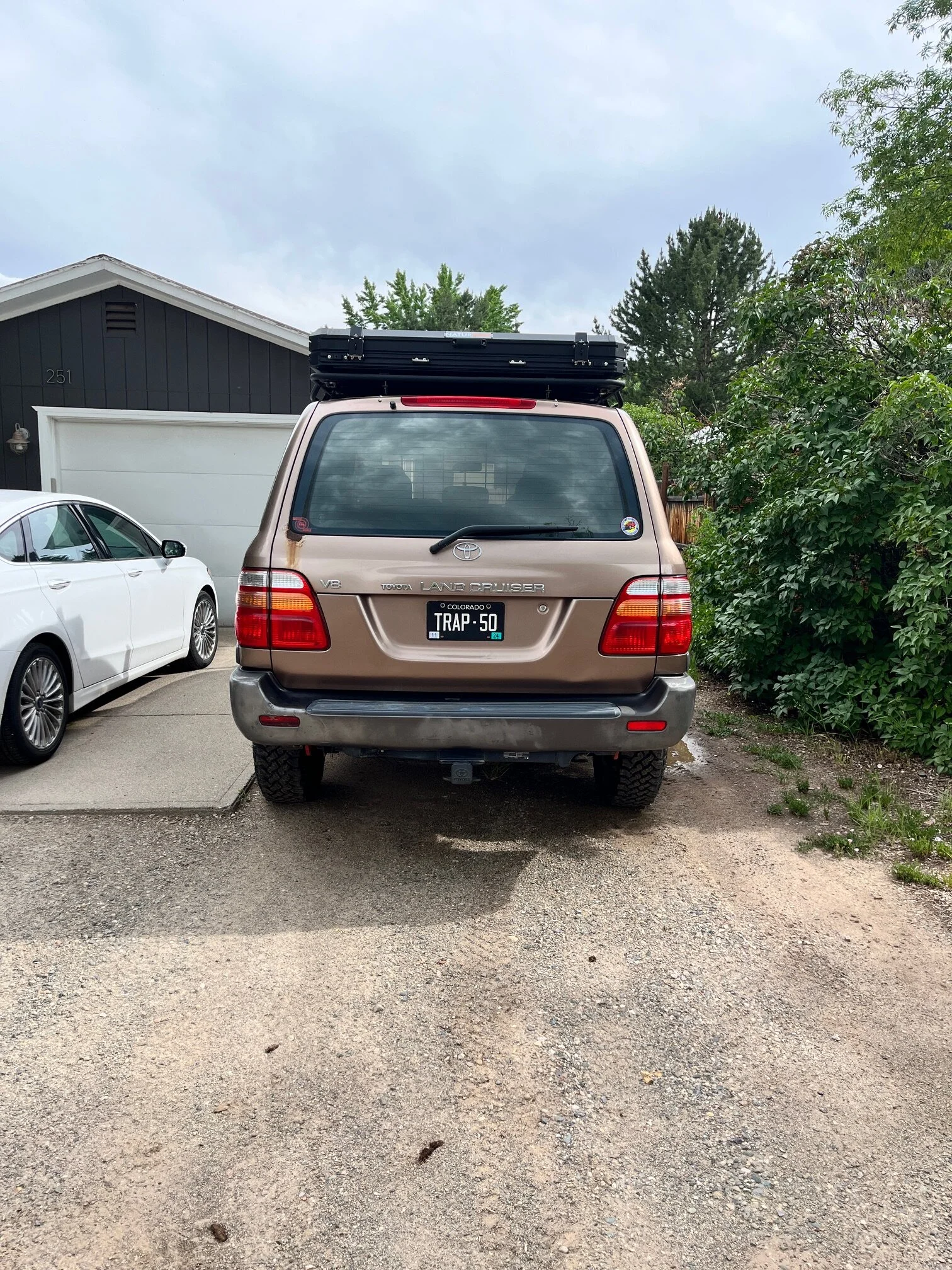

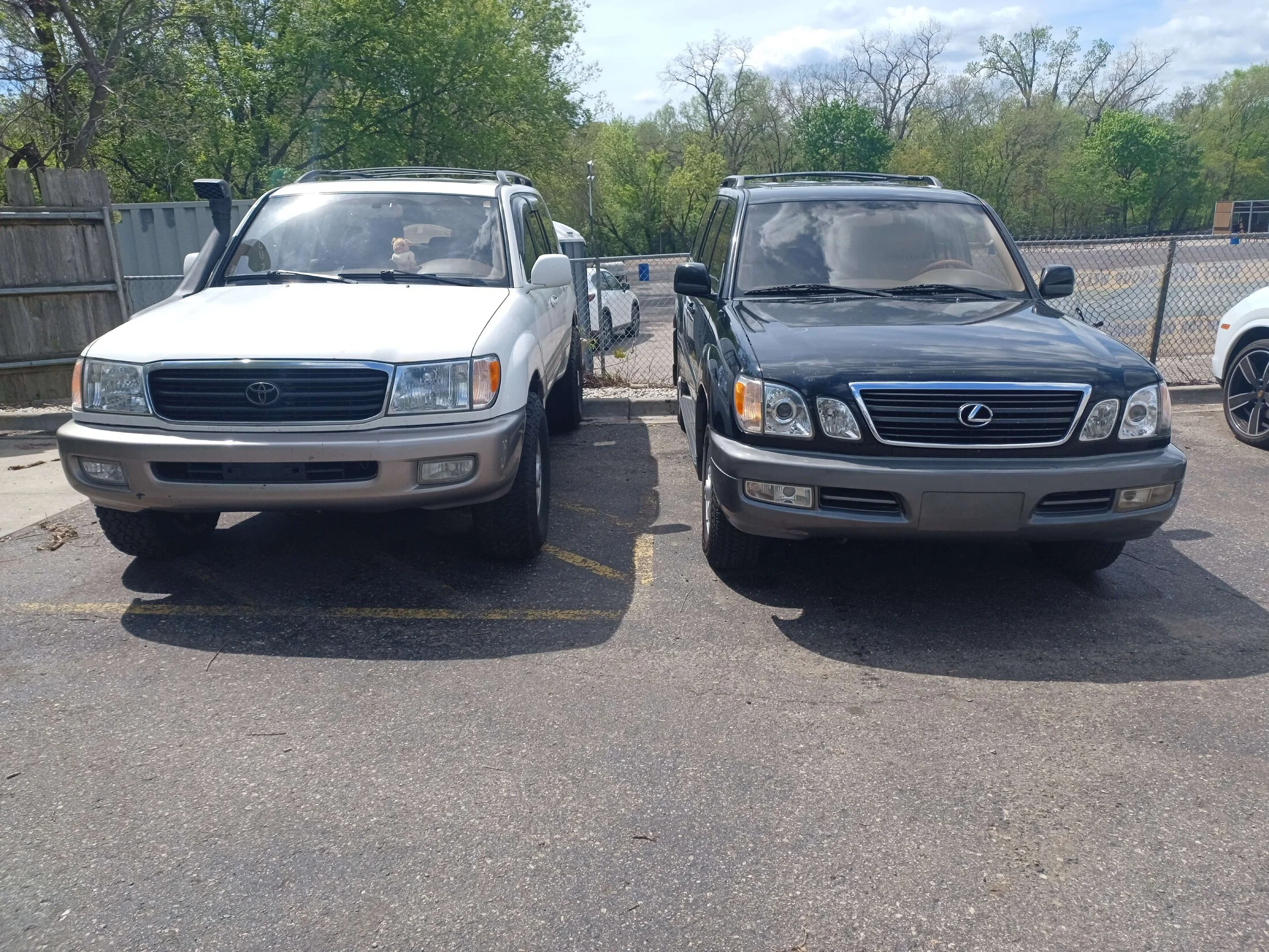

Not 80's but either 70s or 65's on my black one.
They will look very similar to 255/85-16, som have a look at post 19 in this thread:

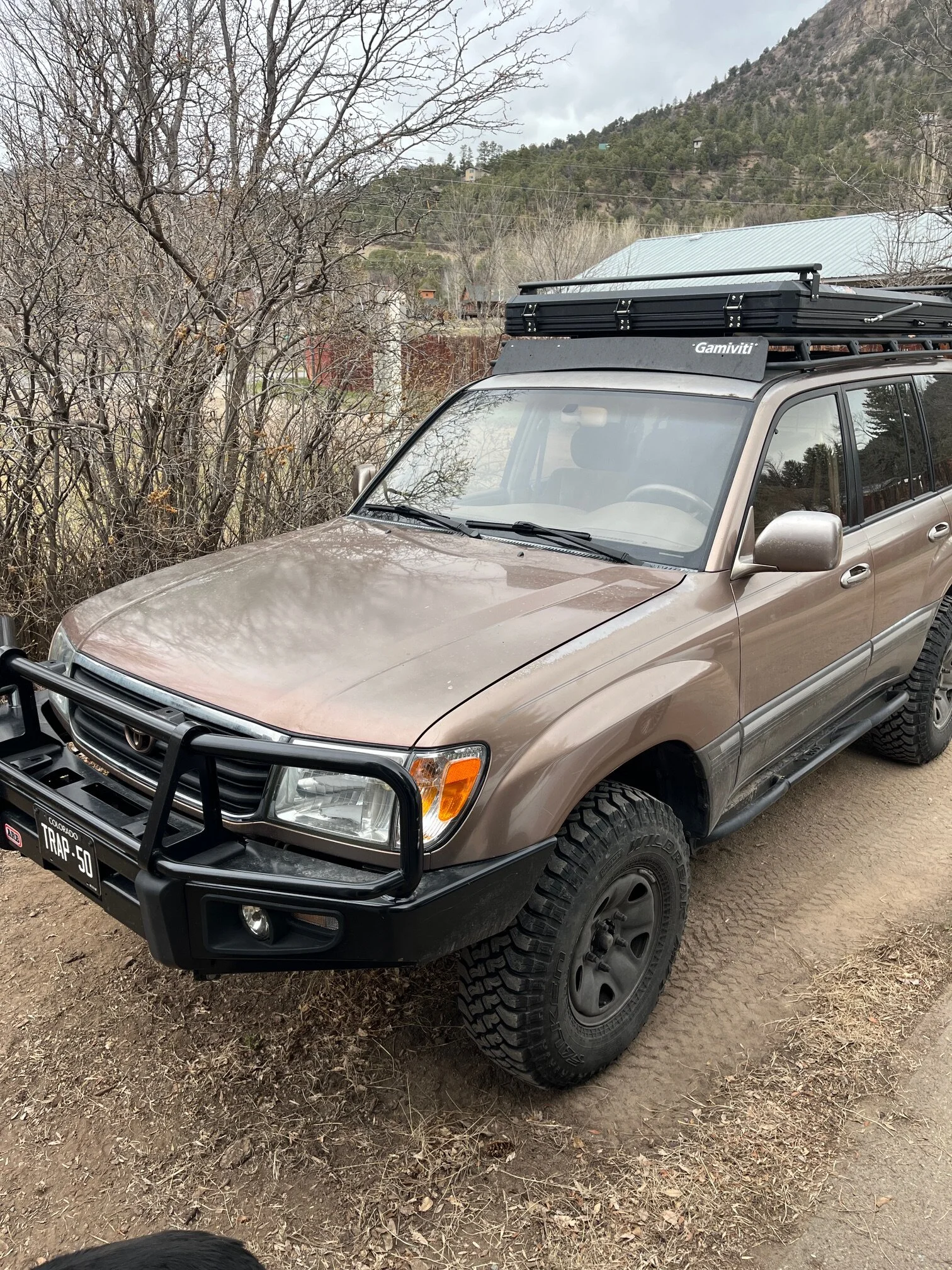

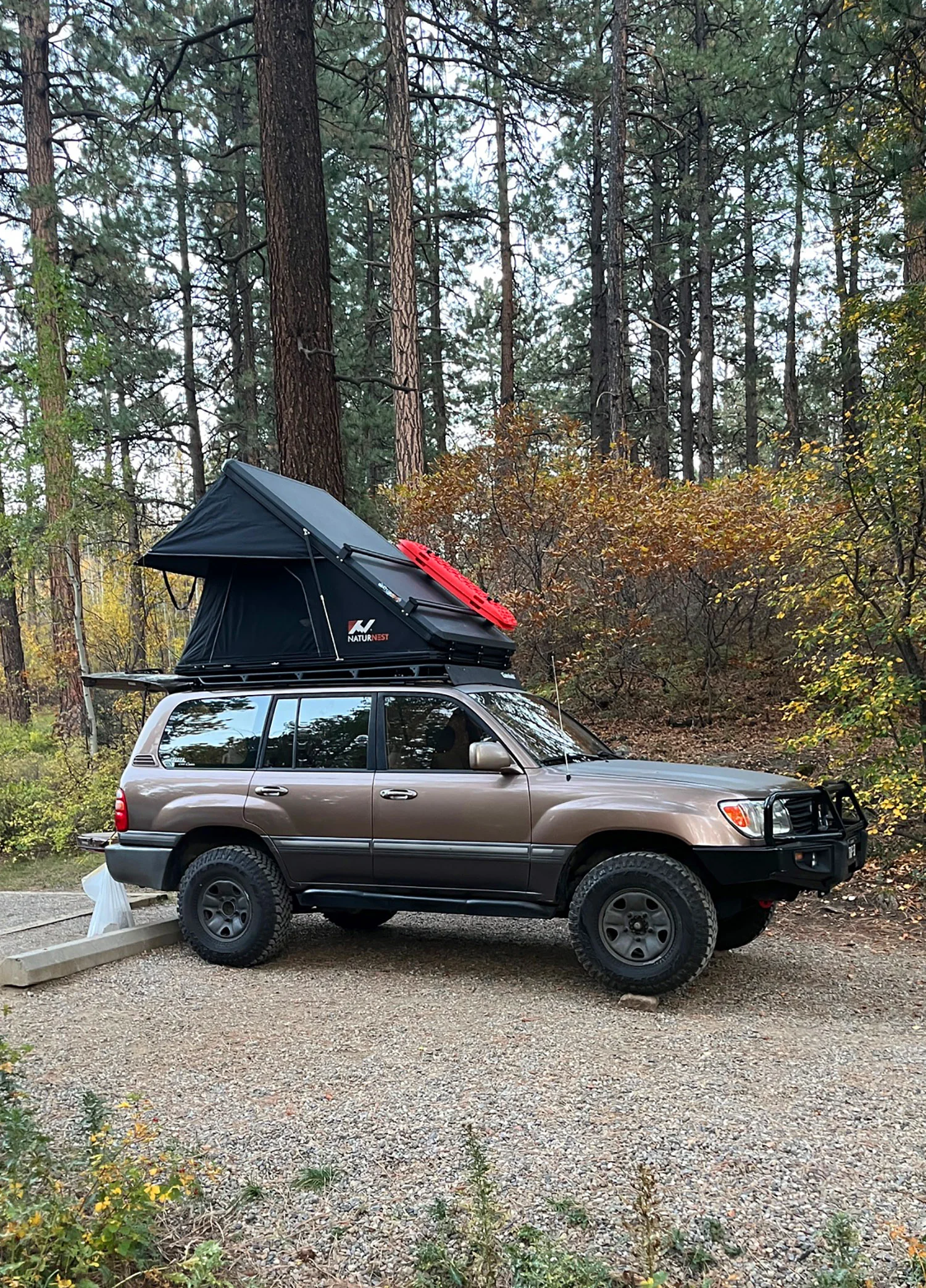

I've got a set of 17" FN's on the way (not due until later this year as it was a recent pre-order), but I'm looking at running a 255/80-17. Currently running 285/75-16's and interested to see if going to a skinnier tire does anything to help fuel economy (I average a measured 10-12mpg daily driving). I know I've seen pics of this size setup around the forum, but don't know that I can quickly find them again, and it will likely be October or so before I have wheels in-hand and can get tires mounted.
I'm very early in shopping for tires, but so far it looks like most 255/80-17 tires I'm finding are C load instead of E. I need to get my truck weighed, because while I've heard people saying they're finding C-load tires to have a more comfortable ride, I'm not sure I'm willing to go to a lighter-rated tire given that I've got steel bumpers (swing out on rear), a 200+ lb rooftop tent, and 5 people+gear to consider when figuring load... along with the potential of hauling a 15' trailer of scrap to the dump once or twice a year. Kinda thinking that sticking with the wider tire may be the most practical for my application.
You aren’t going to solve a weight/mpg problem with tires.
Yeah, it'll help a "little". So little as to not even matter.
Even going from E to regular SL will only net you maybe an extra MPG or 2 in the best cases.
yeah, looking more for a minor all-around improvement by reducing unsprung/rotating mass. the FN wheels should already be decently lighter than my OEM, wouldn't mind going to a lighter tire as well. when I say "measured mpg" I recognize that my odometer is off by as much as 10% [285/75-16, roughly 33" currently], and when we took our trip to colorado we peaked on mpg at 17 measured mpg. All that considered, I don't think it's particularly terrible for what I'm asking of it, but it's also bad enough that any minor improvement will help. my normal commute is lots of start/stop, which is about the only area that lighter wheel/tire combo will help efficiency, but the narrower tire can actually hurt rolling resistance depending on the shape of the contact patch, inflation, etc... it's all a series of trade-offs. you're probably right though that I'm worried about pennies and ignoring dollars (so to speak).
