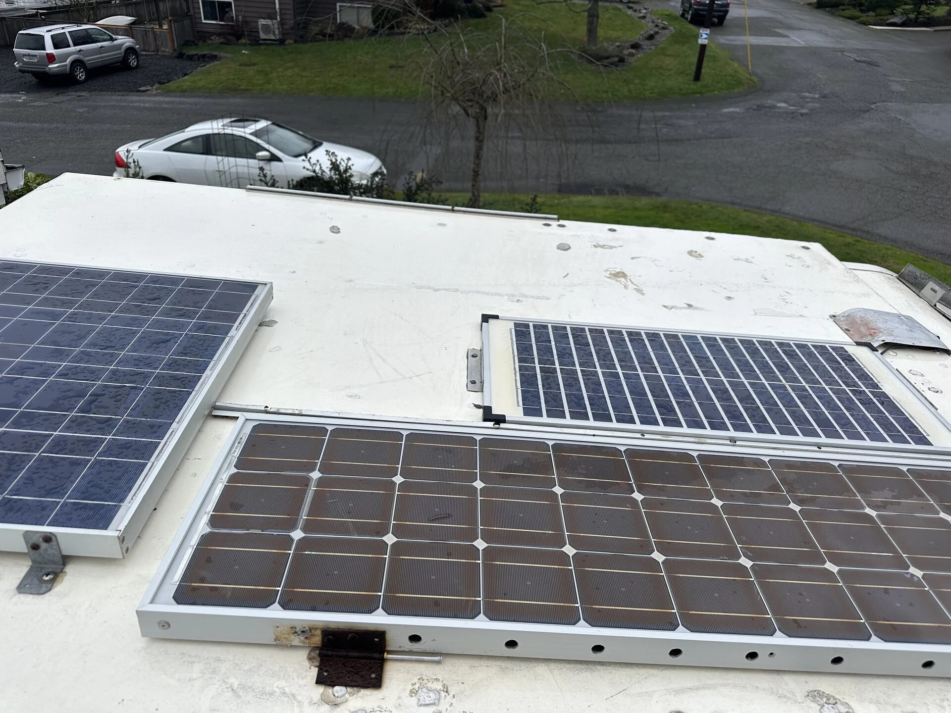

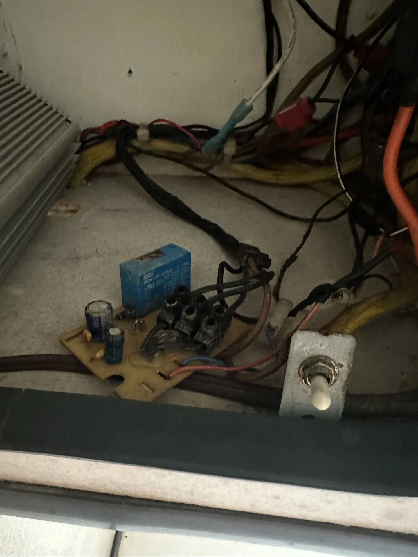

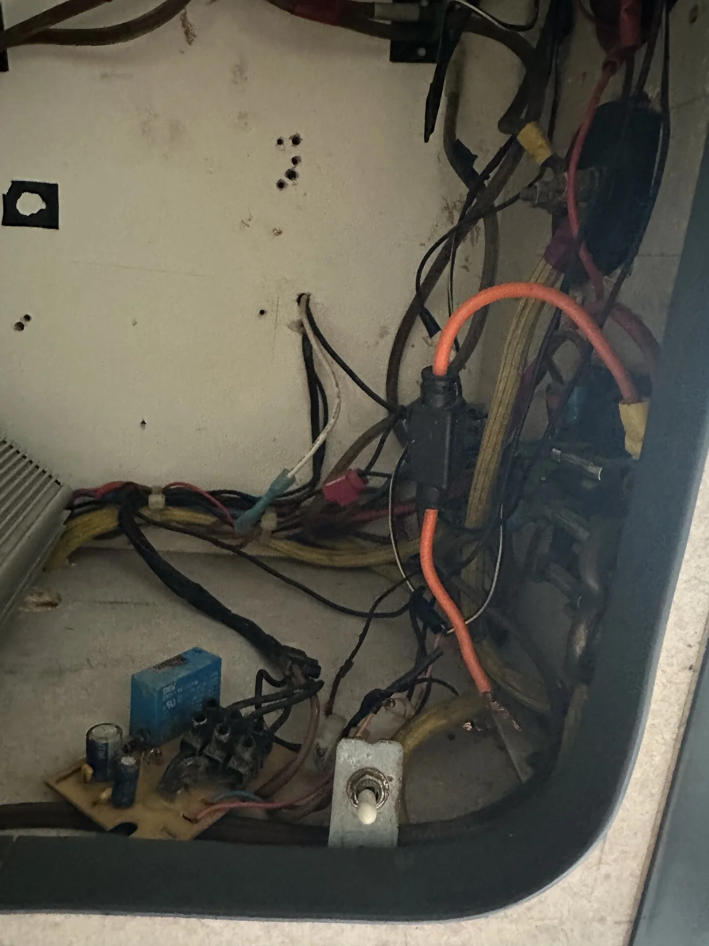

My current set up, is not exactly clean and easy to understand. 4 different size panels , two “house batteries” in different locations
solar controller is functioning great.
I don’t know enough to say the system is antique , Definitely believe that starting over is my best bet for solar.
