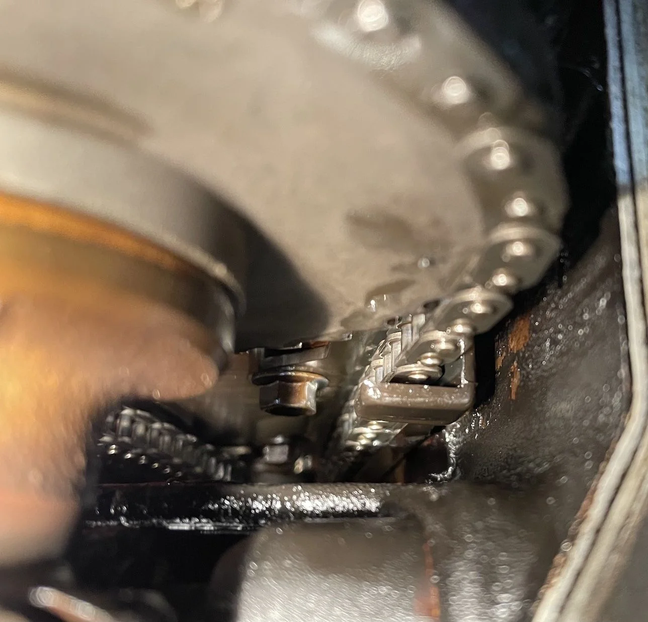

Picked up this 94 Pickup with 22RE recently and don't have experience with the 22RE. It's made a noise since purchase that I thought were bad idler bearings, nope - wouldn't describe it as a rattle or knock, just marble / slight grating sound. Pulled the cover to find the timing chain has been rubbing the bolt heads for the guides.
- 172k miles. timing chain supposedly done at 140k miles
- truck generally runs fine.
- noise isn't there at cold start. thicker oil for the tensioner?
- drivers side guide is loose, but intact
- what would be causing the noise if the guides is present and intact? bolt heads don't seem worn enough to be the primary source of the noise. I assume the tensioner is weak allowing the chain to rub both guides, bolt heads, etc and that could explain the noise?
Anyone with experience on something like this? I suppose I'll be doing the full job this weekend if I can source parts quick enough. Picture of bolt heads with wear attached
Im thinking the only way(s) that would even be possible is a collapsed tensioner and lots fo compression braking.
Overdecked head/block. Wrong chain.
Can you actually push the chain over to the bolt?
Thanks. At TDC the chain was crazy loose on the driver side. Once I manually cranked it another revolution, the drivers side snugged up. Not sure if I rotated something backwards to cause all the looseness, but it was very loose until I turned the crank. Doubt there is any way to test the tensioner without pulling the timing cover? Oil pressure is good according the dash gauge. Don't know anything about the prior timing chain replacement, unfortunately.
Not seeing any way around a full timing cover pull to replace the tensioner. I guess I'll replace the chain and guides as well.. ugh. drop front diff and oil pan seems like the winning vote, correct?
Do a full timing chain replacement with the kit. I looks like the PO didn't tension the chain to snug up the driver's side before tightening every up or the tensioner failed or even got loose. Good luck!

Buttoned it back up w new plugs, PCV, oil and filter. She’s purring now. So nice! Let it warm up and set timing and idle. Will actually drive it tomorrow. So much better!
The old tensioner was a bit “sticky” in that it wasn’t super smooth to push in and pull out. Maybe that was it, or the chain - nothing was 100% obvious at fault.

I’d agree. On that. i just went through the process with only an occasional rattle when warm. Ended up the chain was stretched over one link longer than the new one. My tensioner was toast too. No bolt rubbing but I’m sure thats a “personality” issue with the engine.
