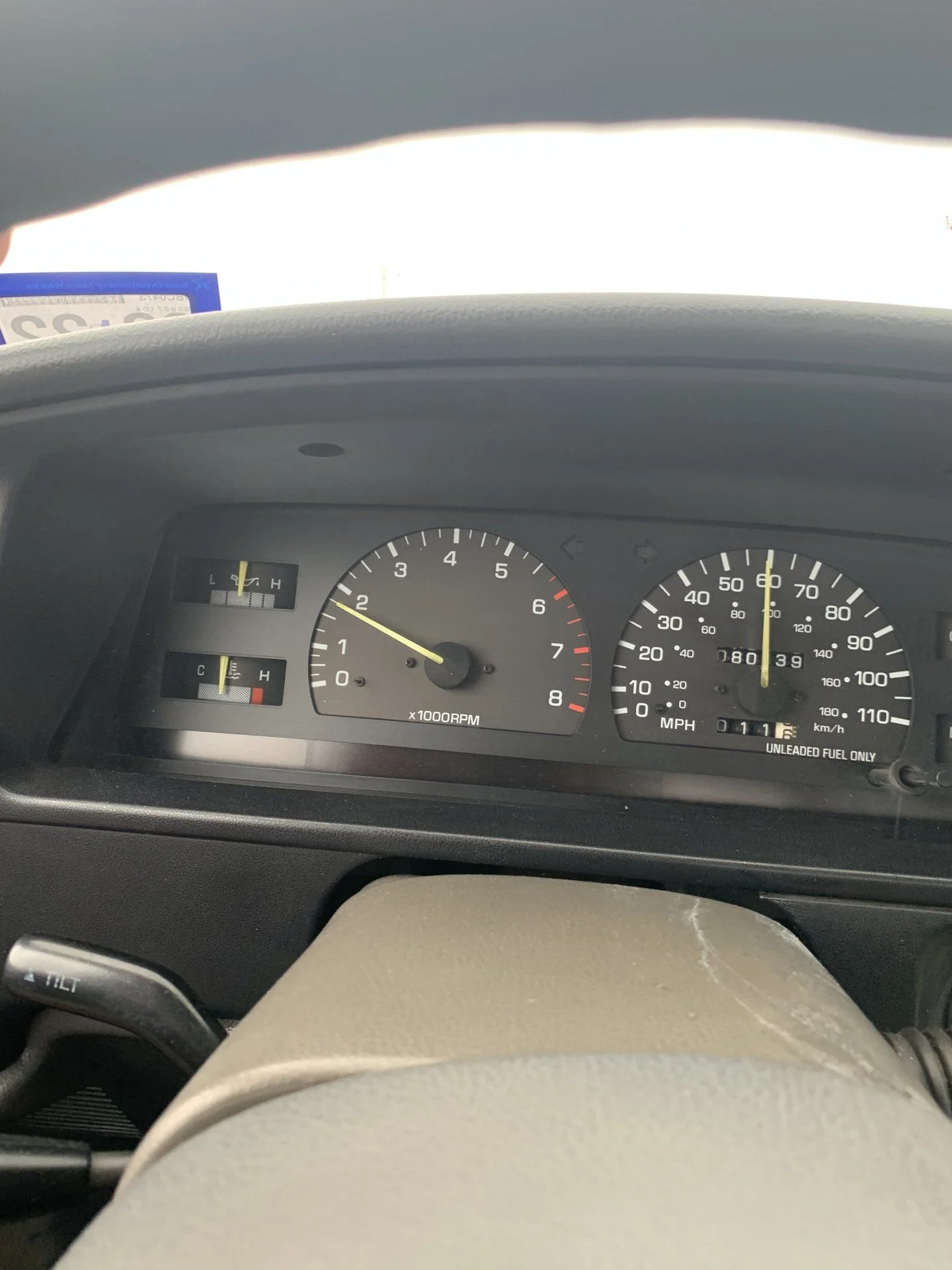

Hey forum,
1992 xtracab , 22re, I believe stock gears , tires 31x10.5Xr15 mt’s
just wanting to double check my rpms at high way speeds.. I know the engine is not a revy one but it seems a bit low .
engine was replaced about 6,000 miles ago through Toyota. I’d like to assume they adjusted the tac etc
I run 2800rpm at 70mph in 5th. 32" tires and 4.56 gears.
'80 with a 20R and 4.37 diffs is designed to run at 3100rpm in 4th(1:1) Tires were H78/15 (28")
The seems right. 5th gear pics?
My s*** runs lower in 5th. Gotta peg out 4th gear on the freeways. No guts no glory.
Thanks for the response ... Yes it’s in 5th.. Coming from the higher Rev’n 2.7 Tacoma has me double checking everything lol .
