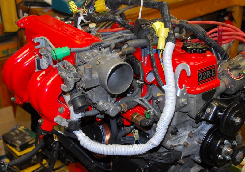

I know the sensors you mean, they are the green and brown ones in this photo. I tested them both when I had them out of the intake while it was out for powdercoating, and they were fine. But I do have a spare set of each, maybe I'll give them a try.

When I did my TB/plenum swap I abandoned the air valve. That is part of my confusion. It was my understanding that the later model TB/plenum setup didn't use the air valve. I've never seen an air valve on a later model 22RE at the boneyard.
The two sensors below the thermostat are the EFI Thermo Sensor, and the Cold Start Time Switch. If you are having cold start issues the problem is probably the CSTS, or the cold start injector. If the issue is while the engine is warm, it's probably the EFI Thermo Sensor. If you have an Air Valve, upgrade to the later model TB/plenum and toss that junk in the trash.

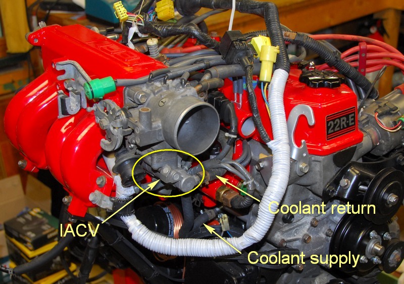

Don't you have a couple of small coolant lines going to the underside of the TB? Those are going to the IACV. As I understand it, the IACV opens a passage that allows air to bypass the throttle plate when the engine is cold. Then, when the coolant warms up, the thermostat in the IACV closes off the passage and the idle comes down.
Did you just bypass this?
Yes I have it. No, I didn't bypass it. What I'm talking about the the monster unit found in the older trucks. It was a separate unit that dangled below and behind the TB. I personally consider what you are showing to be a part of the TB. It's a much simpler and more efficient device that replaced the old Air Flow Valve.
OK, then yes you and I have the same thing. That old stuff is gone on mine too, although I still have it in a box.
