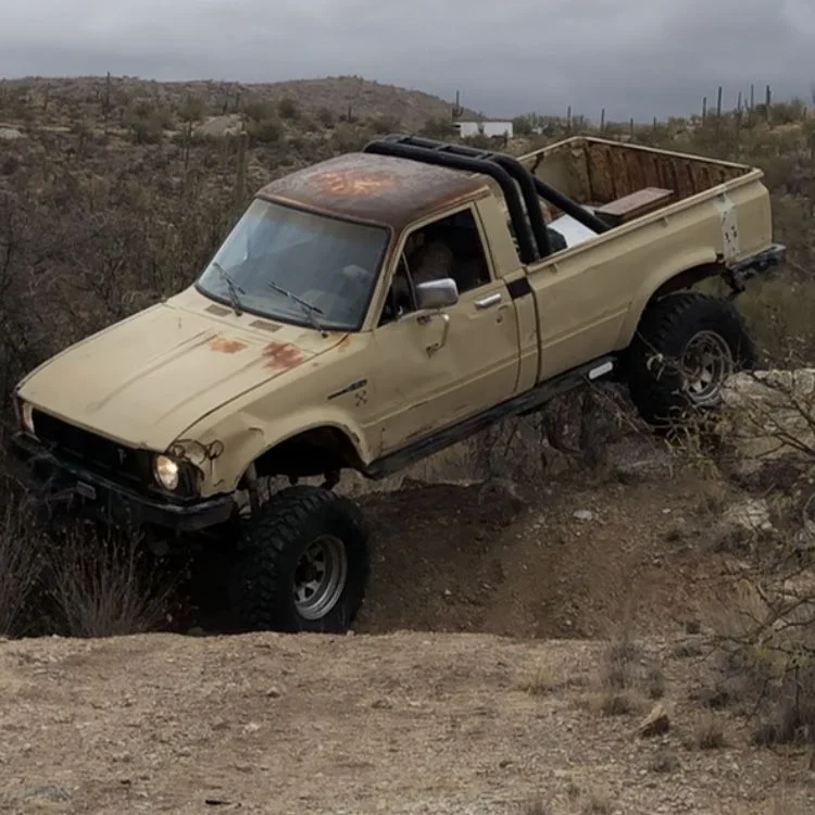

By the way truck in question pictured below:
