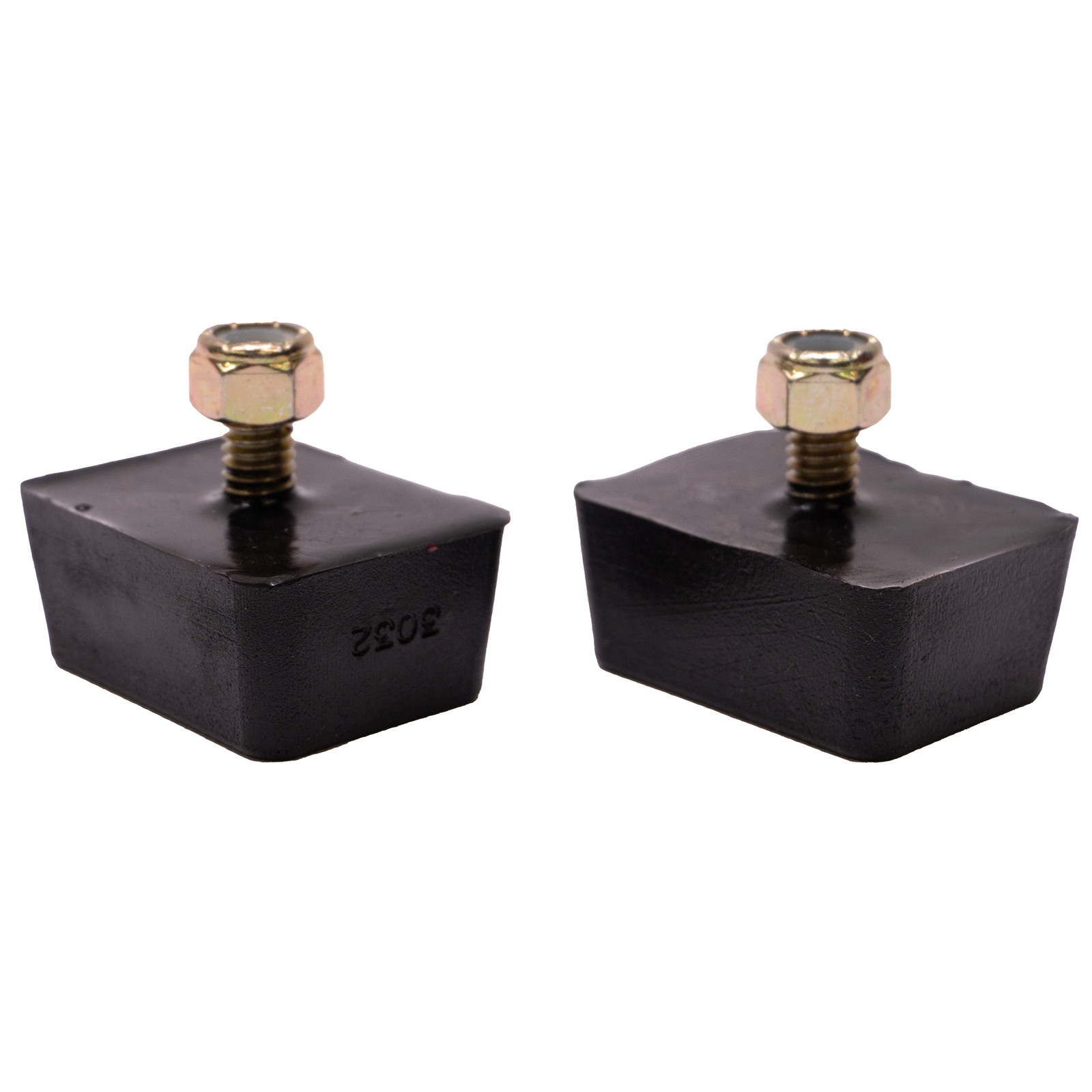

So just wanted to share a recent mod I did to my 4x4 Labs bumper and hopefully it may help some of you out there, especially if you're doing the DIY kit. So I have the 4x4 Labs bumper for my 5th gen 4R. Since it's quite a complicated bumper to design around the 5th gen 4R you can't get a DIY kit for it, they're all pre-built from Labs. I have a love hate relationship with the bumper for a few reasons. It's great off-road due to the clearance, departure angle, and strength. I like the modular swing arms, attachments and that it's relatively simple and lightweight.
However it's a PITA to use for a daily driver for a few reasons. Mainly it centers around the latch and the slam stops. The 7,000lb latch can be a real bear to use at times. With the swing arms clamping onto each other you really want a tight and strong hold. That means it requires a lot of strength and leverage at times to open the latch. My girlfriend simply refuses to use it because she doesn't have the hand/arm strength to operate the latch. The latch strength seems to change with weather and loosening/stretching of the u-bolt over time. You can adjust the jam nut and nylock washer to compensate for this. It is a very delicate balance though and I find myself fiddling with it more than I'd like. Too tight and it's really hard to operate the latch (especially in winter where your fingers and latch are frozen) and too loose where it's easier to use the latch then you get excess wobbling/vibration in the arms and tire carrier. If it's too loose you'll also get metal on metal rattling at the slam stop which can be annoying on the trail.
So I decided to have a local fab shop modify my swing arms and hopefully this will help solve some issues. I had them cut/grind off the metal slam stops on the swing arms and in its place weld a metal tab where I can attach a polyurethane bump stop. I used ruffstuff4x4 bump stop for this. This has helped mitigate some of the issues above. There is no more metal on metal contact, so the swing arms should be really quiet now. Even if there is some vibration between the bump and stopper it'll be silent. You can see in the pictures below where the original metal-metal contact wore down the powder coat on the center stopper as well so this will help prevent that. This has also made adjusting the latch strength a little easier adjust. The bumps are softer which lead to a little more vibration/wobbling in the swing arms so I had to tighten the latch a bit to compensate. But it seems I can fine tune it a little bit better now without worrying about metal rattling. The polyurethane bump is also an easily replaceable part if it ever wears down. I've seen a few people do this to their DIY swing arms and also took the idea from other bumper fab companies for inspiration. I thought I'd share my experience with my mod and my general experience with the normal 4x4 labs latch. I still need to test this out on the trail but so far I'm liking how quiet it is to close the arms and how much easier it is to operate the latch.

I did a similar thing by putting a small piece of rubber on the factory slam stop. Just drilled/tapped a hole in the center, and attached a piece of truck bed mat material initially--that lasted a couple years, now there is a piece of fuel line on there. :D
6 layers of electrical tape on mine. Rattle free. Lol. Fuel hose works too. I finally gave up and tightened the u bolt on mine. Now I just use a little cheater pipe to open and close it.
I thought about doing the same thing but didn't want to drill into the bumper frame itself. Figured if I modded the swing arms and messed up at least those could be replaced easier lol. Another thing I considered was using a 1/2" block/strip of HDPE and using industrial double tape to attach it.
I tried gorilla tape for some time. Eventually it would just wear through and the rattle would come back. I figured it was time for something more permanent lol.
