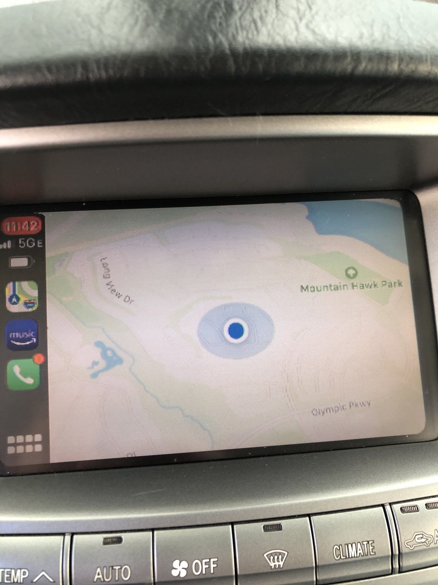

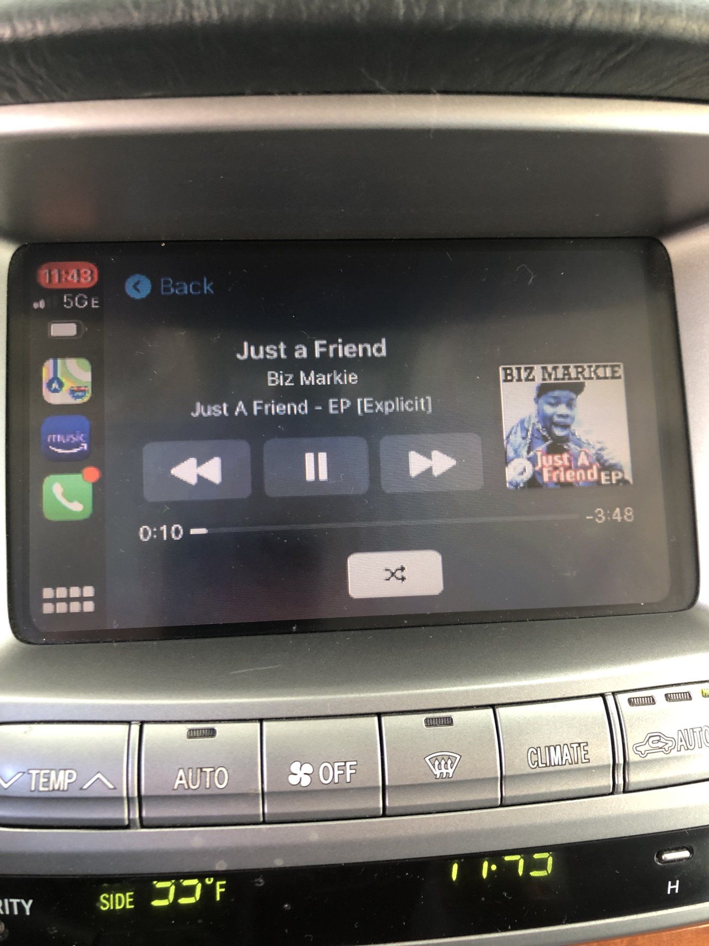

How does it look with the low resolution screen? Can you post pictures from a few different apps - Music/Spotify, apple/google maps, etc?
@Moridinbg have you read much of Einstein's Special Theory of Relativity? He does a great job of explaining how perspective influences everything - not just energy and matter. Like - how long 60 seconds feels when you're holding your breath vs. reading this post. So, when thinking about wireless CarPlay in a 100-Series Land Cruiser, one must consider the perspective. This is a truck that had - at best - a 6-disc CD changer and a cassette deck. Is the screen on par with a 2020 anything? Oh *%#& no. It's like watching a video in 480p vs a 1080p.
The larger graphics are fine - the bigger buttons, icons, maps, etc. It's the text that's not so great. I think that could be improved - larger, different font, etc. And, given the pace at which Grom is sending out significant updates - even during the Coronapocolypse - I'm optimistic.
This is the only pic I have on my phone. If I think about it next time I'm in the truck - which these days is kinda rare - I'll shoot a few pics of the individual apps.

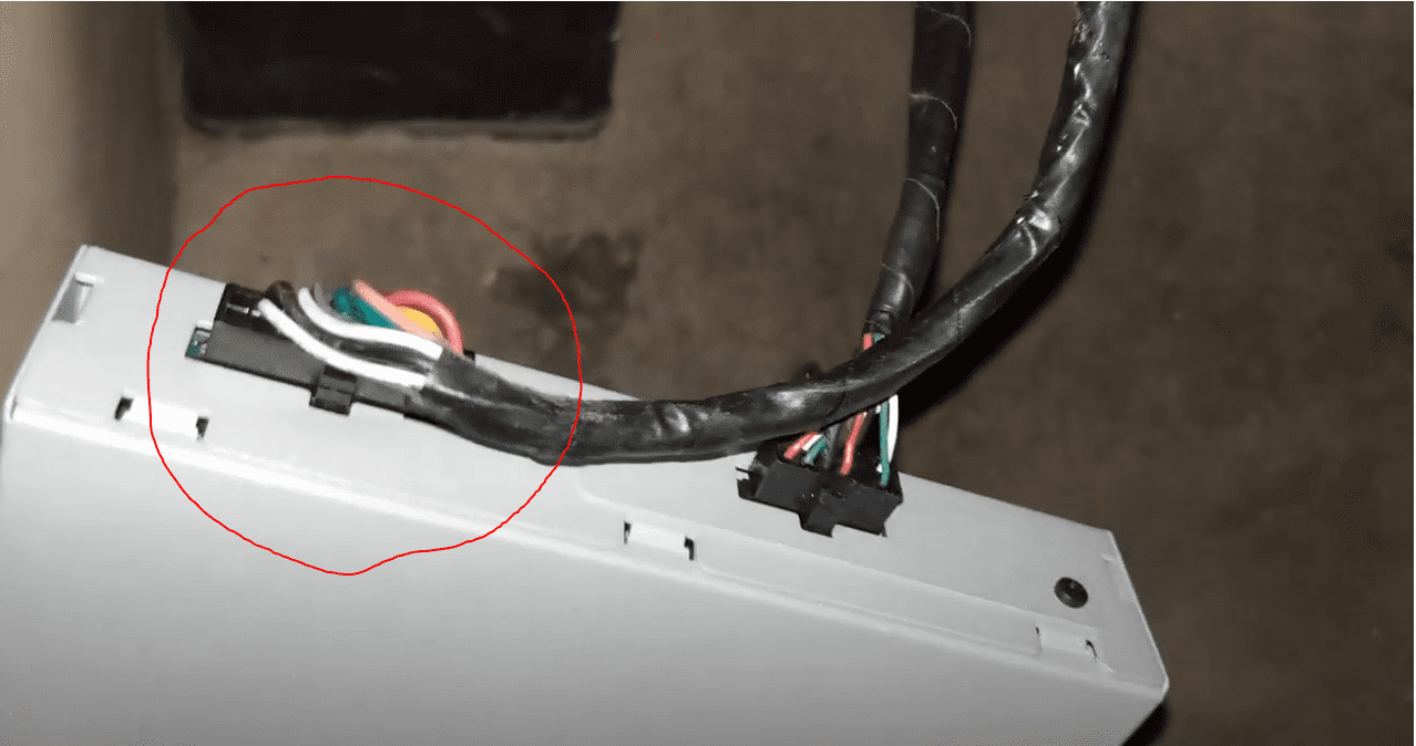

Just got mine installed and am only getting a black screen. Shop who installed it said it was working before they dropped it off. They suggested I leave the LC running to make sure the battery is charged (new battery).
Tried turning off and back on, just a black screen. Press Audio and it flashes the factory screen then back to black. Pressing CD just brings up the top CD bar then back to black.
I can hear the module booting up but no Vline graphics. Anyone had this happen?
Try disconnecting the "power" plug on the Vline, plug it back in, and restart the car.
This connector:
This connector:
Thank you for the help - tried this and no dice. Drove the truck 8 or so miles tuned it off...sat for 30 min then started working when I turned it back on. Has booted up fine each time since.
