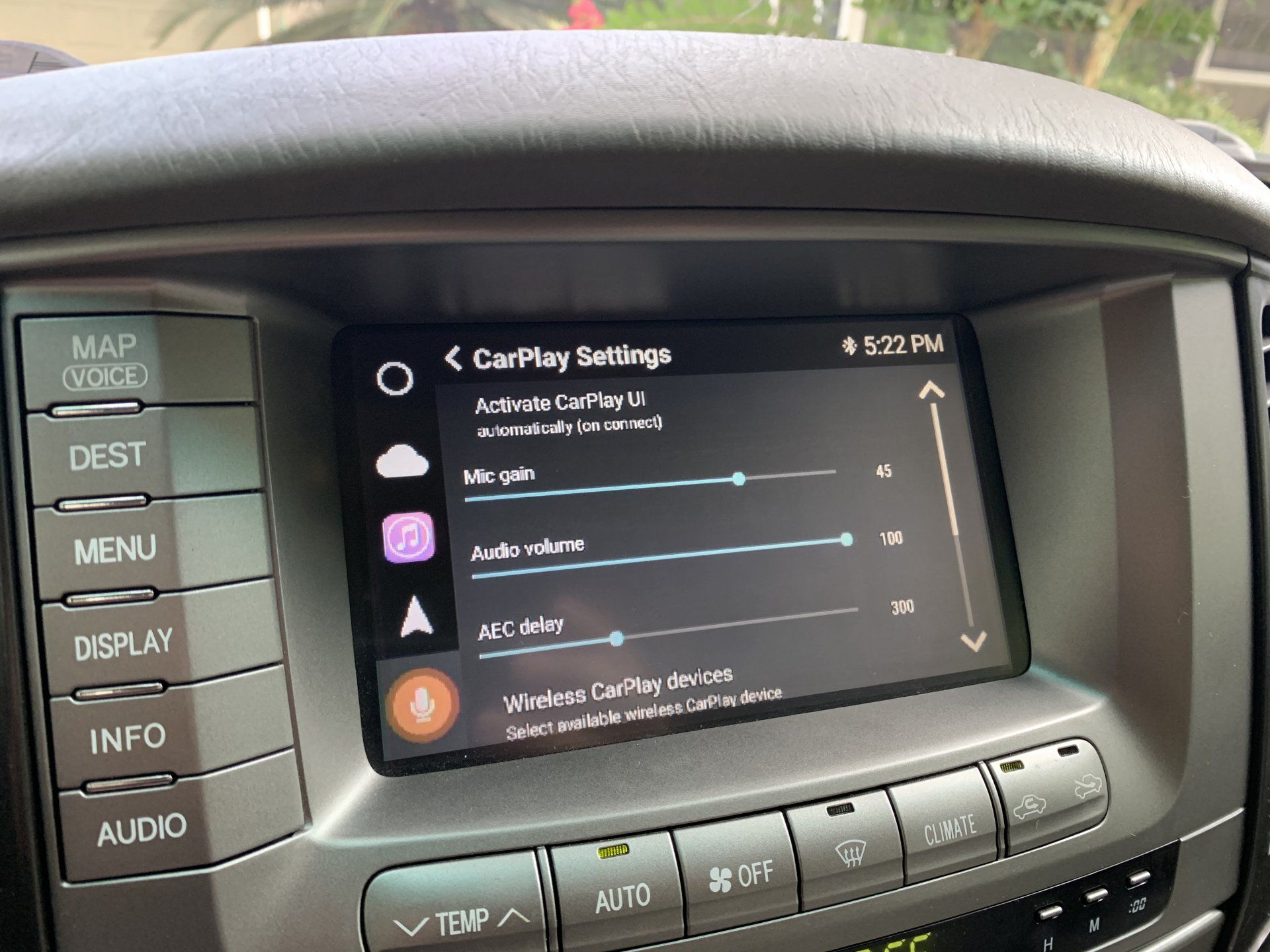

Every time I get in the truck, I have to manually pair the phone. Somewhere in one of the many settings menus, there's a setting for automatically pairing. At one point, I had it set to just that - to pair automatically. But... A: It's not pairing automatically now... and B: I can NOT find that setting! Anyone know where this is?
are you talking about carplay
Finally found that button yesterday. I think I was looking too hard - it's right there!
The funny part... I'd been going back and forth with Grom tech support on the topic. All I was asking about was that button. The guy had me checking for updates - software and firmware; verifying that the date and time settings were correct... He literally never said where it was. I just kinda noticed it yesterday.
