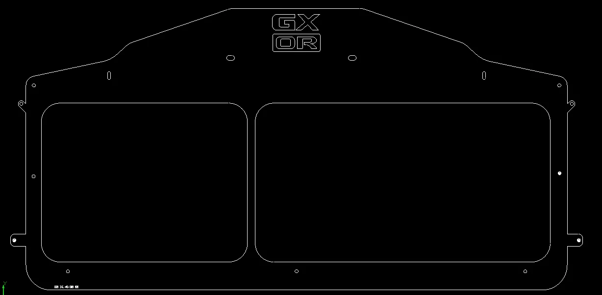

Just ordered a rear fold down shelf from OrangeBoxx. They are doing a custom GXOR logo on there for me on it as shown. I like how they have a lot of different customization options. Looks like it's going to take about 3 months though. I've read a few bad stories about their customer service, but so far the owner has been really great to deal with. We will see. Was also finally able to schedule with Goose Gear -- getting my rig in there next month. Only last thing left will be the rear bumper with 4x4labs, they are in communication but tough to schedule with.
Just ordered a rear fold down door from OrangeBoxx. They are doing a custom GXOR logo on there for me on it as shown. I like how they have a lot of different customization options. Looks like it's going to take about 3 months though. I've read a few bad stories about their customer service, but so far the owner has been really great to deal with. We will see. Was also finally able to schedule with Goose Gear -- getting my rig in there next month. Only last thing left will be the rear bumper with 4x4labs, they are in communication but tough to schedule with.

Yeah, I just decided to finally pull the trigger as it was 20% off with the current promotions. About $500 all in with various customizations, but man 3 months wait is nuts.

That thing is looking boss! Very clean and matched up nice. I have the OrangeBoxx rear window panels. Quality build, and wait did take a bit, but worth it. No issues with owner or customer service.

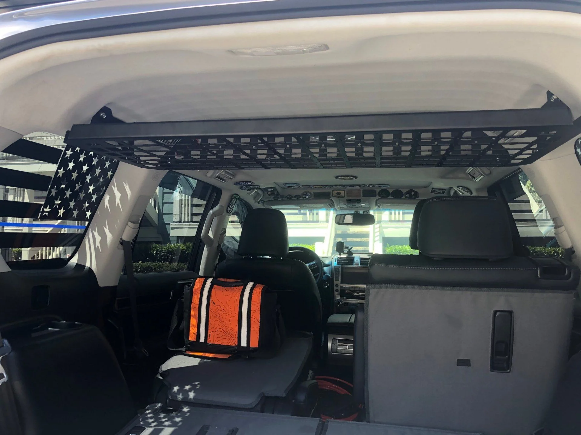

let know how you like that rack. That looks really slick!

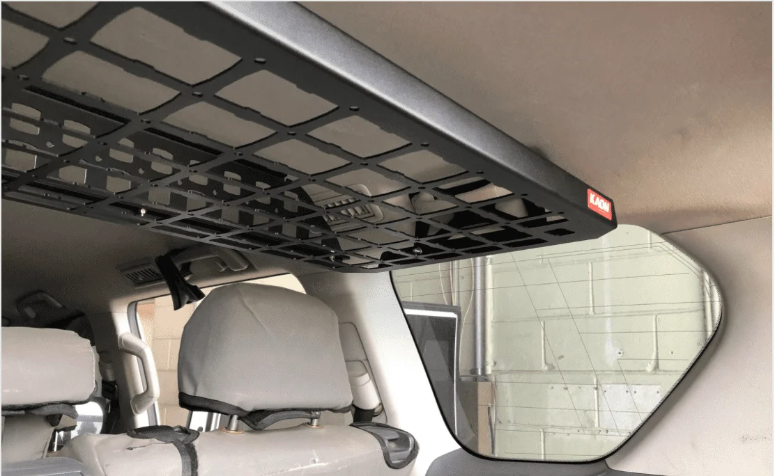

Just ordered a Kaon rear shelf
I have been considering this as well. Between the rear door table and some brackets I've gotten from them I am very happy. What was the total shipped after the conversion? I am excited to hear what you think.
I have the MOLLE panels on my rear quarter windows, do you know if this will work with those installed?
It looks like you use the hand grabs for mounting points, the same I need for my MOLLE racks.
I believe they will. There was someone who did this on the FB GXOR group, will see if I can get a hold of him. I have the panels from OrangeBoxx on order, so I really hope they are compatible with this.

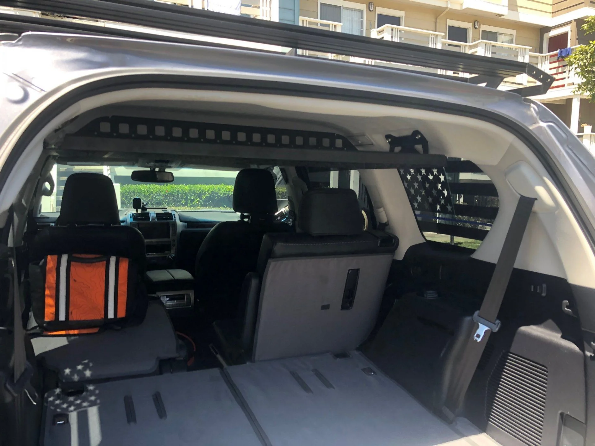

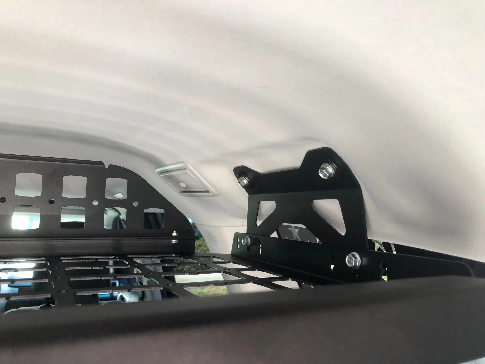

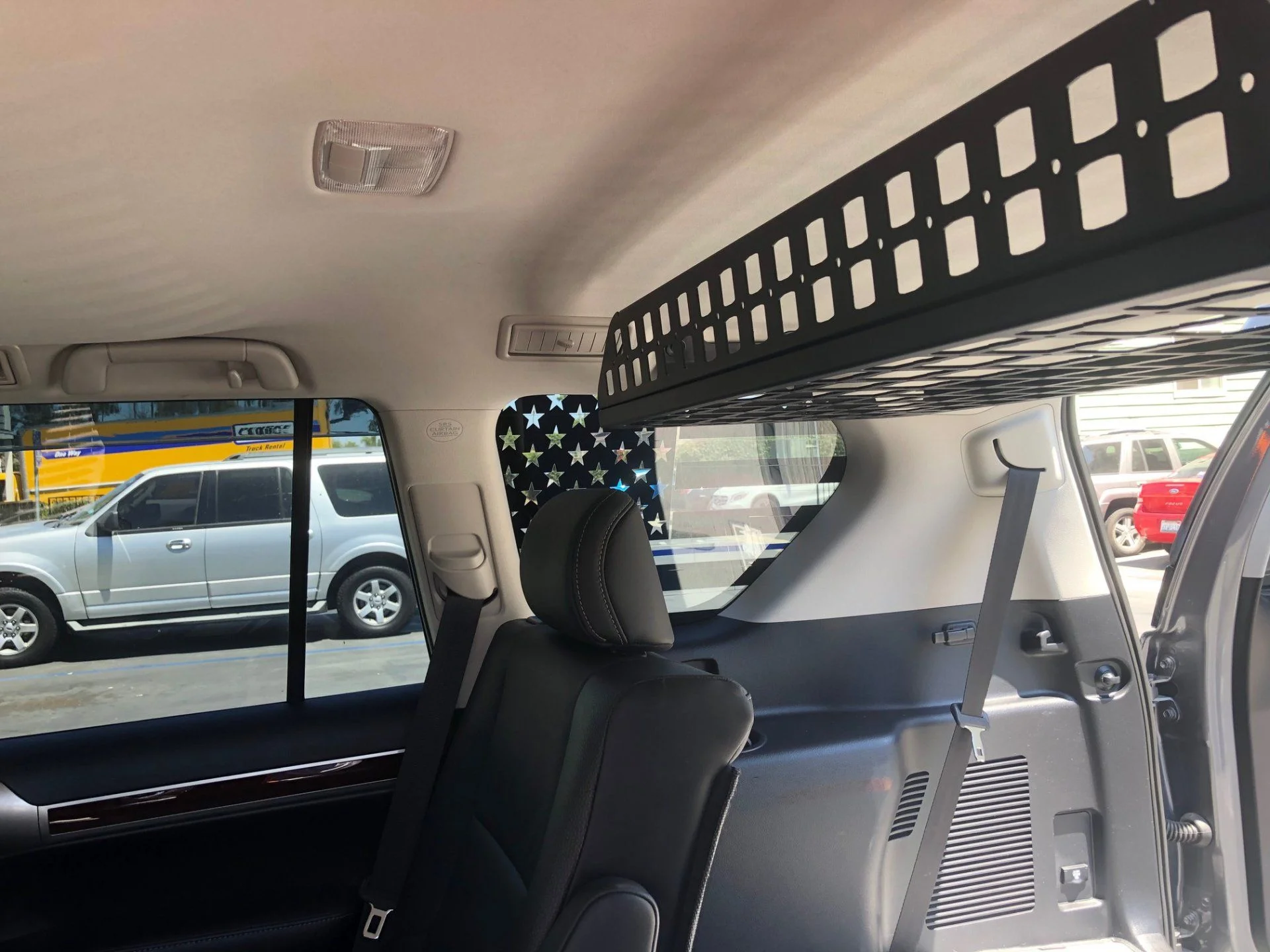

Just mounted the Kaon shelf. One note, you'll need to get larger washers (i.e. 1" diameter) for the bracket mount attachment if you plan on taking the handles off. I think it is weird to keep the handles mounted, so just got larger washers. The screw hole in the bracket is too large for the existing washers -- guessing this is for placement adjustability. There is some adjustability -- 3 holes for front to back and 2 for up and down. last pic gives an idea in the middle setting of head clearance for rear seat. These are captain seats and i have the seat pushed all the way back. 3rd row, well, better just be kids haha.
