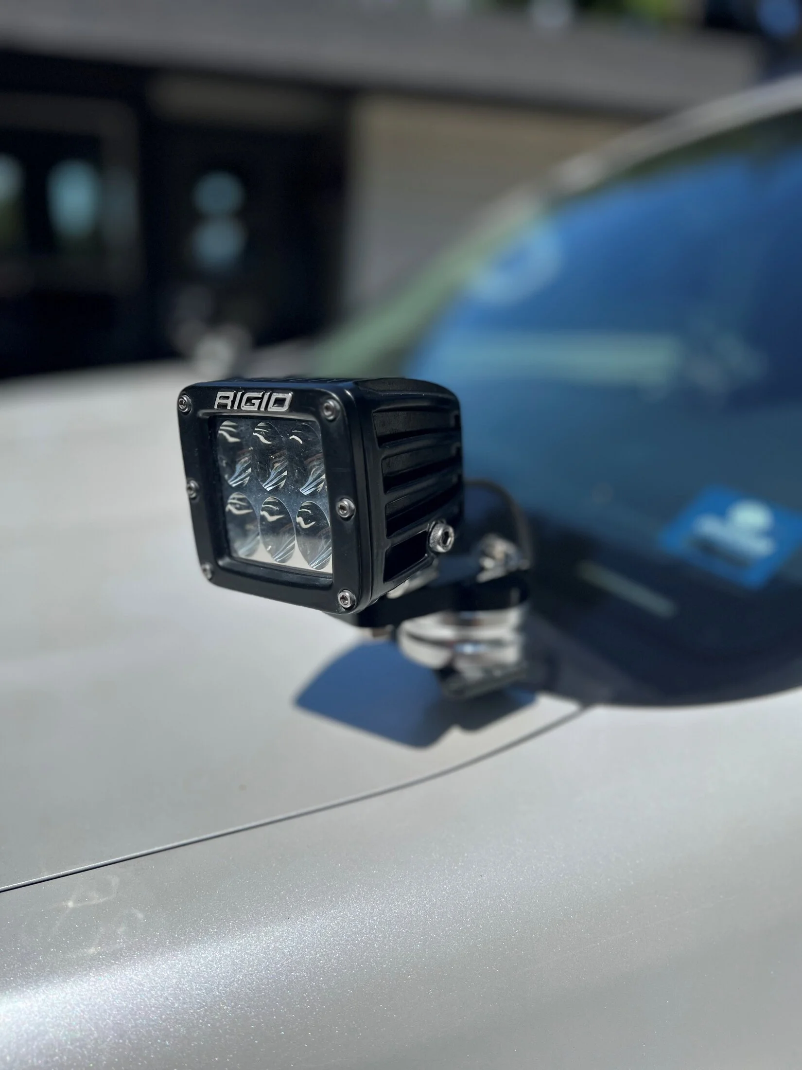

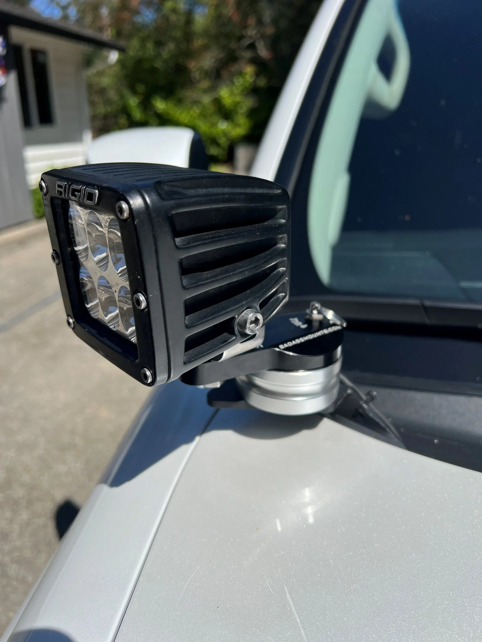

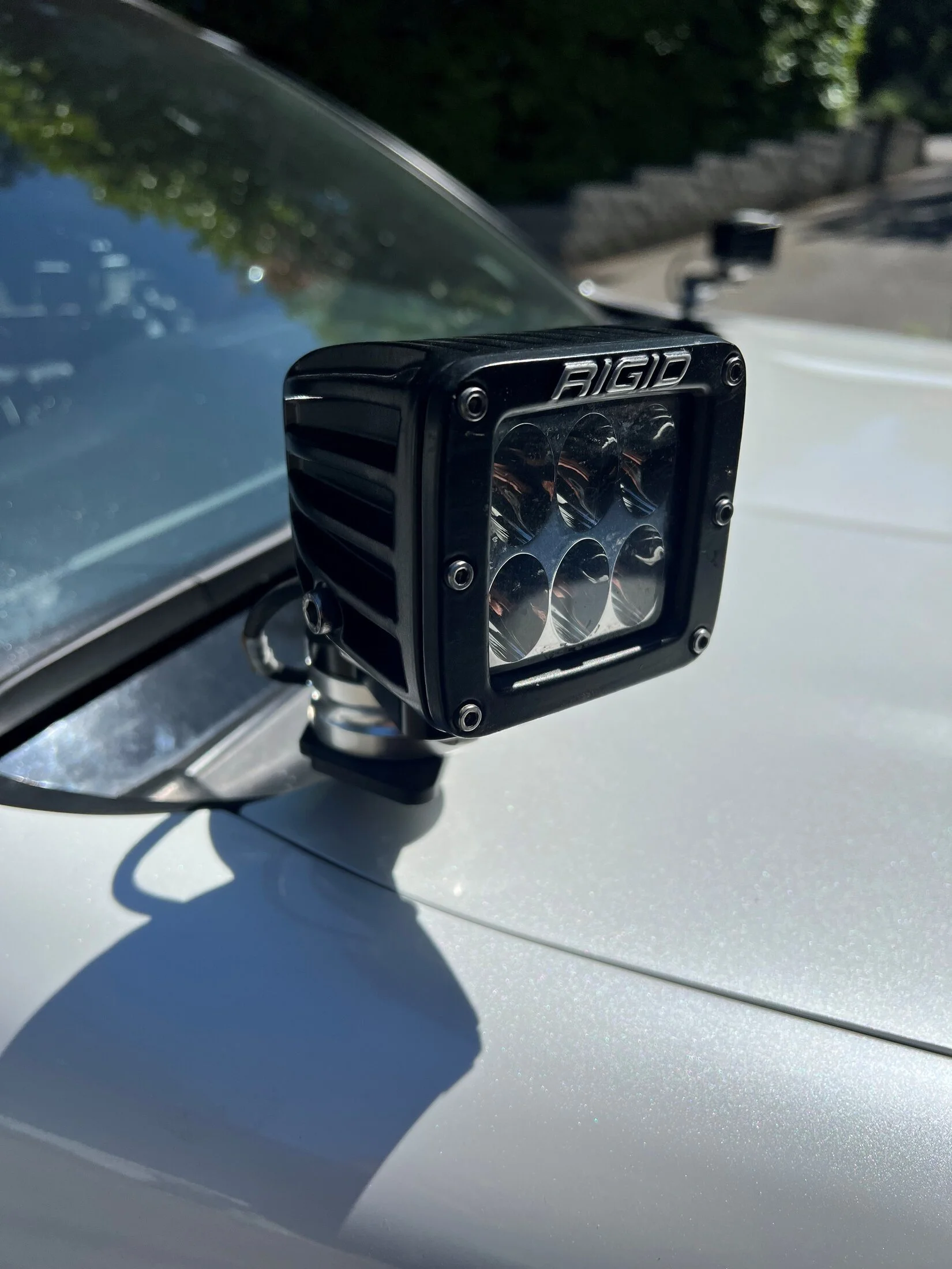

These are completely unecessary, but thought they were cool!
BAM ditch light mouts. BAM 360° Mounts & Accessories - https://badassmounts.com/
^So the BAM mount lets you easily change the angle of the light by just pulling the pin, or is there more to it? It's a neat idea since I feel like tighter trails you sometimes want the ditch lights almost perpendicular to the car but not sure that's a $150 problem.
Agreed that 150 is to much even the $115 I paid is a lot (holiday sale). Just fun to have! Might be handy in camp for task lighting.

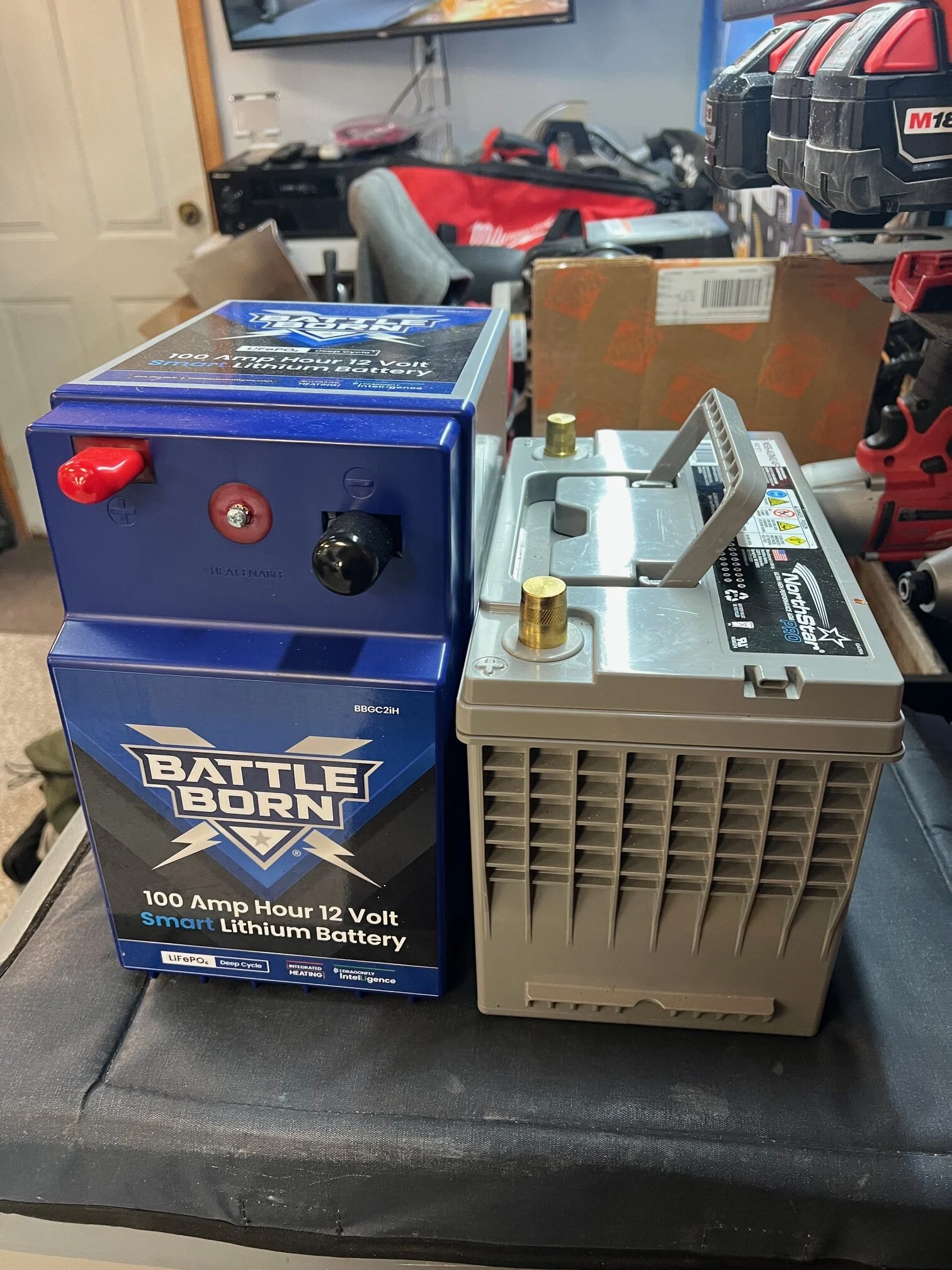

While I never intended my recovery gear storage hutch to be a home for my house battery it ended up being the most logical spot due to the lack of space under the hood without compromising a few different items that other folks did to make two batteries fit under the hood. .
With that being said as my training business has grown and with adding more recovery gear I quickly ran out of storage space for my recovery gear.
Battle Born had a great BF deal on their most advanced 100 ah battery. Slightly smaller in size and half the weight of my current house battery I placed this on order last Friday.
This will allow me to reconfigure the battery orientation and give me a bit more room in the gear hutch.

Holy Cow Batman!!
ON SALE for $999.00!! Reg: $1,249!!!
Wow, that's a lot for a battery.
Did you have to give up your first born child also for it??
Couple of questions:
  • Can this be mounted in any orientation?
  • How do you wire this up? Can you run this straight off your alternator?
Holy Cow Batman!!
Yeah my first born was way more expensive, had to stop at one.

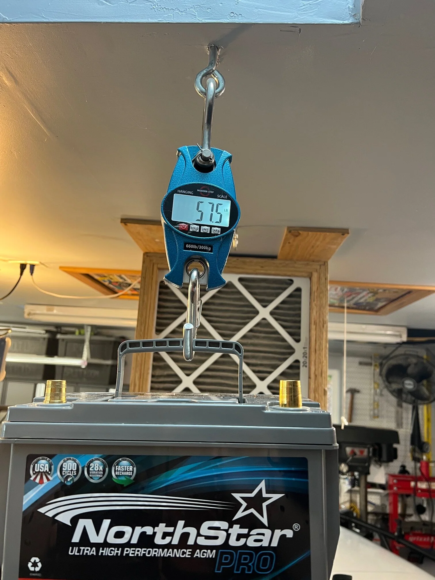

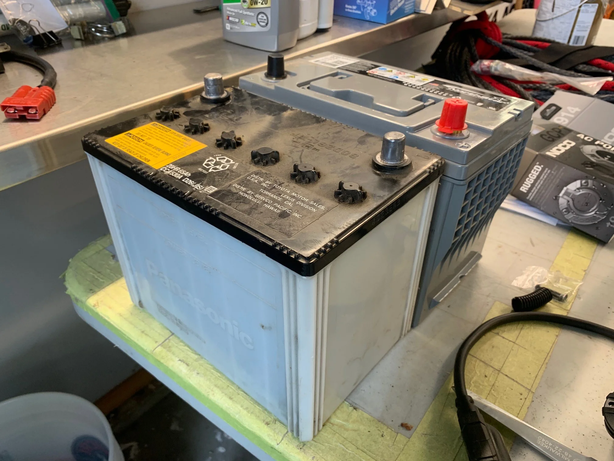

Yes they are expensive but a equivelant AGM is a little less than half and has nowhere near the amp hour capacity, it has a battery management system, built in heater to charge when ambient temps are below 32, and has a Bluetooth app for monitoring the state of the battery. You can get just the basic 100ah battery for $649.
Yes, mounted in any orianation. It will be charged off of my Redarc BCDC. The BCDC can be configured to charge all three types of batteries.
Most importantly its somewhat smaller and half the weight of a my AGM battery.
I had some days this fall where the solar panel and battery couldn't keep up, we have lots of rain and clouds. The AGM is getting to be close to 5 years old as well.

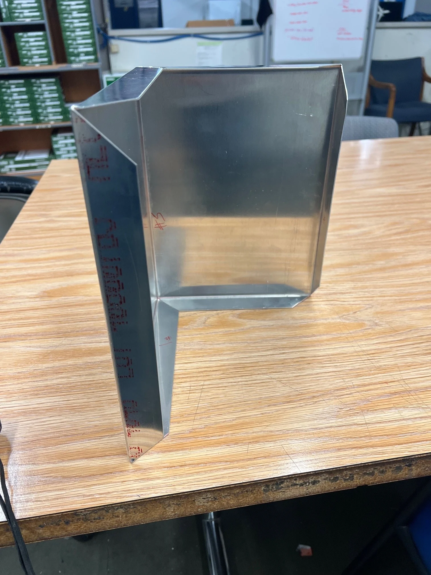

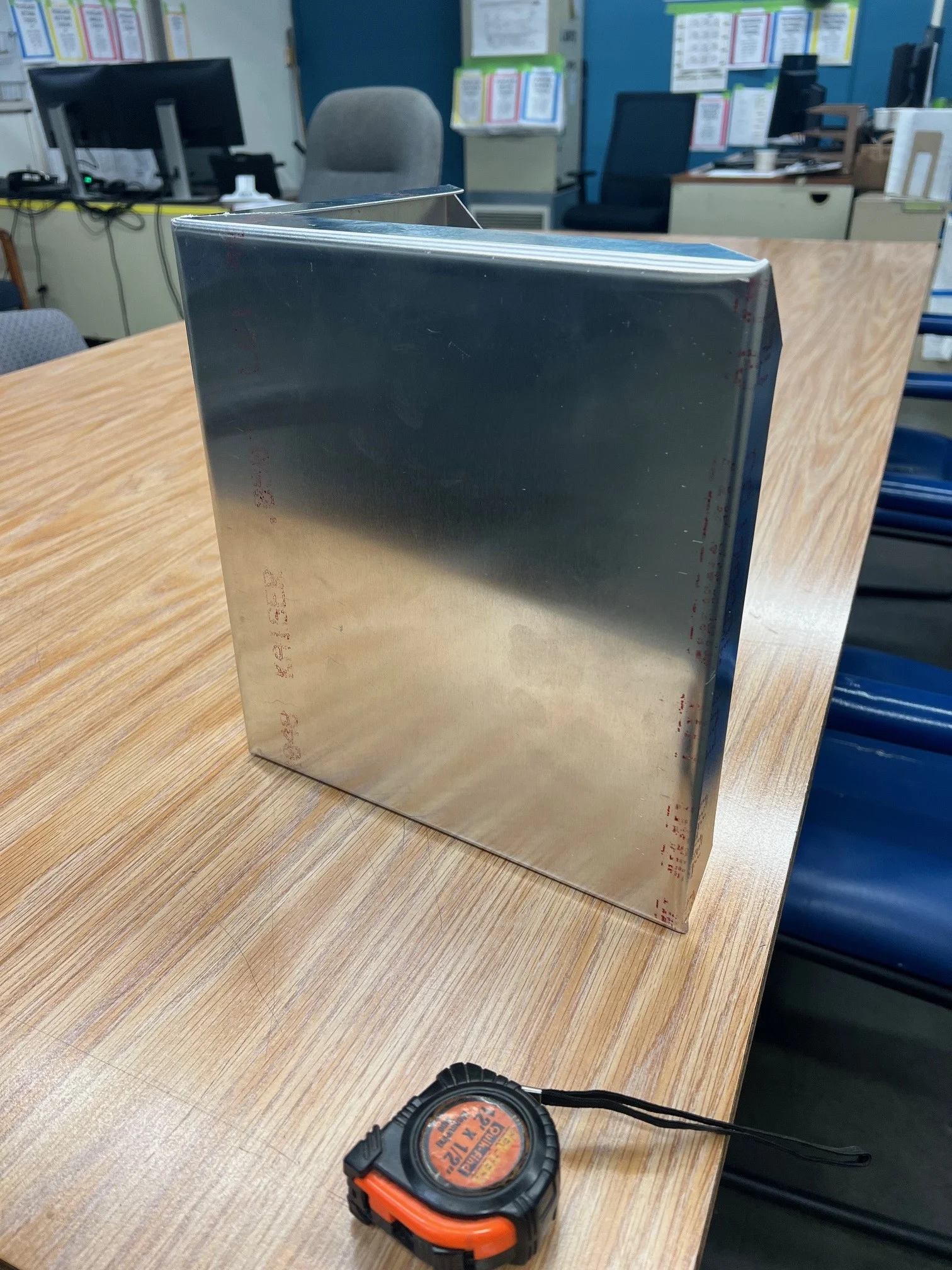

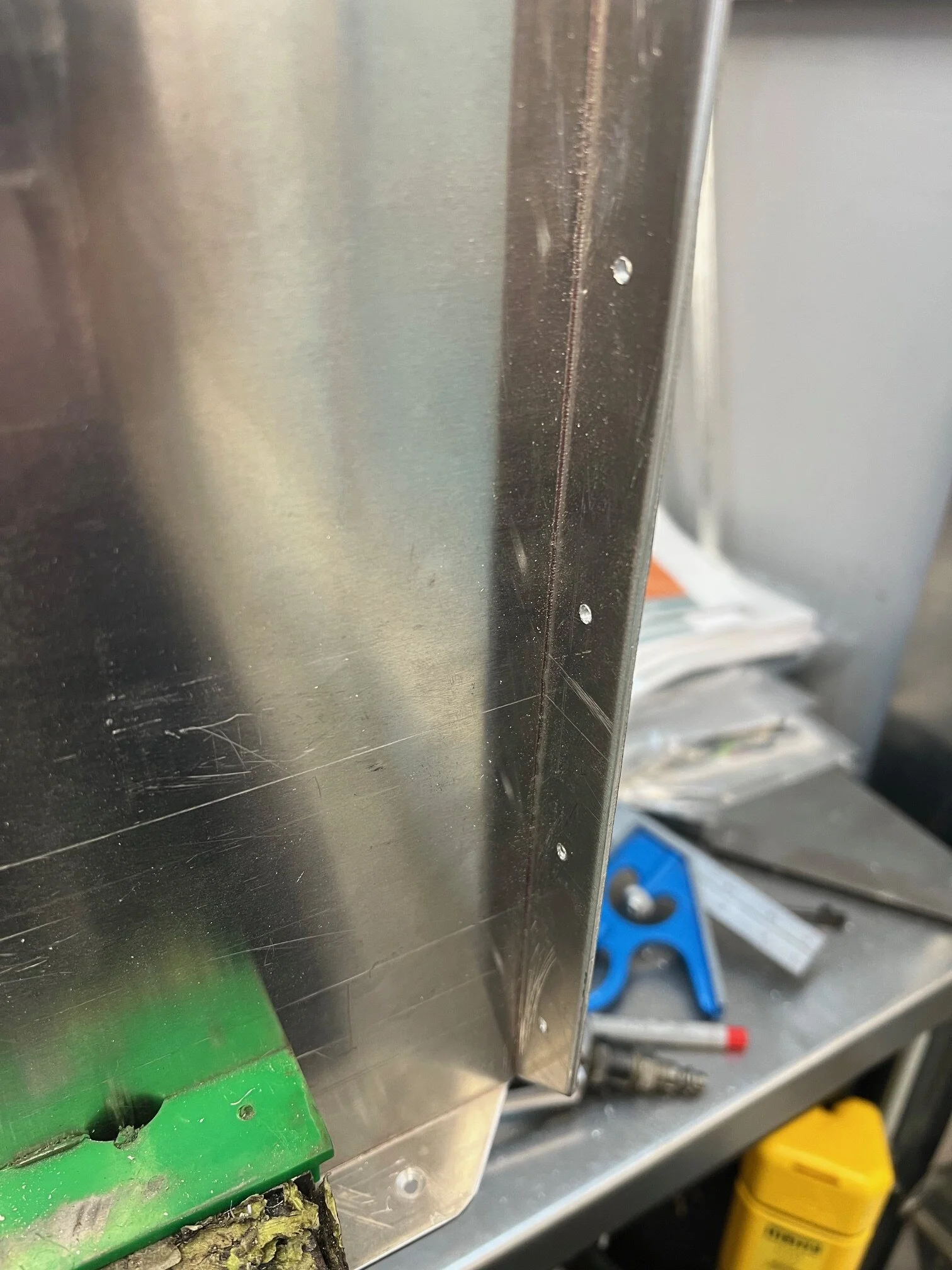

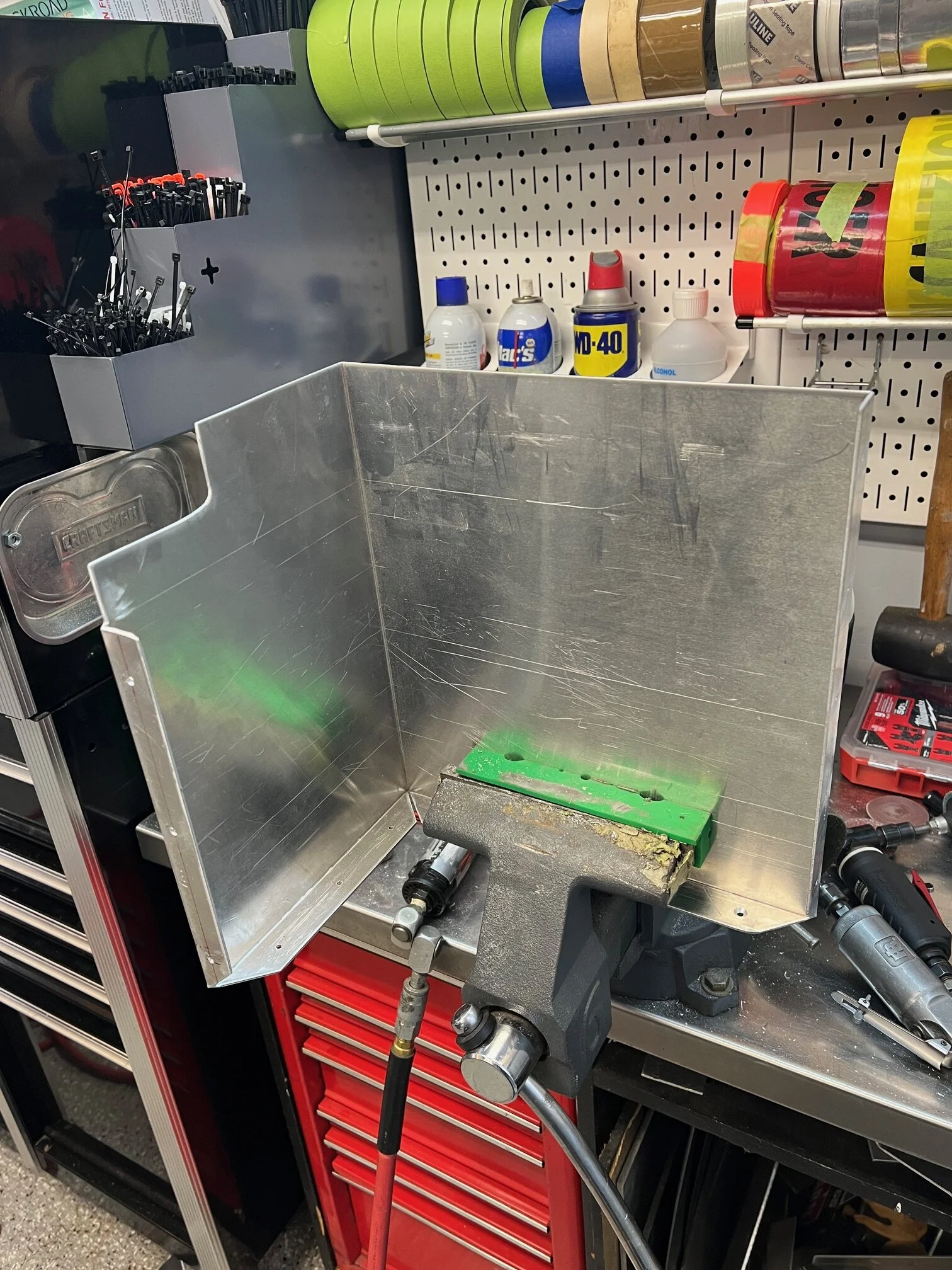

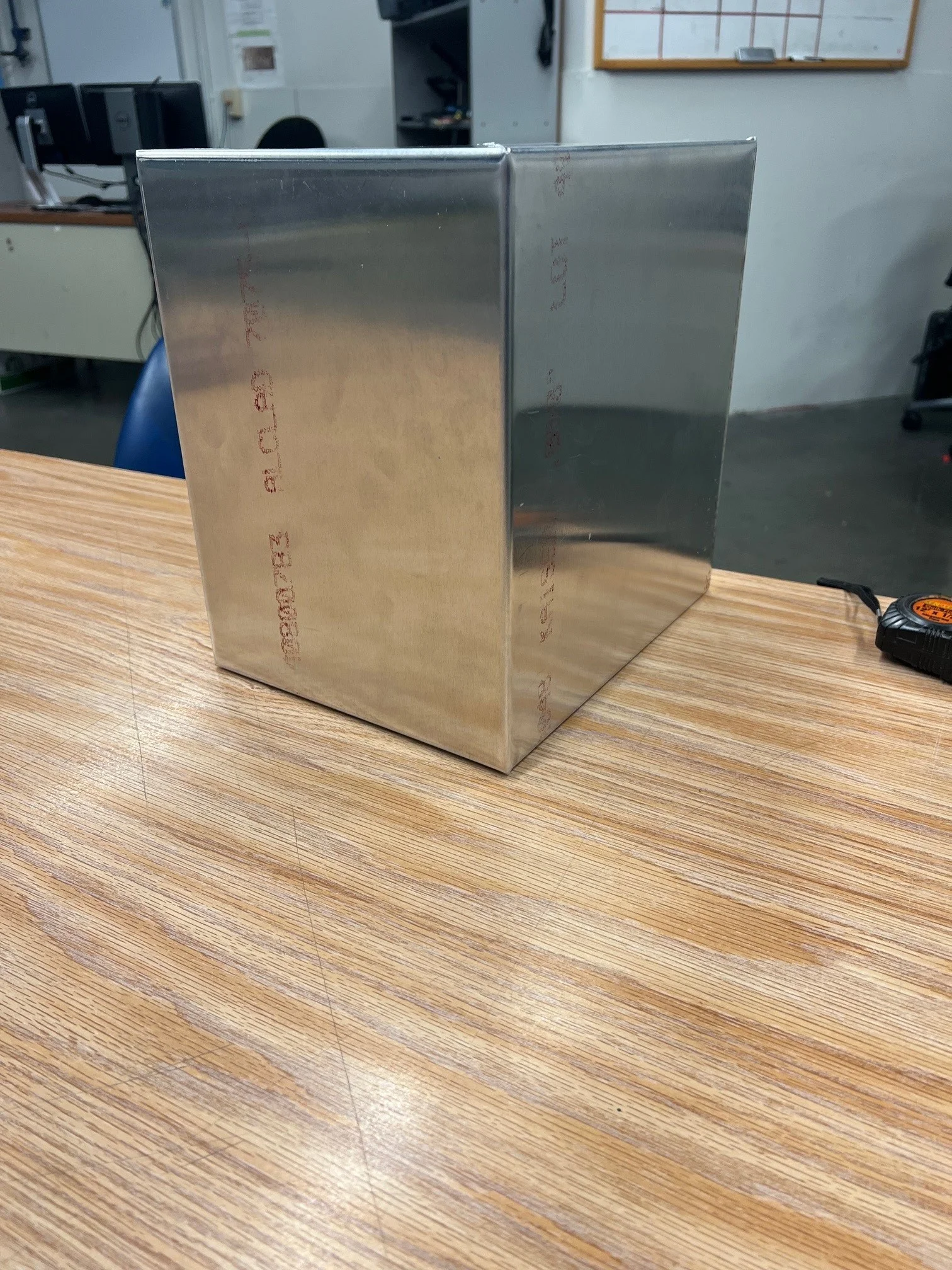

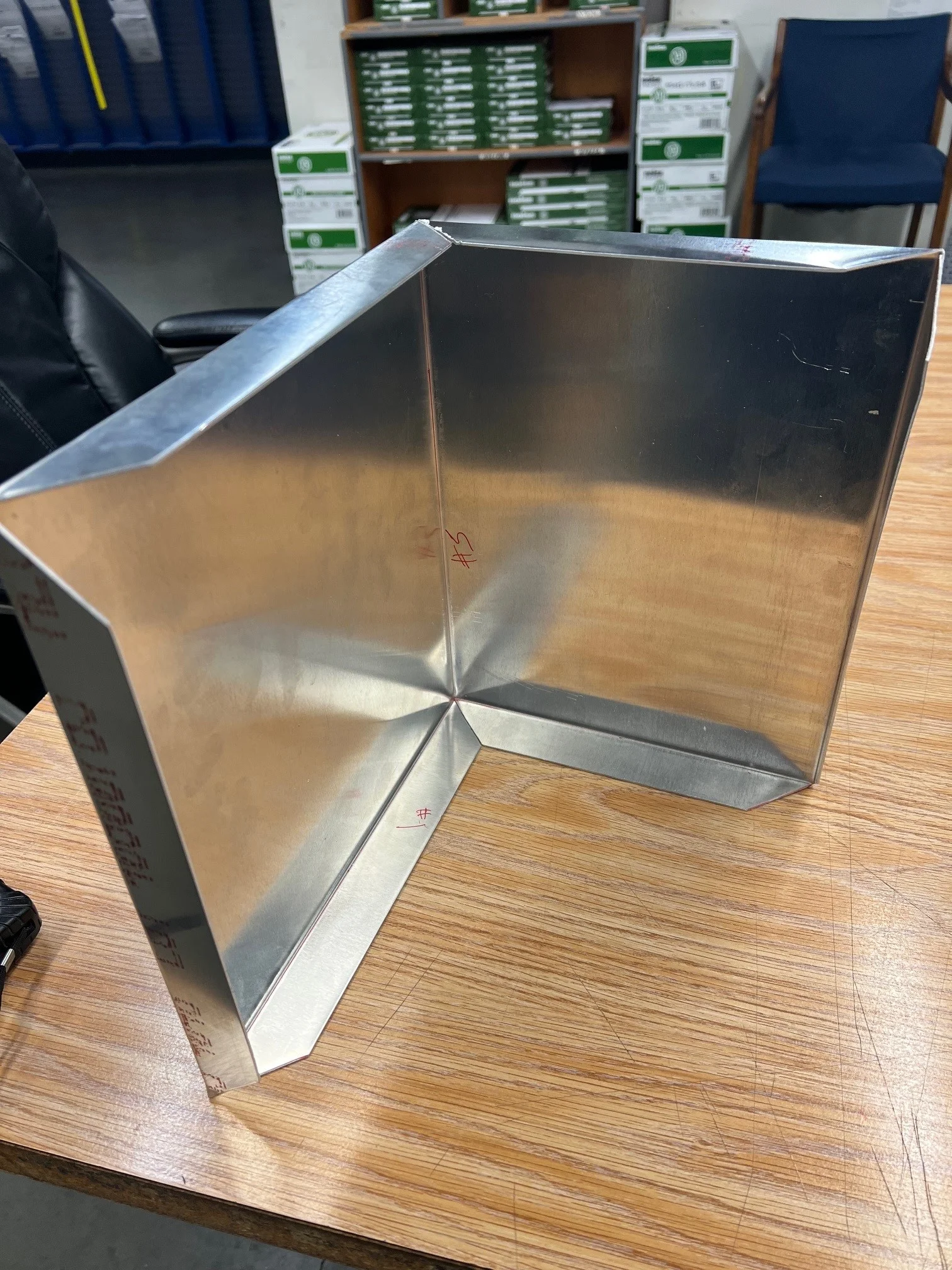

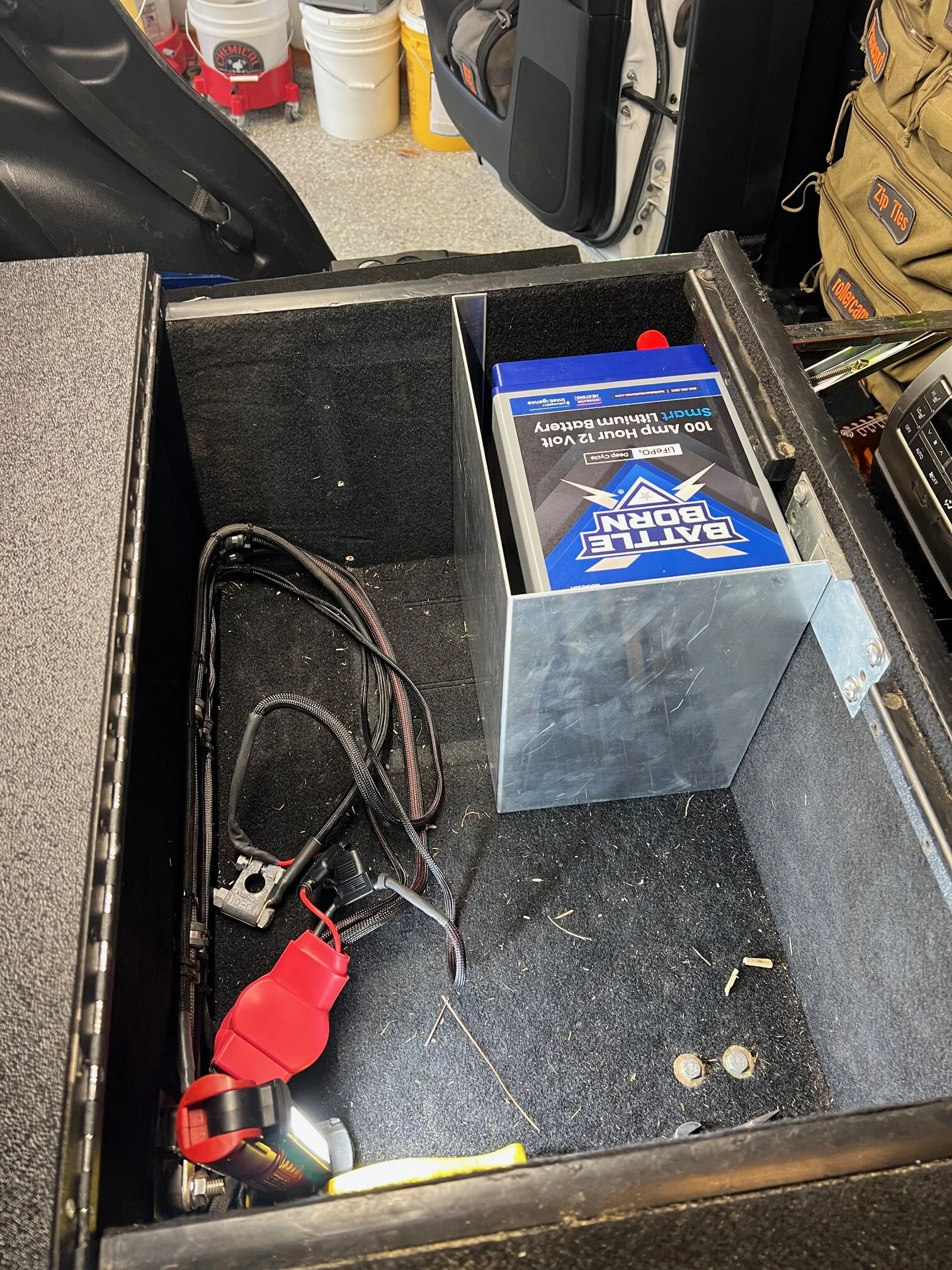

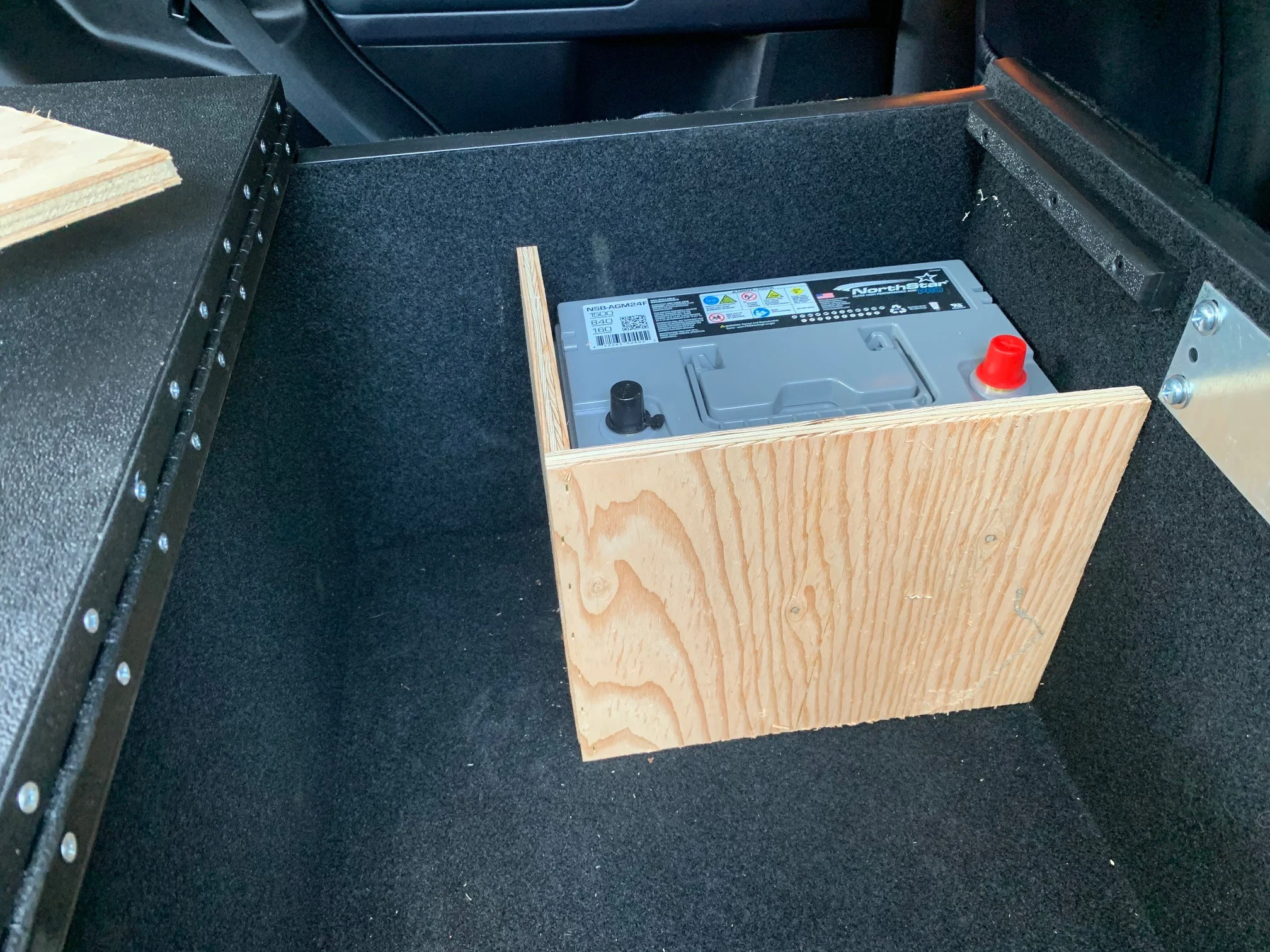

The wood suround (see above post) of my current house battery takes up an extra 1/2" of space, needing to have to make a new battery surround I figurd I'd build a new one but out of 1/8" or .125" aluminum. Wanting to fabricate a test run I whipped this one out tonight, made from .050" 7075-O.
This is just a test run fabricated to test the idea using the battery dimentions from online, my experience I have found online dimetions to be inaccurate. I will use this test part to see where I can cut back the size and deseign. I already discovered the upper lid mounting flange will need to be redesigned to make the overall size smaller. I think I have a redesign idea but need to wait untill I have the battery on hand. It was also a usefull exercise to figure out the bend schedule of the material.
The new battey is about 3" taller, about 1" narrower, and about 2" shorter. Ill be sitting on this until the new battery ships mid month.

Guess you have a box and pan brake? Been wanting one of those for years for little projects like that.
I'd opt for aluminum, with a little over lap on the joints and rivet together, unless you have a TIG which would be better.
I will see how the .125" comes out after bending it. If rigid engough I may not weld it. I do have a brake in the garage but took the oppurtunity to use the nights jobs shop equipment to bend up the test piece.
Gotta love having access to a shop!

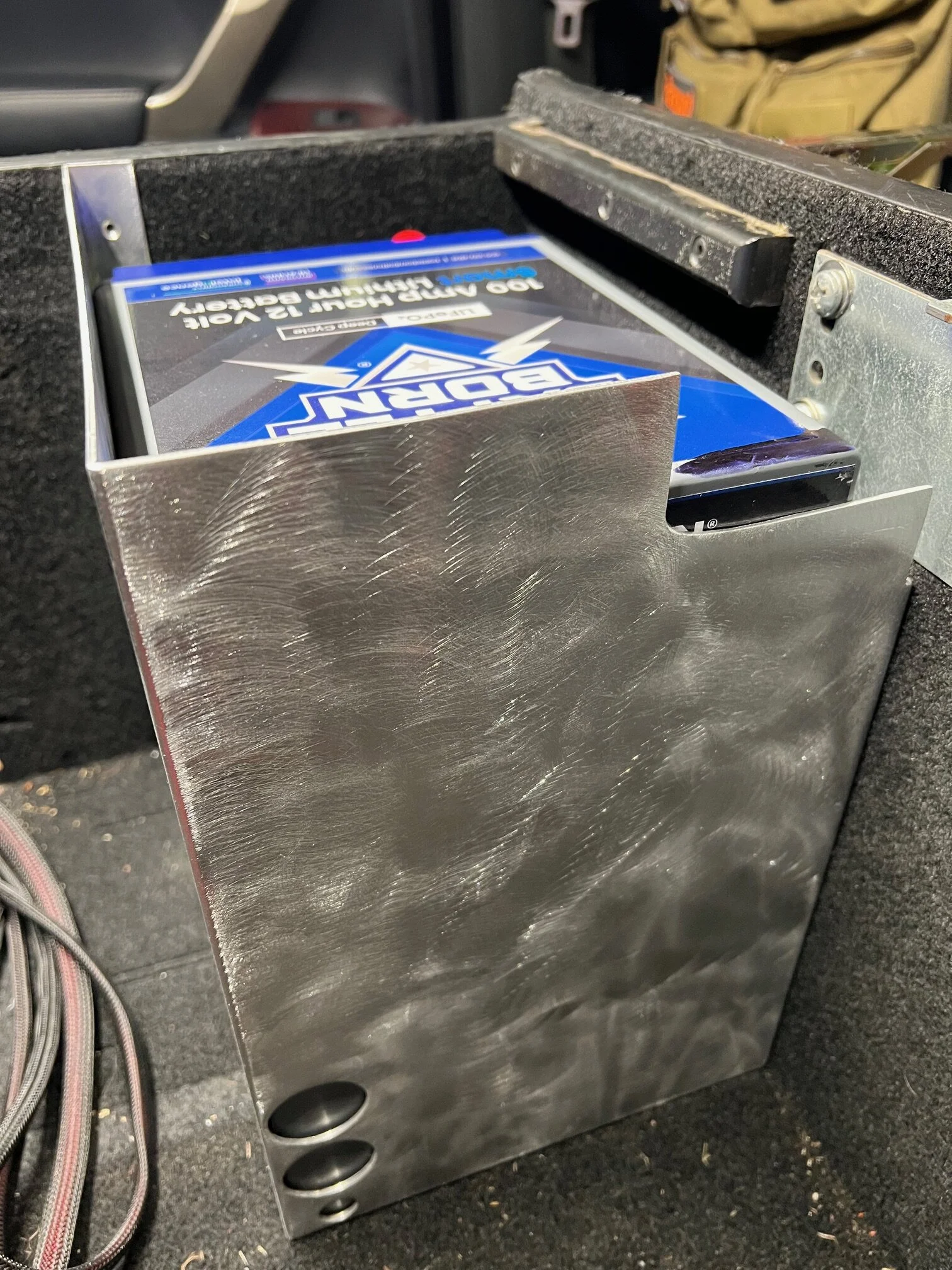

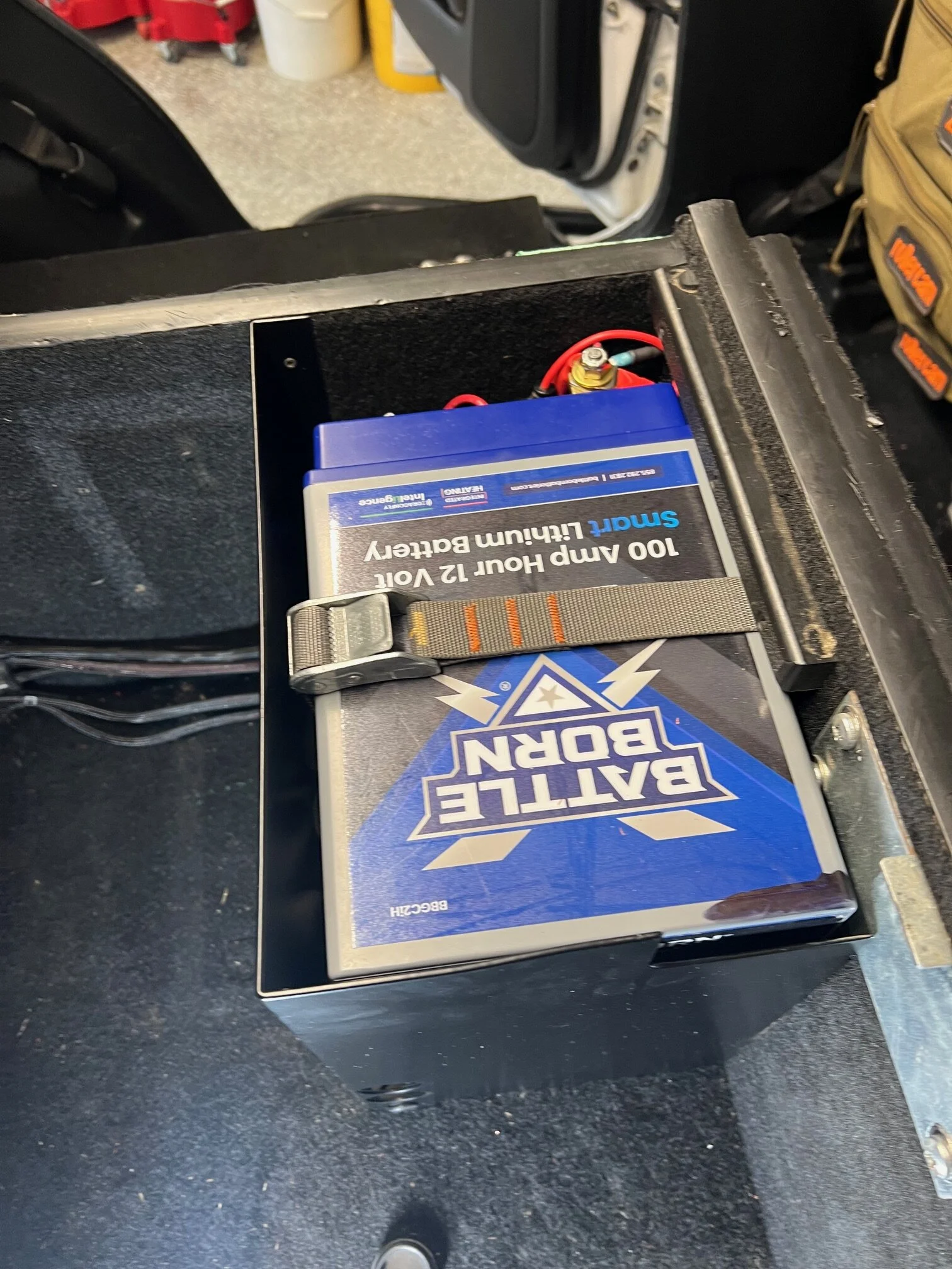

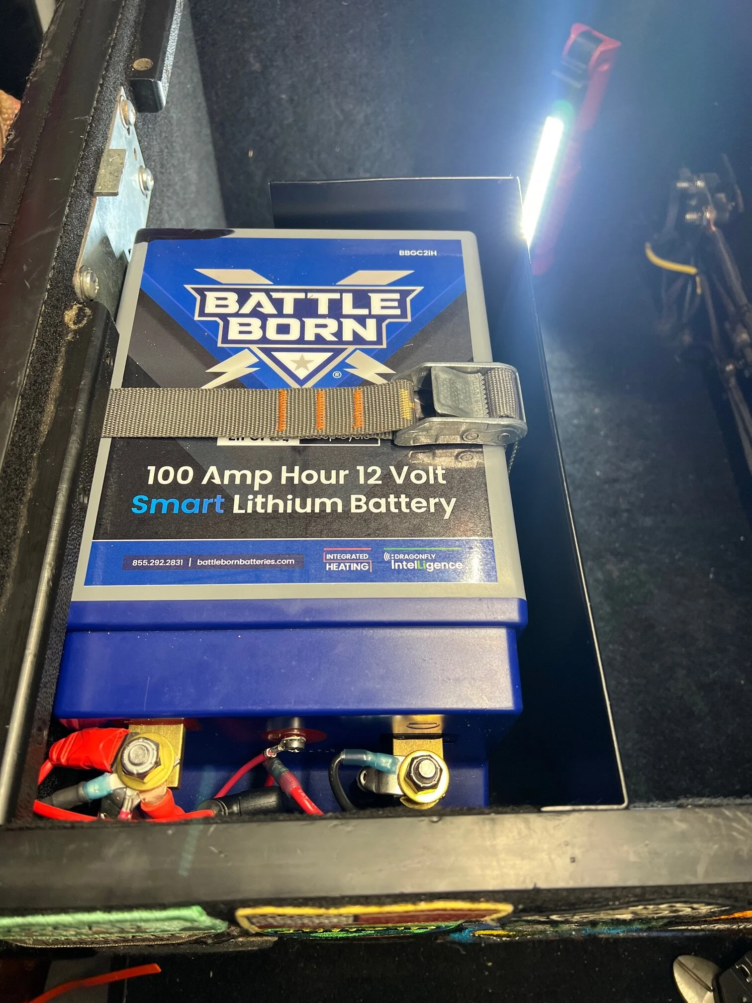

I finally got around to installing the new Battle Born LiFe PO4 and new battery box. The Battle Born is nearly half the weight of my old AGM battery. The new configuration allows my recovery gear to fot better in th storage hutch. The battery box is fabricated from .080" 7075, bent it up on the brake. I didnt leave myself much room for connections, I wanted to maximum the space for storage.

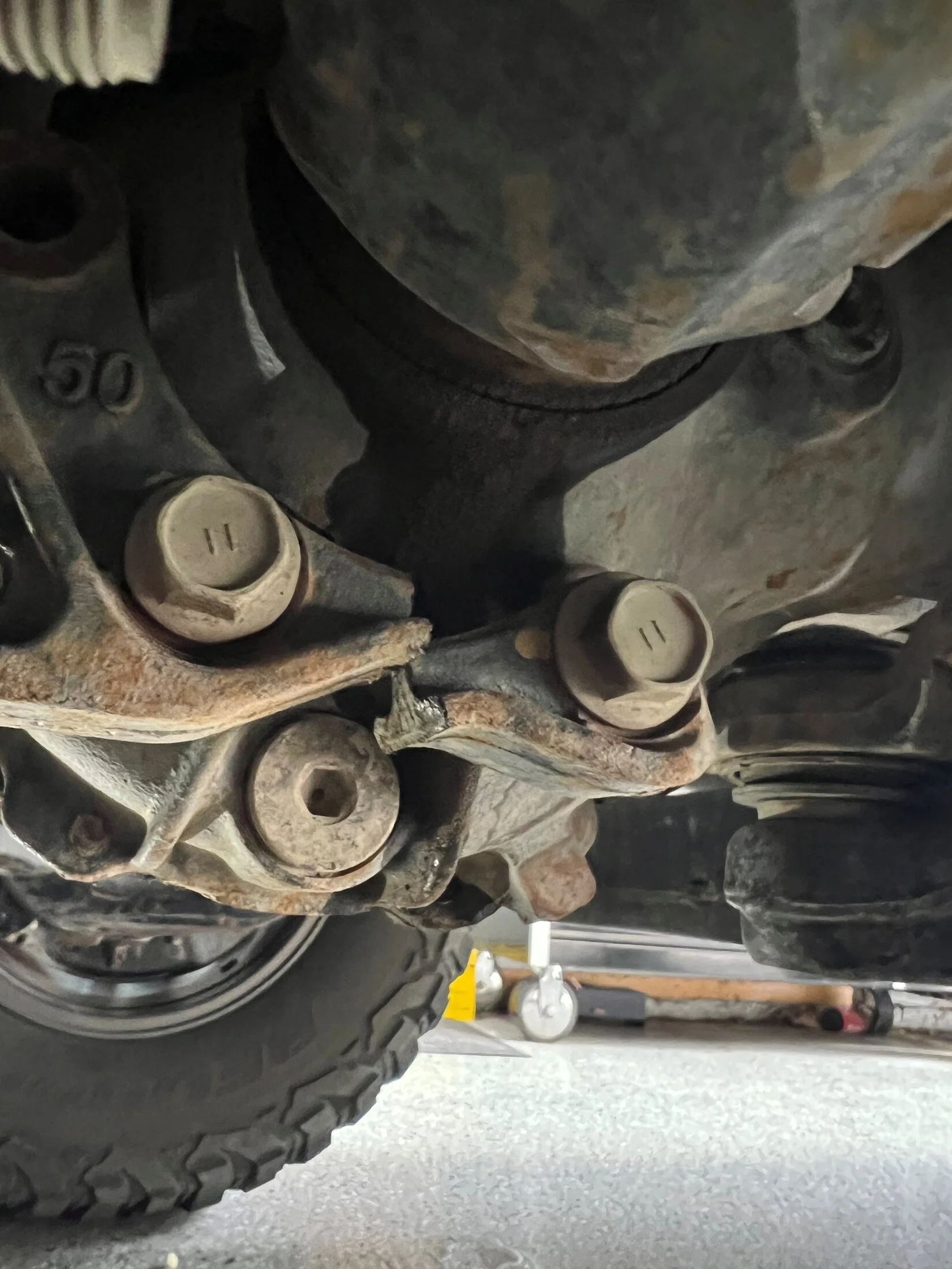

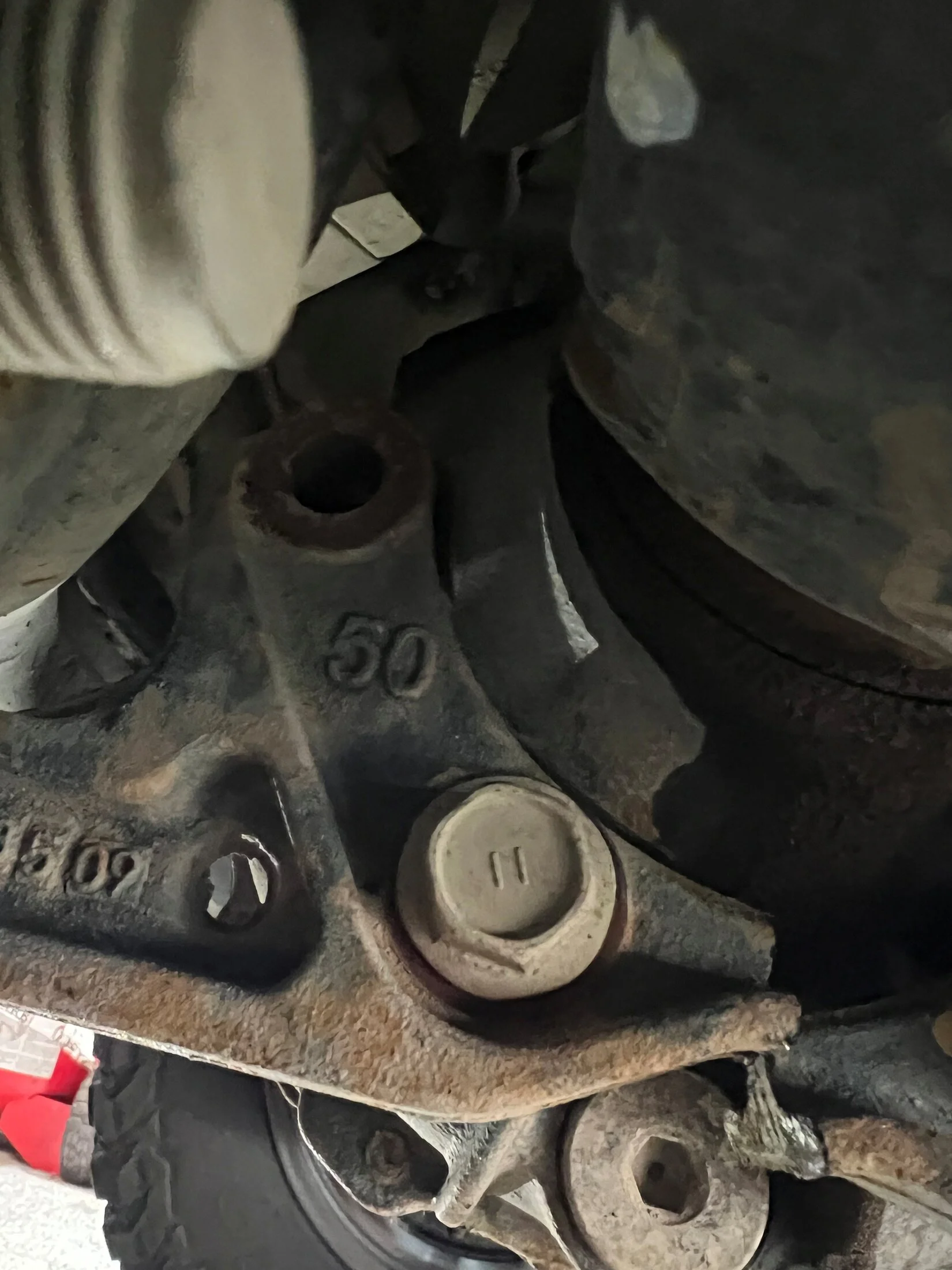

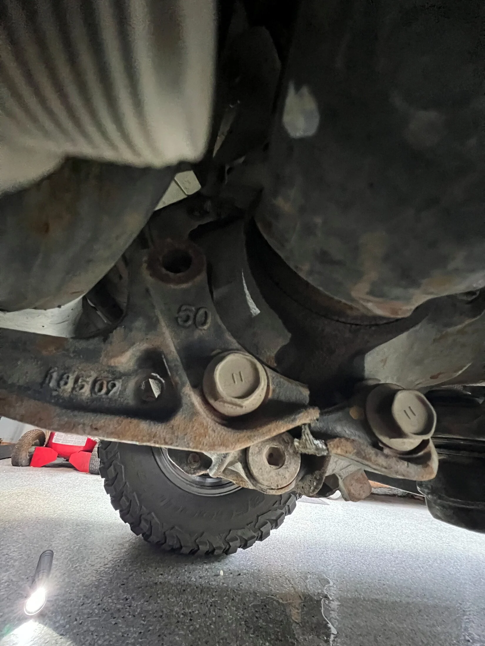

Prepairing for a long trip to Montana this morning, while removing my front skid plate for an oil change a large bolt dropped on the ground. A bit confused I start to look and the area the alignment shop would have been working the day before as I replace my upper ball joints last week.
I found nothing in that area but was concerned and this was a heavy duty bolt. To my surprise I quickly located the source of the bolt and other damage! The lefft front differential support bracket had a bolt completly back out, that was what was lying on the forward skid plate. Then I realized that the the support bracket had completly severed/broke! Part is on order but had to purchase from the dealer as I couldnt wait for a online supplier and shipping. I depart for Montanna on Monday. Ill update as I replace th part. I was glad to have found this, the trip coming up is 1400 round trip and I doubt I would have made the journey.

OH snap!! Pun intended. Any idea what happened to cause it?
  • Haha
Reactions: r2m
We were on a pretty rough two track out of the central Oregon dunes. We were aired up to highway pressures prior to departure. One of the bolts had worked its way out (the one I found on the skid) threads still in good shape. I think the lack of that bolt being installed was to much for the support.

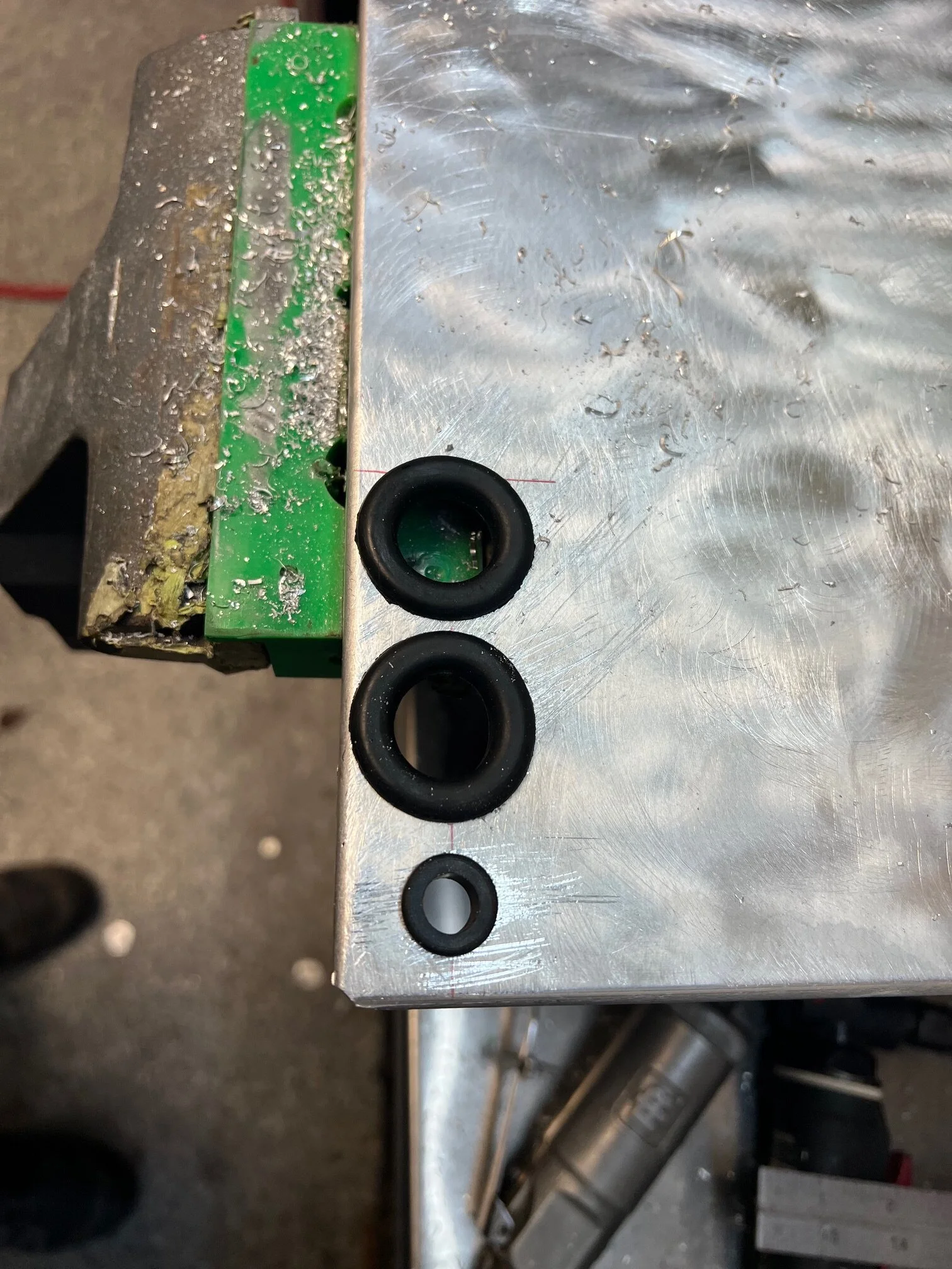

As with most things on this truck it wasn't a simple connect to the 7 pin connector. The reciever on my LFD rear bumper buts right up against the frame to route the wiring I had to hole saw through the bumper, and frame. It took 3 hole saw blades. once I did that the wiring was easy.
