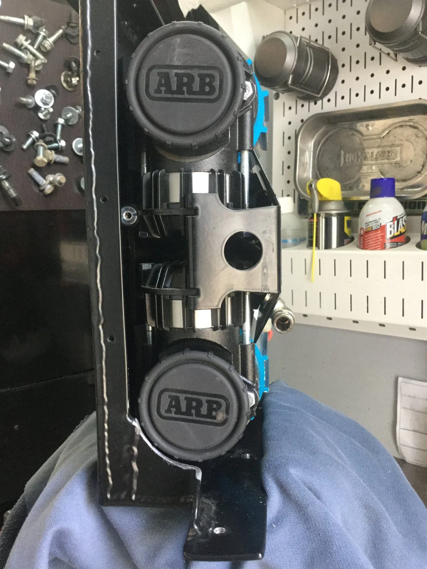

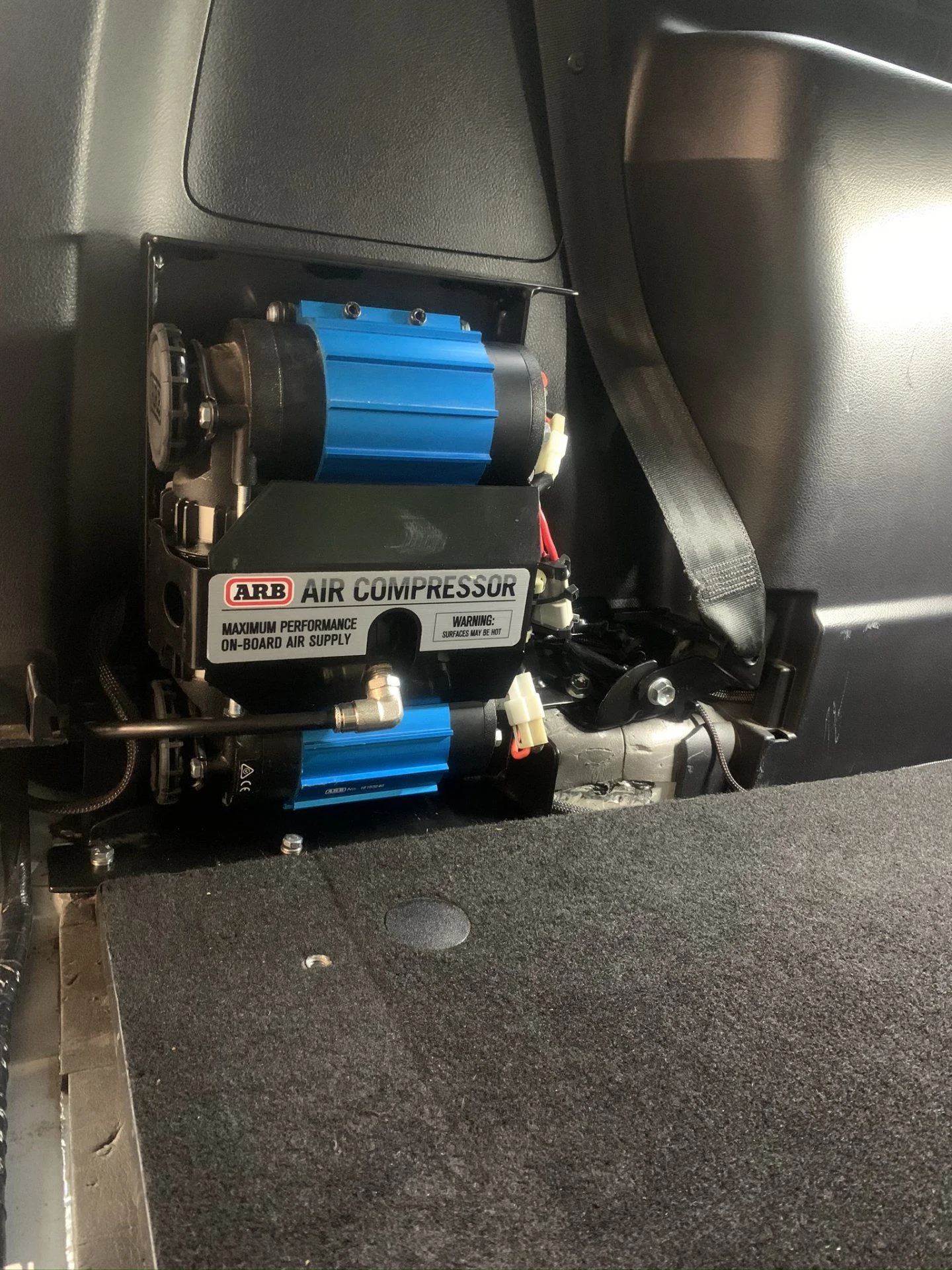

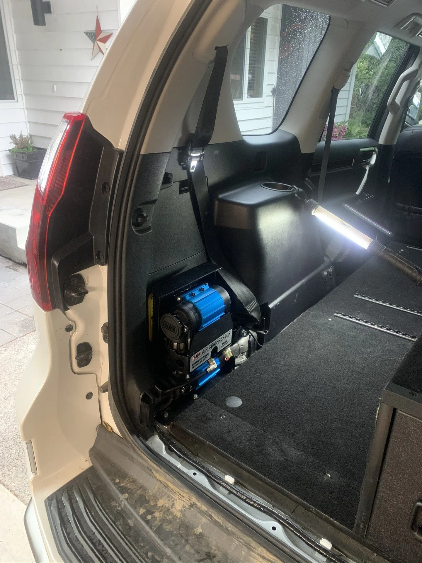

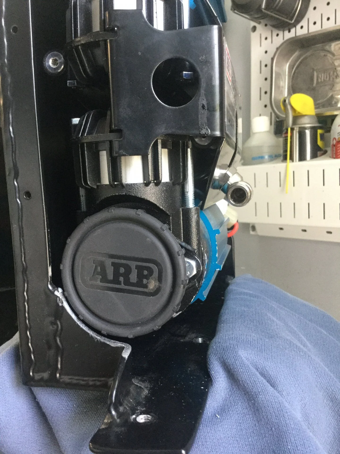

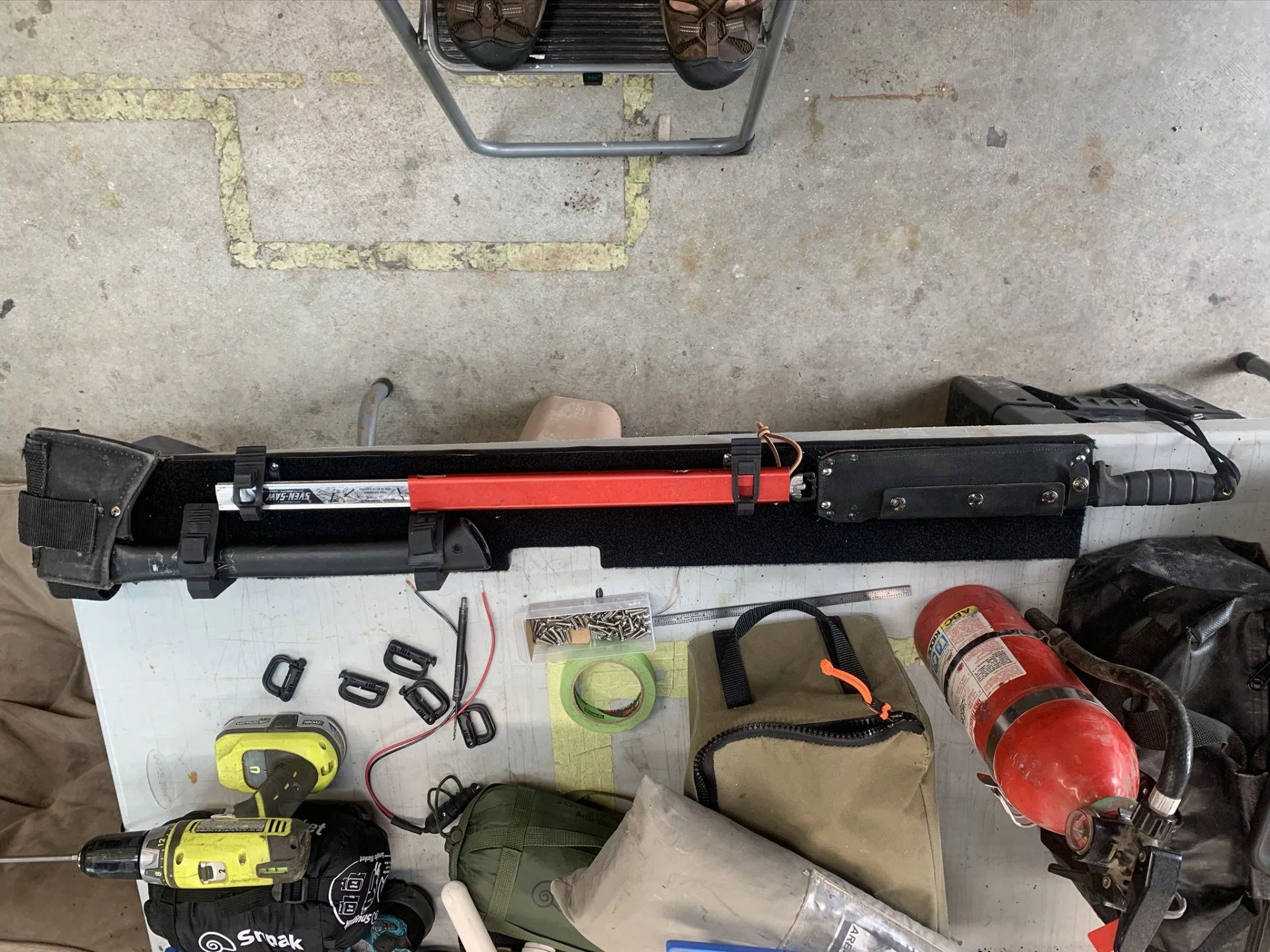

Tidy some items up this weekend. We added extra gussets to the ARB Dual Compressor Mount and one of them ended up blocking installation of the air filter. For my most recent trip I did a quick relocation of the air filter but that looked like crap although functional. I removed the mount, notched the gusset and sprayed just the edge that I ground out. Reinstalled and now is a much cleaner look. I also added a lanyard to the Whits End pacifier on the air chuck.

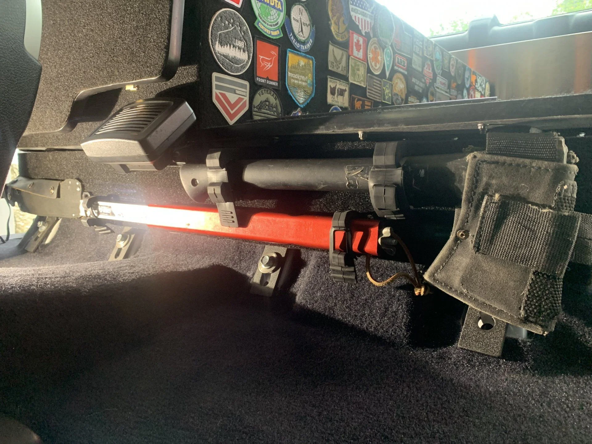

I’ll be building a shelf/shroud around the compressor mount once the rainy season kicks in a couple months from now. I also finally mounted up Quick Fist to the front of the Truckvault platform. Again another item that didn’t get resolved before the trip and was annoying as I dislike loose rattling possible dangerous items bouncing around on the floor.
Tidy some items up this weekend. We added extra gussets to the ARB Dual Compressor Mount and one of them ended up blocking installation of the air filter. For my most recent trip I did a quick relocation of the air filter but that looked like crap although functional. I removed the mount, notched the gusset and sprayed just the edge that I ground out. Reinstalled and now is a much cleaner look. I also added a lanyard to the Whits End pacifier on the air chuck. View attachment 2398193View attachment 2398194View attachment 2398195View attachment 2398196View attachment 2398197 I’ll be building a shelf/shroud around the compressor mount once the rainy season kicks in a couple months from now. I also finally mounted up Quick Fist to the front of the Truckvault platform. Again another item that didn’t get resolved before the trip and was annoying as I dislike loose rattling possible dangerous items bouncing around on the floor.
Like how tidy your setup is for your compressor is, but> How noisy is that compressor with it being inside the cab? But I guess when you're using it, you're squatting by a tire airing up, or airing up water toys/mattresses, etc., but what about any passengers inside?
Do you have a cover? But that may be counter productive since it'll cause the compressor to heat up more. On the bright side, being inside, it will run cooler which means you should be able to air up your tires quicker!
I have the same compressor under the hood, it runs hot because I have to keep my engine running to use it for any length of time and is pretty loud.

Engine heat is one of the many reasons I didn't want in under the hood, dirt, moisture, and submersion all factors in my decision. The GF didn't complain about compressor noise but we were fully loaded with gear so that would have mitigated some of the noise. Its much more quiet than I expected. I did add Dynomat on the brackets to gut down the vibration.
We are heading out again tomorrow for two nights just my GF and I. Hopeful slow roll, take pictures, do some sound db checks of the compressor, highway speeds at 70 mph db checks and see how the changes I've made since our last trip work out. I really enjoy the refinement process.

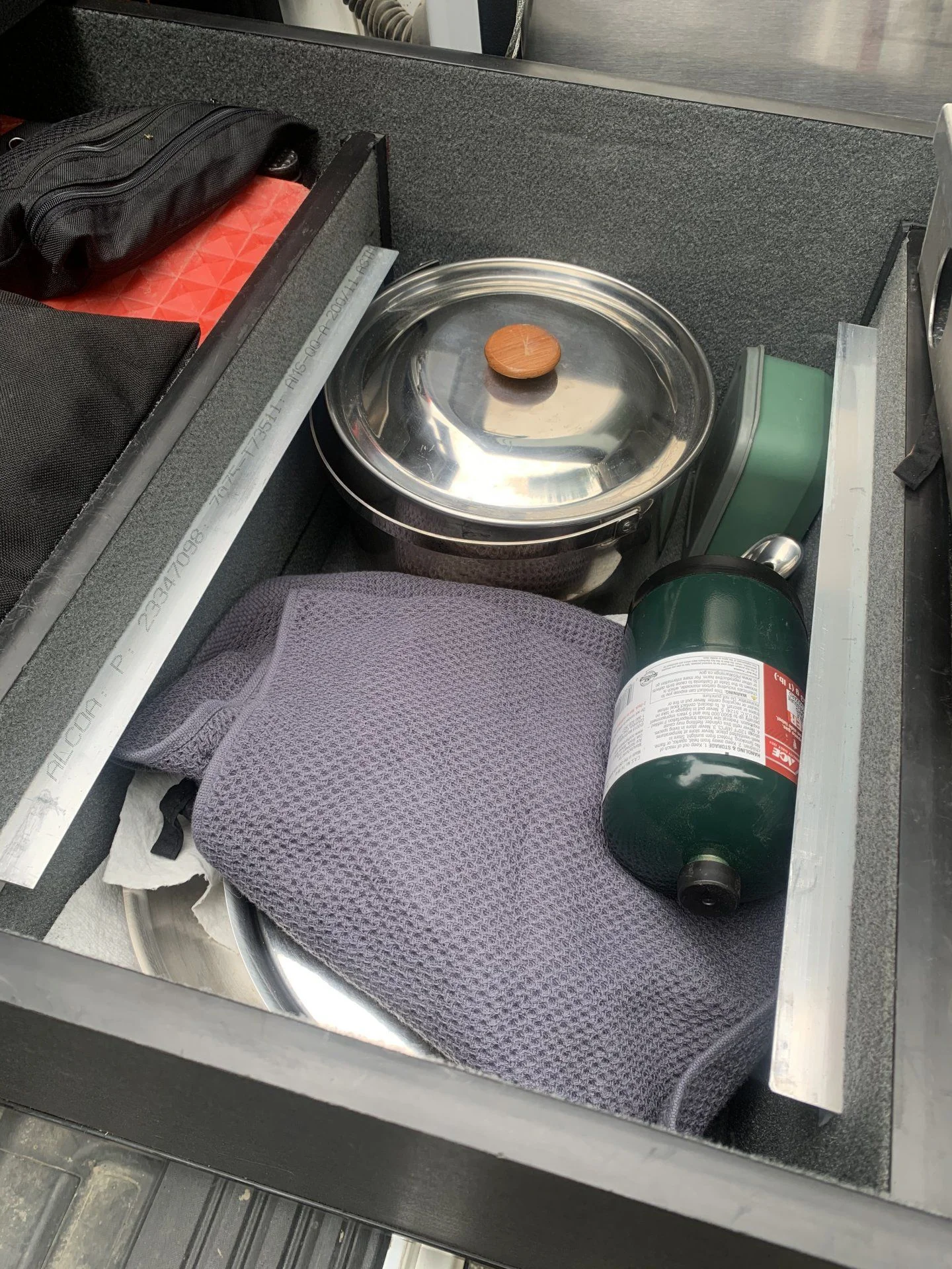

One thing that stuck out quickly on my last big trip by the second night of cooking was my cookware and stove storage. Prior to my simple fix the stove was stored at the bottom of the drawer with cookware stacked on top. If needed to warm a pot water I had to unpack all my cookware, lame. Simple solution was to reverse the stack. Place the cookware under the stove. I grabbed some 1’x1’ L extrusion from the scrap bin at work, buffed the edges, and screwed them the the drawer dividers.
The tea towels and pot holders serve two functions, primarily the intended function but also noise abatement for clanging pots and pans.
