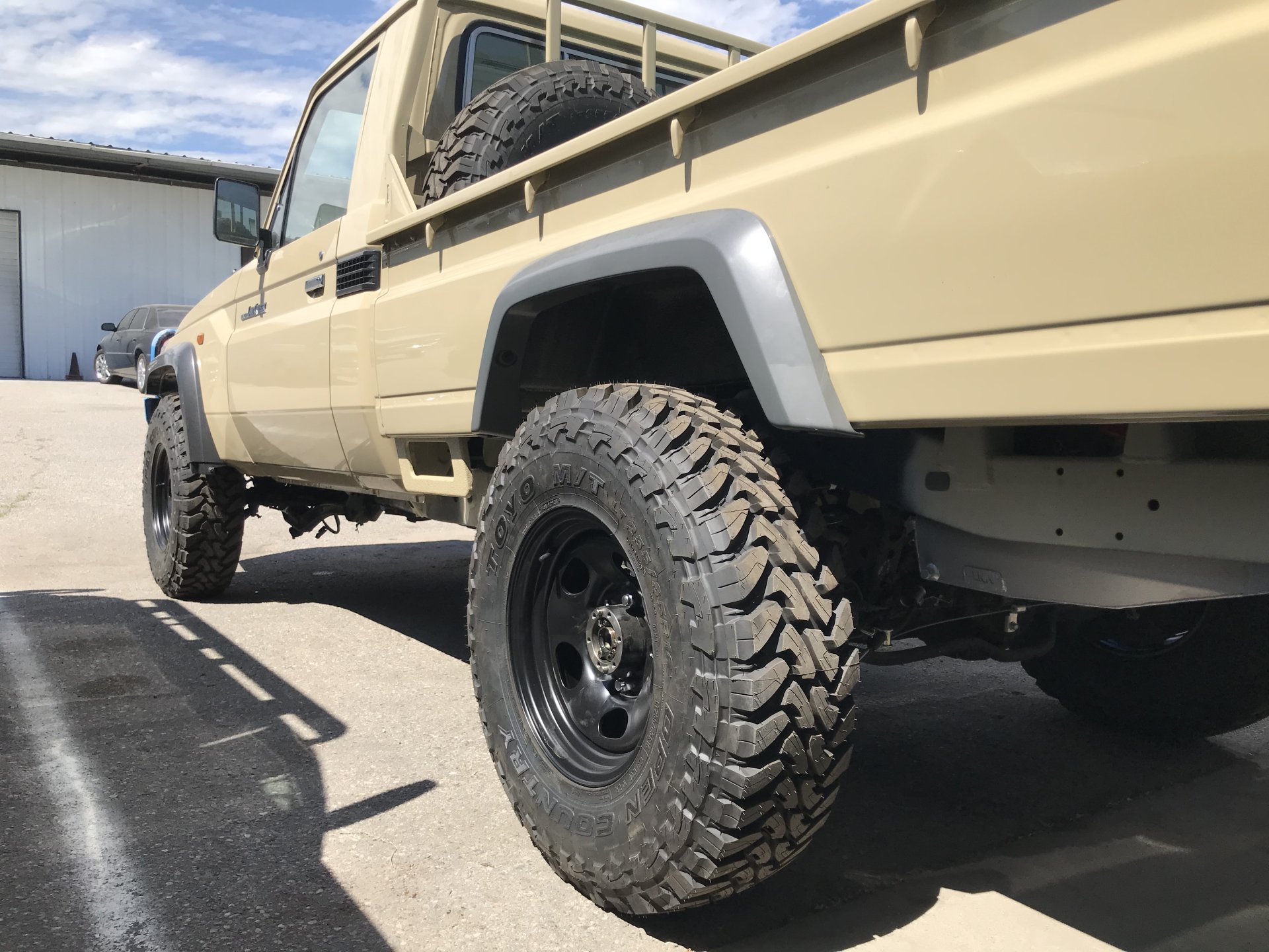

Bro, this is an 80-series chassis, this bumper is made for a 79-series chassis.
Our build is a 79-series body on an 80-series chassis (frame) custom fab is required. 😉

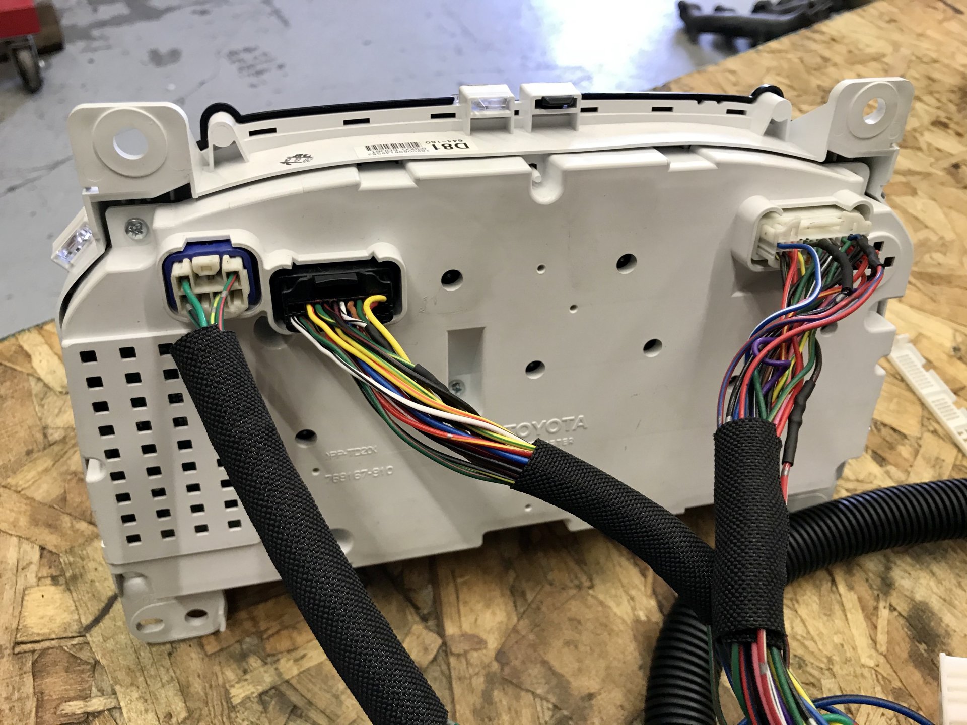

We did an FTE swap in the owner of this Cruiser 80-series as well. I am a fan of the FTE, FT as well but the FTE is just so smooth and good in a variety of ways. ECU is from a HDJ79. We also have some Russain spec HDJ100 ECUs that never came with an immobilizer. Wiring harnesses are all new in this build, from Toyota. Engine harness is a modified HDJ79/78, cowl/dash harness is a HZJ7x, cab and rear chassis are GR & HZJ 70-series. It is what we were able to source new. The cluster is GR79, it is new as well and was sent to us early on before the build even started or we had the harnesses. We are going through all the harnesses and mating them up, many wires de-pinned and moved and lots lots more. In the end though it will be all new harnesses that mate up using Toyota connections.
Sure the tach is off redline wise but if we can make it work why not use it? Finding a new HZJ78/79 cluster just to have the correct red line? We could but the clusters cost a fair share too.

This truck is a brand new 2018 model and it’s been pretty critical to use a brand new cluster on this truck. I already have this exact same engine/trans combo in another truck and redline is around 4000. There really is no reason to take this engine over 3200 RPM - I don’t need the redline to tell me that.
There are a heck of a lot of 79 series with FTEs and 1VDs (and probably all sorts of others) that did not even have tachs from the factory. It’s just not necessary and I would rather have the new tach even if the redline is not precisely correct for the engine.
What a fantastic way to salvage the ugliest factory bumper this side of a Pontiac Aztek.
Now I wanna steal this idea as I have two of those bumpers in boxes.
