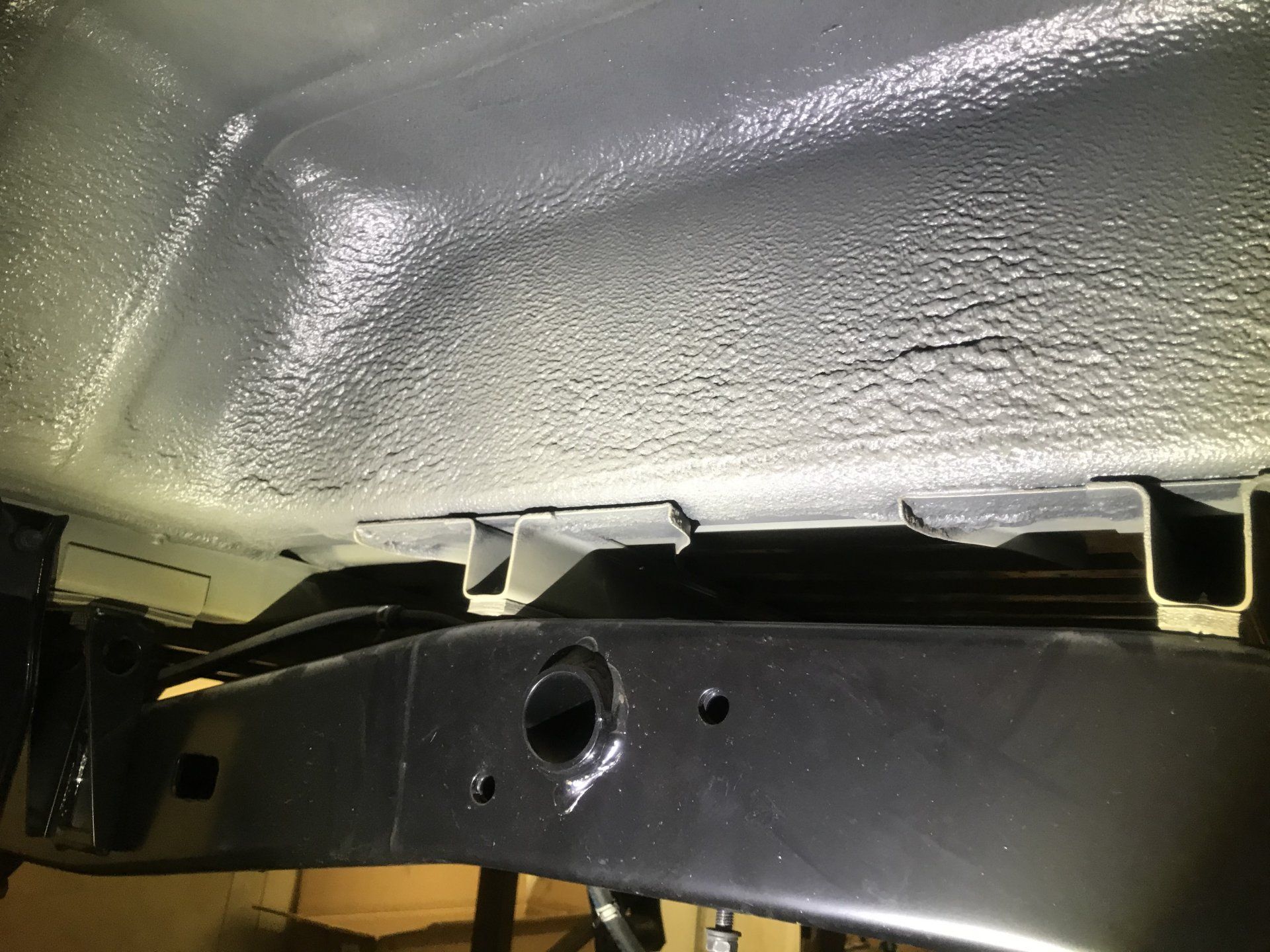

We painted Johns FTE long block today and started assembling it.

The bed is going out early next week for a color match LineX. 😁
