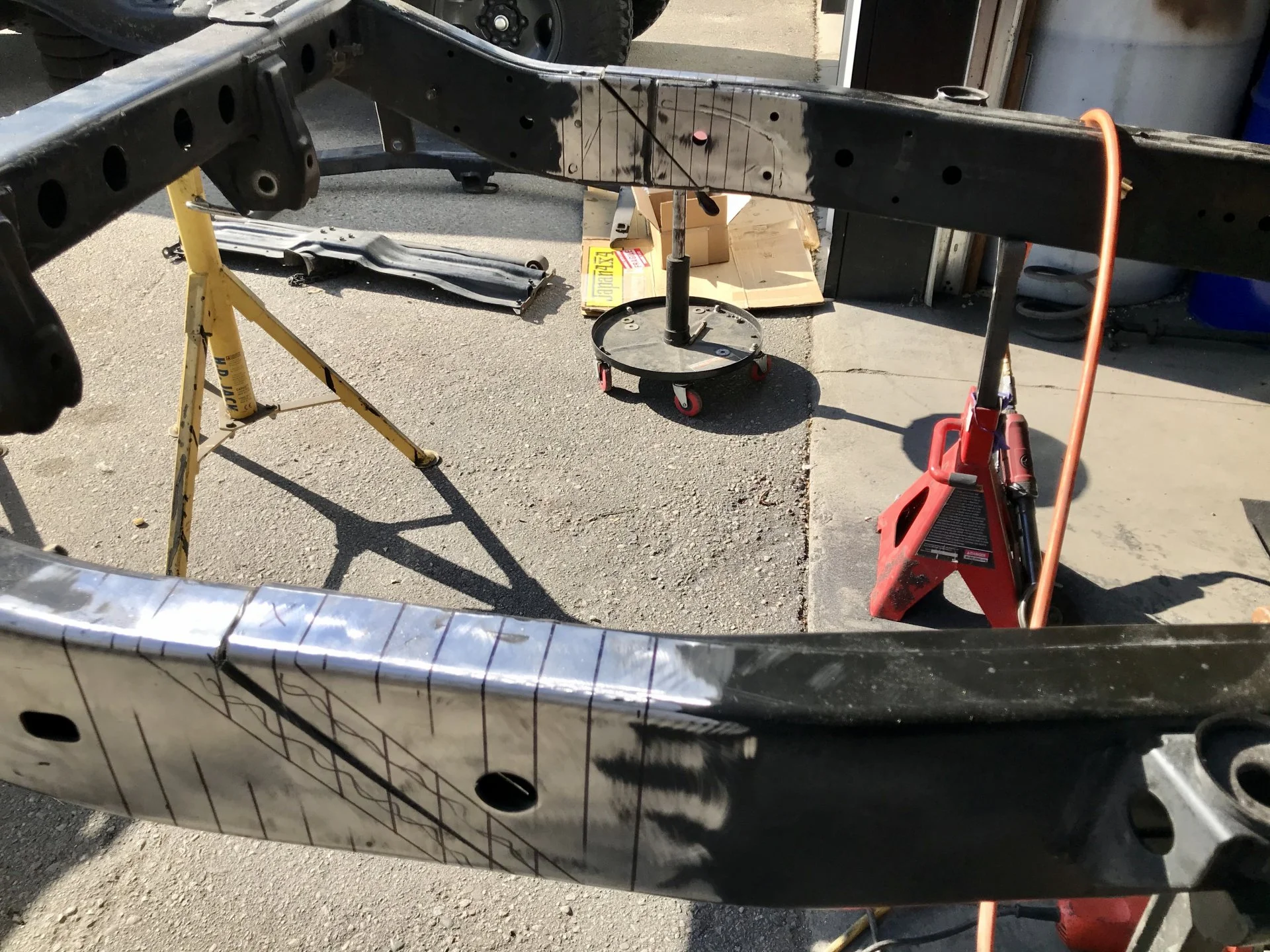

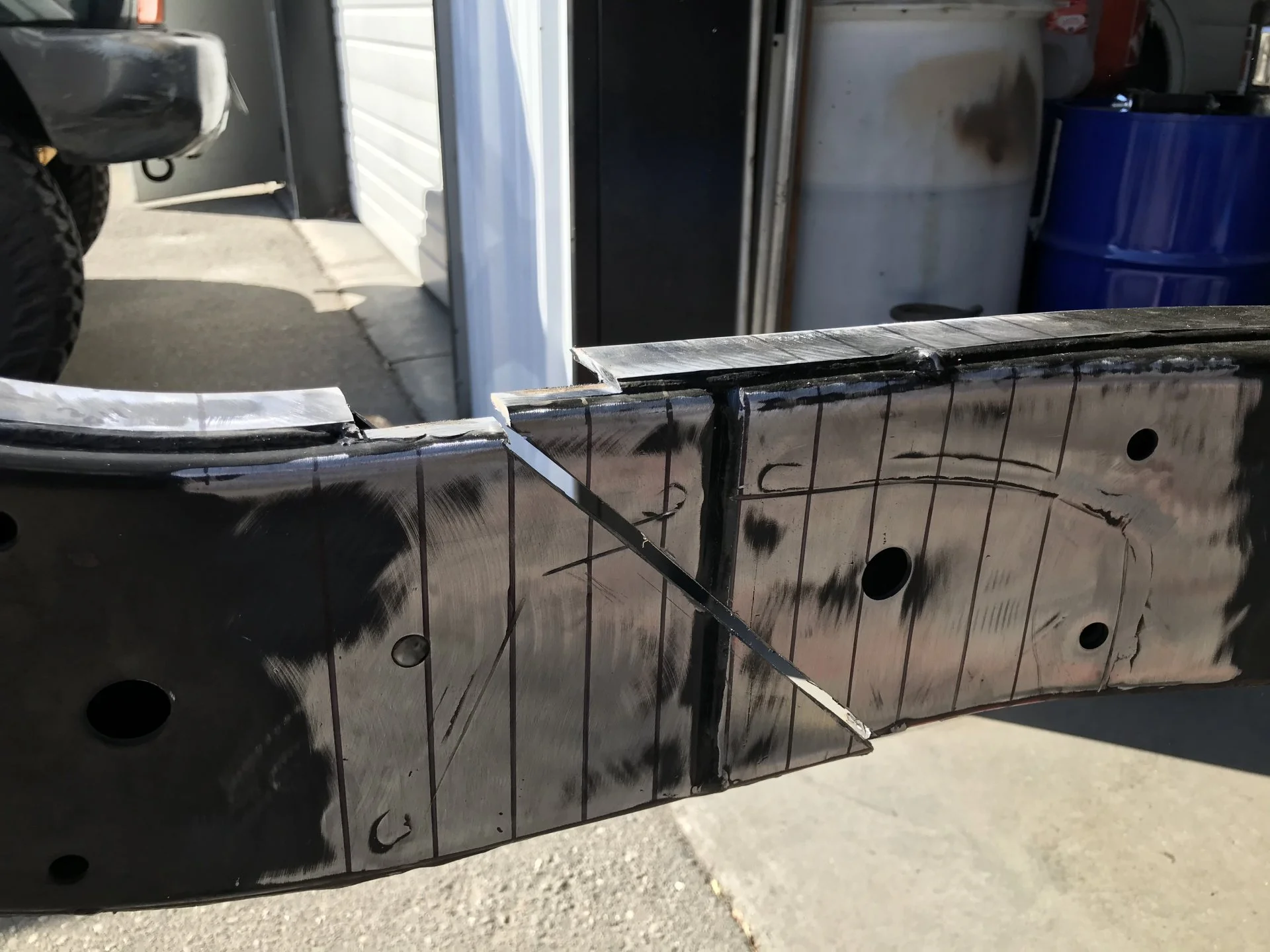

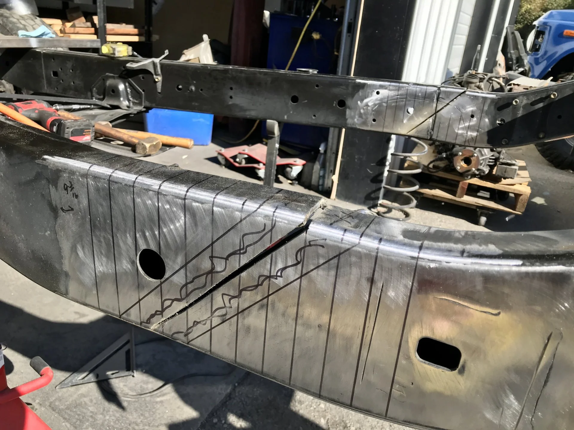

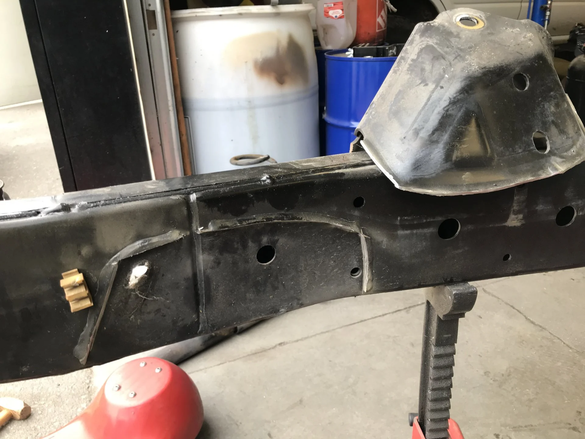

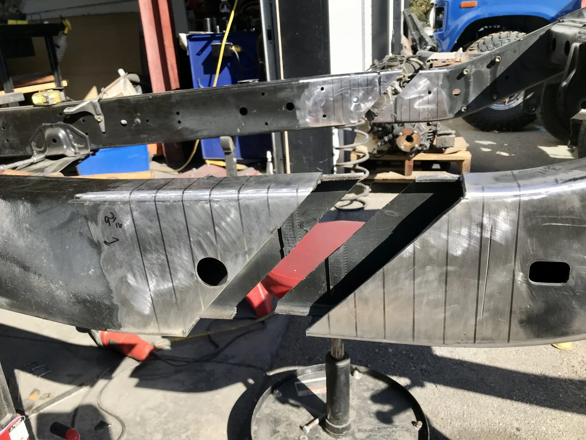

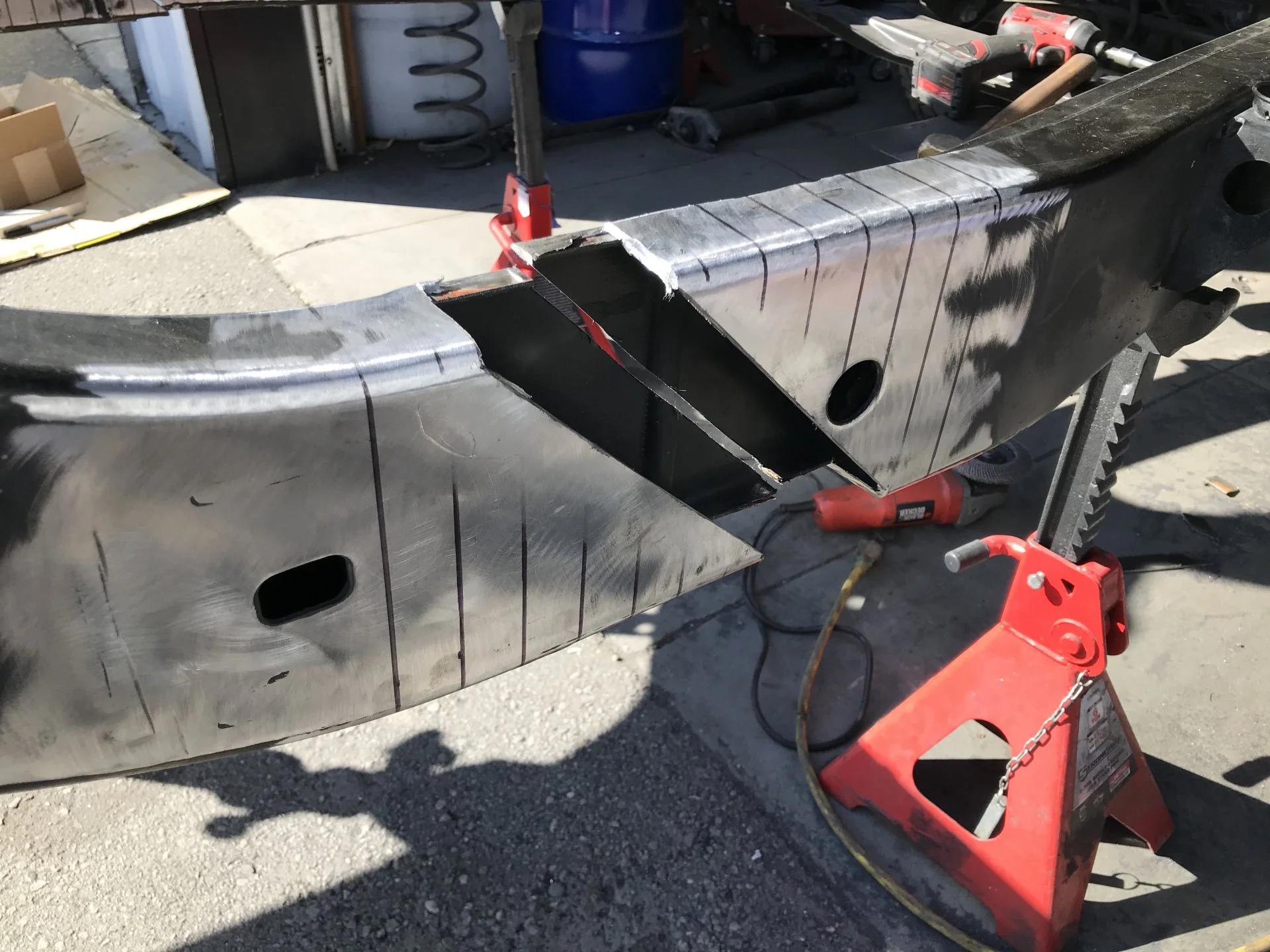

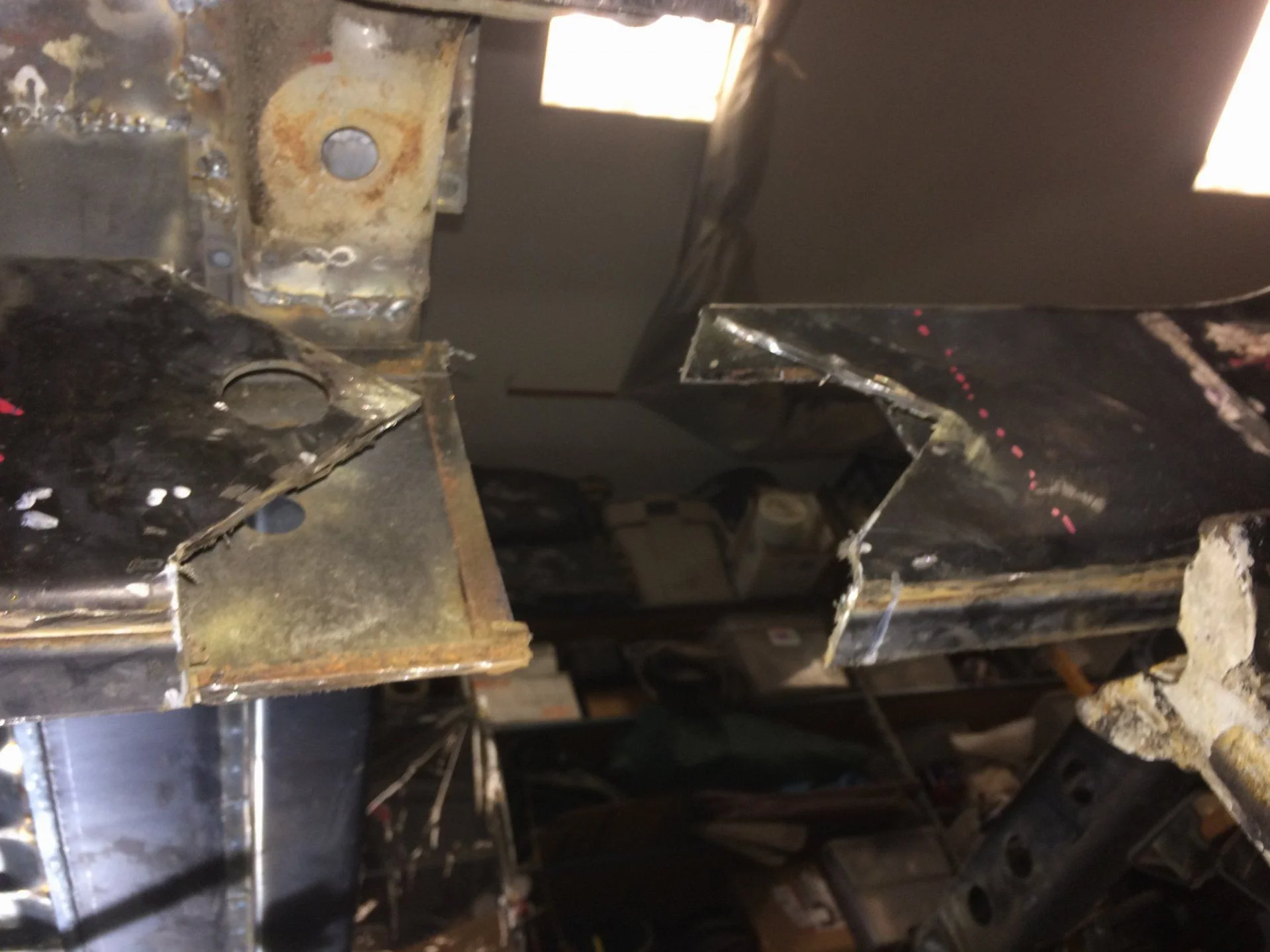

We were trying to get our inner rail tacked in before going home but an hour after we normally close and it still was not lining up perfectly. So we decided to call it quits today and start fresh with layout tomorrow. Only the rear is tacked on the inner rail.

Also, in case you are wondering about the funky cut being offset inner to outer rail, we are offsetting these on purpose. The point being, more strength with the welds being offset inner to outer rails.
