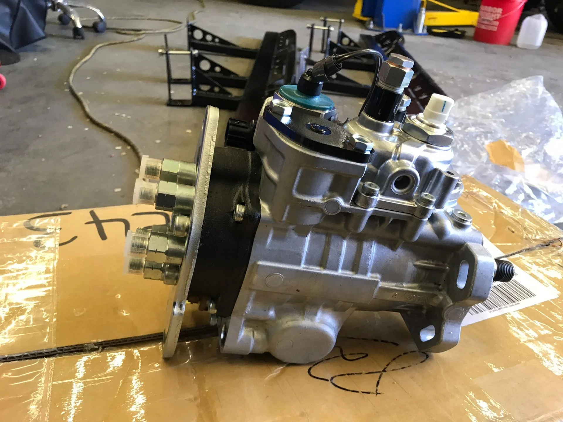

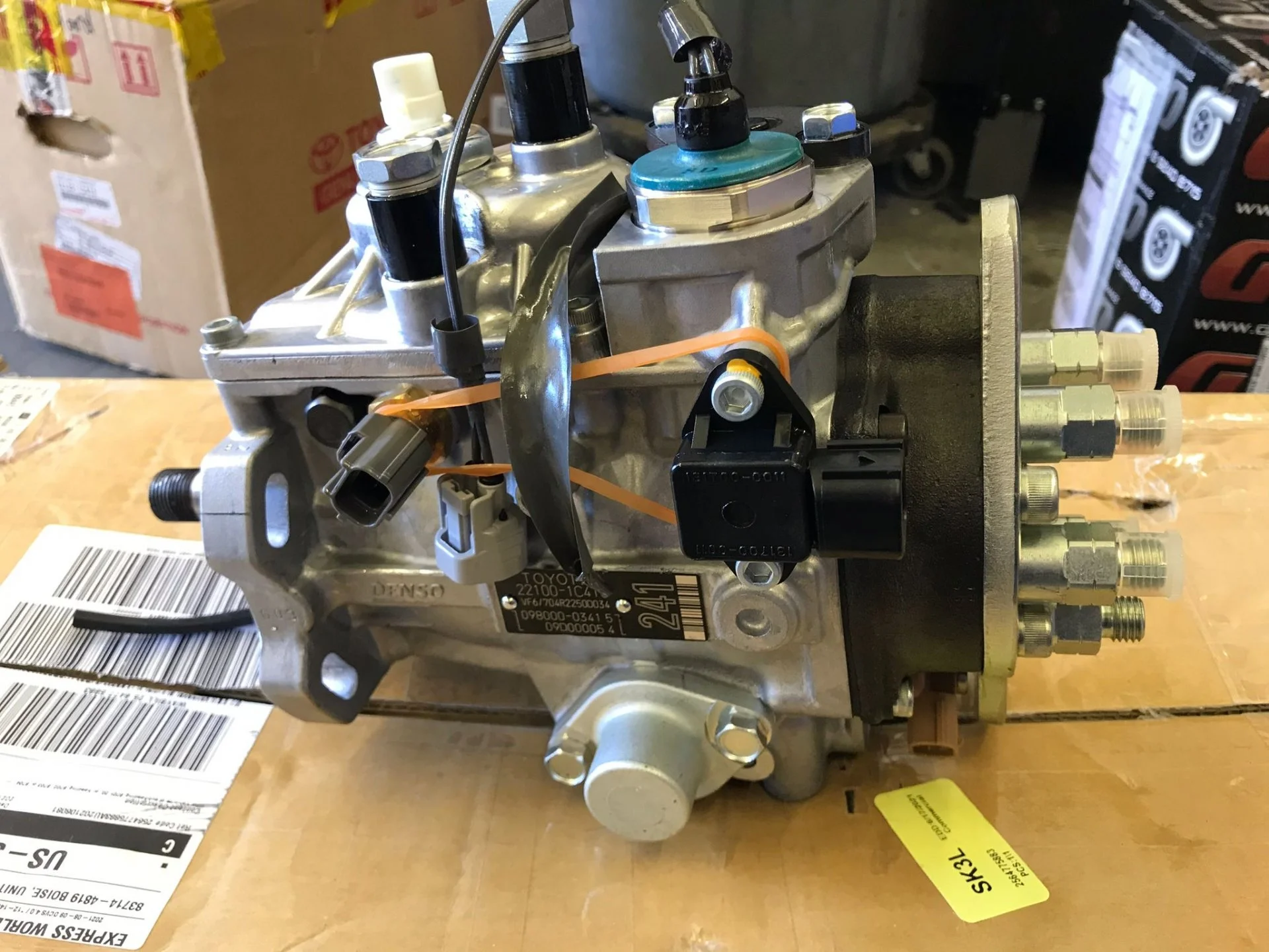

The positive develop on the harness side of things put me in a better frame of mind with this truck. But it got me thinking about the engine choice and have been concerned about having two really similar but also really different engines (the FTE v FT). We have the new FTE short block so.......after a few emails with GTurbo it looks like @SNLC is going to be building this engine as the electronically controlled FTE. GTurbo is going to supply us with a new and improved FTE injection pump, injectors, turbo and a chip. Thrashlux is going to supply the FTE ECU, harness, pedal, etc., and it should plug right into the harness @Onur procured.

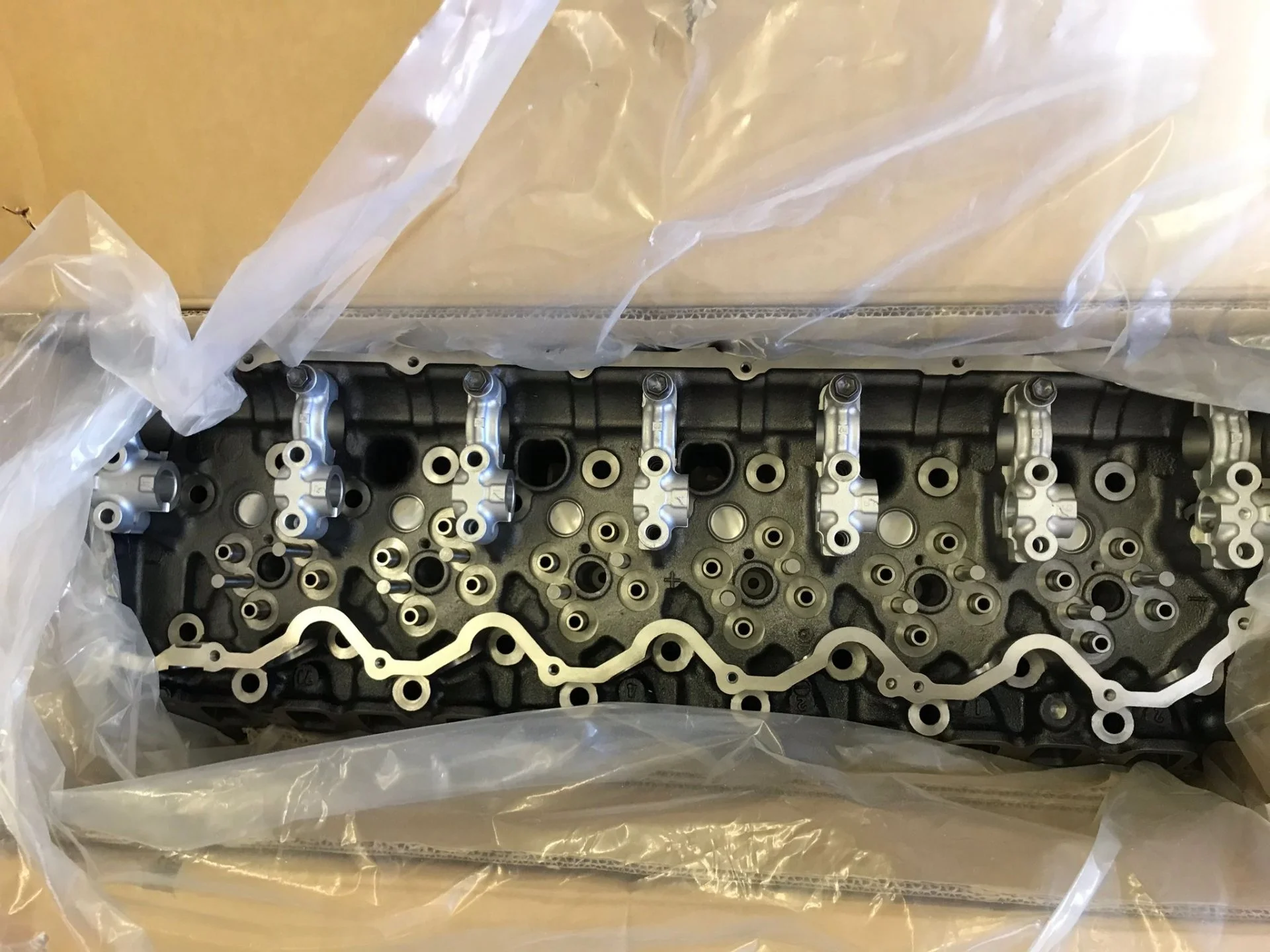

The truck has not been abandoned. Just waiting on some parts. I hoped we would have been able to utilize the head that came off the HDFT I had “rebuilt” for my 80 series but the machine shop said it was so jacked up and beyond saving. We now basically have a brand new FTE as we already had a new short block and this new FTE head plus all the new components will complete the package.

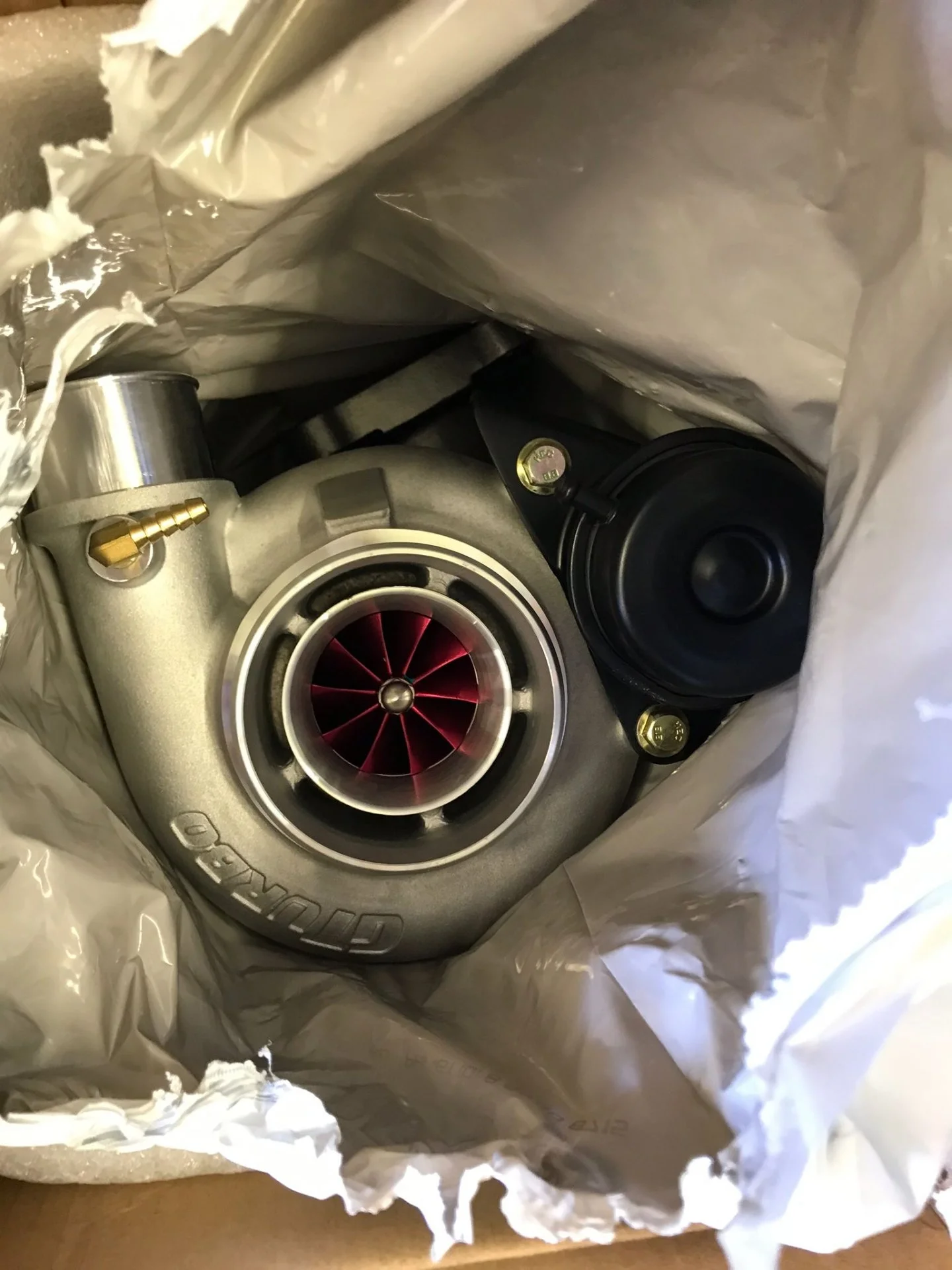

The Gturbo delivery also happened today. Sneak peek

Are you going to be using GTurbo's tuning module on this one too or exploring different options (Unichip)?
Same thing I said in the pm.
Currently GTurbo does not have one available. They decided to redesign or redo theirs, Unichip is building it. A few months ago they said it would be a few months before it is available.
Cheers
Cheers
They used to run DTE modules which from a tuning perspective were decent (IMHO based on having @Indestructible 47 truck on the dyno and meddling with things), but found the harness unreliable, rough ground and it would bump off the plug and she'd go back to stock which was frustrating.
