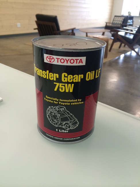

Just received this email from Toyota Corp on their 75w transfer case fluid. What’s everyone’s thought on this?
I’ve only seen the 75W spec on the Torsen diff equipped models...LX,LC,GX and 4R Limited
Ravenol 75W is widely available
The 75w is spec’d for the new Tacoma’s and tundras as well but no dealership stocks 75w or even heard of the weight. All said they get the cheapest (Valvoline 75w90) bulk oil and use it for all transfer cases.
Also the LC in Australia is spec’d to use 75w90 GL5 for their transfer case. Not sure if they use the same transfer case or not but thought it was interesting. Gotta love oil talk haha
A lot of doubt was instilled my many of the oil companies. At the time I changed mine the first time 4 years ago... Amsoil for instance wouldn't even recommend one of their oils for the transfer case. They simply said no substitute.
I always wonder if just ignorance, outright deception, or both when dealers/manufacturers claim they haven't heard of a common issue or even oil that there is a company product number on.
The Ravenol 75W wasn't widely talked about when I changed mine so just sucked it up and went with the golden fluid. I'd be comfortable using the Ravenol.
PN: 08885-81080
BobIsTheOilGuy Thread
This Toyota 75W says it was made by EMG Marketing Godo Kaisha
EMG Marketing Godo Kaisha markets and distributes petroleum and petrochemical product. Its products include motor oil, gasoline, jet fuel, kerosene, diesel fuel, fuel oil, lubricants, LPG, paraffin wax, and asphalt. The company was formerly known as ExxonMobil Yugen Kaisha and changed its name to EMG Marketing Godo Kaisha in May 2012. The company was founded in 1961 and is based in Tokyo, Japan. As of June 1, 2012, EMG Marketing Godo Kaisha operates as a subsidiary of TonenGeneral Sekiyu k.k."
I can't seem to find that Valvoline straight 75W anywhere... wanted to see how it price compared to the Ravenol.
Maybe just coming on the market?
