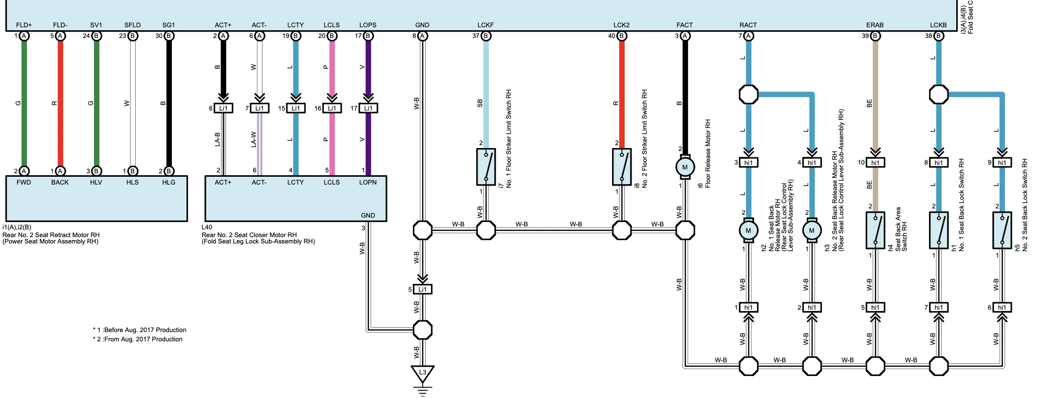

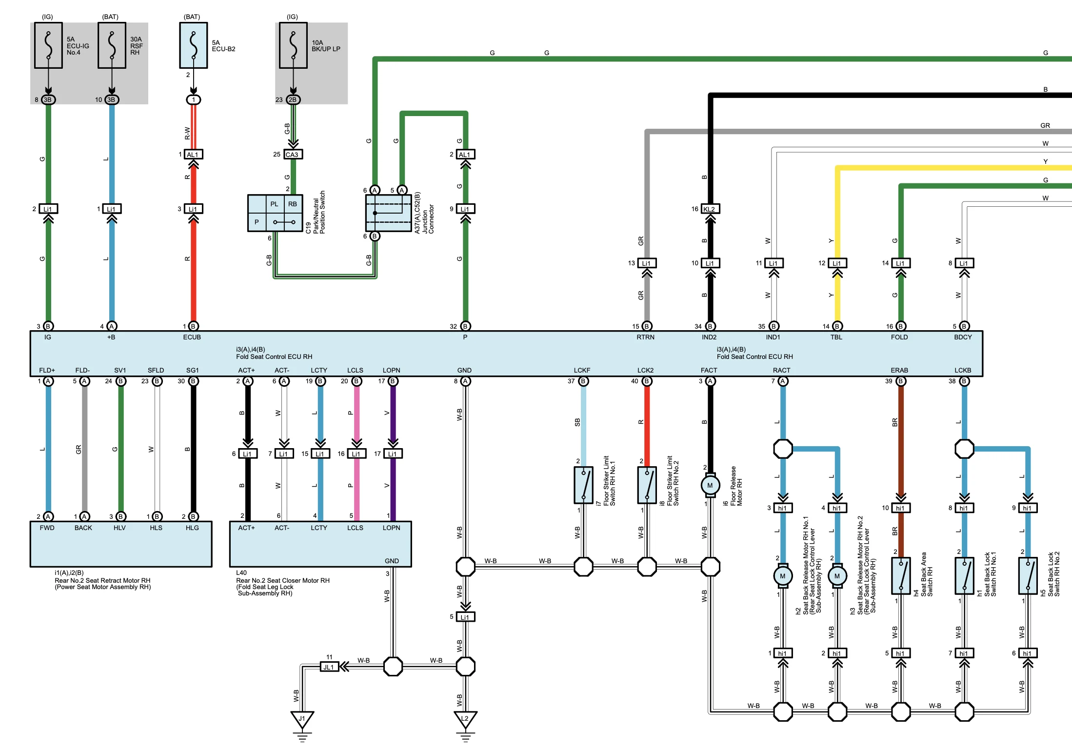

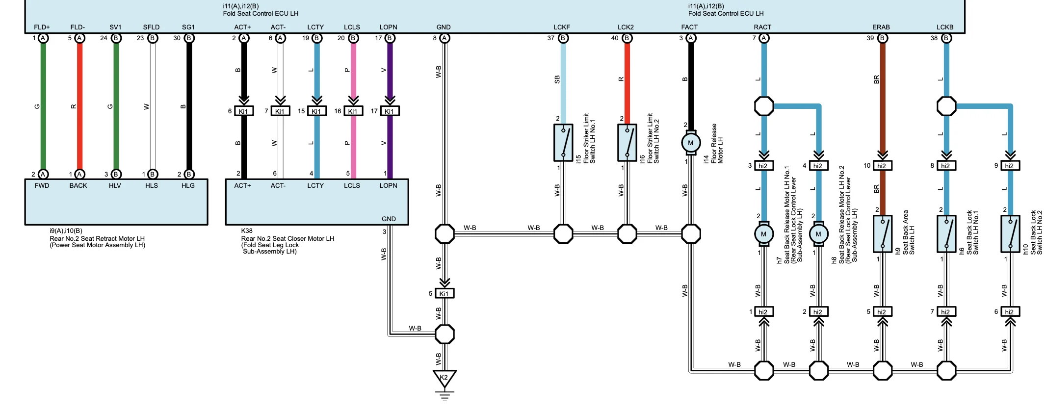

Just checked the wiring diagrams for 2013 vs 2016. There are minor differences in wire colors, in some cases, but it looks like all of the connectors and pin assignments are the same. Meaning at least electrically, the early seats should work with a later LX.
2013 right seat
2016 RH
2013 LH

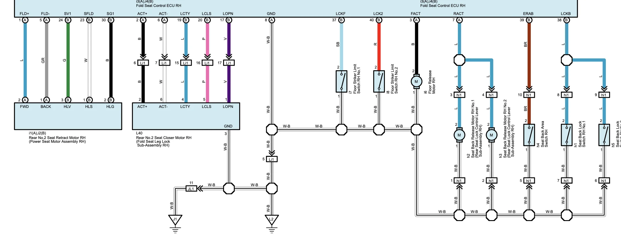

No, without knowing what the seat ECU does to those wires before sending to the seat I can't confirm that. The only one I'd be comfortable tapping would be the +B into each seat ECU.. each has a 30A fuse from the battery, light blue on the RH ecu and red on the LH. I'm attaching the broader seat wiring portion for one of them from a 2013 LX
@bloc, perfect. Now that I see the top side of the schematic, I can see what you're talking about with the 30a fuse. Just checked the connector on the right side in mine and the blue 30a feed wire is definitely bigger than the rest.
