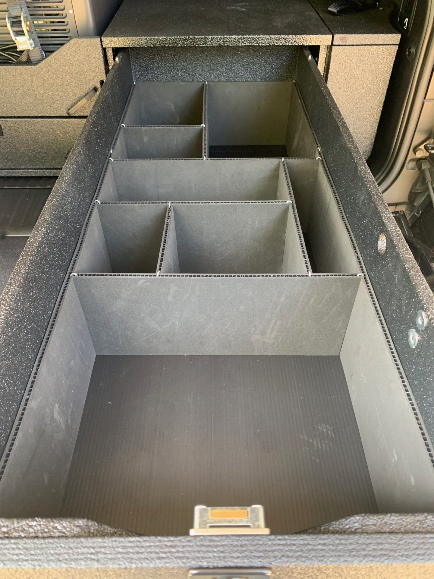

Made up some DIY Trekpac organizing dividers for the drawer system they work great and can be reconfigured in seconds.

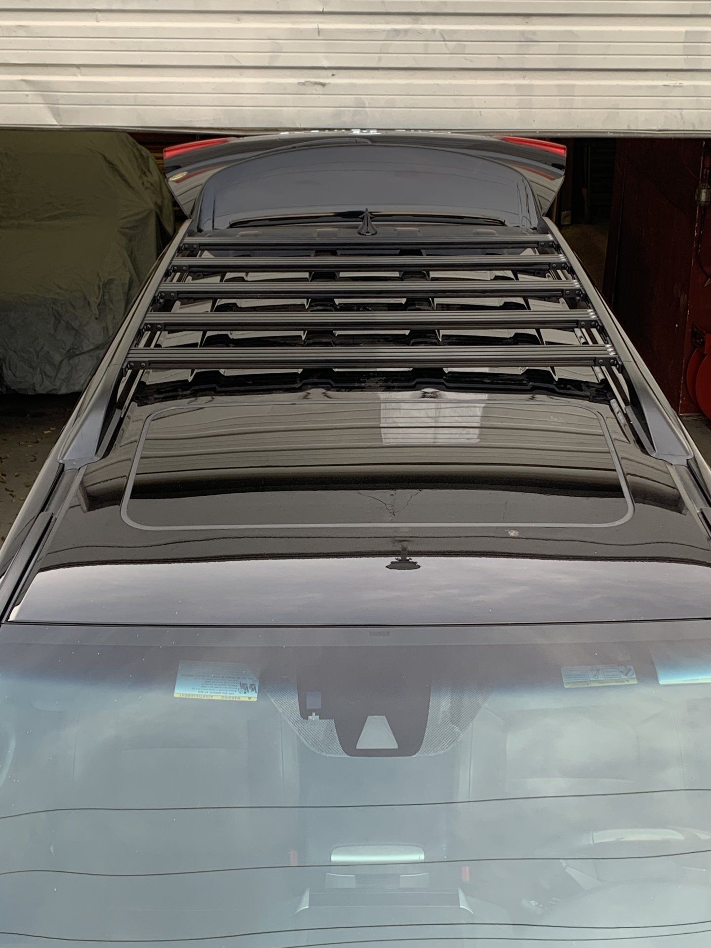

I got around to the quick and fun DIY 80/20 Factory Rack Mod, the only place I diverged from what @tbisaacs and others have done was to use the 1030 profile that is a wider three-slot version. I really like the way it looks in that as my daily it looks OEM to most anyone that isn't on this forum but when you are ready to gear up for a trip it has all sorts of expo attachment options both self-fabricated or off the shelf from Frontrunner etc. Wax your roof well when you have the factory crossbars off, there never be an easier time to do it!
Great build! Would love to see more detail on the DIY Trekpac. Looks super clean. Did you laminate with 1/8" foam?
Thanks! I had this material gathering dust for the project and then @Overland Tailor beat me to it with a nice Trekpac DIY thread that finally pushed me to follow through with it. It's a fun and easy project that was really rewarding because of the quality of the outcome. If I remember correctly the only place we diverged in the build was I used a table saw and crosscut sled to cut up the material after laminating. The cost delta between doing this yourself and buying it is pretty large. Highly recommended.
I don't know how I missed your build thread, glad you bumped it. Currently waiting on my trekboxx so the timing is perfect! Awesome job! Thanks for the Trekpac links. Exactly what I had in mind, nice to see others have already done it. I like the idea of laminating a full sheet and running it through the table saw.

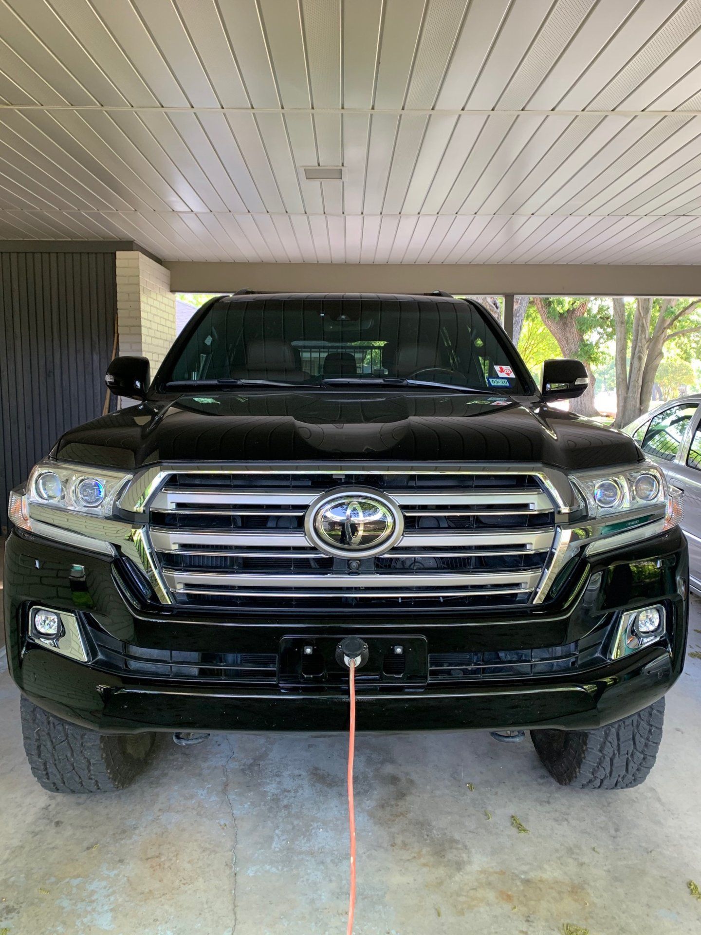

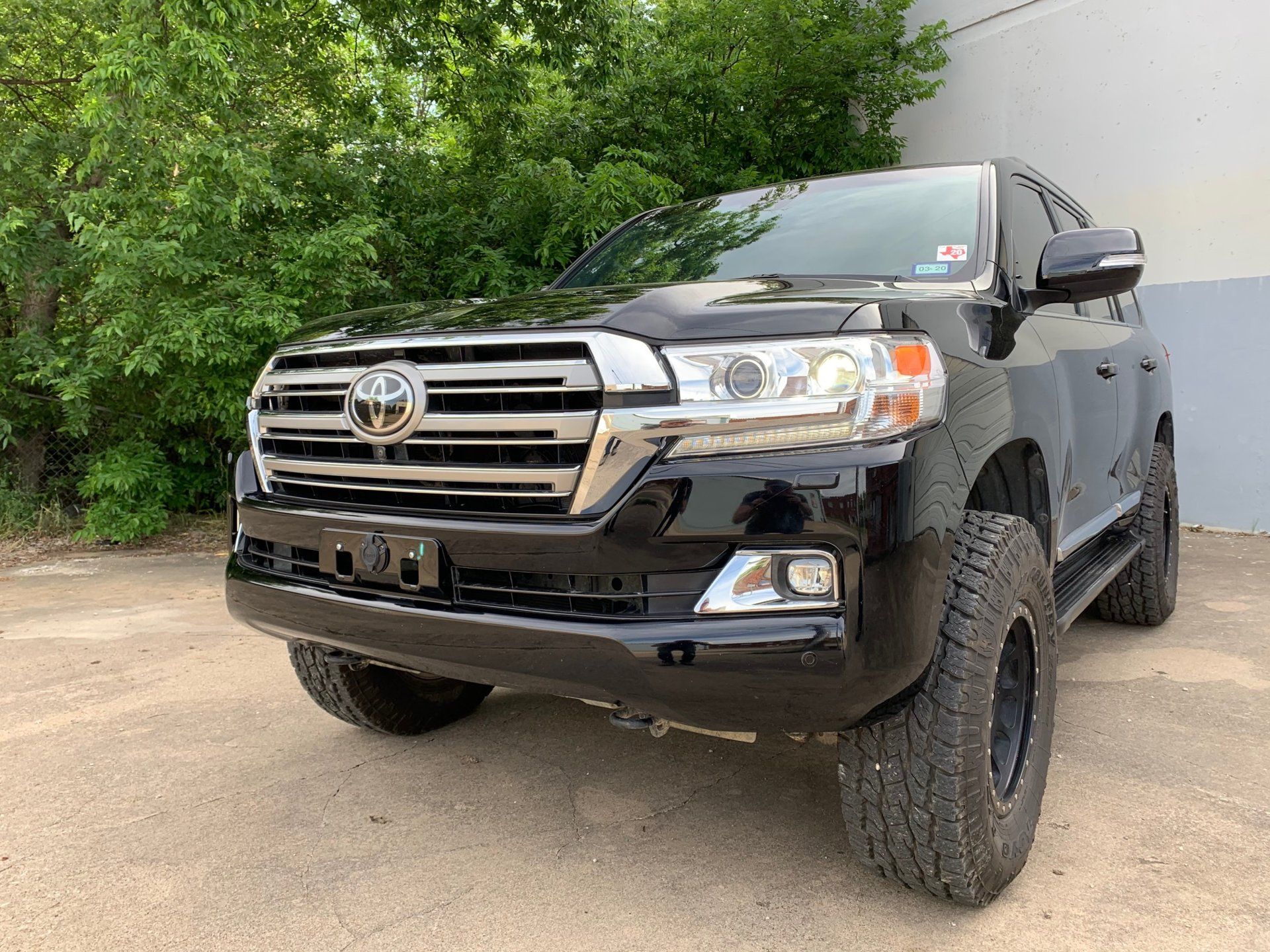

Yesterday I finally got the weatherproof NOCO receptacle installed - Amazon product ASIN B07TJJQP1S
I had intended to install in the driverside lower air vent just to the left of the driver fog light in that small solid portion of the vent. It was going to require some modification of the vent plastic to create a flat area to mount and to the plug itself since the diameter was a little larger than the vent. I completely removed the bumper plastic, the grill and fog light in an effort to get the vent removed for modding before I realized I had a much easier and better location staring me in the face. The flat area for the front license plate has nothing immediately behind it and allows a perfectly flush install.
If anyone else would like to do this you can do so without removing anything but the plastic shroud in the engine bay to access behind the grill to run your wires. So much simpler than what I was attempting and a better result. I had hours invested in what can be done in ten minutes but I'm pleased I landed on this alternative and I think it works great.
Note- TX is a front license plate state but it's never really been my jam wherever I've lived and I've never been hassled about it. If you want to run one or I decide I need to in the future I think one can find a flip up/down plate bracket that would be pretty cool and conceal the plug behind the plate.

Glad I'm not the only one who procrastinates like this. I believe you qualify as a plug-in hybrid now.
Eight to eighty in only six hours.

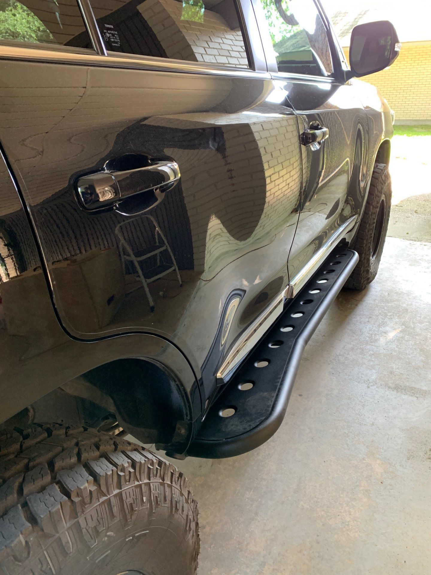

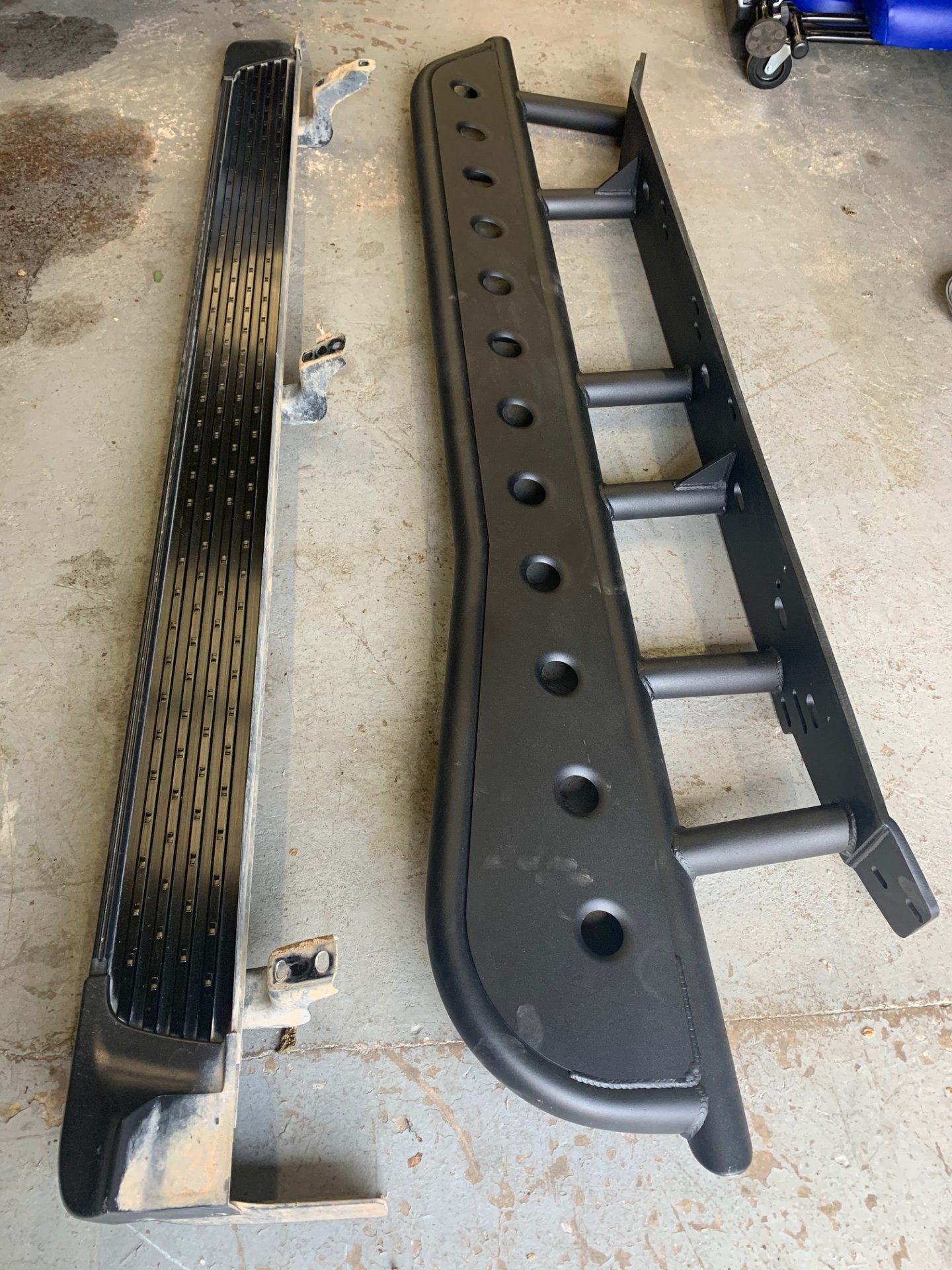

Honestly, the Budbuilt install video that @Taco2Cruiser posted recently made it quite straightforward, if it hadn't also required the relocation of my rear Icon remote reservoirs it would have been under four. Nothing difficult about this install if you have some patience a floor jack and a couple of tools. I'm very happy with the quality of the fabrication, they are built for the hardest of use and they look amazing. Thanks Budbuilt!

I have the same BudBuilt sliders I am getting ready to install and will also have to deal with relocating my rear Icon remote reservoirs. Would you mind posting a few pictures showing where you relocated them and any tips for that part of the job? Thanks!
I am so stealing that idea for the drawer dividers. Now that I've had my drawers for a couple of years, I can decide what needs to go where, and what I really need to pack. Very cool and simple solution. And it so cheap that it's no big deal if you want to change it later.
Are the landscaping staples stronger than just bending up some coat hangers?
I relocated mine to the body from the frame in same area under the rear doors where they were before. It was a PITA because you have at least three different slider bolts there to deal with and once you attach the RR you can’t remove the bolts without removing the RR. This doesn’t make sense to you now but when you are doing it it will because some of the bolts have to go in and come back out for additional washers once you have sucked the slider up close enough to fit them. There is zero extra room there with the RR taking all the available space and with the big stiff hose the whole slider has to be virtually taken off to move the RR out of the way.
I got it done so it’s not impossible by any means but honestly if I hadn’t got so far down the line I would likely have looked into relocating to the rear wheel arch frame and may still do that if I see others have success with that location. Good luck, and if you have different RRs than I do the hose length may dictate a better location than mine did.
Yes, that’s such a great mod per dollar spent! Those drip irrigation staples work like they were made for it and they are cheap. Tag me when you finish it up I’d like to see your set up.
Thanks for the details. Greatly appreciated! I have seen a couple people relocate the reservoirs on the frame, behind the rear wheel. SDHQ, a shop in Gilbert, AZ, did that with a 200-series they installed the Icon lift and sliders on. Rear wheel arch frame certainly seems like an option as well. My tires are narrow enough that I don't feel they would rub the reservoirs under heavy articulation, but would have to make sure.

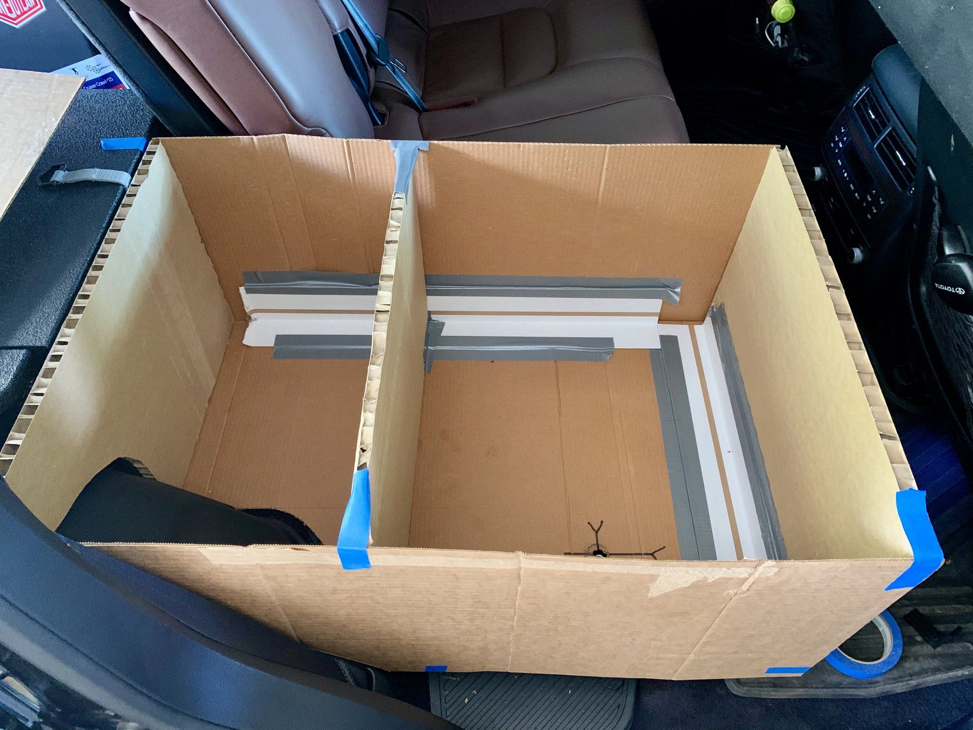

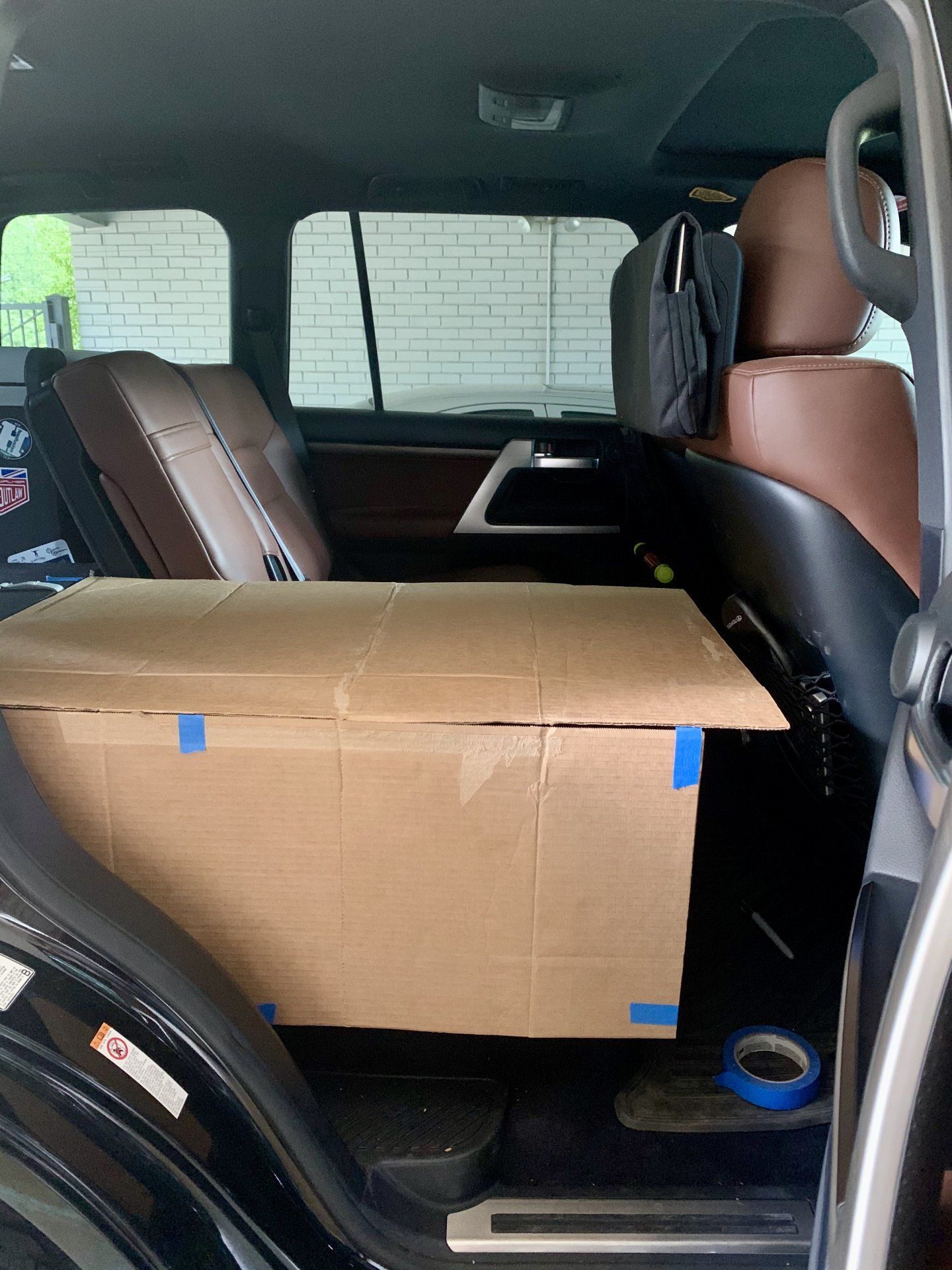

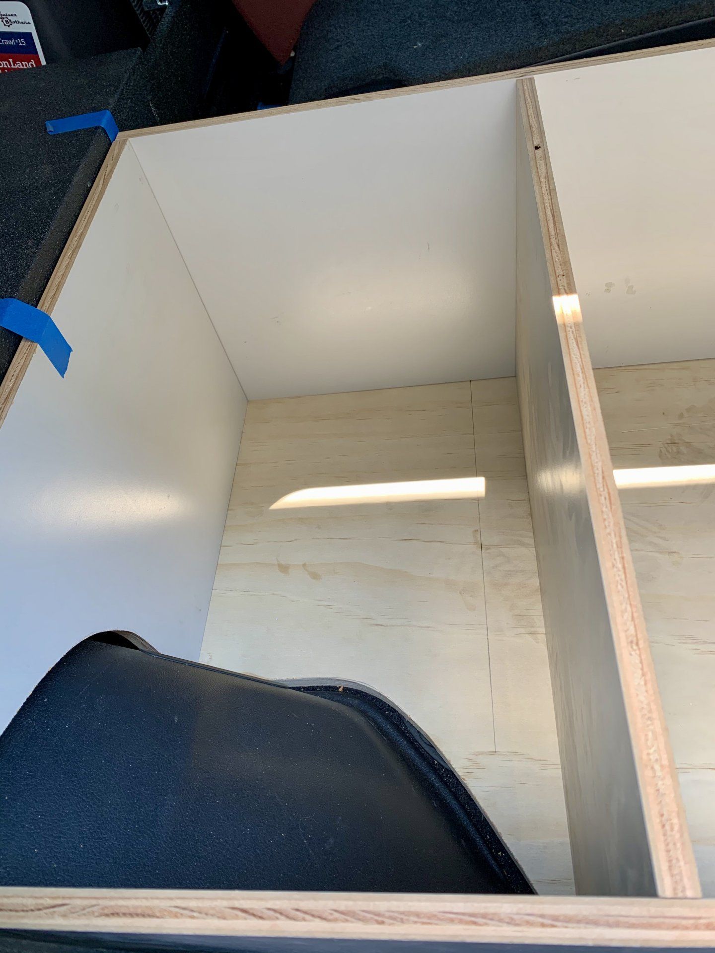

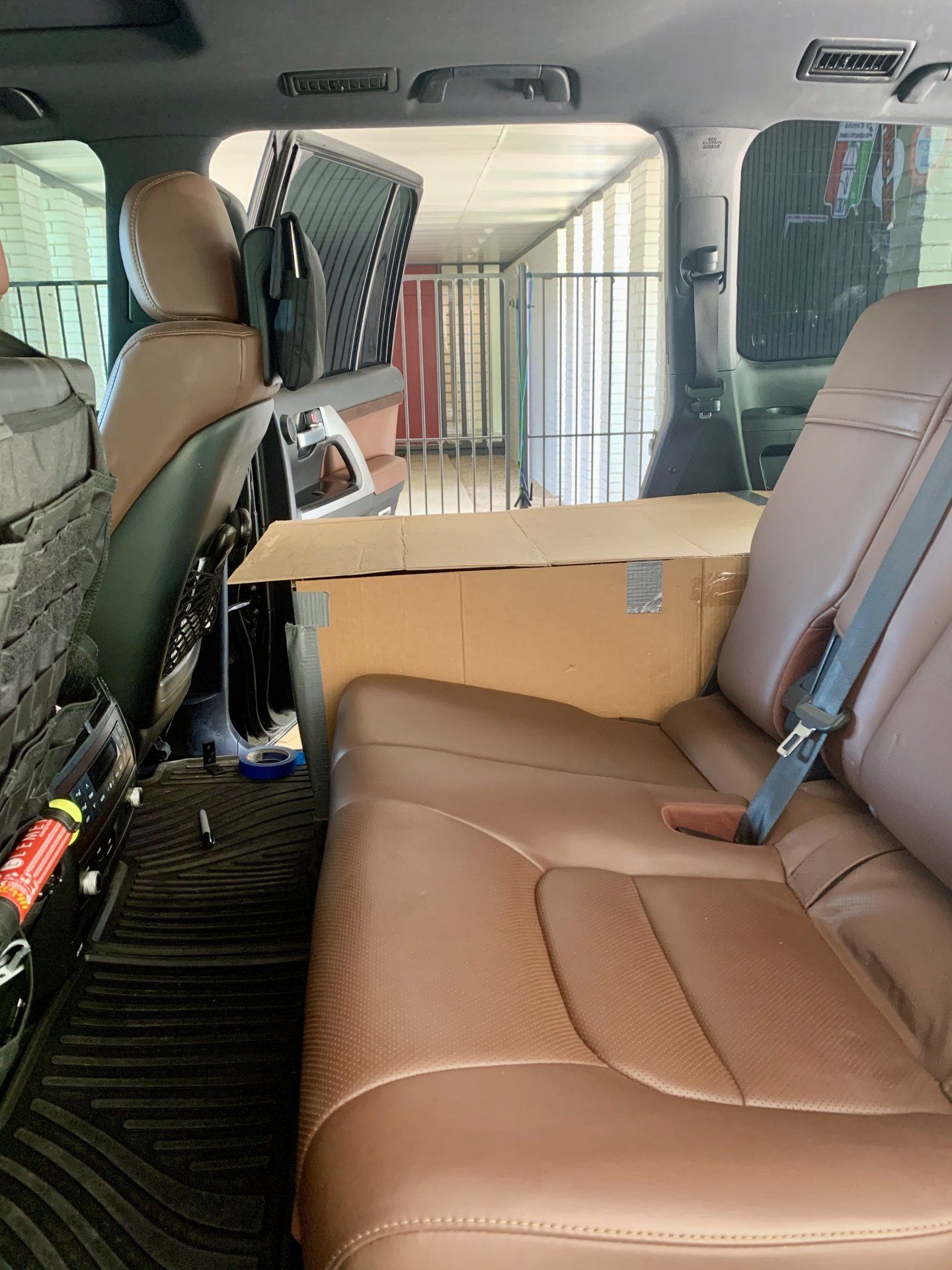

2nd Row storage mock up in progress.

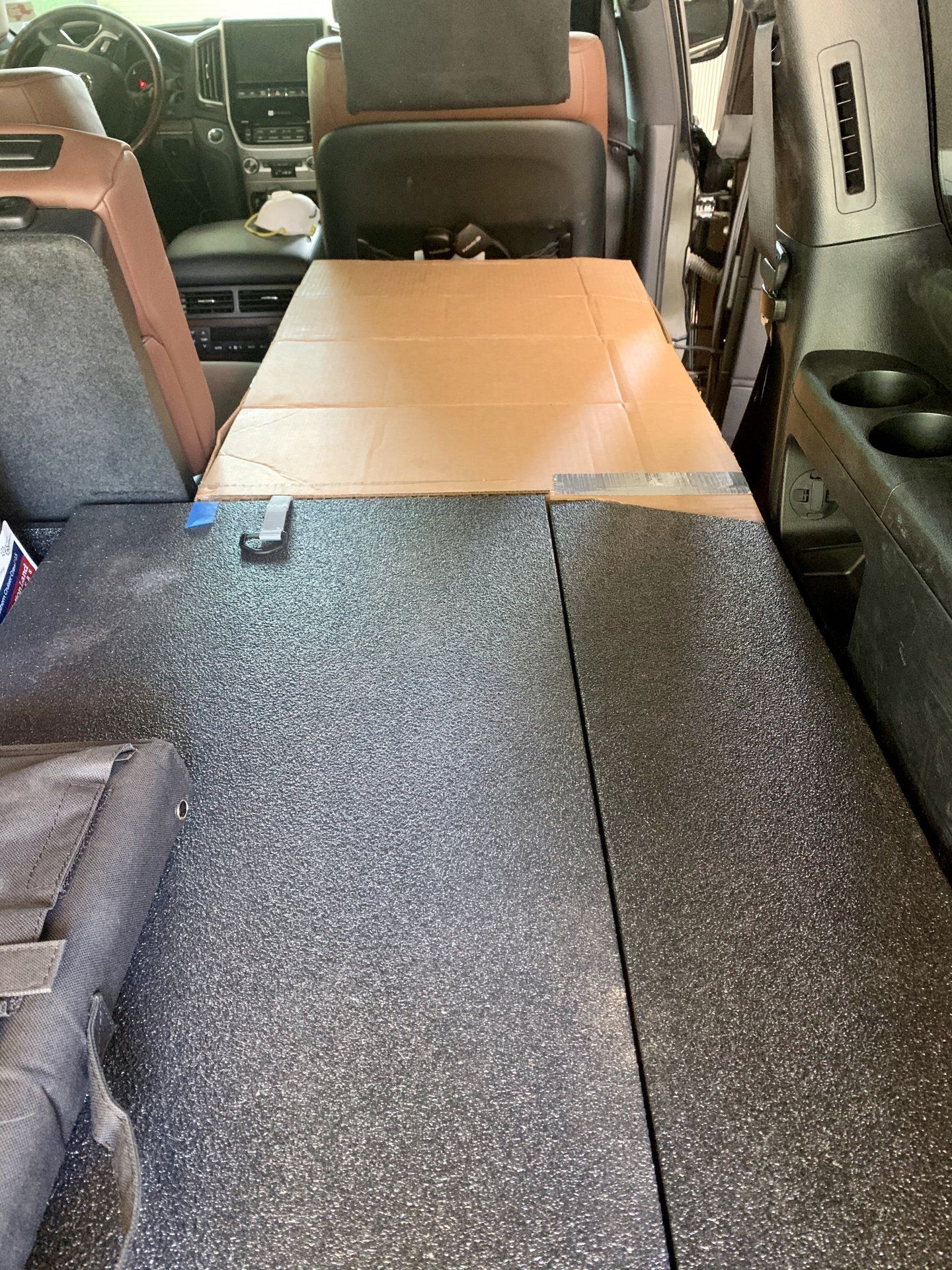

I want to add some more secure storage and improve the sleeping comfort when on solo trips by the elimination of the 40% portion of the second row. there are three of us and on family trips I think this would be ideal for our needs while keeping the larger side and maximum space for the rear passenger. I saw @indycole had a new deck installed recently and I thought I'd throw up my pre-production ideas for feedback from him or others before I go to my workshop and make dust. @Markuson I think you have done something similar too? Anyway, if there are practical ideas that might be worked into this I'm open ears.
We place a big emphasis on trying to travel pretty light and everything having it's place, I also like to see out the back window when on the highway so we keep everything down below the height of the fridge when packed presently and this will make that even easier. The two compartments will each have a hatch access from the top with lever compression latches to secure them. It will also be removable without much effort.
What do you guys think?

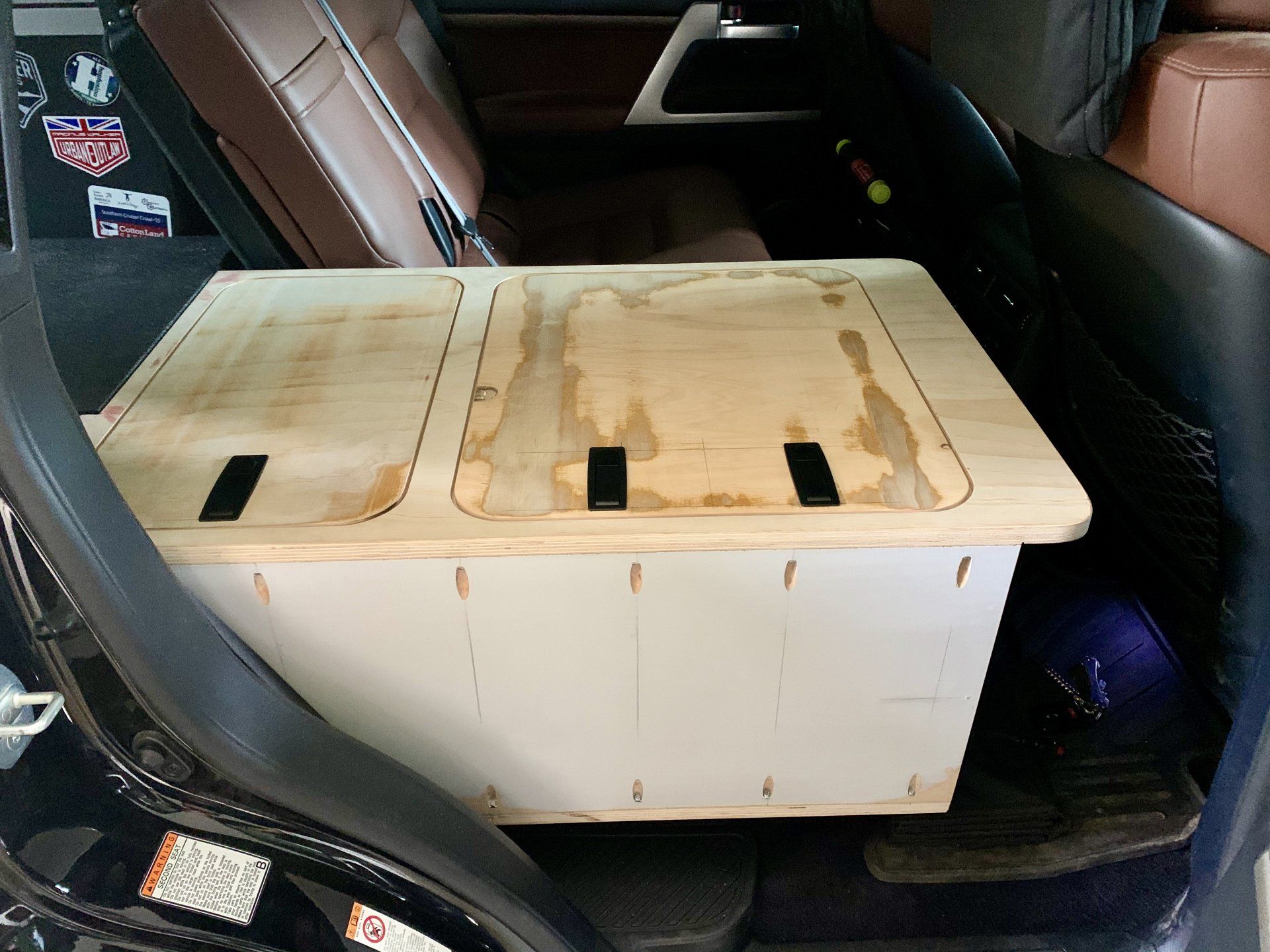

A few more process pics of the effort to build my second-row storage before our adventure to LCDC.
