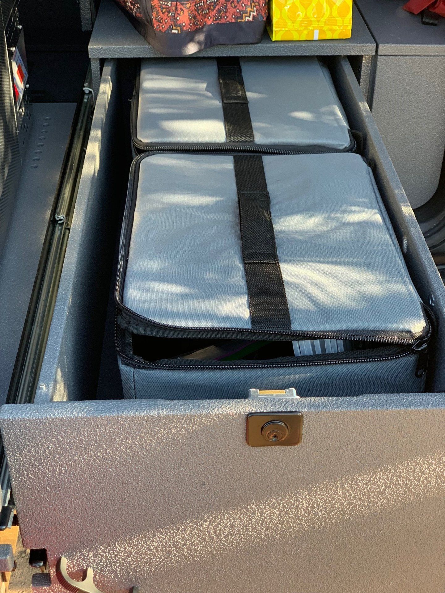

Not dividers, but FWIW - a pair of the Front Runner flat packs fit great in the large @TrekboxX drawer. Since my drawers are only loaded for day/weekend trips, I find this solution works for quickly getting my gear in/out of the system. I pack our cooking gear and supplies in them.
Thanks and that looks great.

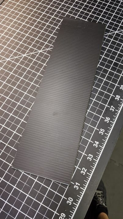

So tonight I completed the upper drawer with my home brew TrekPak. I purchased the plastic sheet, foam and spray glue at Michaels and picked up some hair pins at Target.
At this point, I'm thinking this is going to look like something out of the 3rd grade, but wanted to give it a shot, before paying for a load of TrekPak.
Here is the board I used.
1997321
I designed the system on paper and then placed the items I wanted to use in their respective locations in the drawer. First cut and complete the side sections as the front and rear measurements will need to account for the foam applied to the side sections.
Do each section at a time. Cut your desired dimensions on the sheet.

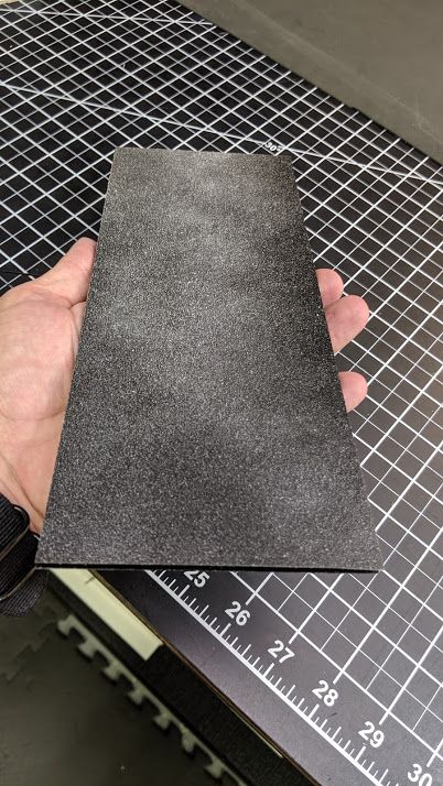

Here is the 2mm foam

Next use the Scotch 77 spray adhesive
1997324
After a light coat of adhesive~
1997327
Now place the sheet onto the foam and apply pressure. The foam bonds instantly.
1997330
Next, use a sharp razor knife to trim the foam.
