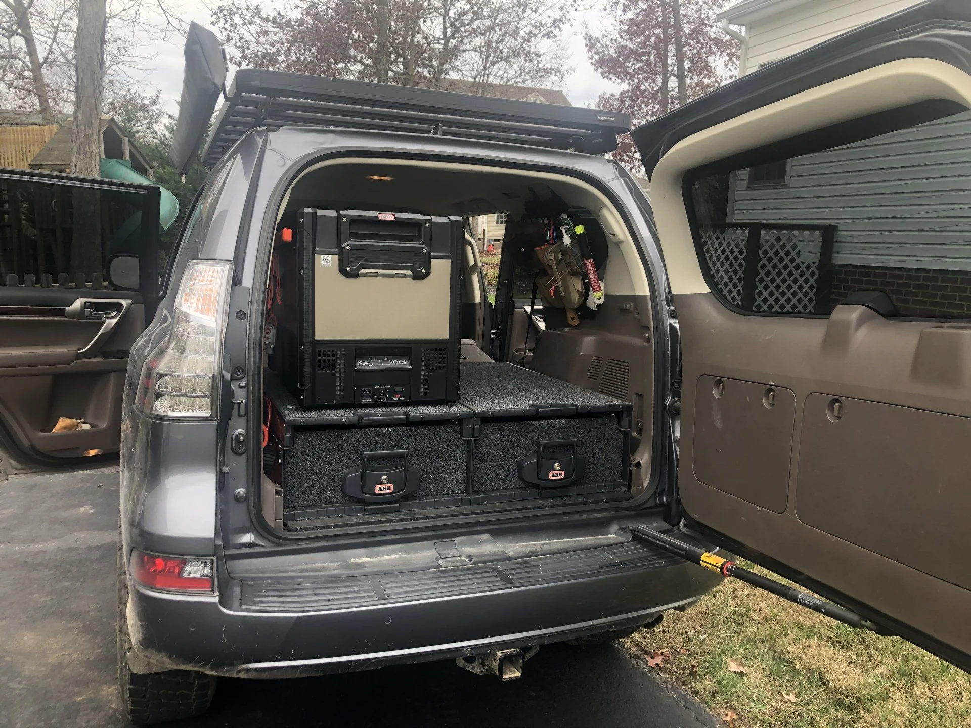

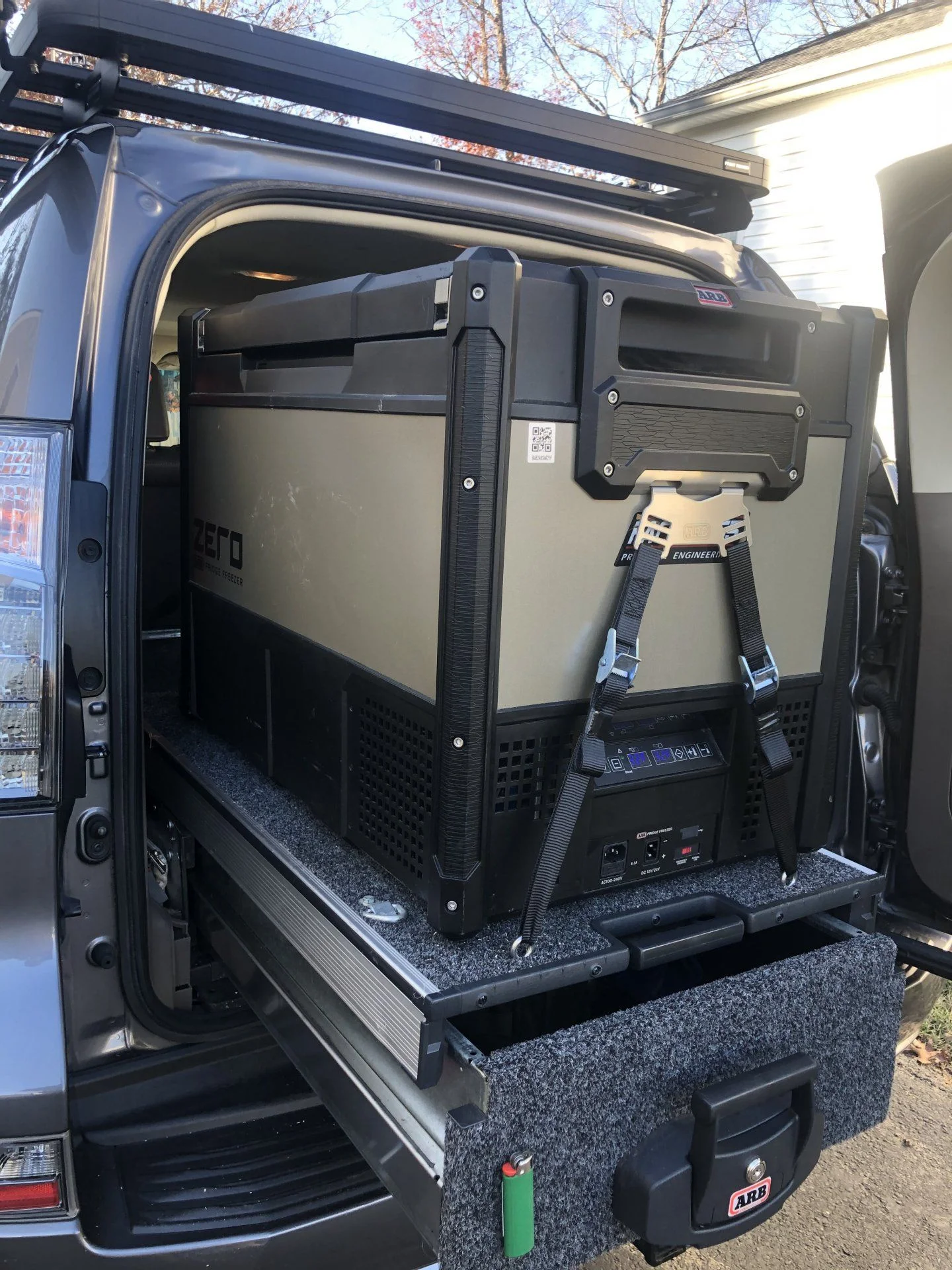

ARB Roller Drawers, the fit is tight, I believe the drawers are 40 inches long, I would recommend something around 38 max to maintain space between the seats and drawers
overall I’m very happy, I used a wits end fridge cable to connect the fridge.

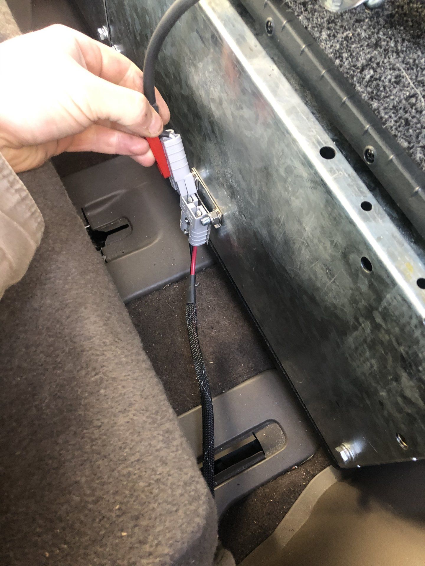

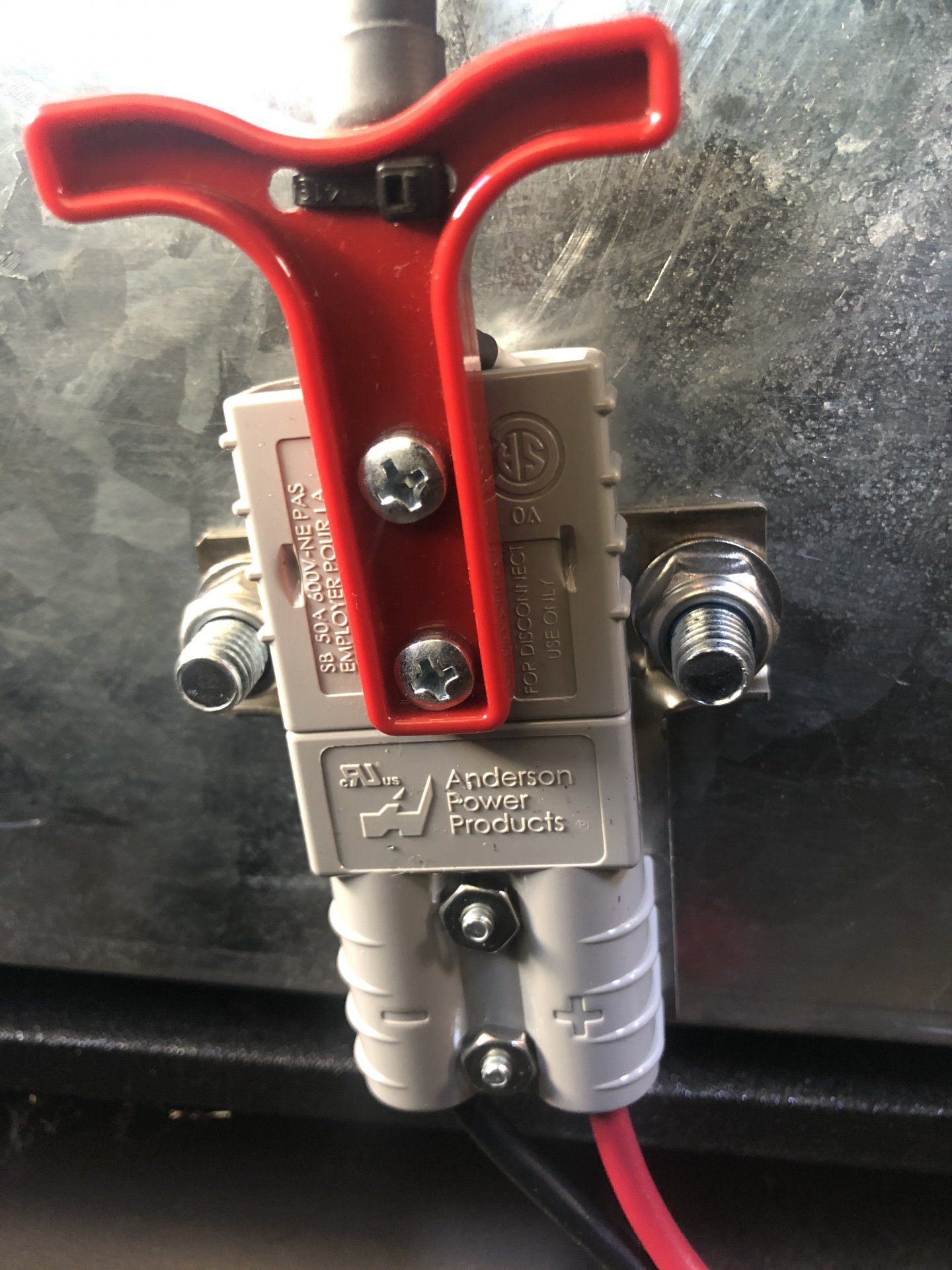

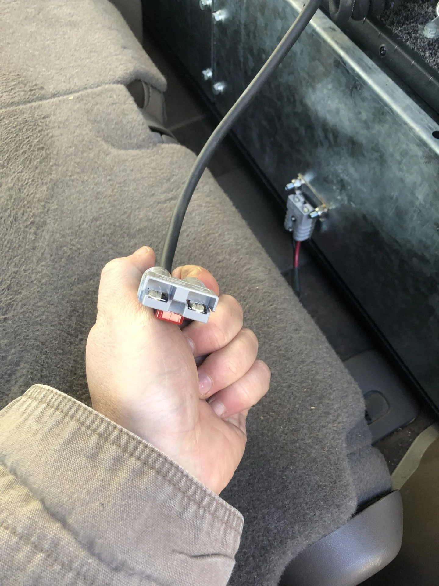

I’ve mounted my arb drawers, roller top and roller floor, and finished my fridge wiring
I used the wits end kit Joey sells for the 80 series guys. Anderson plugs, mounts, the works
wired it into my distribution block under my seat
very happy with the outcome, everything is solid and simple
