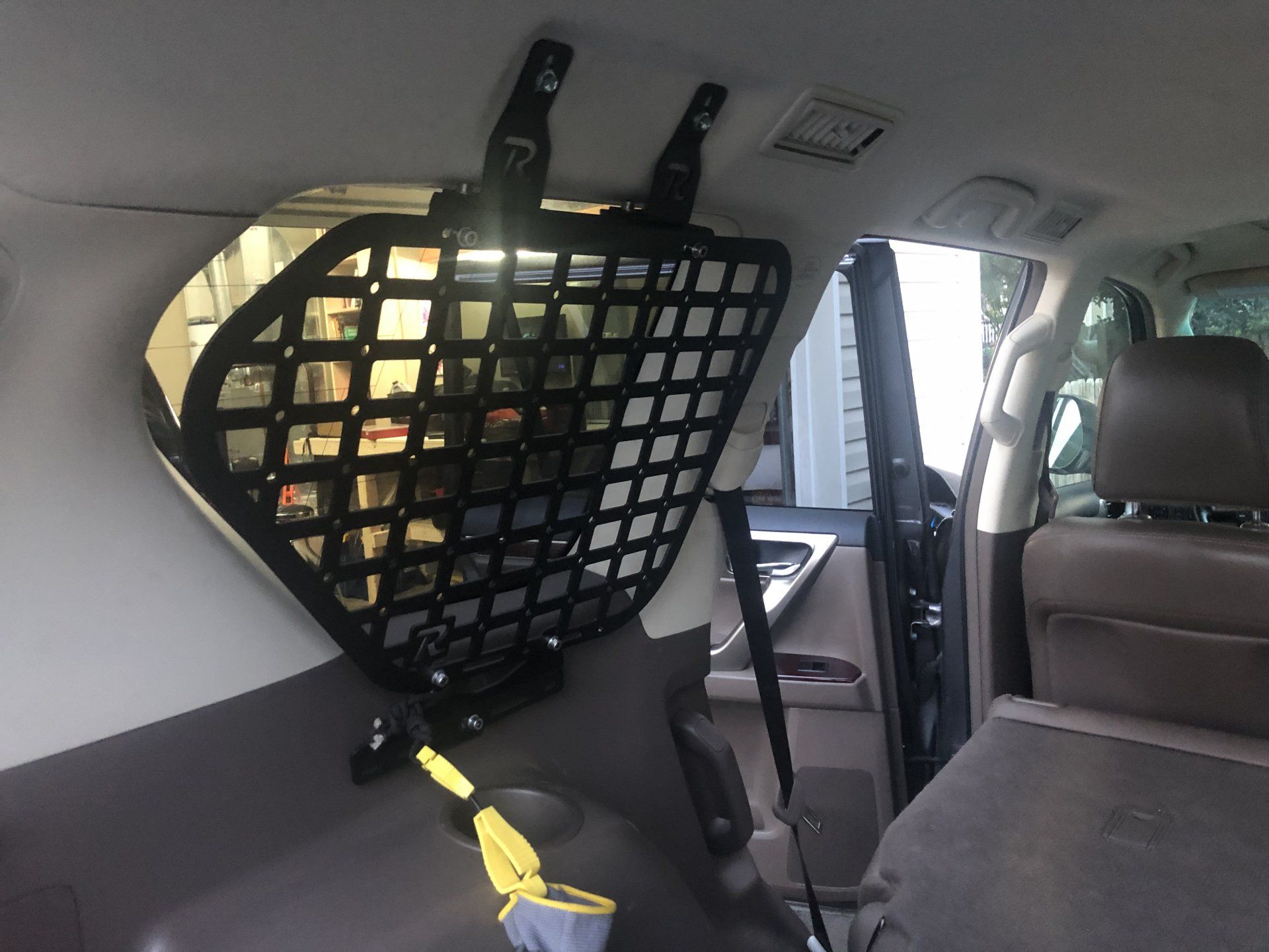

I bought these panels to mount some pouches for flashlights, recovery gear, and misc well used items
So far I reply like them, it’s handy not to search for stuff when I need it
I also packing a trama kit, to be mounted on Velcro

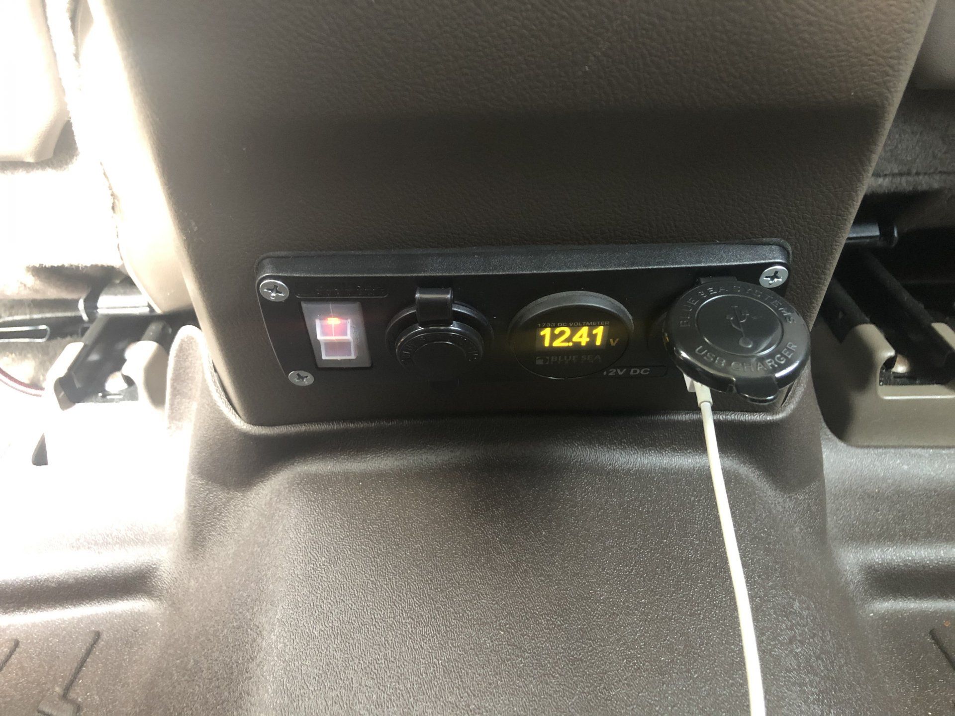

I added a rear blue sea outlet, a fuse block under the drivers seat, and replaced the stock usb outlet for a blue sea high amp usb charger, wired to the fuse block. It’s always hot and quite nice camping to be able to plug the phone in whenever I need to

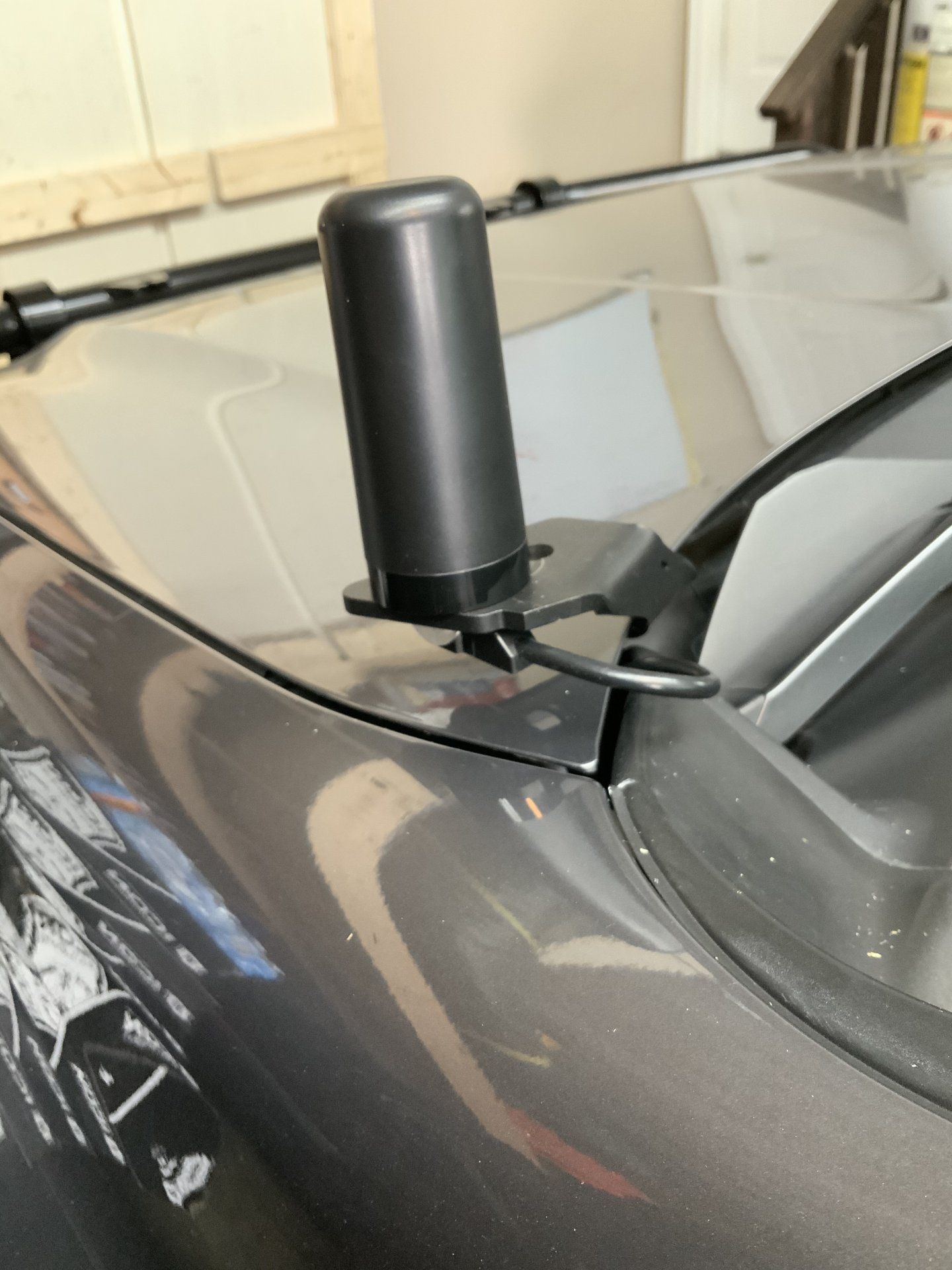

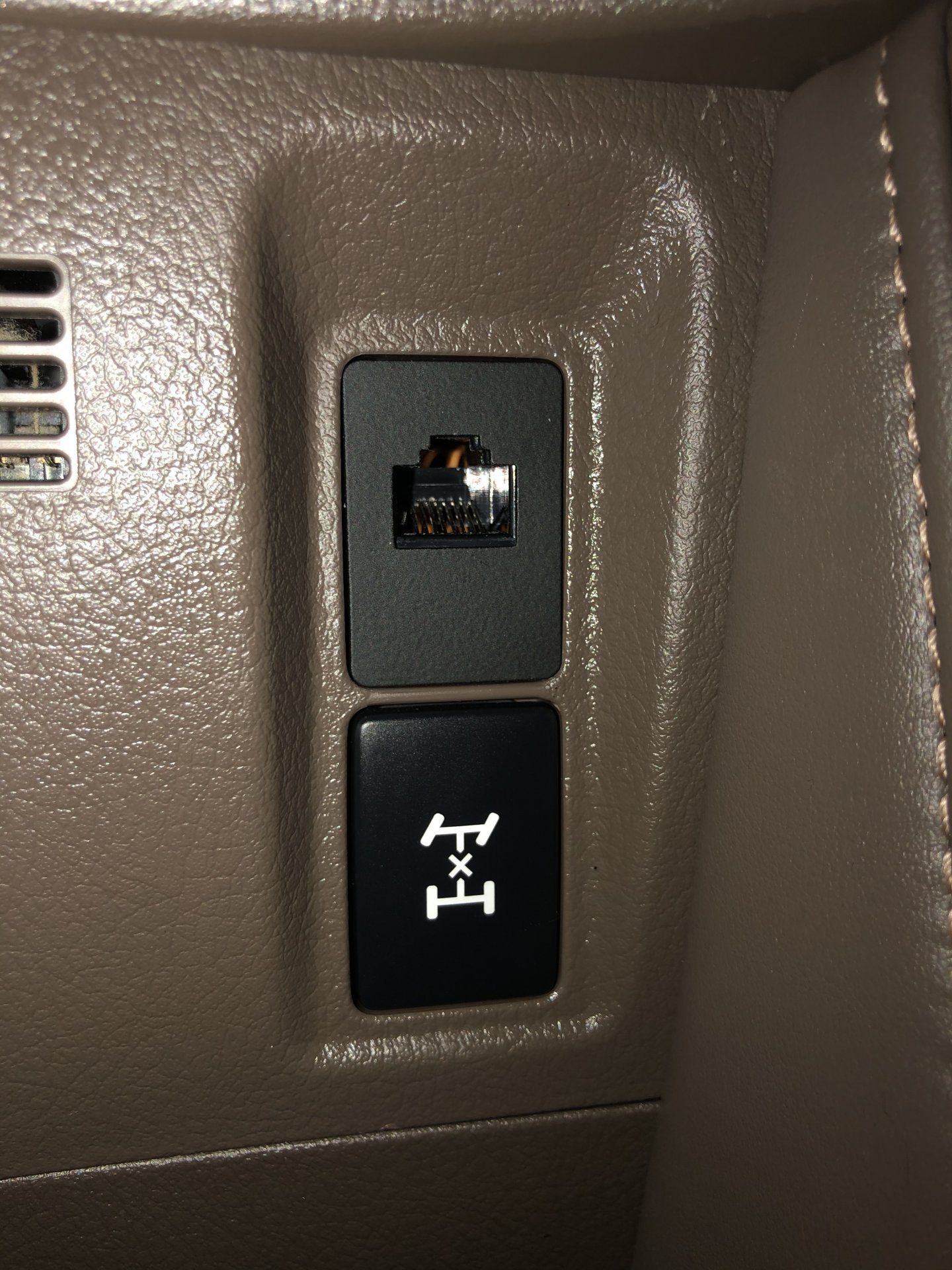

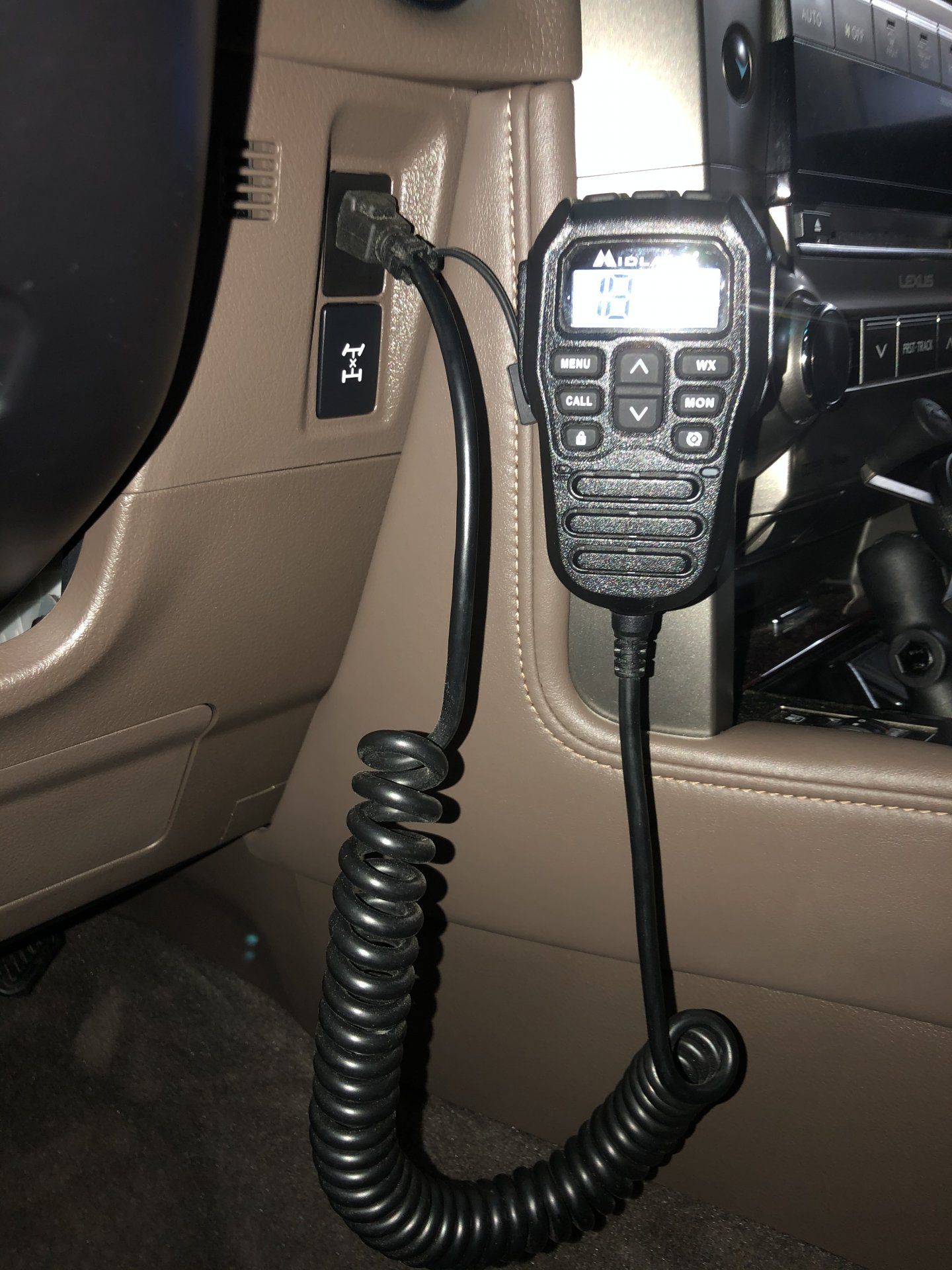

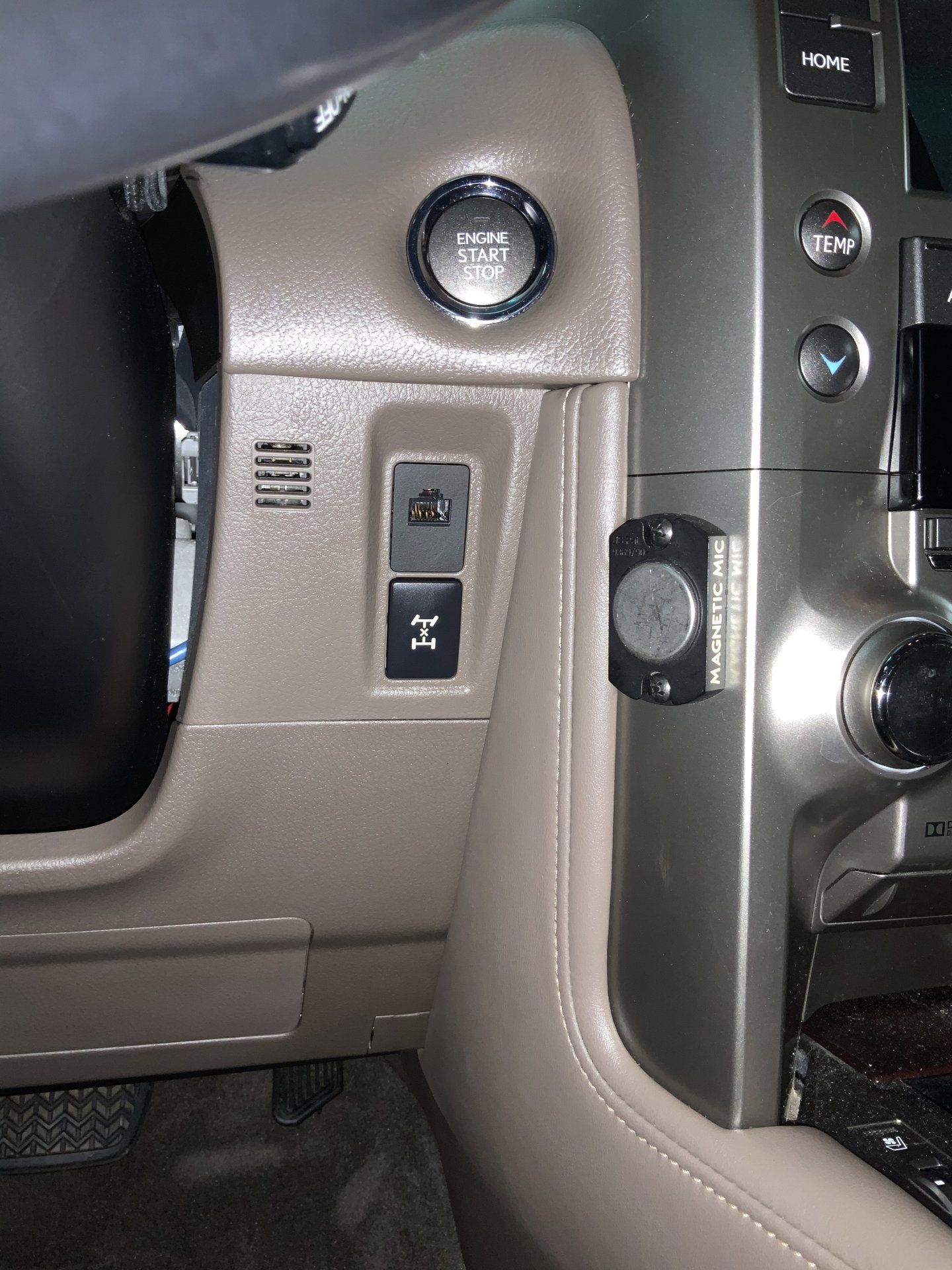

Gmrs radio install
used a magnetic mount, and a slot insert for cat5 networking cable from aus
doesn’t bang my leg at all, and is supper handy
its a midland unit, all the controls are in the handheld
a friend has the same set up and we get 5 miles of wood usage
Gmrs radio install
I like this! Do you have links or part numbers to the radio, mount and blank cable insert?
dash slot
radio
mount
amazon for the cat 5 cable, and misc electrical stuff

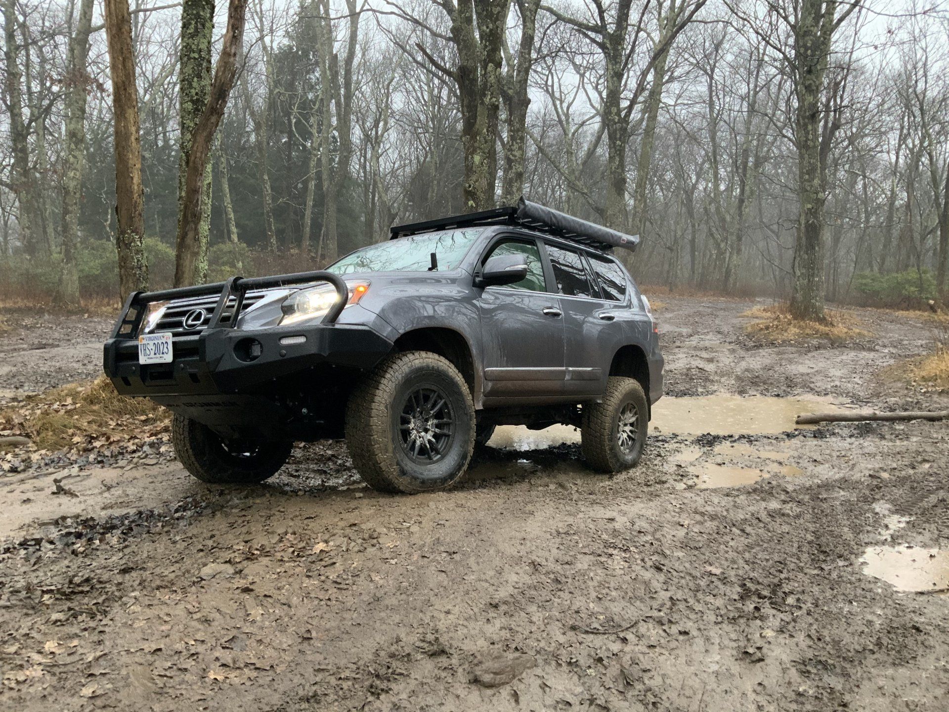

Finally everything arrived and bolted on, I’m super impressed with the radflos.
After my direct comparison to the 80 series, the GX is smooth as butter, im very happy with the amount of flex and ride quality.
Everything is coming along nicely, I need to get out and really wheel it after the sliders arrive
Icon Vector rims
285/75/17 Nitto Terra Graplers
Icon delta joint uppers
Icon rear 3” springs
Radflo 2.5 bodies Coilovers, and Rear Shocks
So the Radflo suspension has really been impressive, I can travel much faster offroad comfortably, without bashing the vehicle
I’ve taken a couple of trail rides one of which was Uwharrie and mangled my factory gas tank skid plate, so some RCI skids are going to be coming after Christmas.
this truck is very capable, I would say on par with my rear locked 80 series offroad. If far more comfortable, and adequately flexible.
with the 34” tires I really need a regear and would like to add a rear locker at the same time.
I think with the rear locked, atrac, and a good winch I will be set for what I’m capable of driving.

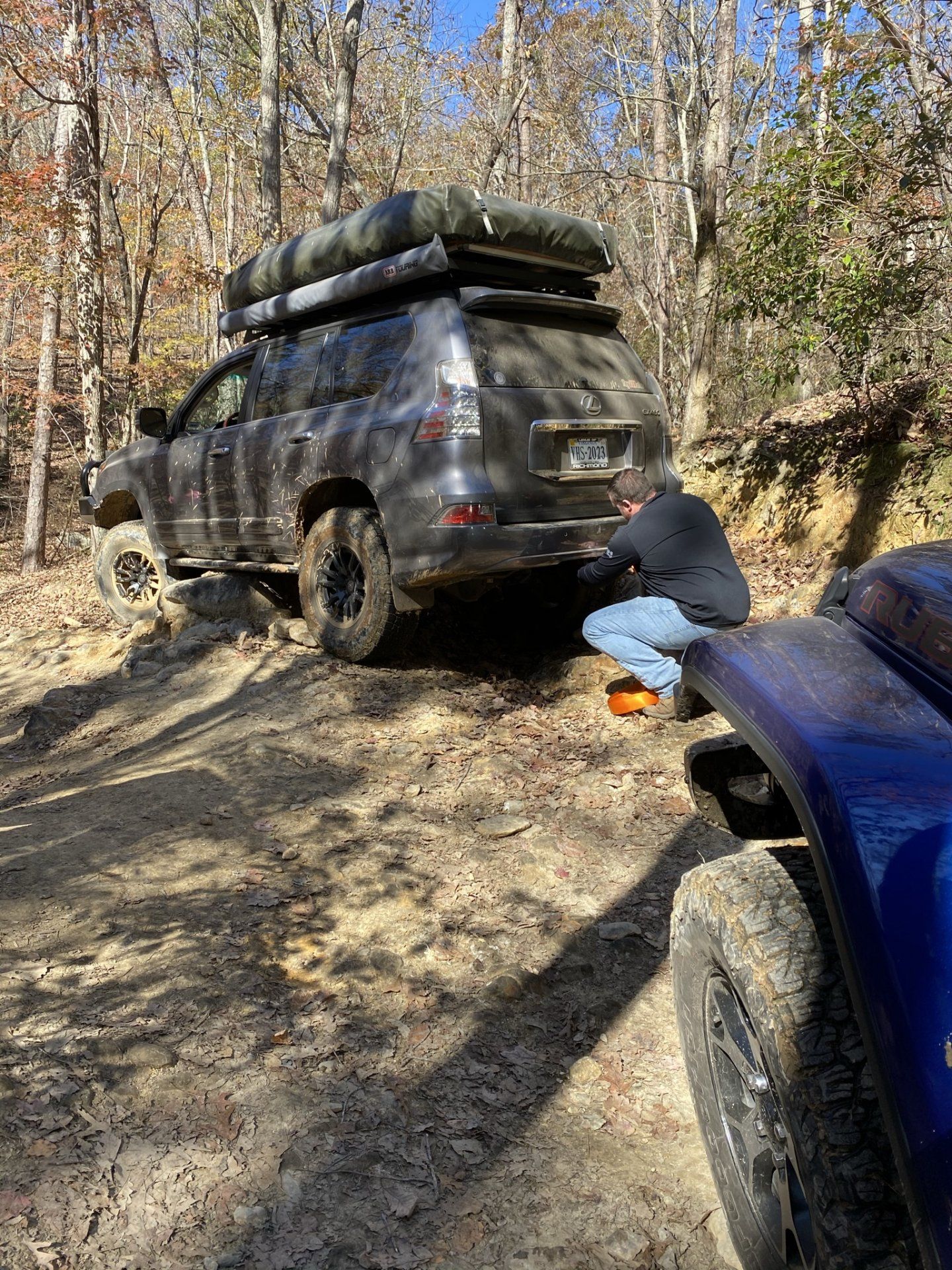

Here are some pics, and yes a Jeep pulled me off the rock, and also yes, if I could drive better it wouldn’t have happened
