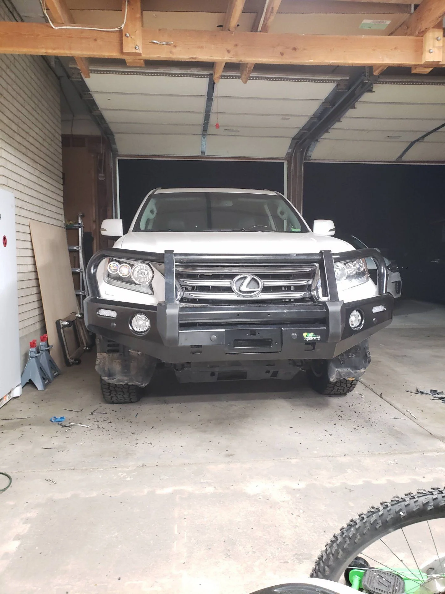

how does it ride stock with that heavy bumper any issues ?
It rides fine, I could notice the first drive, but no perceivable change now
it’s around an inch lower in the front with the bumper, I personally don’t care, I realize I’m waiting for my lift
I wouldn’t run with the bumper stock for a permanent solution, IMHO you need a suspension upgrade to carry the weight
For now, it’s fine

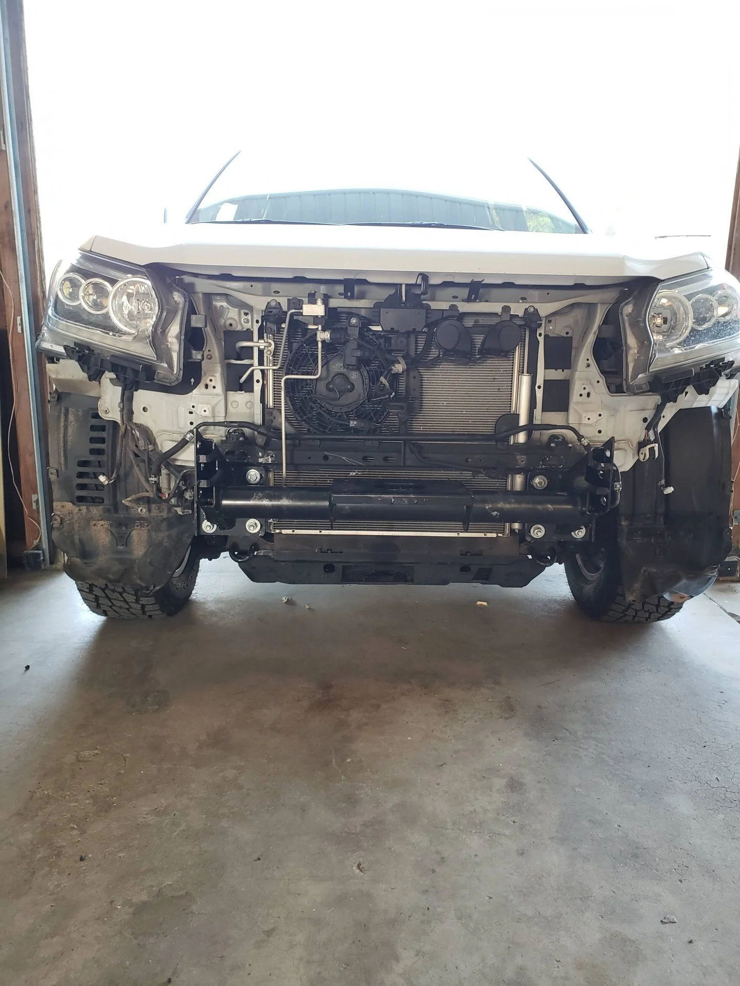

Pro tip for future installers. Install the inner bumper brackets without the channel nut, then after the bracket is in place you can push it back and install the nut from behind and push it into place so your not fighting clearance.
I was undecided on how to handle the cooling lines over the brackets. My dad suggested I use some RTV to encase the lines in place, so I'm trying that route. Yesterday was 'I think I bit off more then I can chew' , but today went really well and I'm hope I'm over the hump!
I trimmed my mounts to allow the coolant lines to remain in the stock place
Yeah, I trimmed a lot to make room and modified some of the coolant brackets to work, but it was still pretty tight around the bumper brackets, so I used some RTV to keep the lines away from possibly touching any metal.

Wowsers, got it done. I cut the front lip off of the factory skid plate and put it over the rock guard. Still need to pin the bumper, but I'm going to wait until I install the lift kit so I can level the bumper if needed.

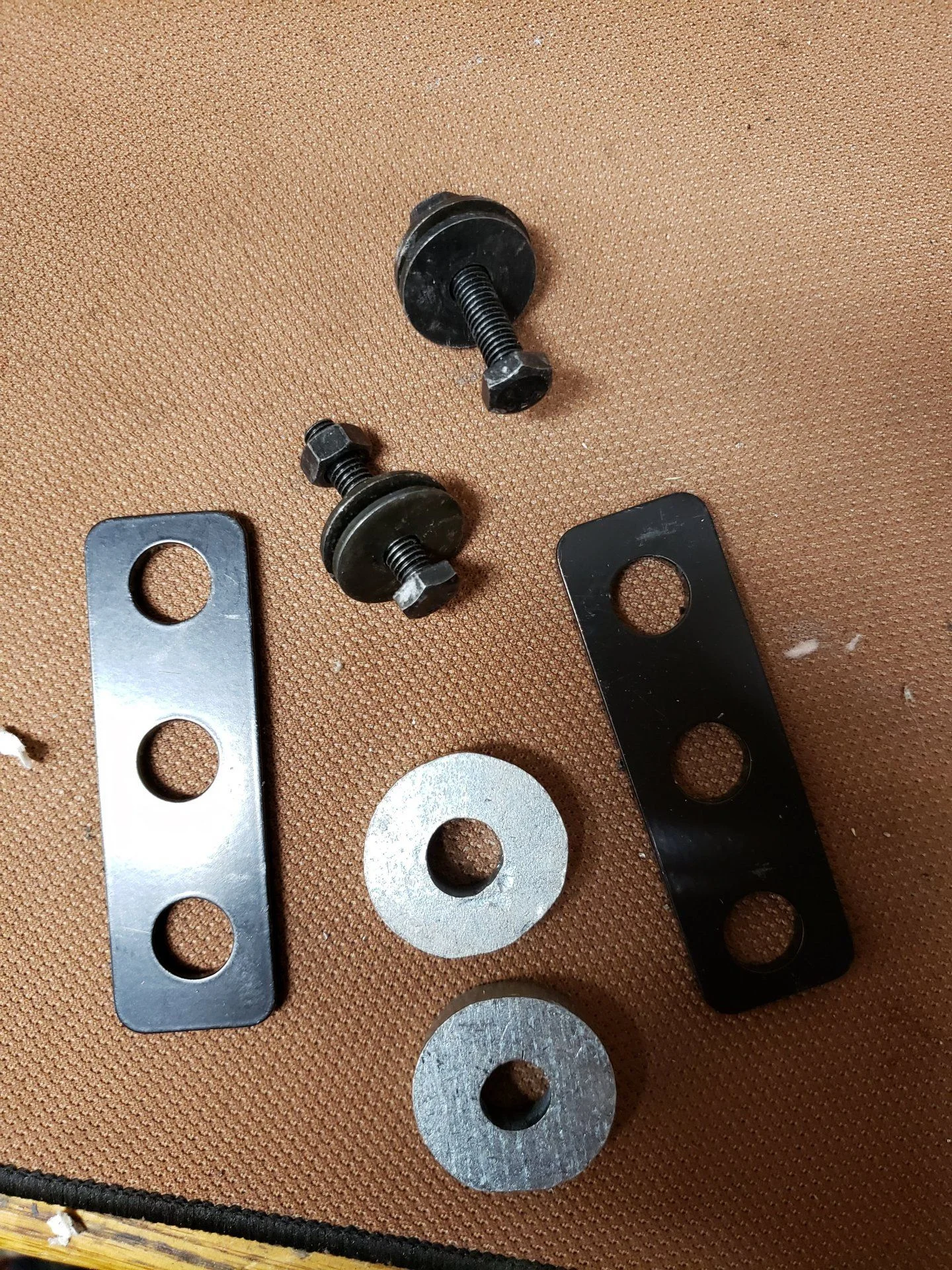

The only parts I have left I'm not sure about:
2 thick washers.
2 thin long bolts with hardwear, doesn't look like a structural part.
2 short black brackets with 3 holes in them.
Any ideas?
What did you all do , if anything, to tie the wheel well into the bumper. It looks like there are 3 bolts holes in the side rock guards inside the wheel well.
2 thick washers.
Any ideas?
The black brackets are supports for the winch mount and quite needed. take a pic so we can tell you for sure

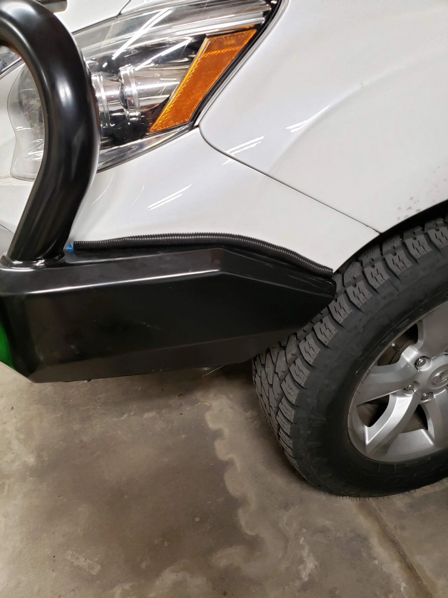

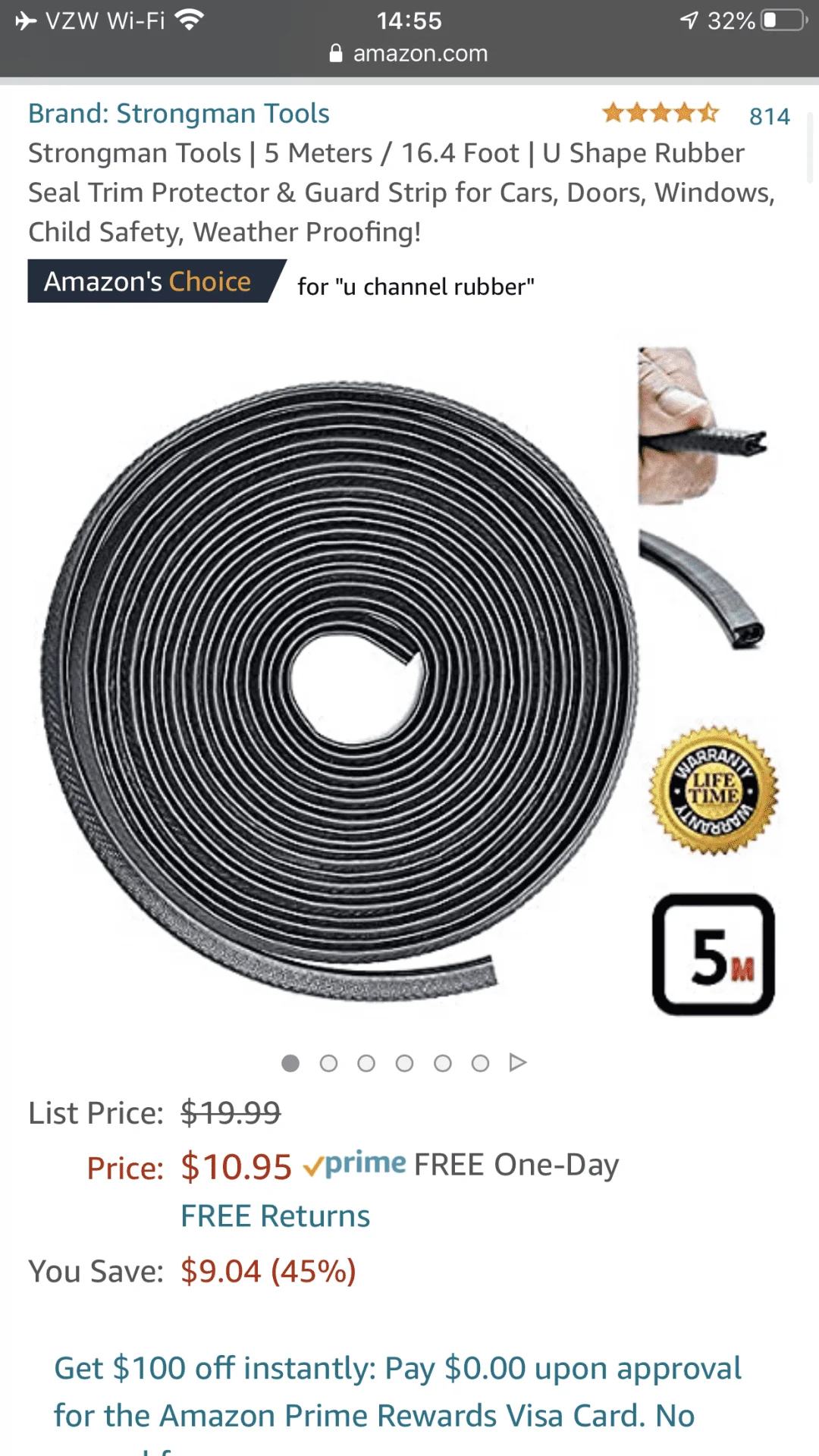

I trimmed the liner to fit inside the lip of the underskirts for the wings
this allowed movement of the bumper, but also kept the mud out

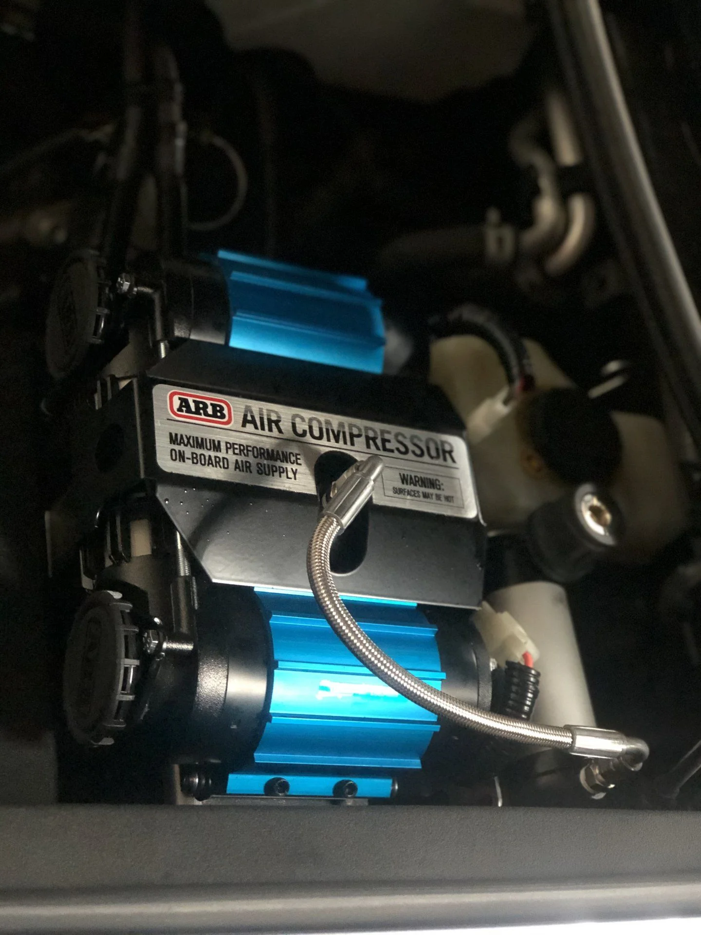

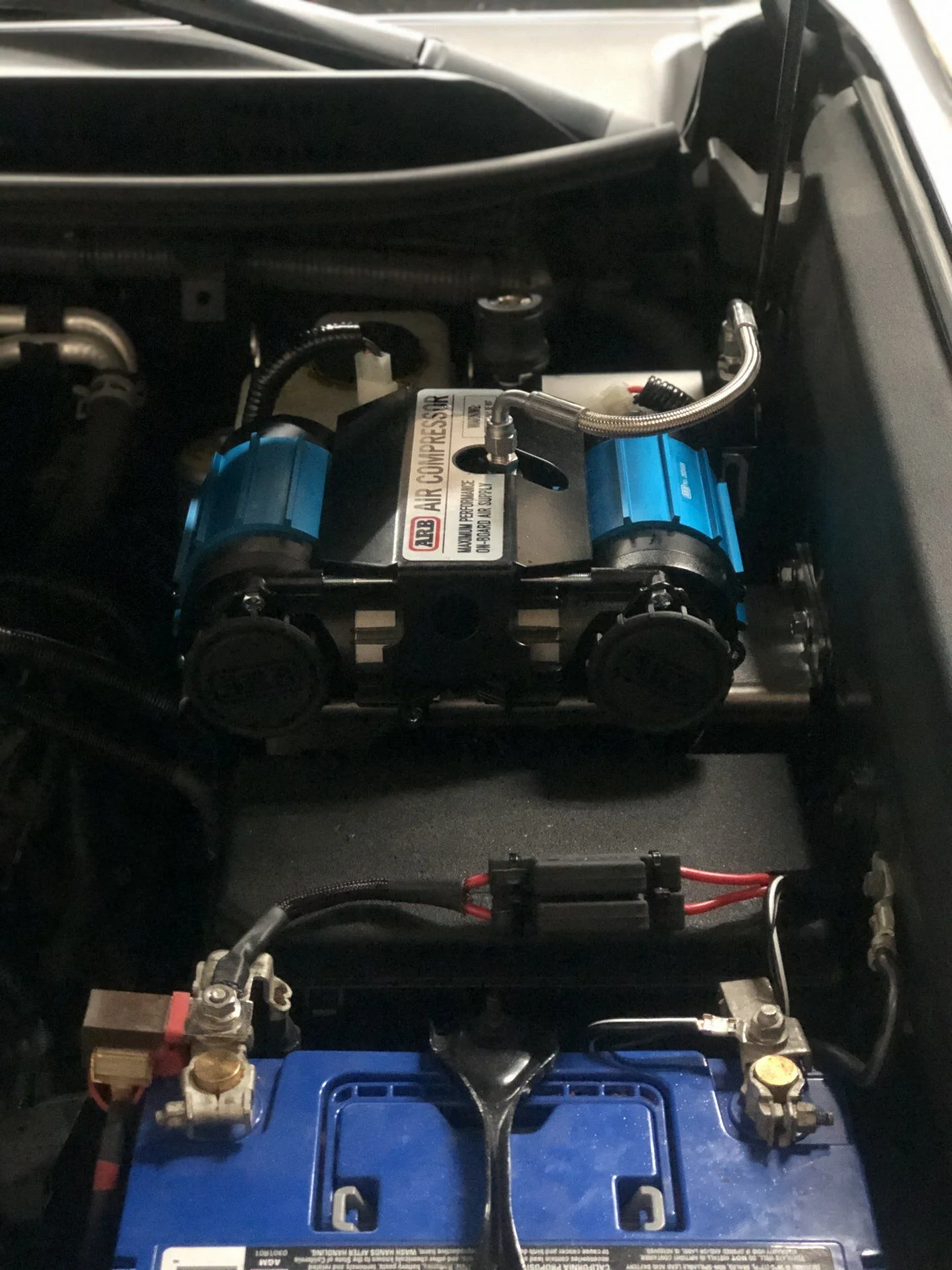

I have mounted my ARB twin in the truck finally
I used a Slee mount which fit like a glove, as expected, except the mounting hole on the fender were filled with compacted dirt inside the bolt holes
I ended up running a small drill bit through the hole to clear it, then brake cleaner, then a 6mm 1.25 tap, worked like a charm
I bought an aftermarket switch to control the compressor from the cab, which turned out great
I’m very impressed with the ARB twin I wish I would have bought it sooner, I’m still running my old Viar in the 80 series, which works great if your not in a hurry
I have also bought some parts from Wits End to allow me to run an airline to the front bumper with a quick disconnect. It will be nice to have a hard mounted compressor, and a factory looking switch

One concern I have is the hose getting loose and wrapping around something that spins like the belt or fan
Several reasons it should never happen:
  1. It's coiled over the SS braided air line so it has a fixed point to which it is attached and can't shift too much.
  2. It cannot come uncoiled because both (male and female) ends are connected together to keep dirt out of the line and prevent a loose end from dangling.
  3. It's a pretty large cable tie and everything is far enough from the engine, exhaust and other "hot" items to not cause any issues. Heck, use 2 cable ties if you like!
I've driven 10's of thousands of miles including severe washboard, rock crawling, many, many many dirt trails with this setup and NEVER had any issues at all, not even coming loose, only the convenience having everything right were I need it.
